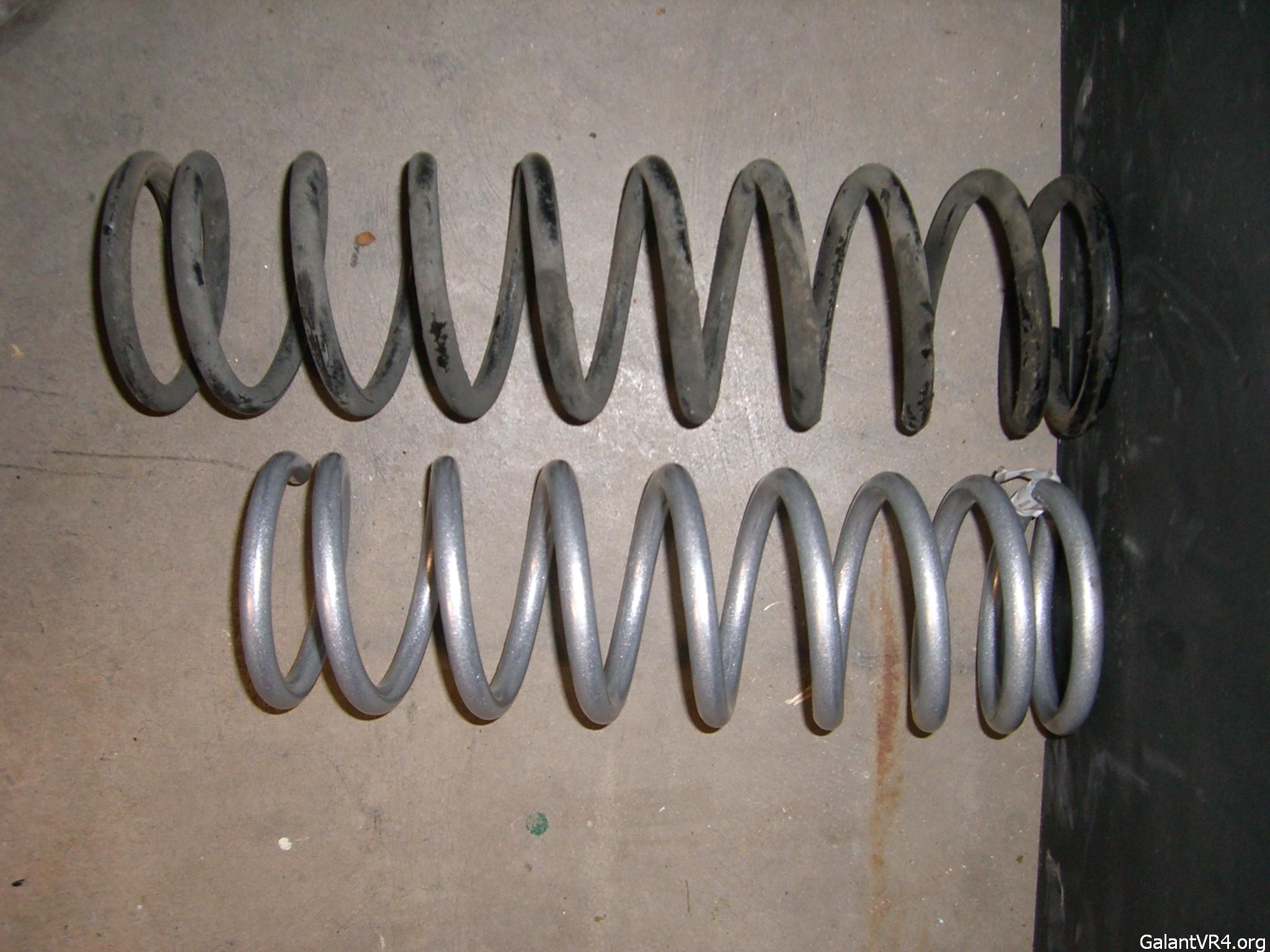

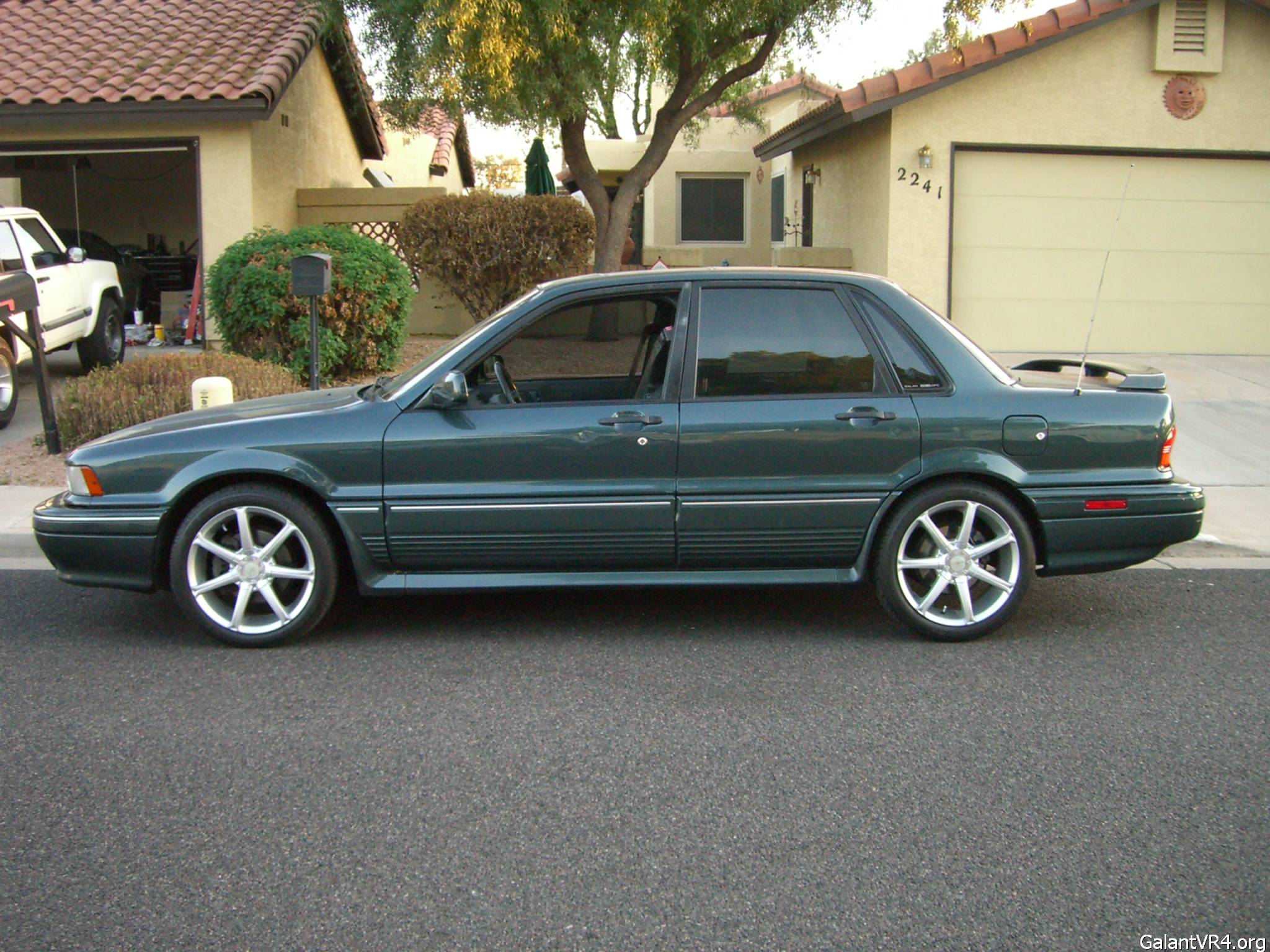

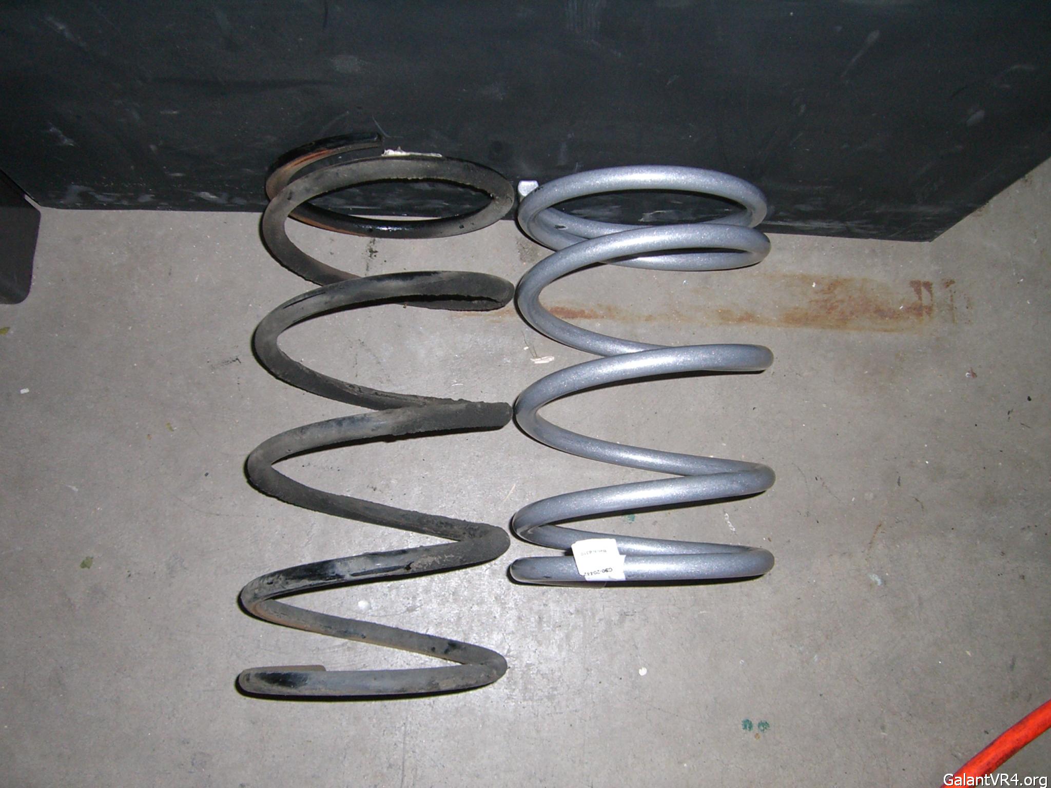

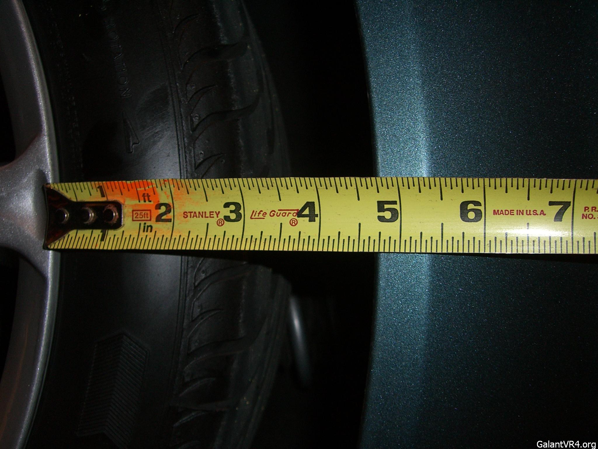

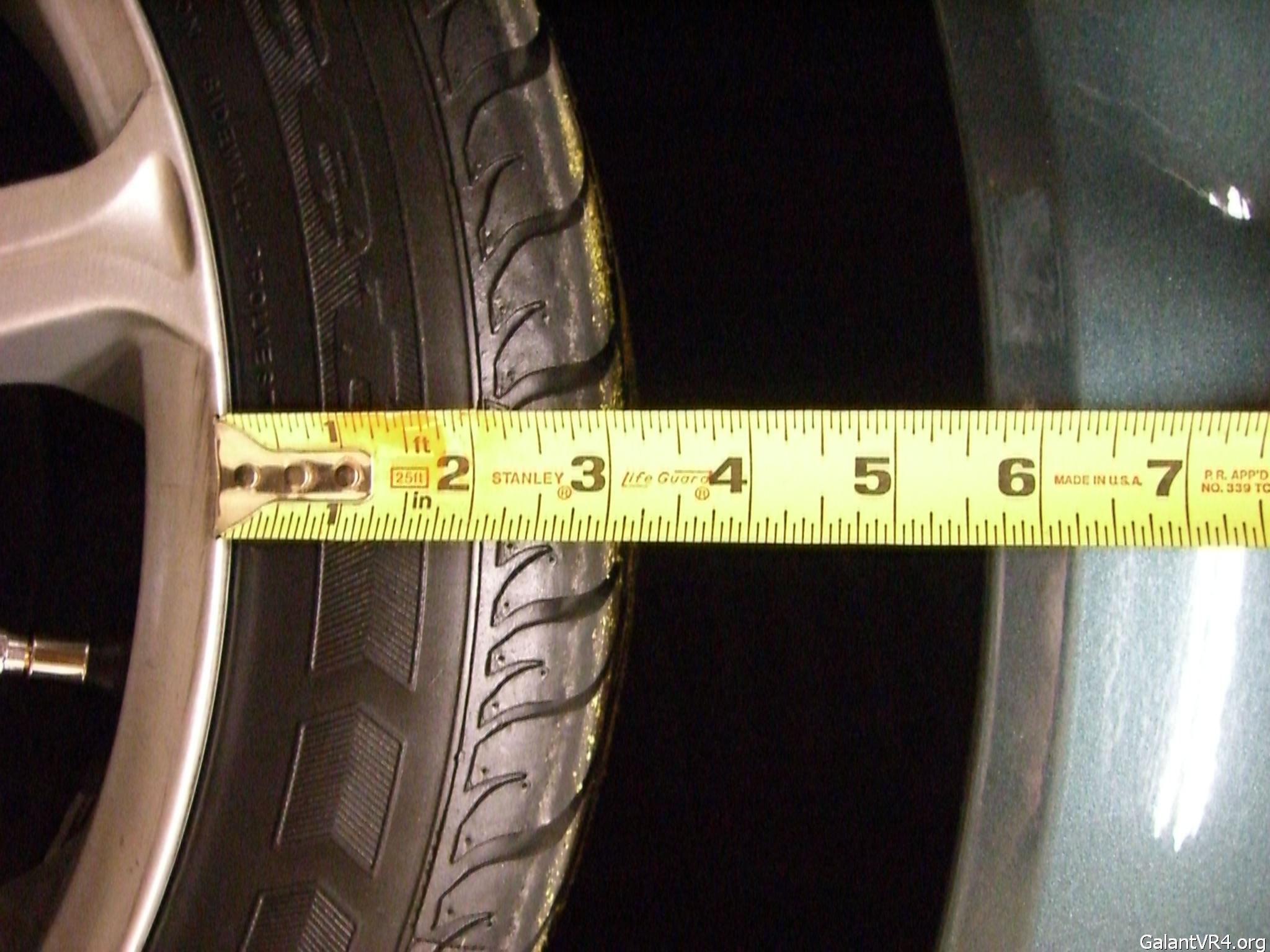

It will always vary from car to car. I just put Whitelines on my car and it dropped an inch all the way around, but seems to be settling a bit lower. Here are a few pics.

When I looked I found that the H&R's for the most part would sit somewhat uneven. All the cars with Whitelines sat nice and even so I waited for those and I am pretty happy. Mine does, but it does sit a bit higher than I would like, but I may experiment with some different upper mounts and see what those do heigth wise.
I can get side shots up later tonight if you want.
