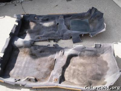

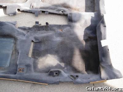

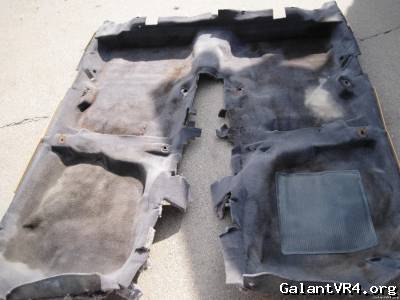

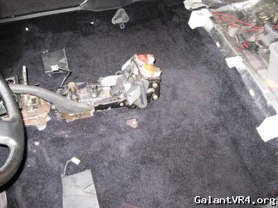

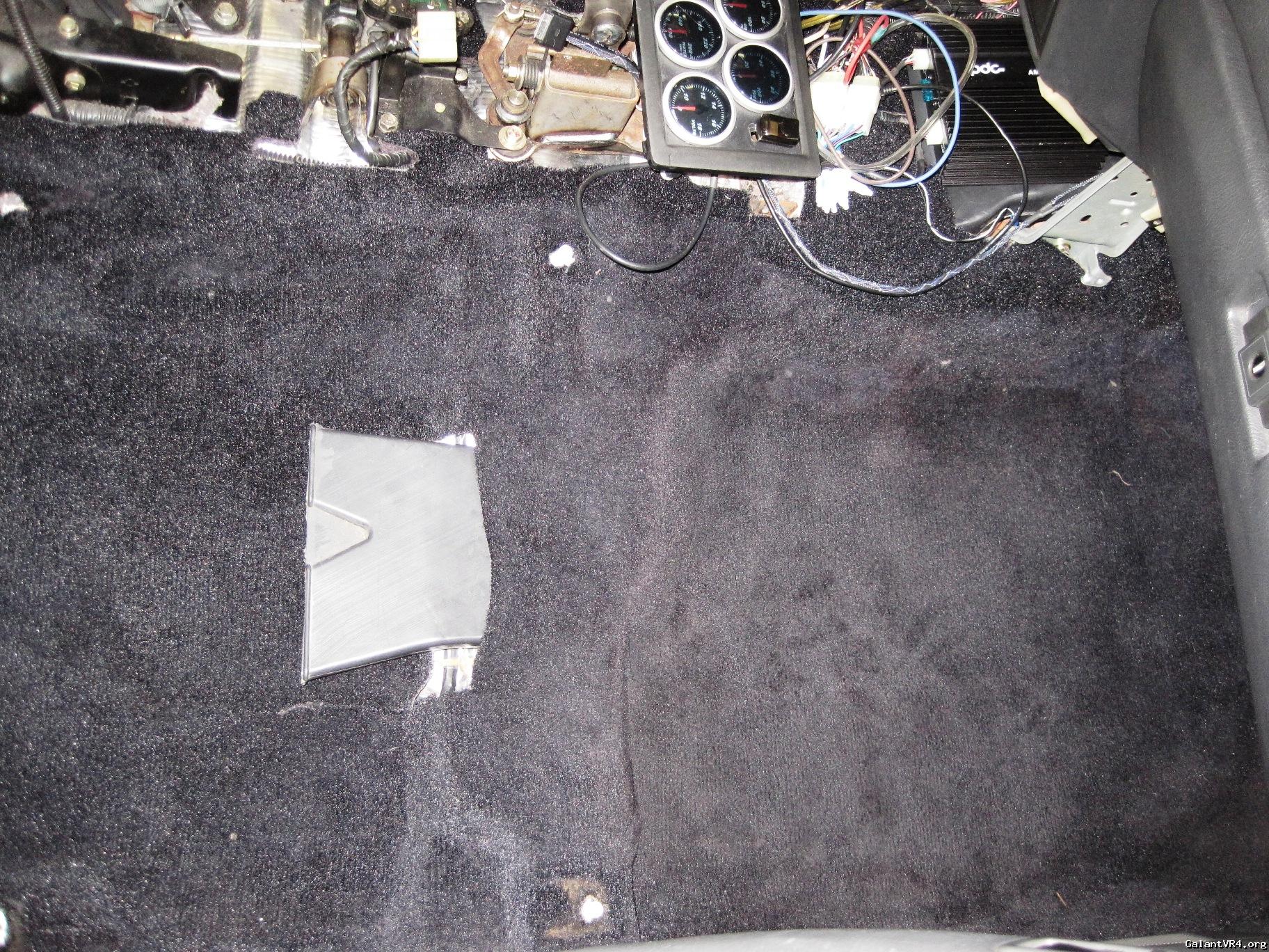

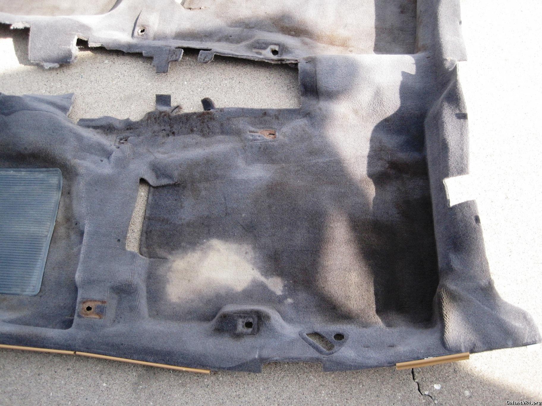

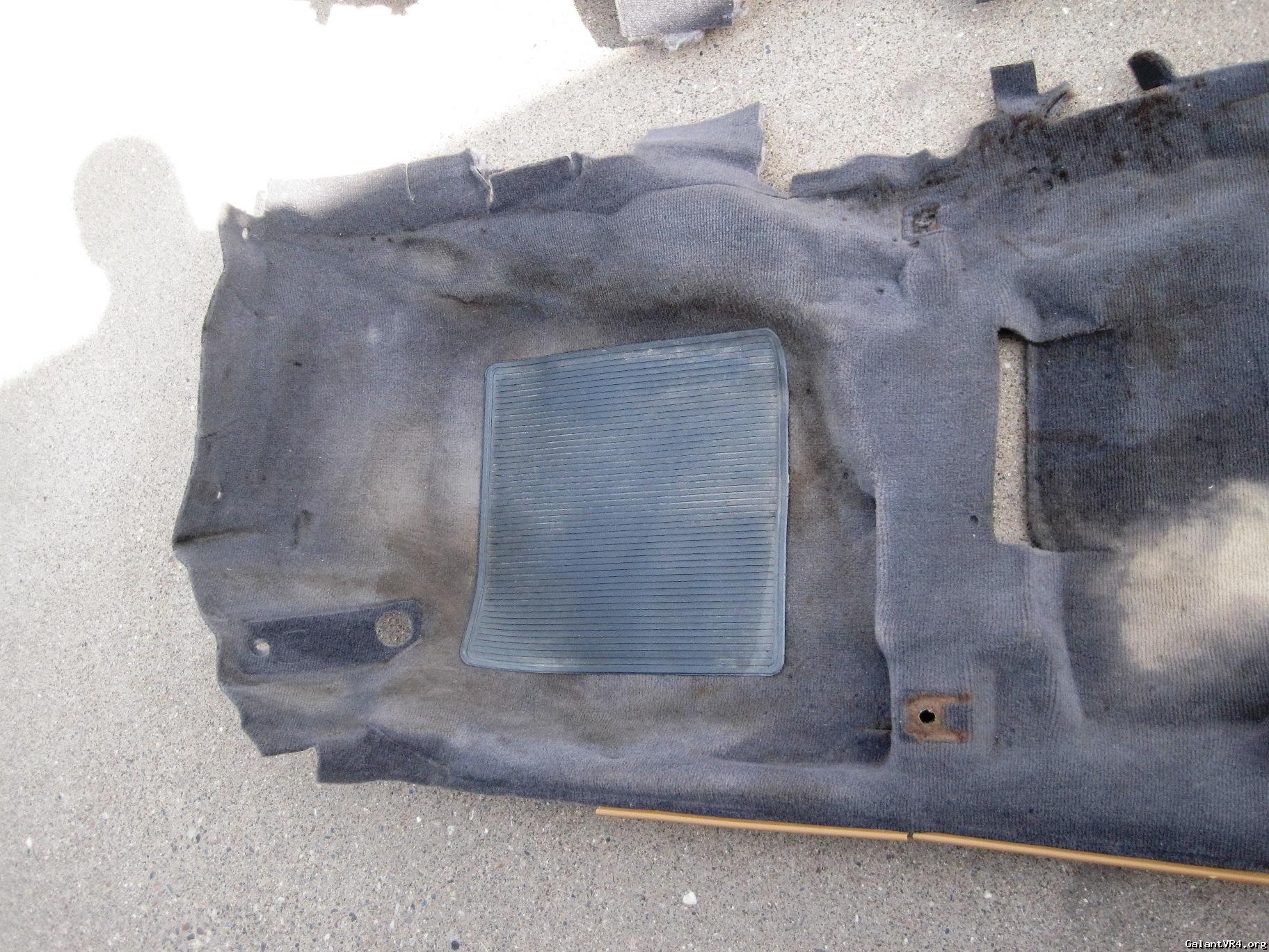

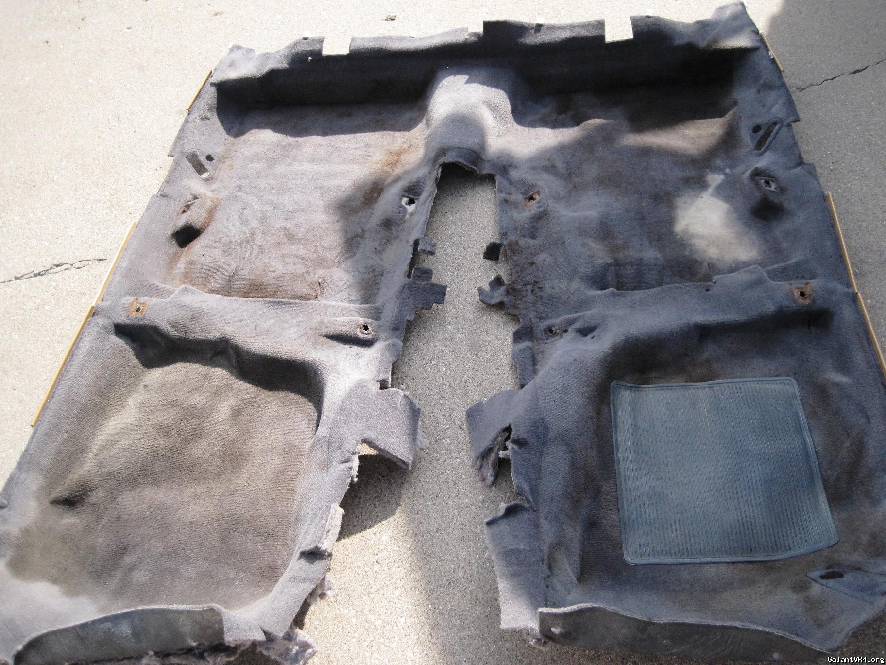

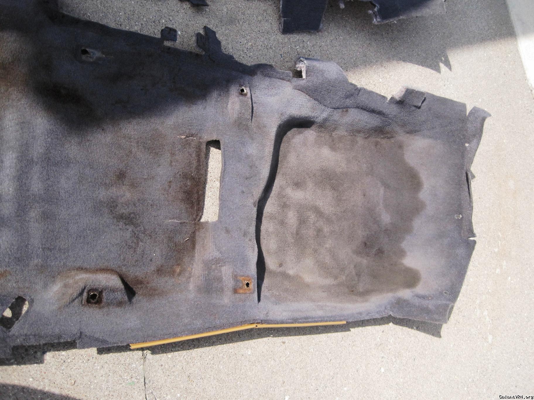

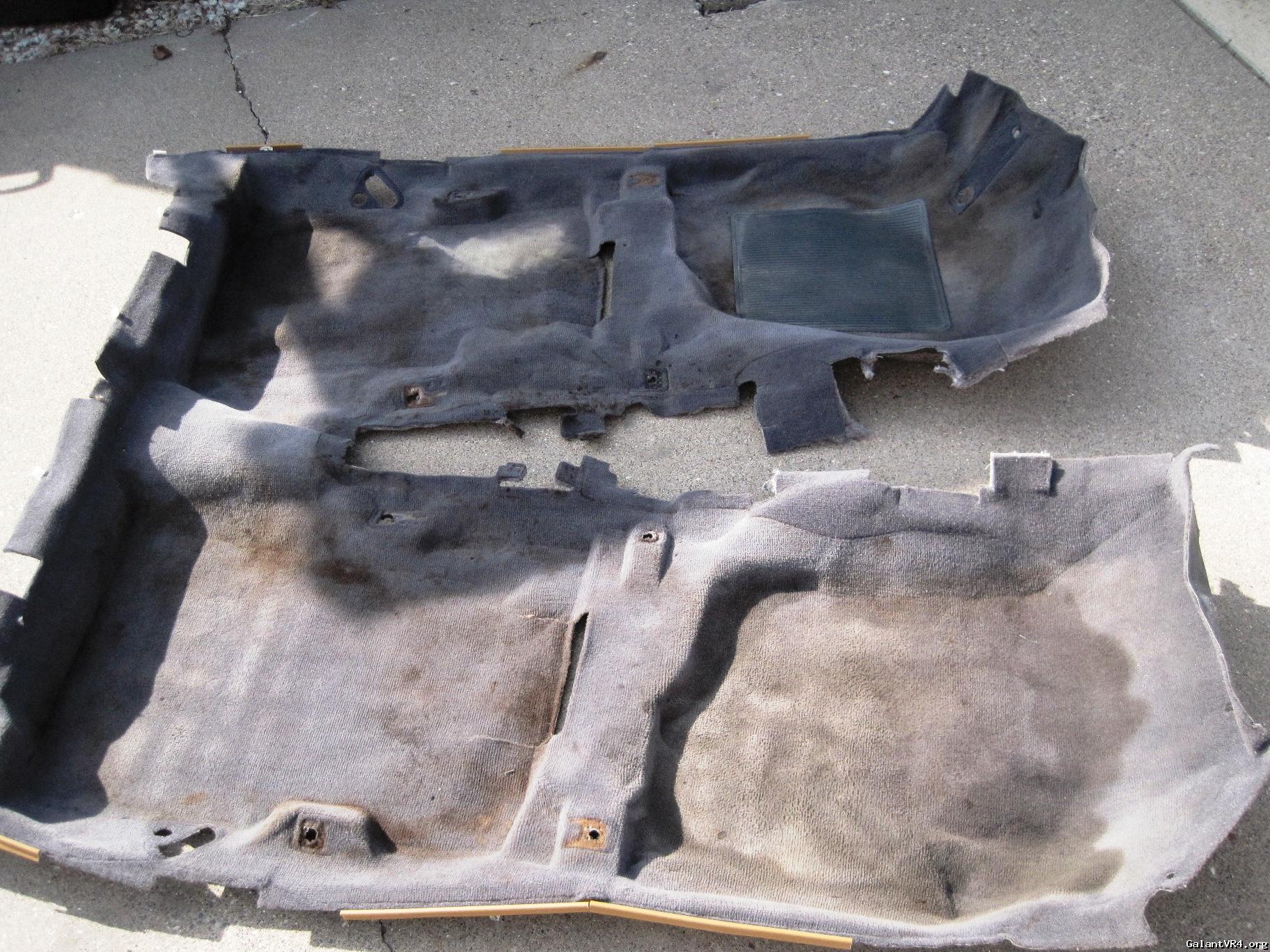

Here are some before pictures of the carpet before dyeing it black.

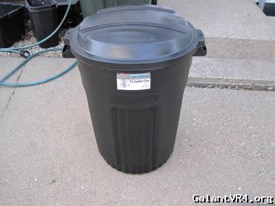

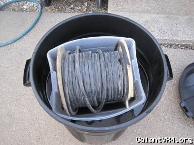

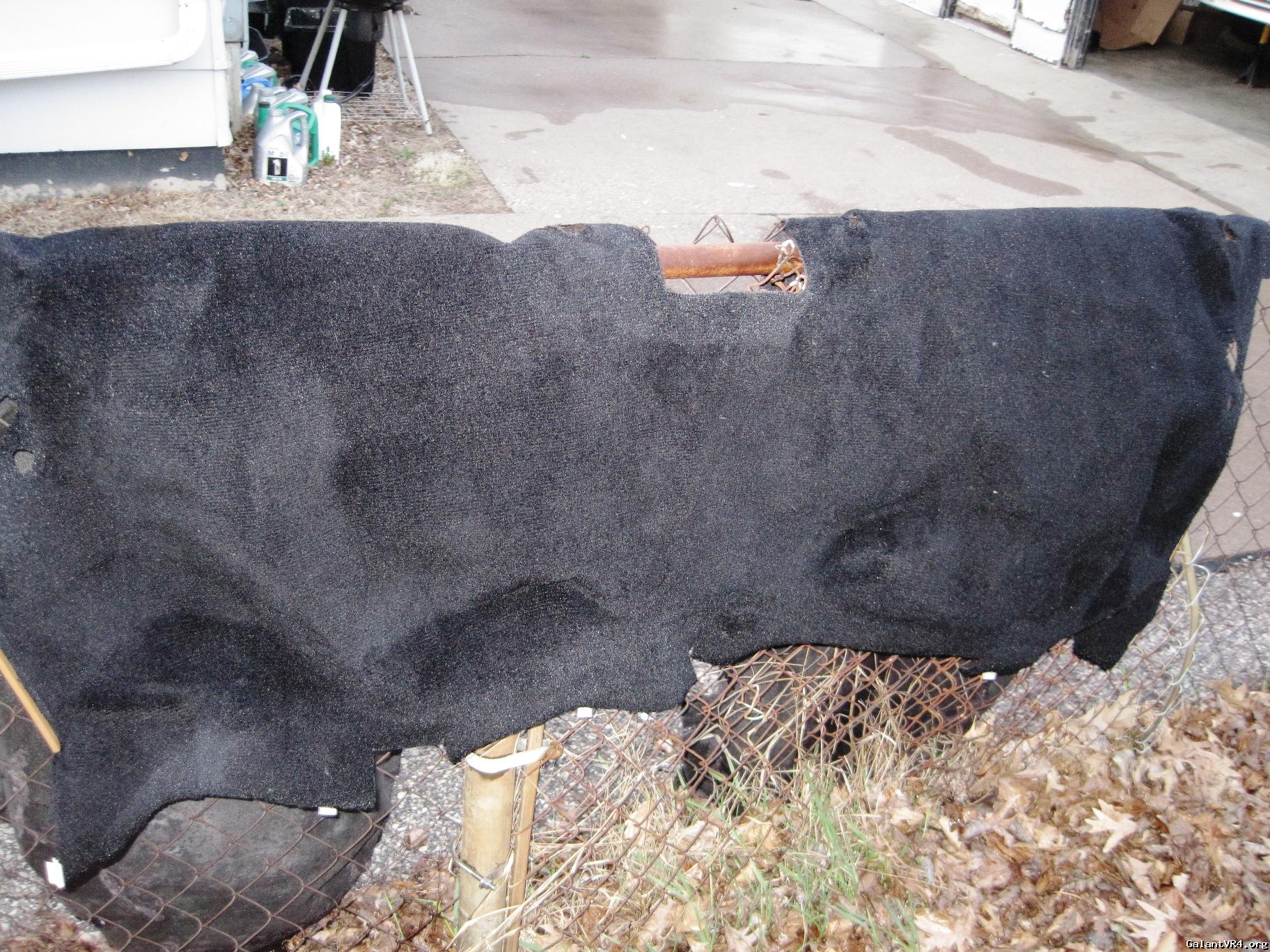

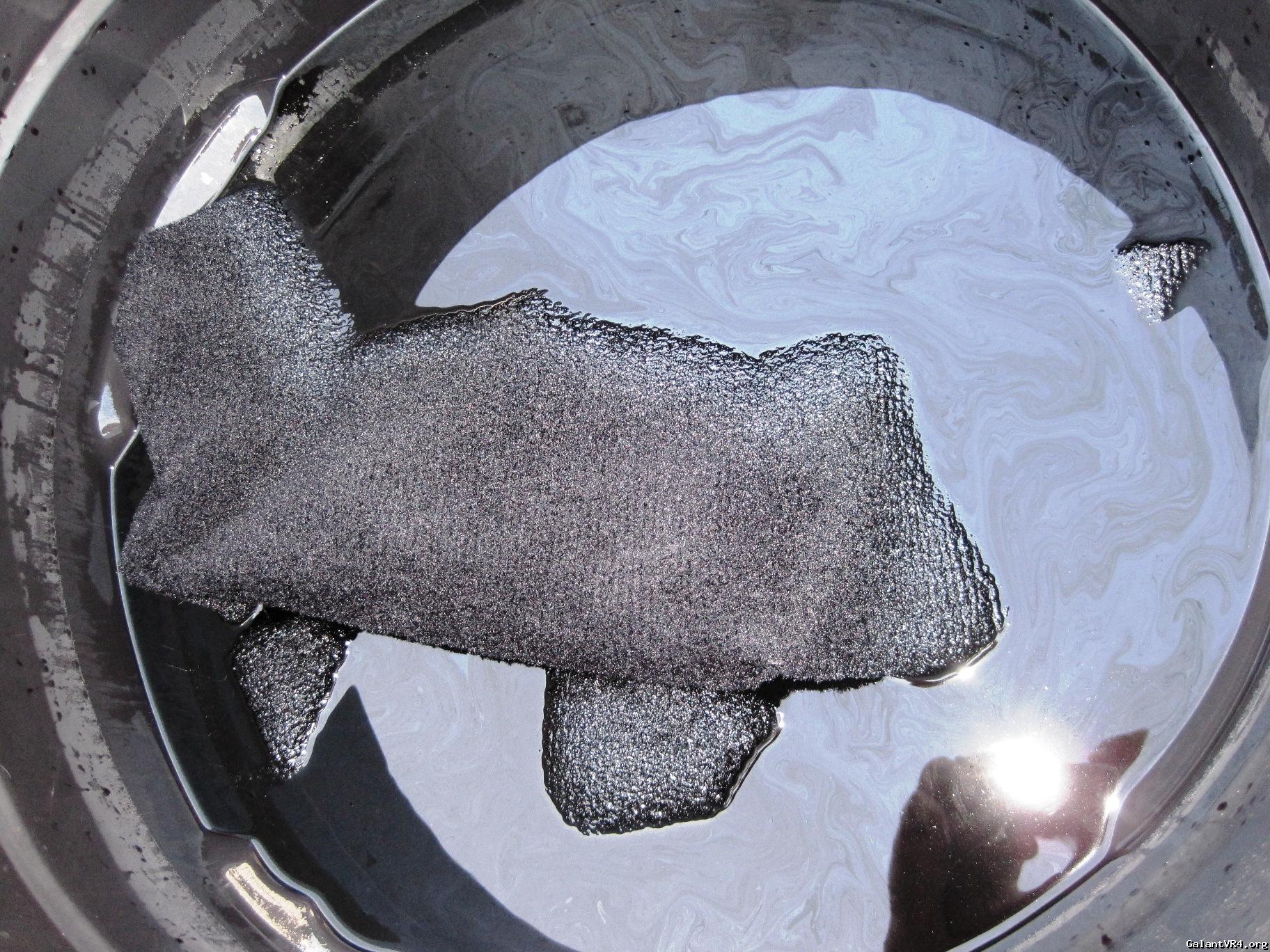

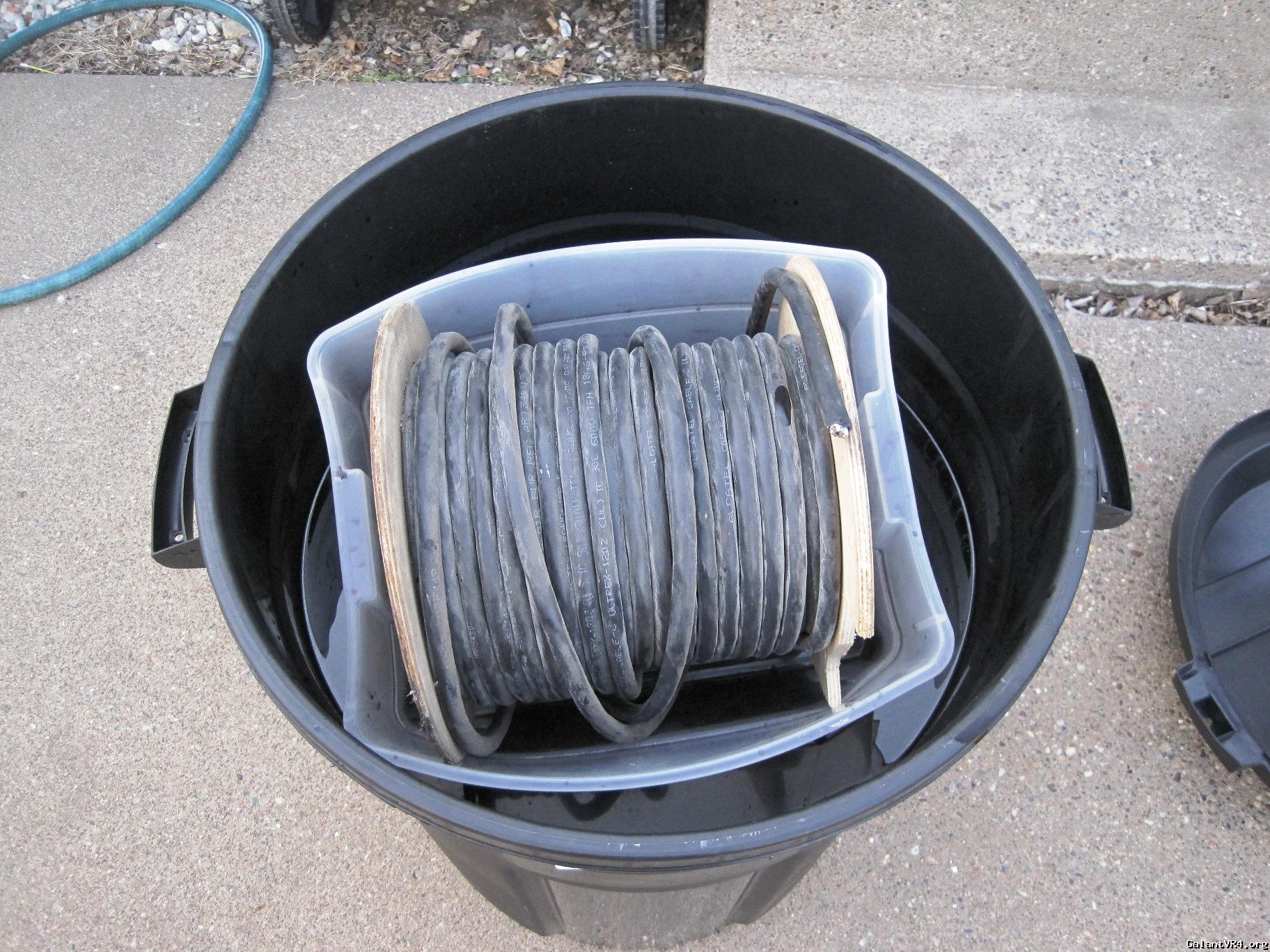

I used 5 bottles of RIT black (all Walmart had) and bought a new 35 gallon trash can for $8.00 at Menards. Filled it will the hottest water my hot water heater pumped out. Mixed all 5 bottles and folded up the carpet and plunged it into the water. I went out every 15 minutes and moved the carpet up and down to remix. As you can see, I used a tub filled with a big spool of wire to keep the carpet fully submerged.

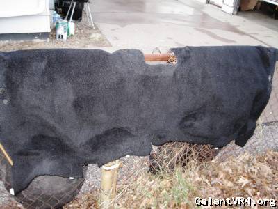

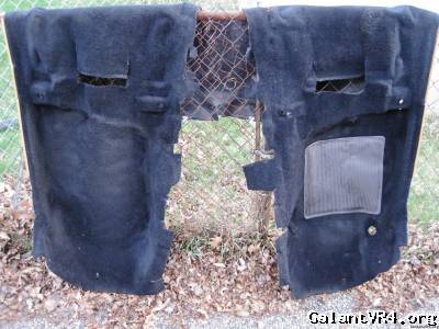

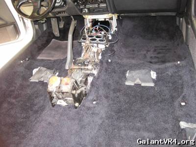

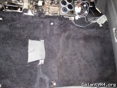

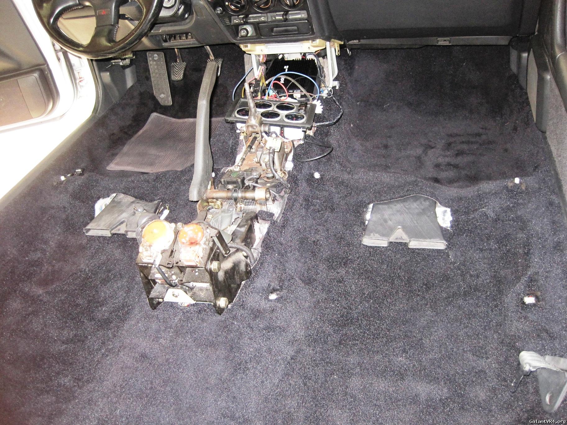

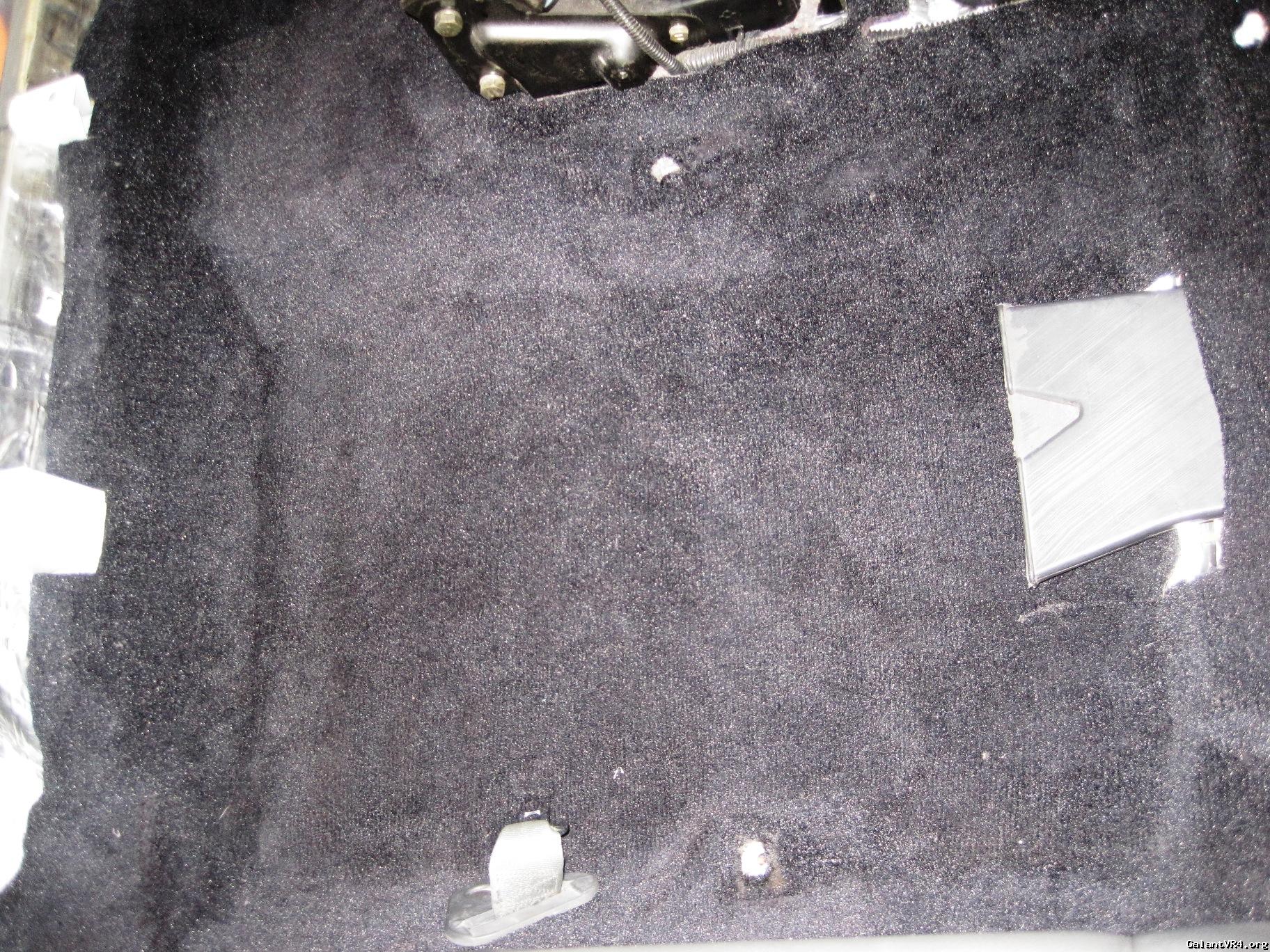

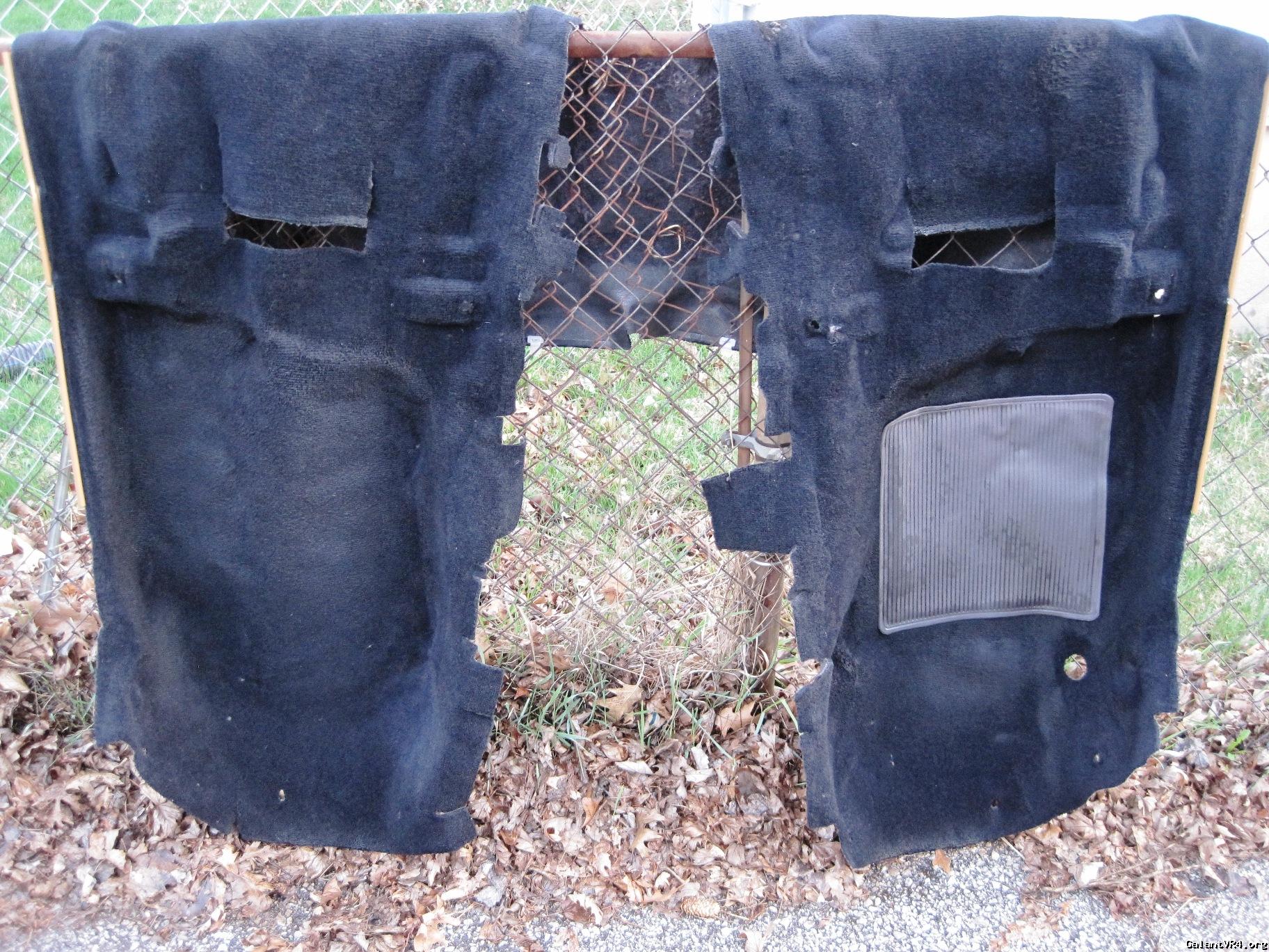

Now for some 75% dry after shots. After removal from the can, I hosed it off until the water ran clear. Total soak time was 2.5 hours.

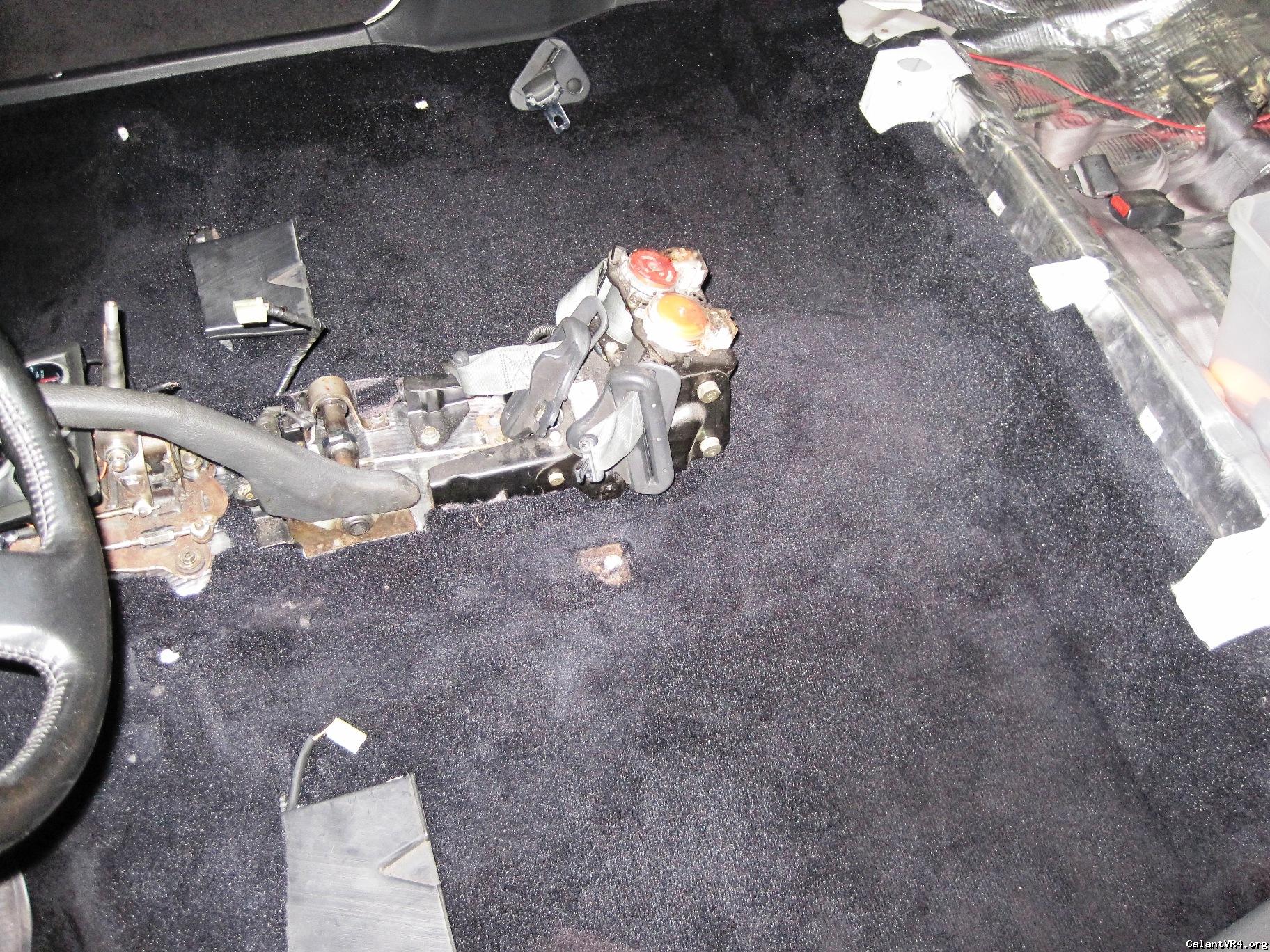

Yep.
As of right now (still damp) it is a very consistent color black. Even the rubber is darker.
Can't wait until tomorrow to install it.

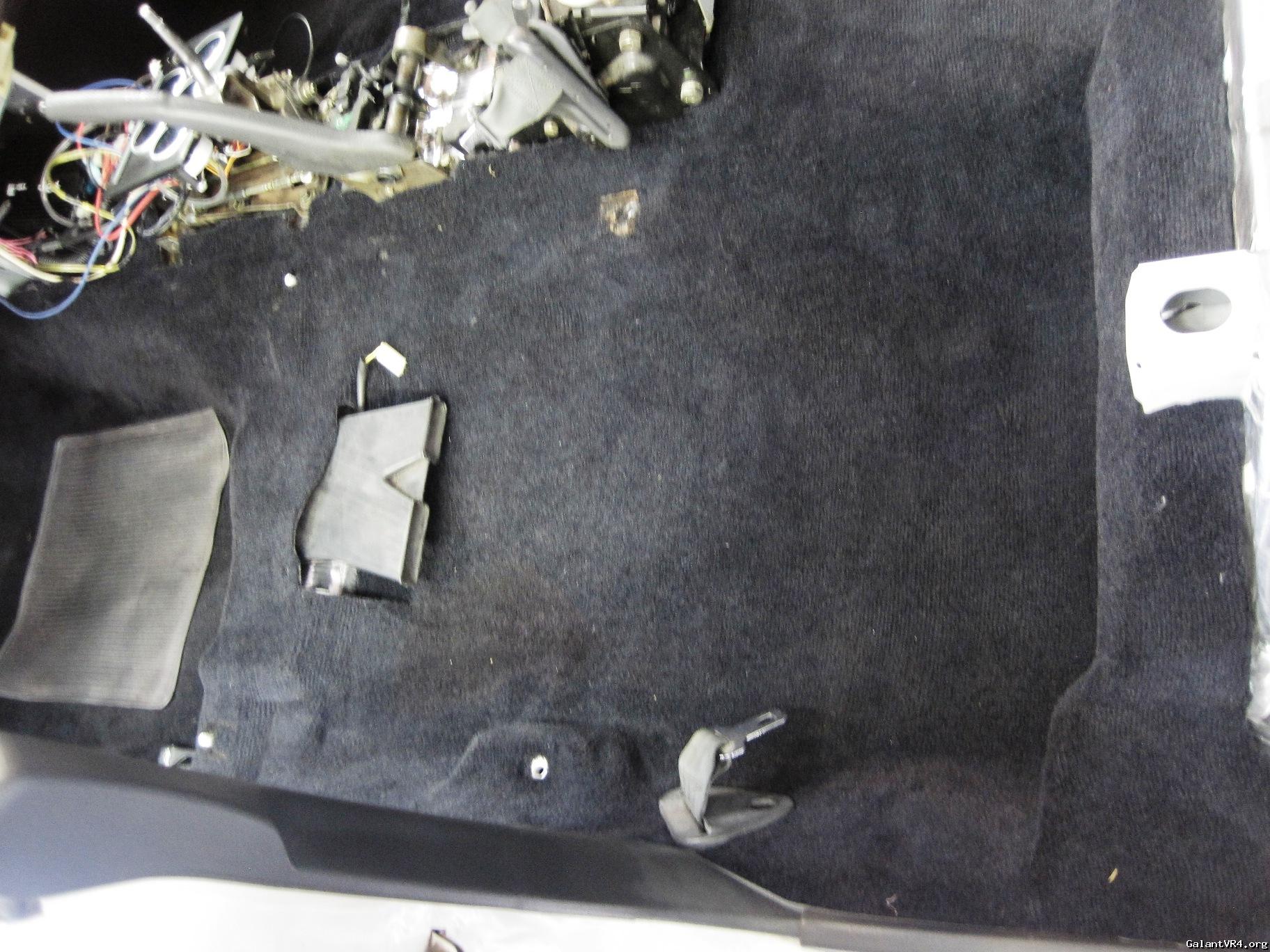

Seats were oiled and bagged yesterday while the carpet was soaking. They come out tomorrow.
Yes Wop, the carpet had never been removed. It was way passed bad.

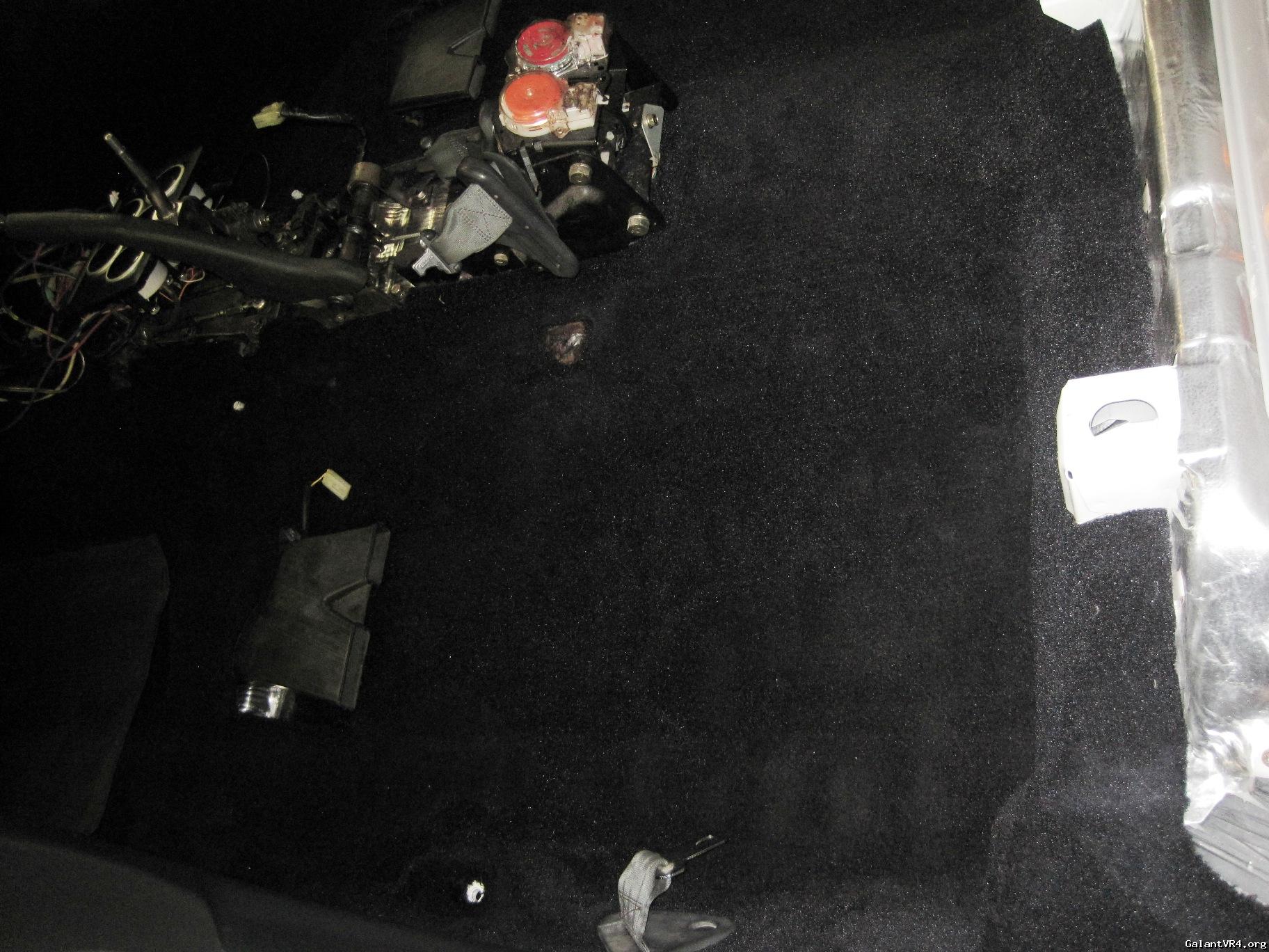

The interior is all back in except the seats. Will re-fit the drive shaft tonight if I get some energy up.

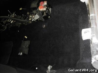

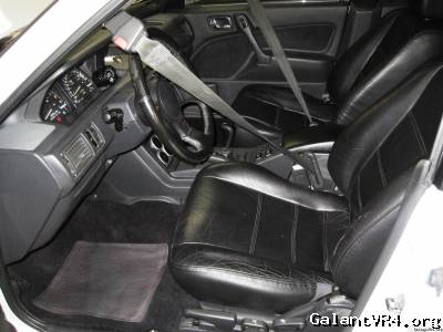

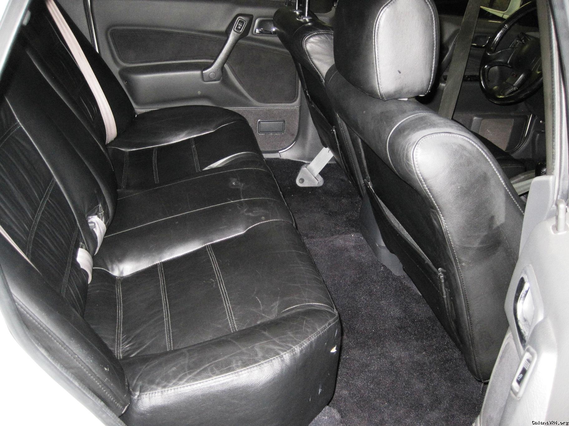

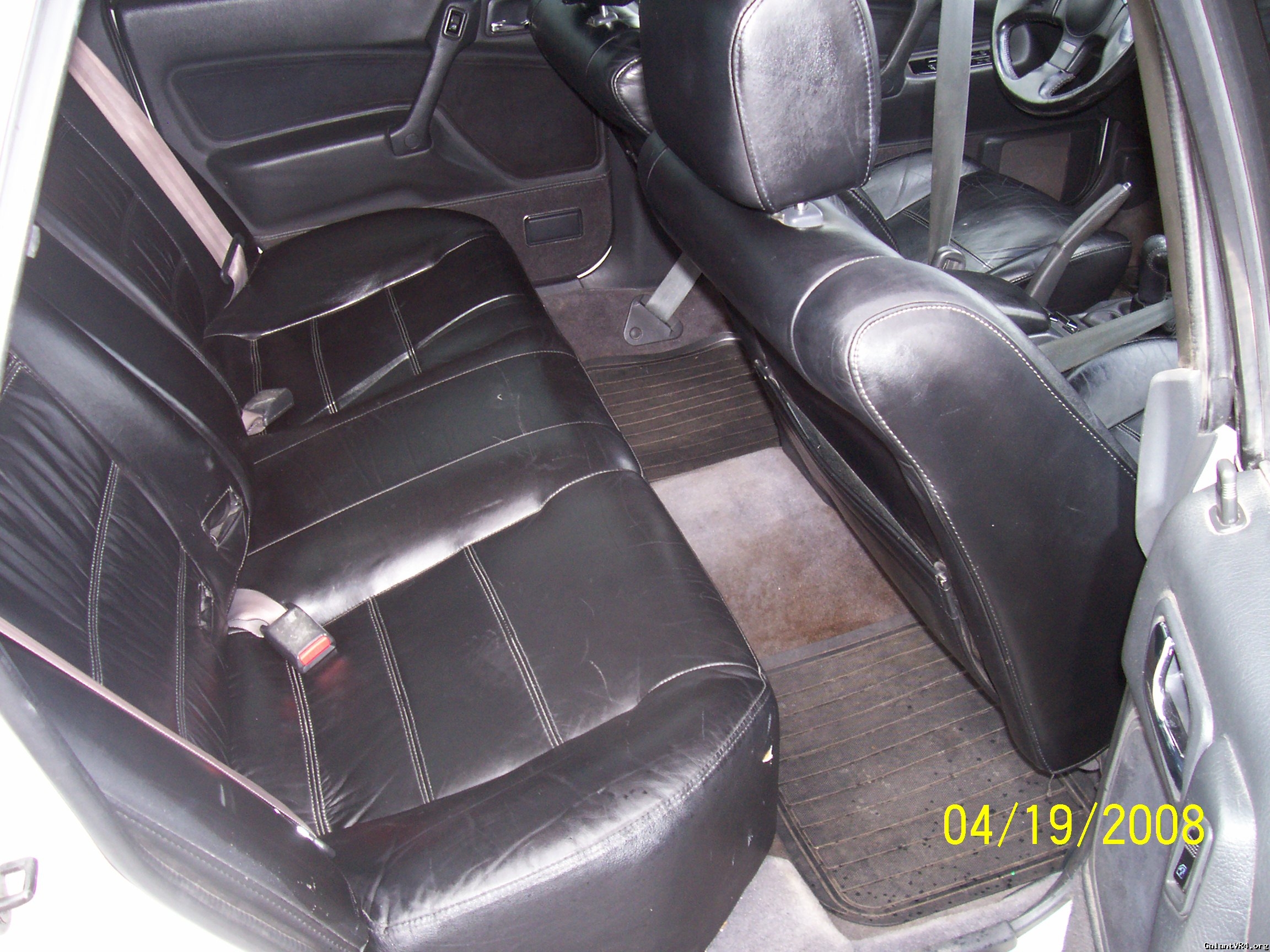

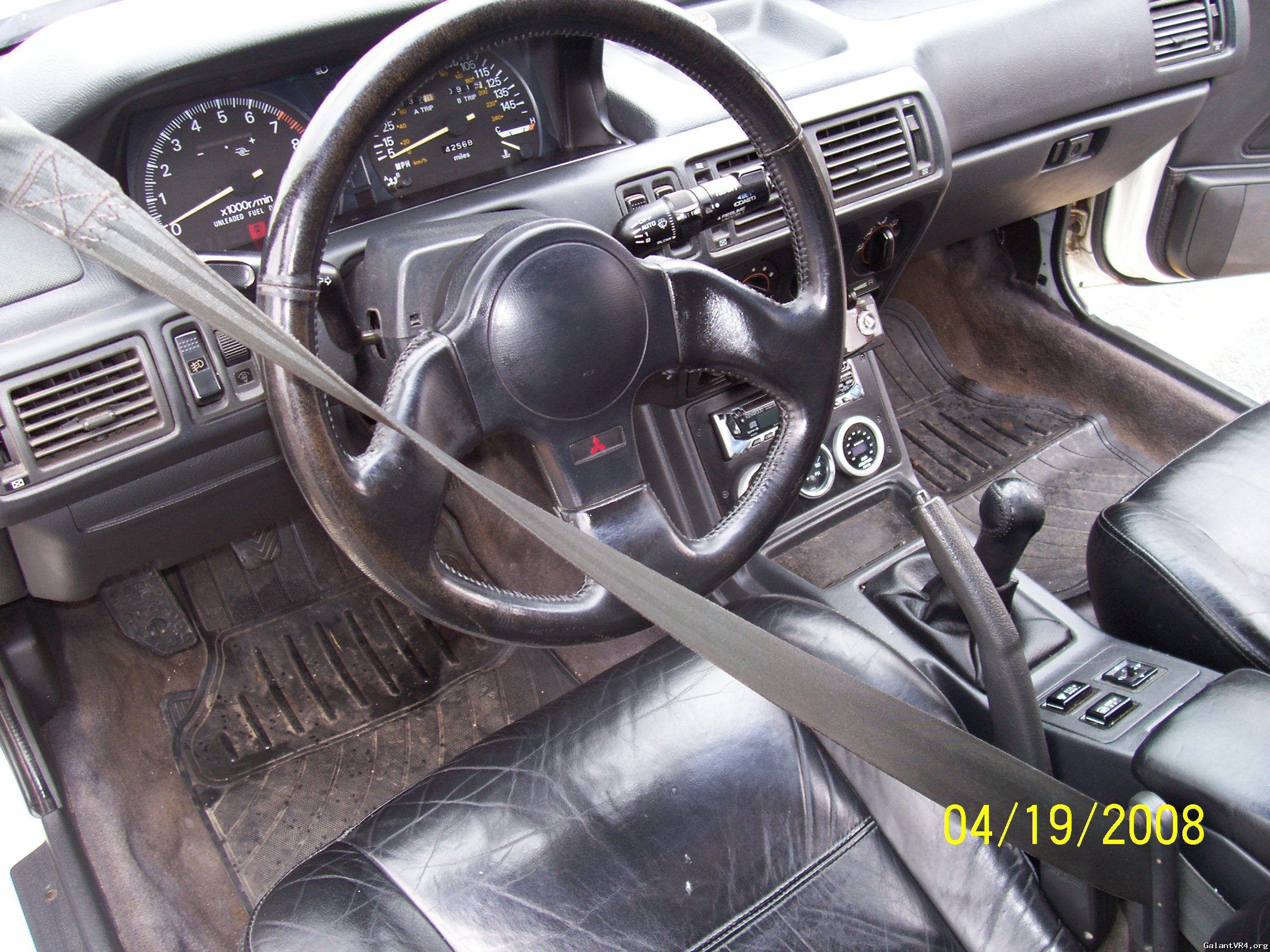

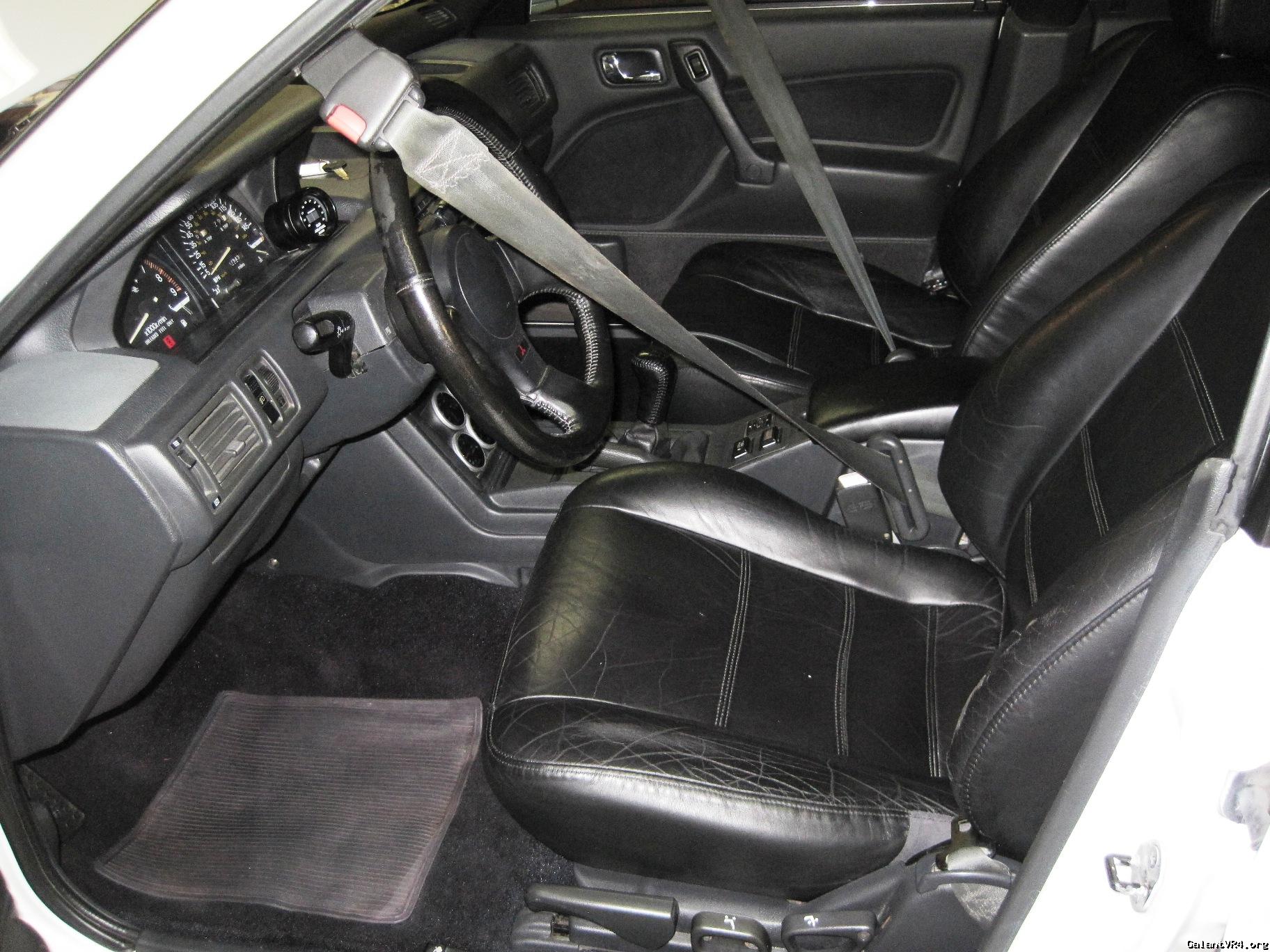

OK guys and gals. Getting down to the short strokes with the interior. Don't know if I can do too much more to a 20 year old without replacing with new. I still want to spend some more time on the glue residue on the passenger side dash that has been there since before I bought it but for now, I will turn my focus to installing the drive shaft and doing the fluid changes and then off to the painter for the final touch-up and showroom finish.

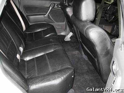

The Leatherque stuff really did not do as much as I hoped. My seats really weren't that bad and black leather does not show dirt like a lighter color however, the rags did get very dirty and the water was nasty and I got new water after each seat part.
Here is a couple of pics from 2008 directly from my "members rides" post (will have to swap these out soon) and now from today. Click on them to blow them up to see the full effect. The camera really has a hard time really showing how well this came out.

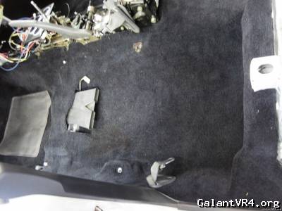

OK, now for the rest of the pics. Some with flash, some without.
