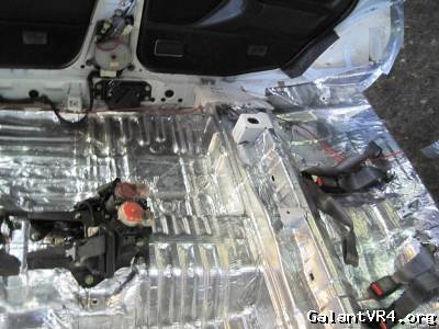

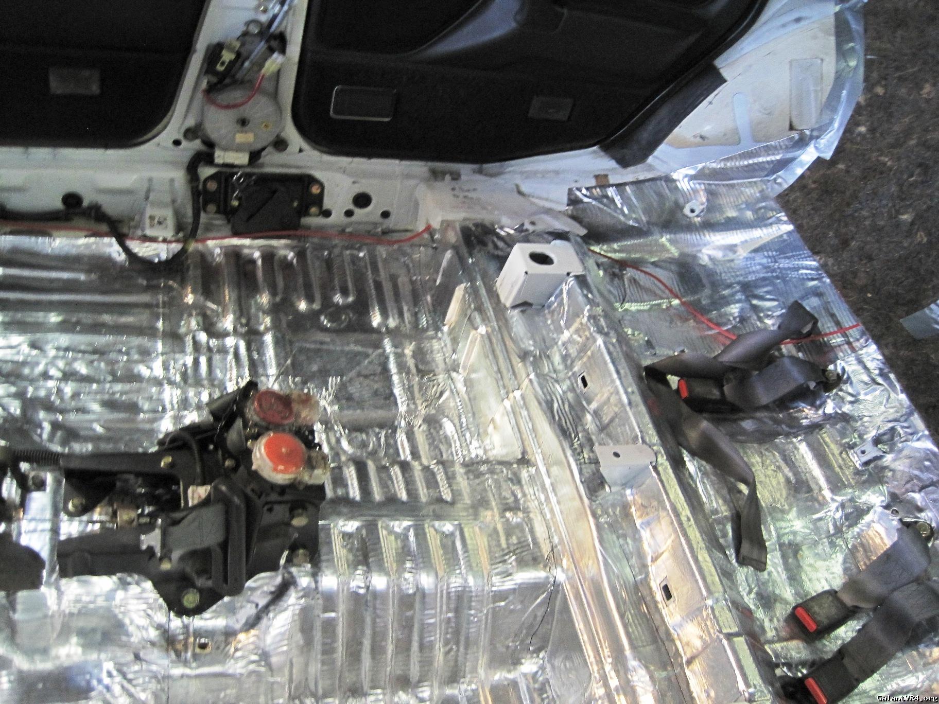

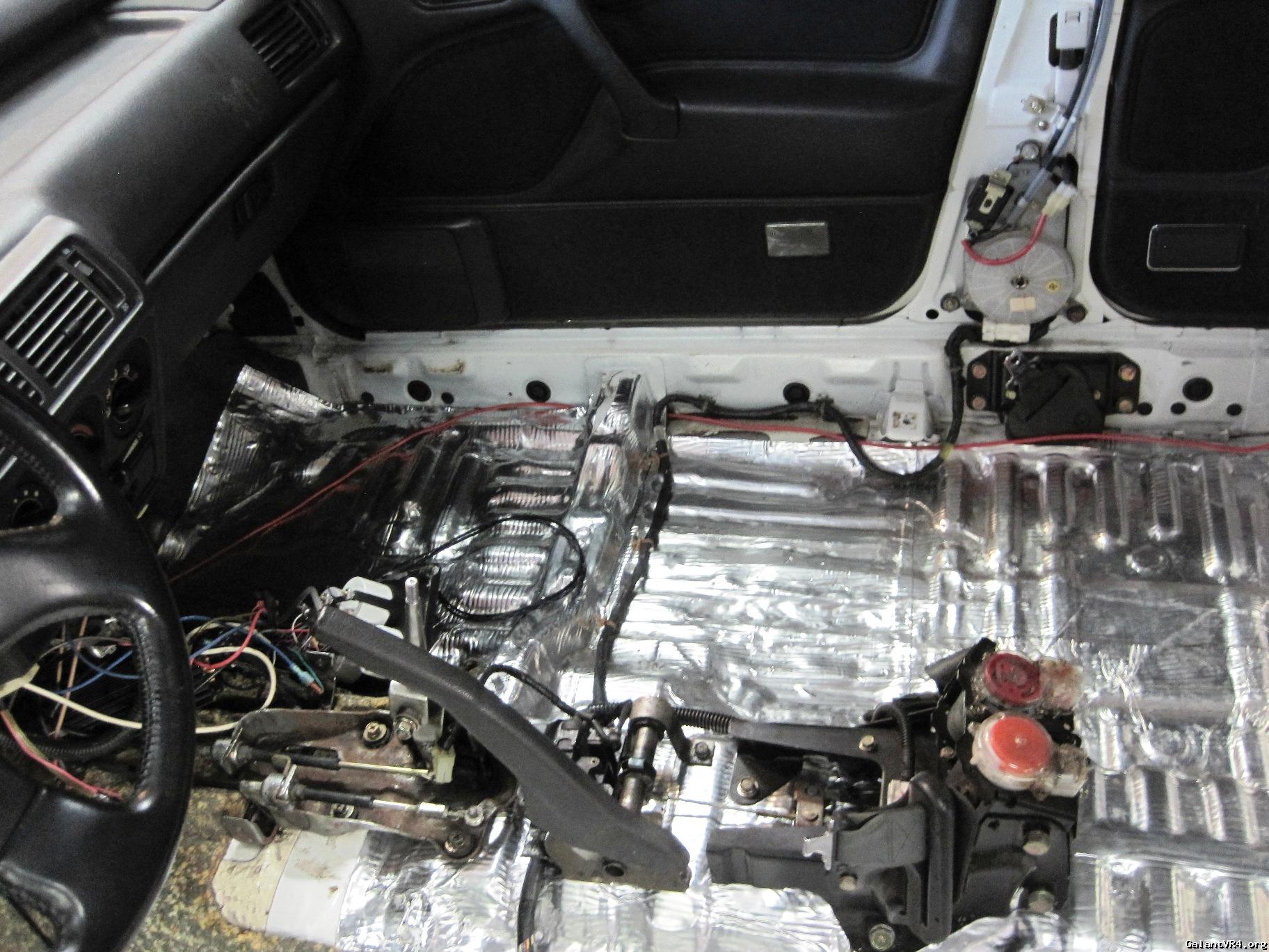

Here are some pics of the floor pan. It is not perfect as I would have had to gut all the wiring also and I was not willing to do that. This is a labor intensive job. you will have a good upper body workout molding this stuff to the contours of the pan.

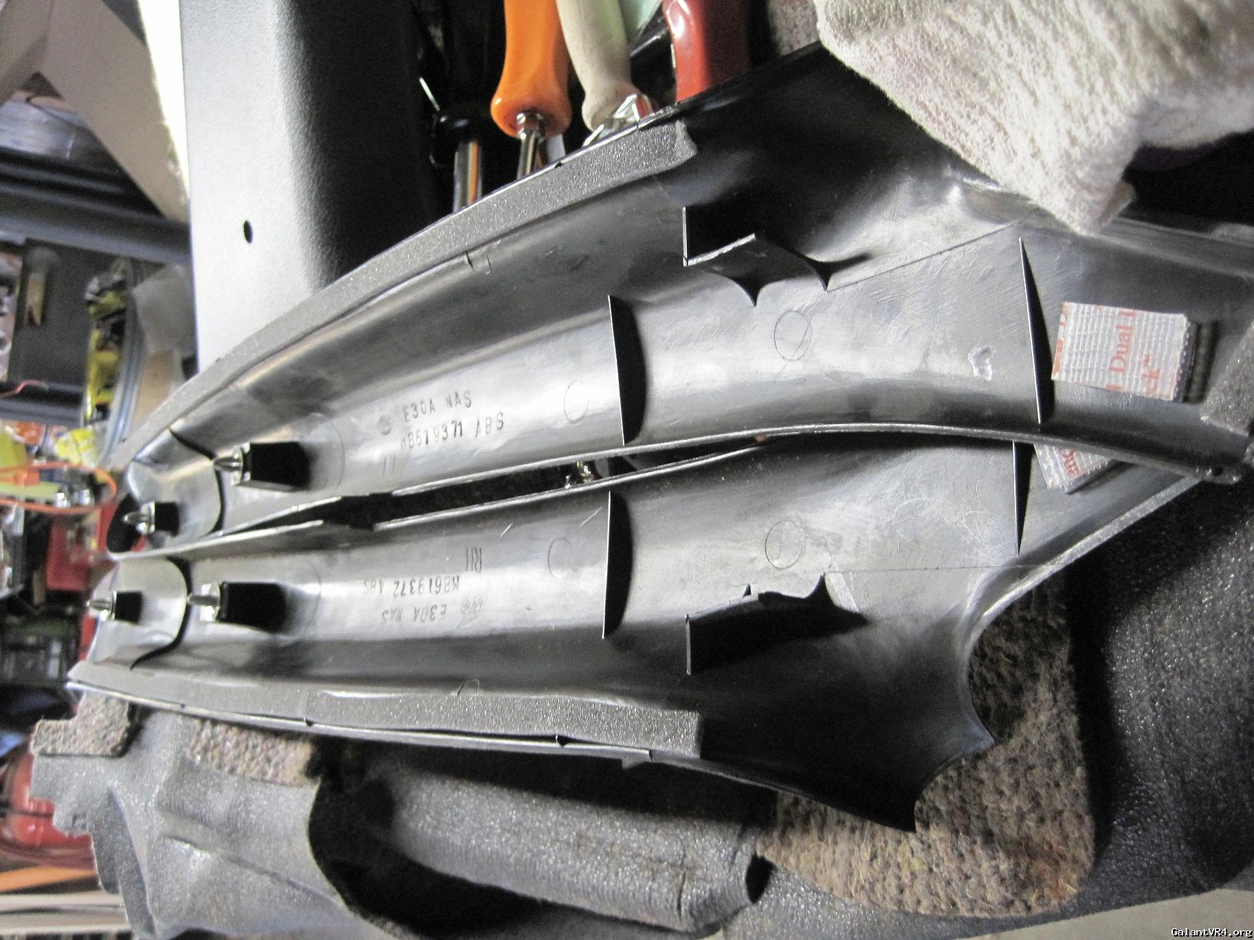

I also trimmed every trim piece with foam tape to reduce plastic-on-plastic squeeks.
Here is an example.
