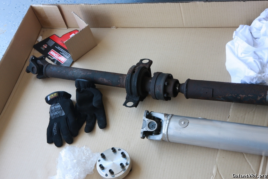

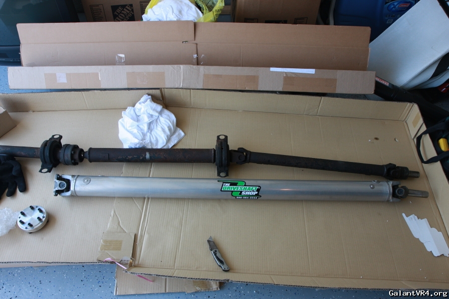

Was too lazy to rebuild my drive shaft so I ordered one from DSS yesterday. Look what the UPS man dropped off. Real pretty.

Looks nice! Does it connect to part of the factory shaft, or is there another piece?

^^looks to me that the circle piece in the bottom corner hooks to the d/s on one side and takes the place of the lobro on the other.

Just looks like the bolt pattern is larger on the aluminum (?) circle...and are there studs on the backside to accept the new DS...maybe I'm missing something; just wondering.

The driveshaft actually has an adapter which attaches to the lobro joint. I took a better pic of where it would attach to. Paid 799 plus shipping. It weighs 15 lbs.

Big reason for going to the aluminum shaft is to help with drive train shock. Steel does not twist as much as aluminum. So with the aluminum shaft there is less shock placed on the drive train because the shaft is twisting. The shaft then springs back. It also a lot lighter. Stock first two steel parts are around 22lbs. The aluminum is around 12lbs

steel twists more than aluminum. aluminum has no flex, which is why your springs are always made out of steel.
the reason for the shaft is to reduce rotational weight. it works the same way as an aluminum flywheel. it also saves considerable weight off the car.

I wouldn't say aluminum has 'no' flex, but when it does, you risk the material cracking. However, being it's a cylinder, it's doubtful. I think the weak link is (and should be) the u-joints, although better have a loop should the shaft come off in front (yikes).
Nice looking piece. A little pricey, of course, but once you factor in the time, sometimes it's worth paying up front. Just curious why they didn't also make the front piece, but it's good to eliminate one of the flex points.
