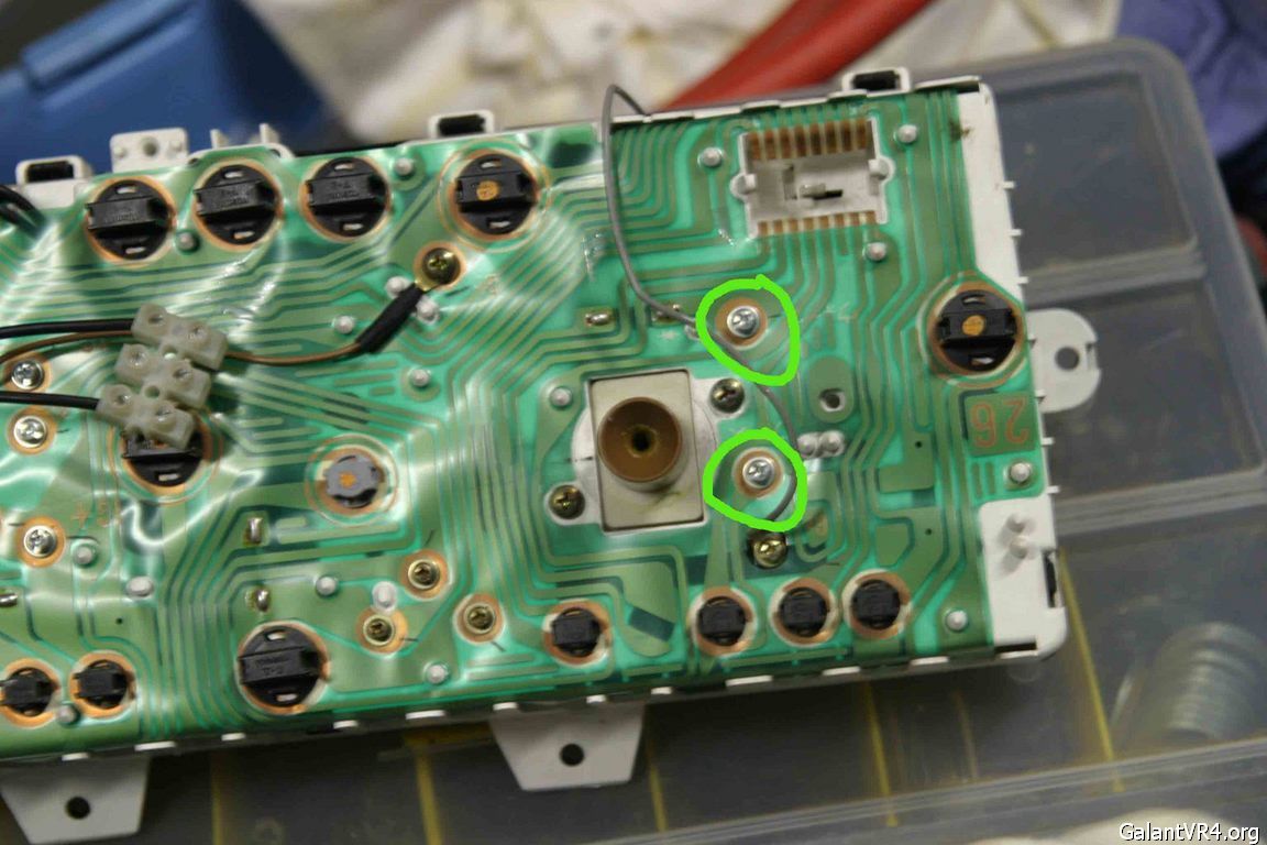

The following text passage is "borrowed" from Rob323 over in aus. (thanks Rob!)
Below is a photo of the back of the instrument cluster on a late model J spec. I'm pretty sure that if you remove the top screw circled in green, that you remove both the speed cut and the 105 kph chime but still pass the speed signal to the ecu. If you remove the bottom screw circled in green, you still get rid of the speed cut, but still have the chime and still pass the speed signal to the ecu. If you disconnect the grey wire, you disconnect EVERYTHING including the speed signal to the ecu.
so is there a negative effect of not having a speed signal to the ECU? or does it make the ECU think the car isnt moving at all? i'm not using vr4 instrument cluster, so i guess i have none of intelligent features of the vr4 cluster :p
Ok, so that doesn`t harms the ECU if i do that? I have Greddy E-manage support tool to modifying to the ECU and turbosmart bleed valve to controlling the bar/psi. So i need more speed be cause it`s cut the speed to 4th gear..
no, it wont damage the ECU at all. but shouldn't e-manage be able to by pass the speed limiter?
I don`t know, may be.. but that speed limit sensor can`t remove or tuning pass the e-manage, so is it possible to fix or change the value for ohms to some kind of potentiometer? I heard that for somewhere...
