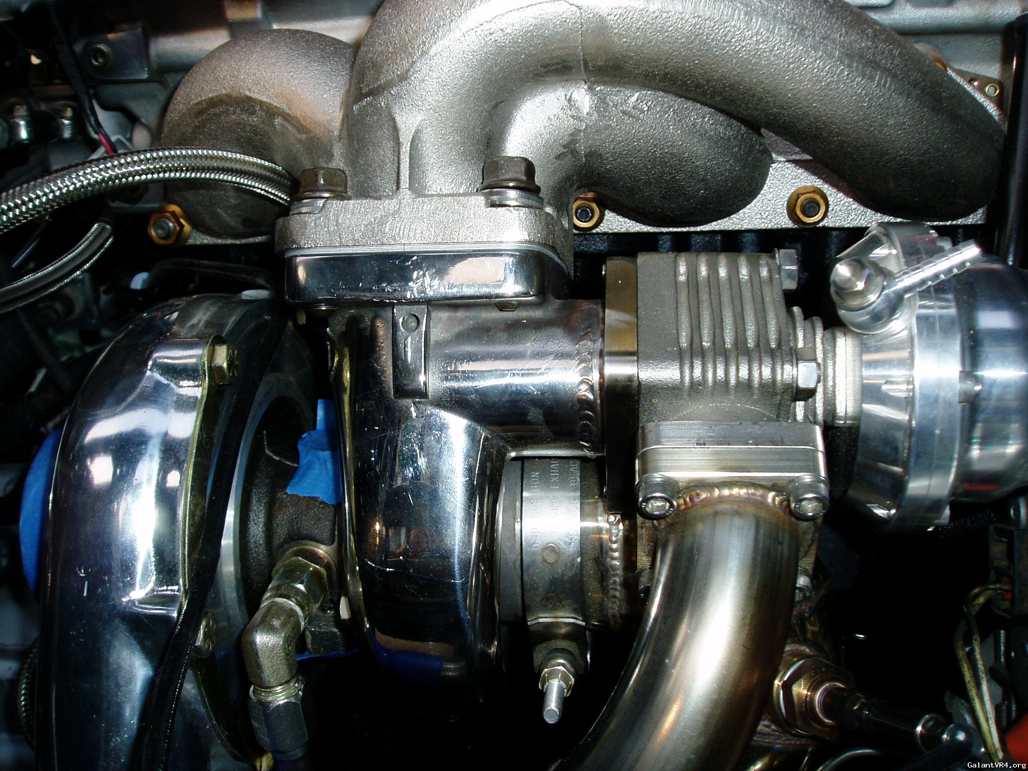

Very nice looking setup. Everytime I see that FP exhaust housing, It makes me wish I would've gotten one of those instead of my o2 wastegate mounted SCM. It's gonna look sick when you're done.
P.S.- Very similar build to the one I'm hoping to get done over the next couple weeks.
Justin
Quoting 3rdstrikedsm:
Looks good, What coupler is that off the turbo? I need that same one.
That's a 2"-2.5" 90* coupler from ETS. Call me if you need one and I'll get you setup.
Thanks for the kind words guys! This project has taken so long that a couple times I thought I'd never finish it. Without you guys as motivation I probably would have given up. I pretty much missed the racing this season but I should be out there in full force next year.

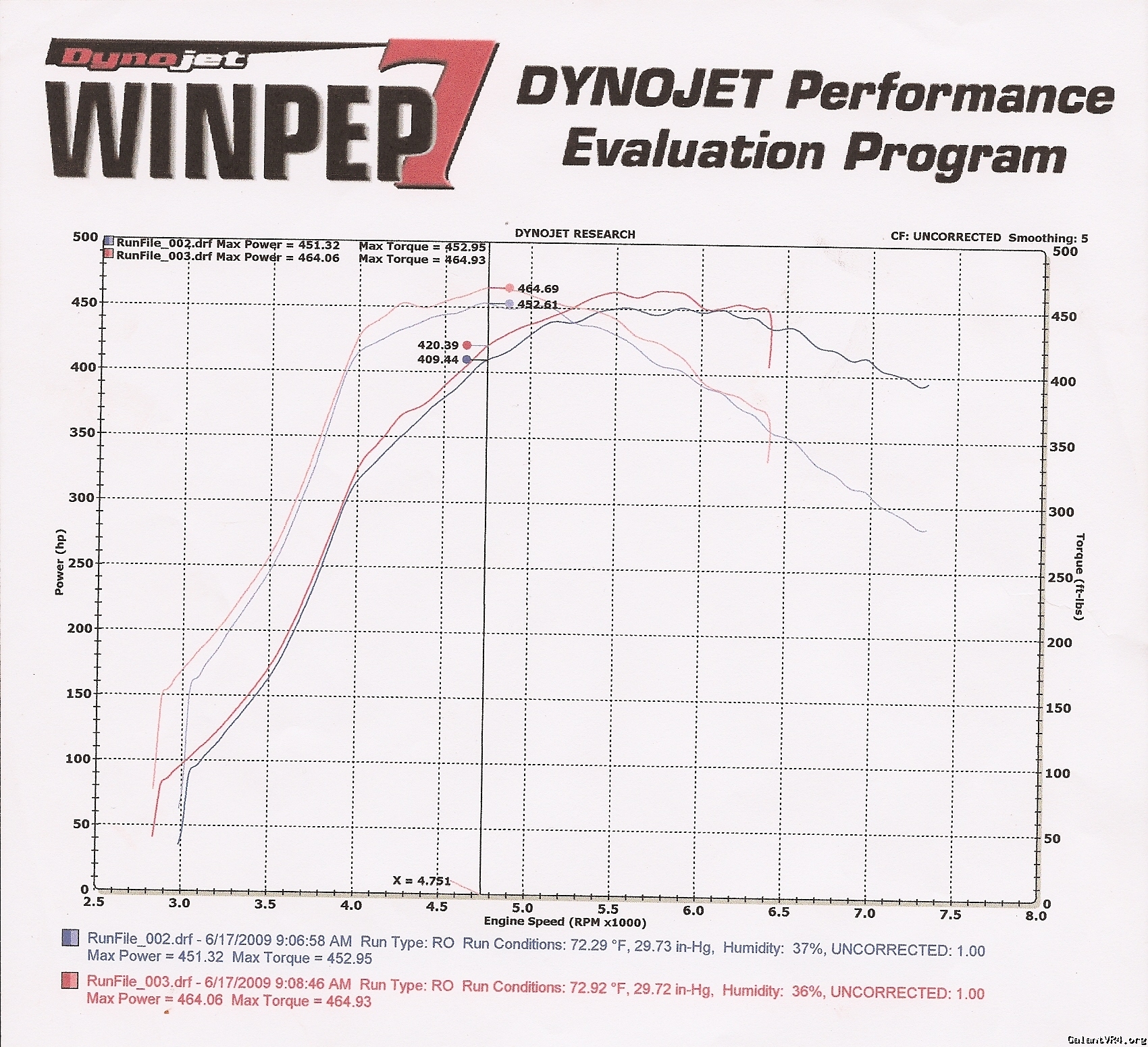

Finally some dyno #'s from this setup...
Made 464awhp, 464tq @ 25psi. This setup will make well over 500 if pushed to 30psi+. I was happy with the results so we called it a day. Numbers are uncorrected, corrected with 1.01 factor it made 469/470. I'm going to run it like this for a while before I change things.
Wow man great numbers. I bet you were surprised when it made such good numbers.. I wish I had the time and $$$ to do that to mine,, /ubbthreads/images/graemlins/smile.gif
This was on an awd dynojet.
I'll post the graph when I get back to town.
I should make it to the track next weekend...
nice numbers jesse! Nice to know all my money was going to a good cause lol!! keep it up playa! Soon enough ill be on my way to DSG for some numberz.
Thanks guys! I'm pretty happy with the car making 400ft/lbs before 4000rpm /ubbthreads/images/graemlins/smile.gif I know there's a lot left and guys have made a lot more with this turbo but I'm not gonna get greedy till I at least get some passes at the track and eventually get a twin plate clutch. It's on an ACT2900/Sprung street disc right now which is good for about 510ft/lbs at the flywheel and I'm pretty sure I exceeded that yesterday. Many thanks to everybody that helped make this possible, mainly all my customers, also: ACT, FIC, ECMTuning, Whiteline and GoFastBits. I'm going to be writing a full build write-up very soon and I'll definitely post it here!

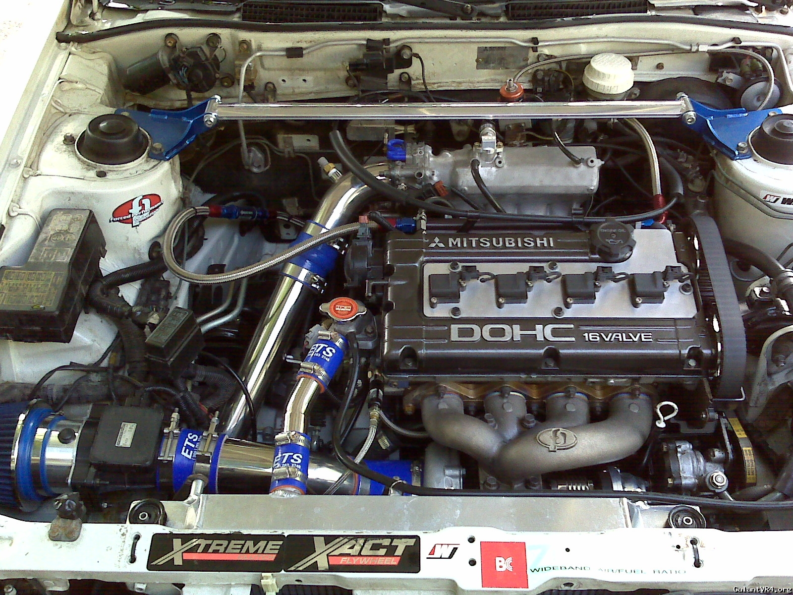

Meanwhile... you guys can critique my engine bay!

Good curve. Only problem I see with your engine bay is that you have exhaust fumes on that white paint!
LOL.. Every white VR4 I have seen has the black stains on the paint.
