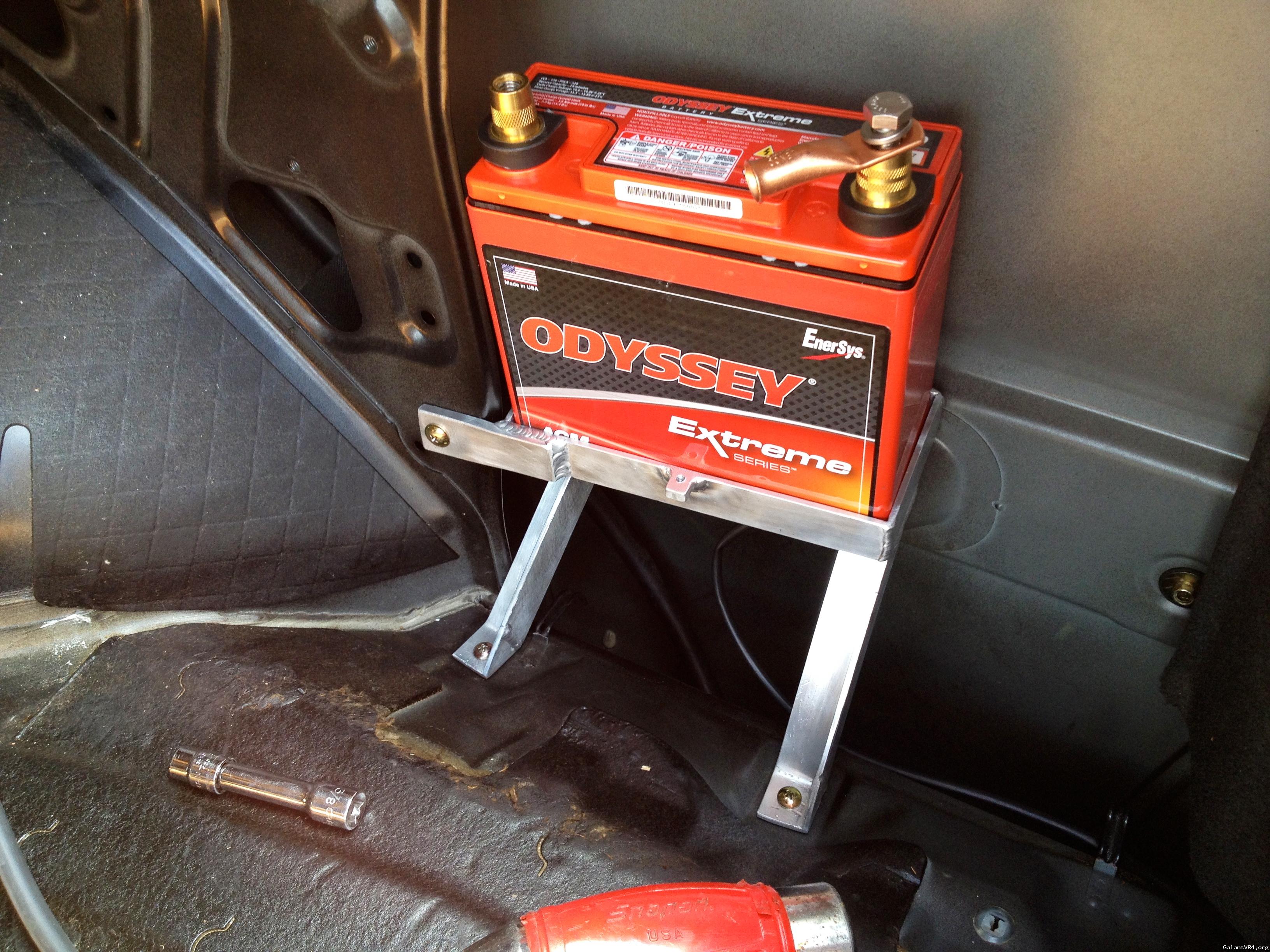

Your right. Thats what I was thinking of, but both JNZ and STM carry the JMF battery mounting kit. Nice enough units but if your going to spend money to relocate your battery or buy a kit you may as well move it to the trunk. This is what I did courtesy of EMX5636.

I do like the trunk location. I don't agree that if your moving the battery it should go there though. If you race, that setup is completely wrong and won't pass tech. I know EMX has gotten lucky with that in the past.
Anyways, that's why I changed my plans. I didn't want to drill a hole for a kill switch

It is completely wrong w/ respect to technical inspection only -its absolutely right if your daily driving like myself and wish to clean the engine bay up while maintaining the stock trunk interior side panels. You wouldn't even know it was there. On the other hand, the passenger rear is the lightest corner of the car so where my battery is situated is the smart choice for me. Sure its missing a battery box and kill switch but I'm not racing so its not necessary. If I were, then that corner of the trunk is exactly where I'd stick it.

Just to clarify, I don't intend anyone who has (or might buy) one of my truck battery mounts try to get through tech illegally. Unfortunately the rules (even though most batteries built today do not need to be vented to the outside of the car) are there for a reason. My solution was for space/look and as pot mentioned, the best place to put it weight wise IMHO. Yes it has gotten through tech on occasion, but I drive my car there, and aside from the turbo which requires a fire jacket, most of the car appears and drives mostly like stock so I don't get looked at much. I plan to have more issues with the roll bar rule than the battery rule, and if it was an event and not a test/tune night, it probably wouldn't pass anyway. The only part of it I don't like is vulnerability to a PS rear collision, but it's no more/less protected than some factory rear mounted batteries.
-end laywer speak. Back to the fun part of moving the horrible location of the stock battery. /ubbthreads/images/graemlins/grin.gif

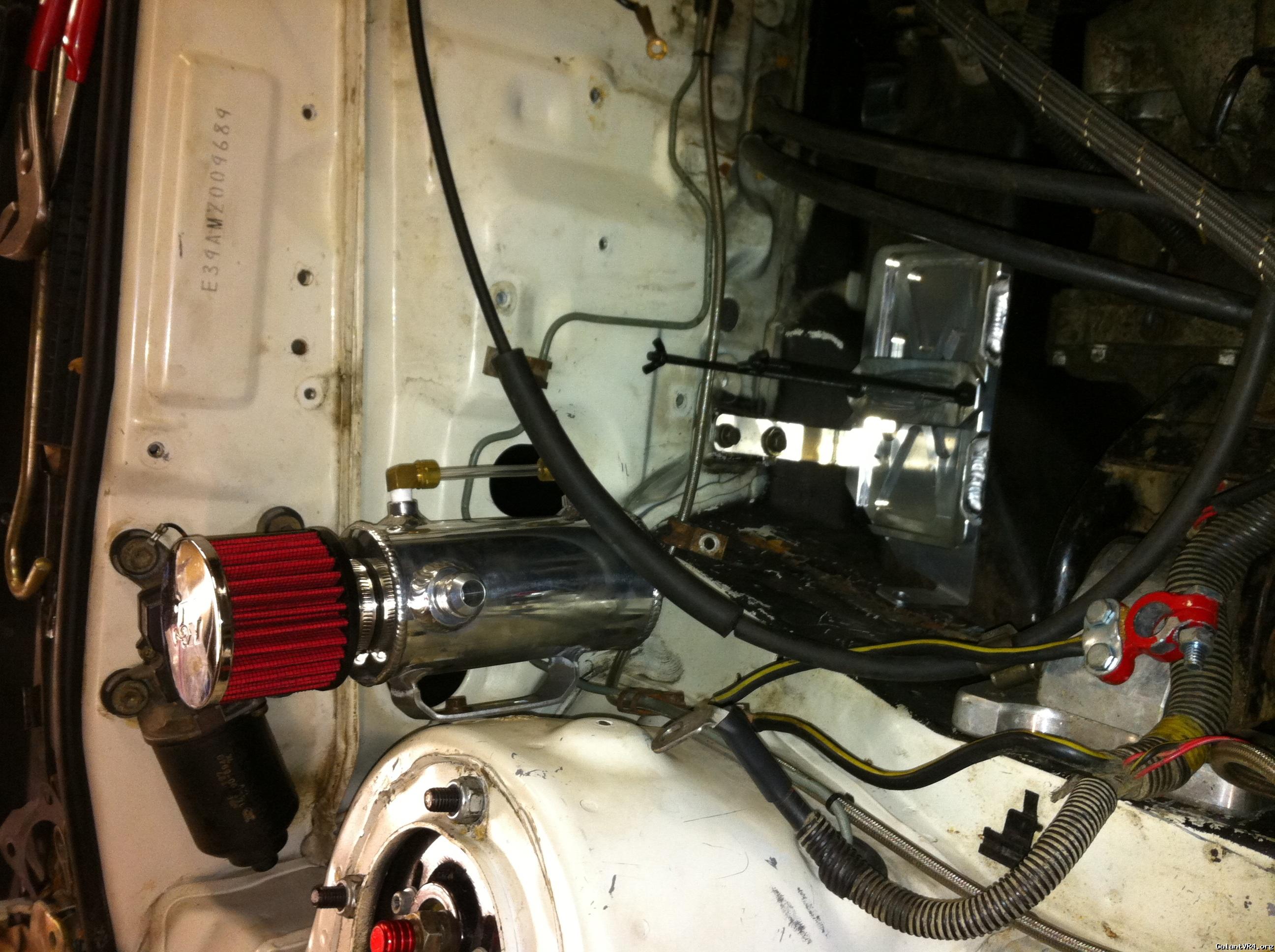

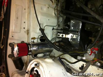

This is what I did when I went to a DSM style intake pipe. Primary advantage was that there was no lengthening or alteration to the the battery cables, and everything still fit under the hood.
Odyssey Battery Relocation In GVR-4

I remember viewing your build post and really dug how your project came out. Thats another sweet spot to install the battery, looks good.

That is a nice clean setup Ed. Looks really good!
Thanks!! I just wanted something that would allow the use of a DSM style intake, and wouldn't require running new leads or grounds. It seems to work pretty well for me.

This is the third one in my car since I relocated the intake and battery. Yes, they are kind of expensive and I hated replacing every one.
First one I cooked was my fault completely. I was on a date and left the headlights on for a few hours. Push started the car (in the rain) and got her, and my car home. Battery held a charge afterwards, but slowly got worse and it got replaced.
Second one was from when the car got painted. The body shop guys liked to leave my doors open with the battery hooked up while they had the car apart doing body work. Got the car back, and the same story as before. Held a charge, but slowly started to die off as time went on.
Third one is still going strong after 3 years. I understand it doesn't have the capacity, or the robustness of a factory battery so I treat it as such. If the car is going to sit for more than a week, I disconnect it and let it sit. Still starts every time and I haven't had to throw it on the charger yet.
I also avoid leaving it in body shops and going on dates while its raining, so that seems to help too.
