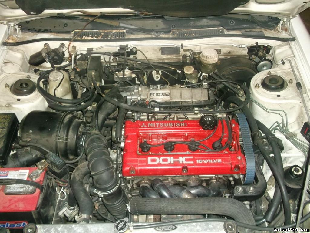

JUST WANT TO WHAT A GVR4 WITH EVO 3 B16G AND 3IN TURBO BACK WITH STOCK FUEL CONTROLL, AND PRETTY MUCH OE ERYTHING ELSE SHOULD BE SPOOLING @3K,3.5K,4K AND 4.5K. RIGHT NOW MY CAR FEELS LIKE A DOG 3K-4.5K. 3K-3.5K BULDS 0-5PSI, 3.5K-4K BUILDS TO 10PSI @ 4.5K ITS AT ABOUT 15 AND THEN PEAKS TO 16-17PSI. IS 17 PSI TOO MUCH TO BE RUNNING? ON STOCK ENGINE?
CURRENTLY ON 1415 I HAVE AFTERMARKERT LIGHT WEIGHT FLYWHEEL,EVO 3B16G AND O2 HOUSING, EBAY HEADERS,BC CAMS NOT SURE WHAT SIZE COMPRESSION WAS 130PSI ACROSS WITH OIL +5-10PSI HEARD MIGHT BE NORMAL WITH OUT ADJUSTIBLE GEARS?? NOT SURE WHAT O.E. SPEC IS EITHER.. O.E. INTAKE, O.E. INTERCOOLER AND PIPING, O.E. FUEL CONTROLL INJECTORS AND PUMP PRETTY MUCH O.E EVERYTHING ELSE.

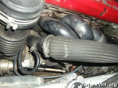

Ebay tubular header and stock/OEM IC are your enemies, especially that exhaust manifold. Cams could also be impacting, most of them are designed to flow better at higher RPM's at the expense of low ( and slow spool ). Cam timing will also affect spool. List goes on.
Compression is compression regardless of cams, ours is 7.8:1.
Stock cams, 2g or EVO3 exhaust manifold, any other IC than stock, and a decent tune should help.

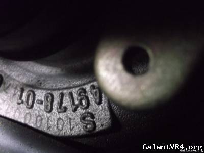

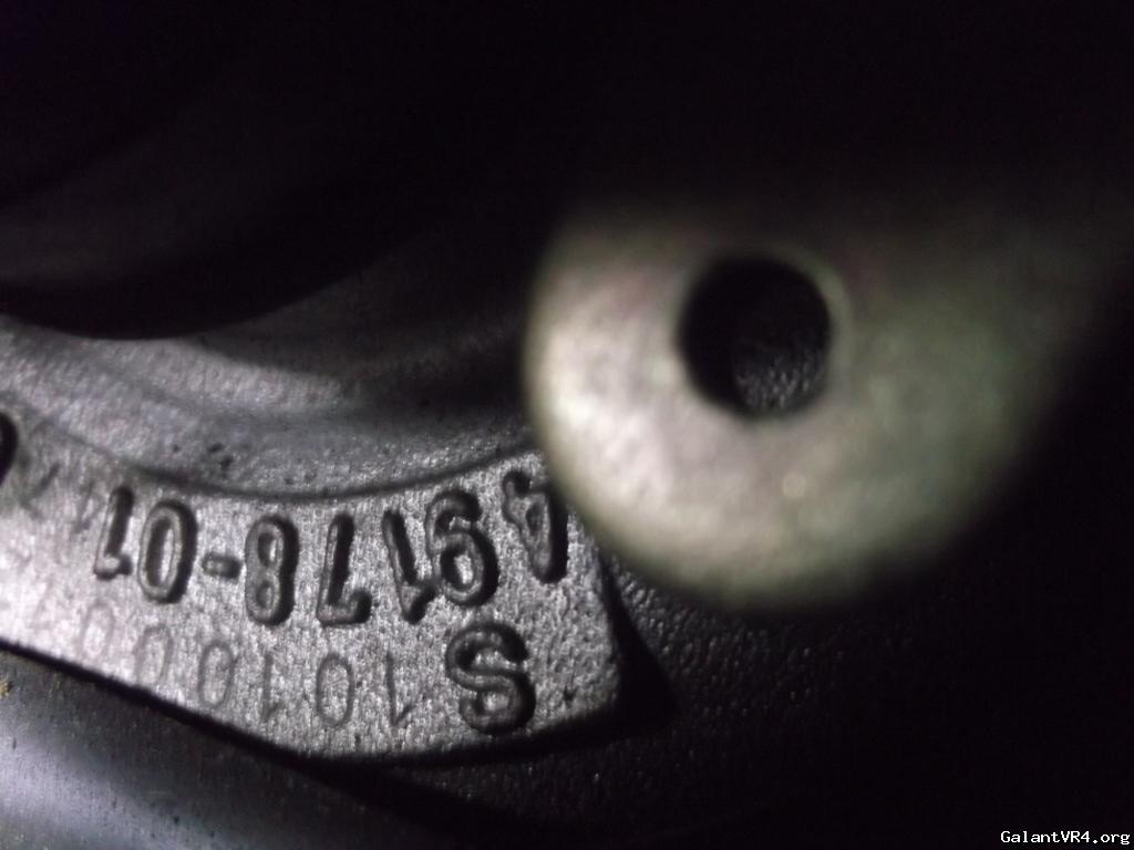

The arm for wastegate is clearly not MHI.
That's not to say it's just that housing though.

so i read some post about about lag on 16gs and the actuaters not being closed or having to shim them or something when there put on a diff turbo, not sure if this is the one that came with 16g or not. but i took it off today and it was a bitch to get the bolt holes to line back up, felt like it had to bow somewhat to thread the damn thing. the c-clip was still there. how do i tell if i have the right actuator or which one i have?? also gonna check for collapsed hoses.

The cheap manifold will cause lag because they don't seal properly. It is likely you have a pre-turbo exhaust leak.
And if you know the car is running too much boost for the current mods, why haven't you turned it down? As far as your planned mods go, the 560cc injectors aren't enough to max out that turbo, a maf-t setup isn't for a 2G MAF, and I would really consider using ECMlink instead of the SAFC.

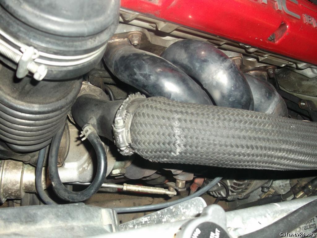

The stock FMIC is more restrictive than you can probably imagine. Seriously. It's basically more of a restriction than an intercooler at all, especially when placed behind the factory, uncut bumper.
Also: That exh mani you have, combined with the stock rubber "hotpipe" to the IC is just asking for trouble. I had one start smouldering after i parked my car once. All that heat with rubber that close can be bad news. Fortunately, i was outside working on the yard and my roommate noticed it. I promptly put the "fire" out, and put a heatshield back on before replacing the hose and driving it again. Didn't really matter, though. Less than six months later some 17 year old drunk/stoned asshole hit it while parked with a hyundai accent and totaled it.
