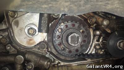

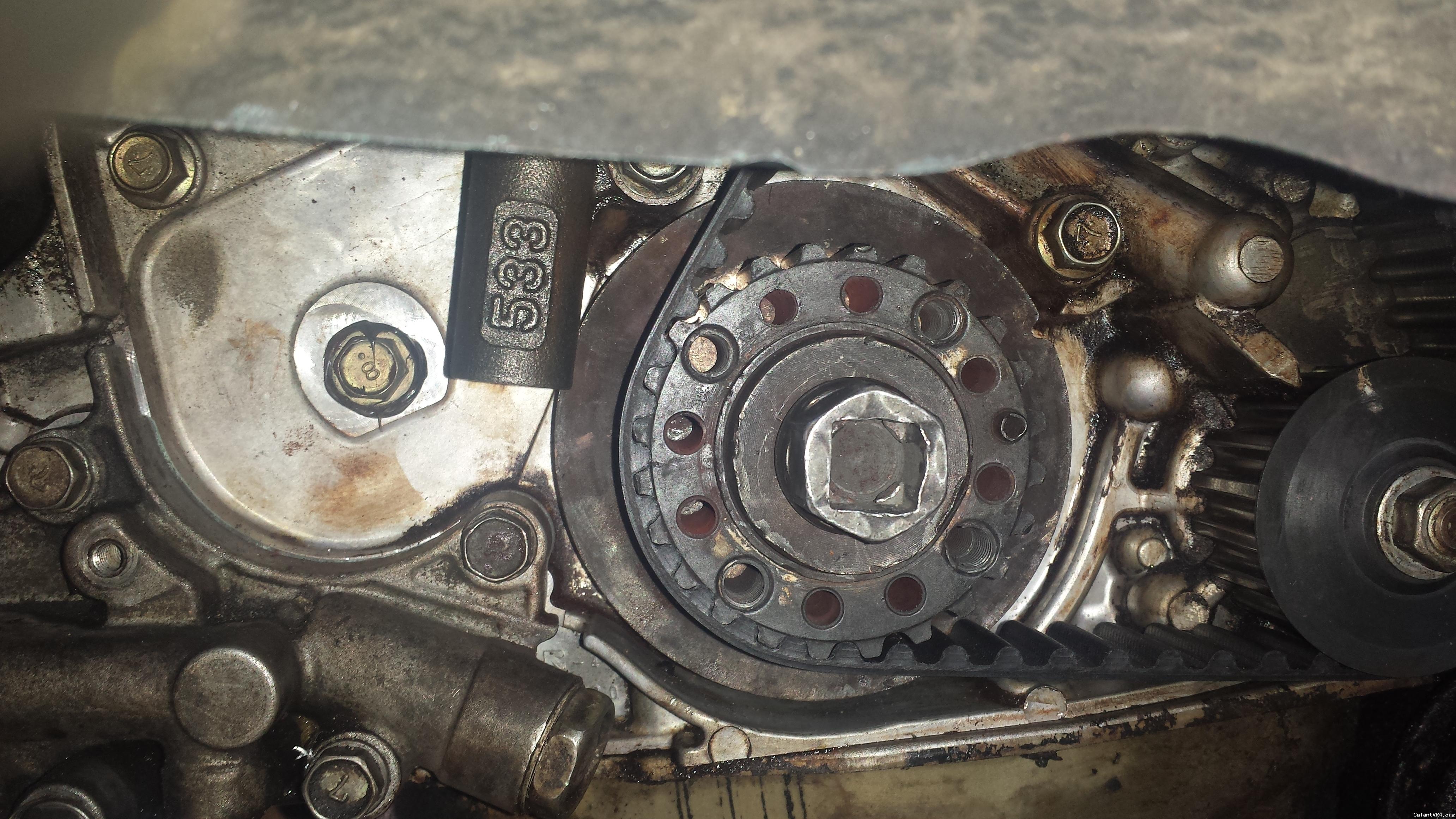

I don't see how a 2.3 would have the timing marks off, unless you had the head or block decked somewhat, since the height is consistent. On a 2.4 you have issues because of the added deck height, different belt, gears, etc.
Wolfpuss
Jul 8, 2014
157
St Louis
Update: Due to my noobness, I installed the crank plate backwards /ubbthreads/images/graemlins/banghead.gif
The car now runs and I am very thankfull that its not something catastrophic.
Thank you all! I owe everyone a beer /ubbthreads/images/graemlins/grin.gif
