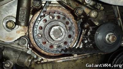

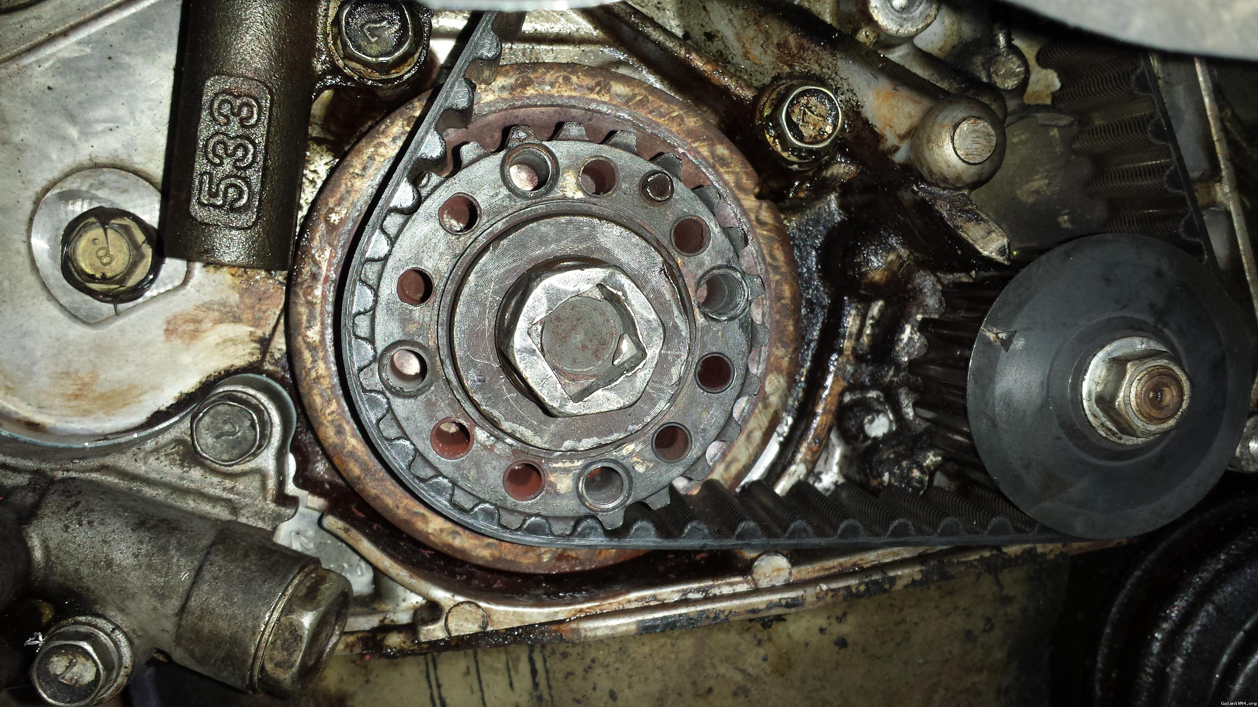

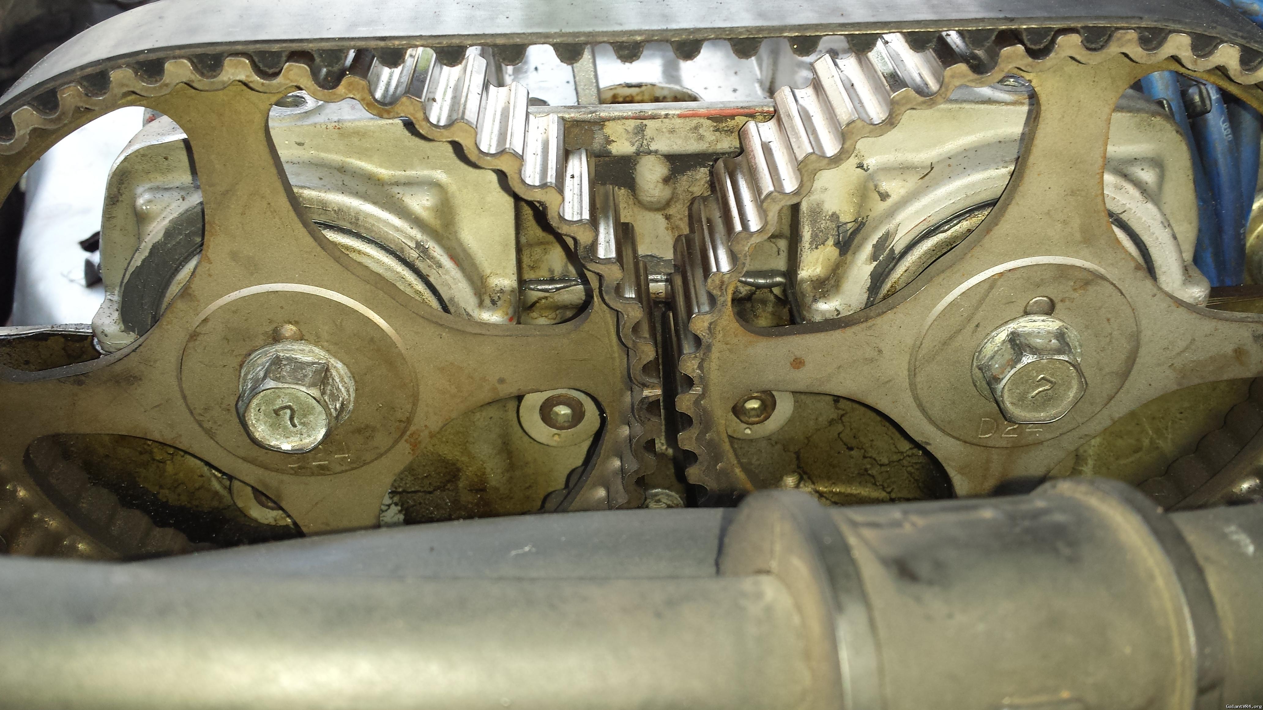

Pictures:

Your timing marks are definitely off, you need to line them up right and see how things rotate after that. Hopefully nothing has been damaged.

You have alignment problems here. Also wipe that hot mess down a little.

You haven't put the crank spacer on backwards have you?
It looks like I can see a ghost image of the balance shaft sprocket on the front of the spacer.
transparentdsm
Jul 27, 2011
3,690
Cherry Hill, NJ
yeah. looks like the plate is on backwards and of course the crank mark is off.
Turbowop - to an extent yes a 2.3 or 2.4 stroker will have the timing marks off a bit and after a closer look the cam marks look fine.
