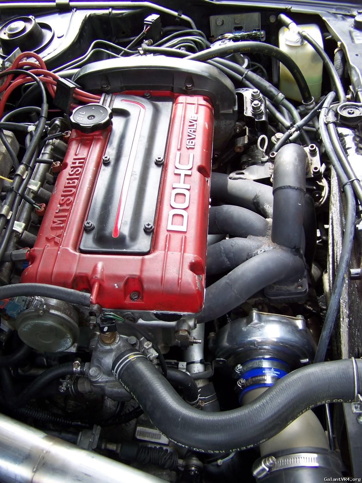

I've had a silicone 45 on mine for years. It's pretty damn close to the manifold and had me a bit worried when I first built the setup, but no issues and it's been a long time.
You can see it pretty well in this pic:

It's been so long since I put together this setup that I can't remember where I purchased my elbow. I wanna say it's 4ply, as I was worried about strength/heat in that area, but I can't remember for sure. And 1051 is just a weekend warrior. That's a lot of weekends since '03 for that elbow to hold up though, so it's done well.

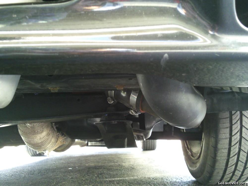

Had a silicone 2" to 2.5" 90 degree elbow on my Talon for years and it work very well in the downward facing poistion.
