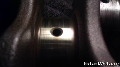

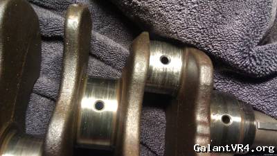

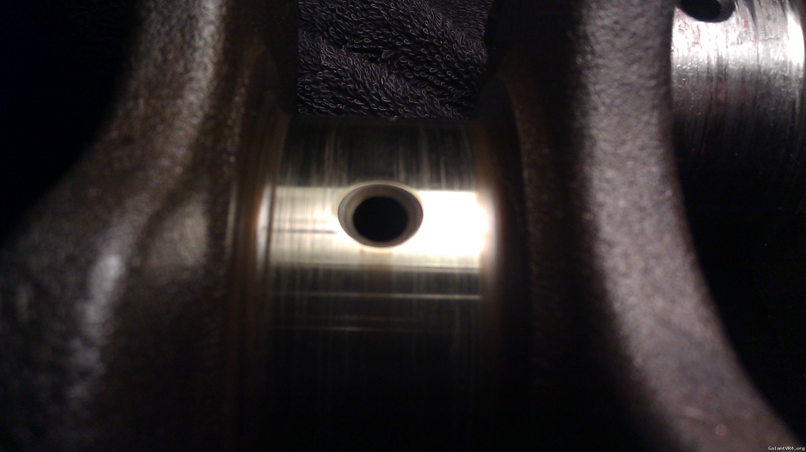

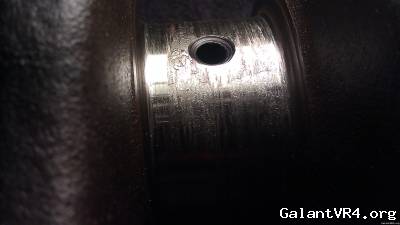

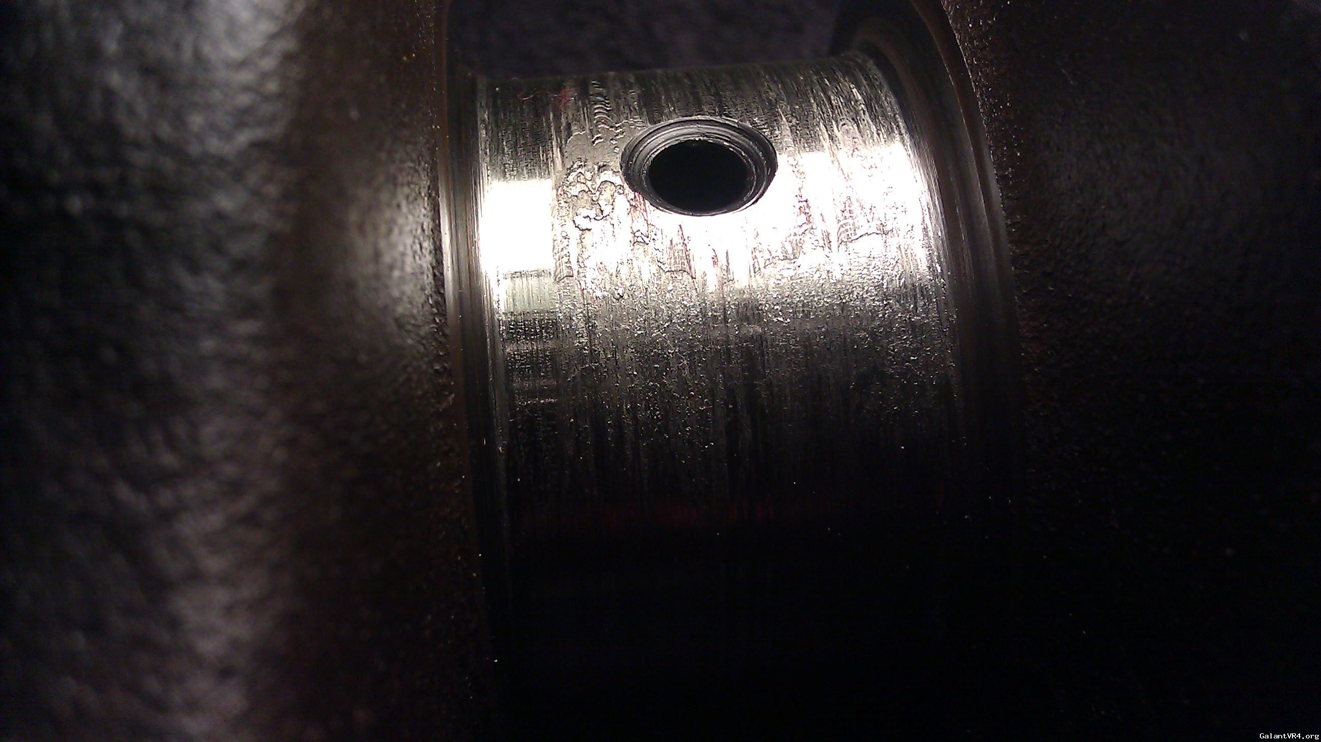

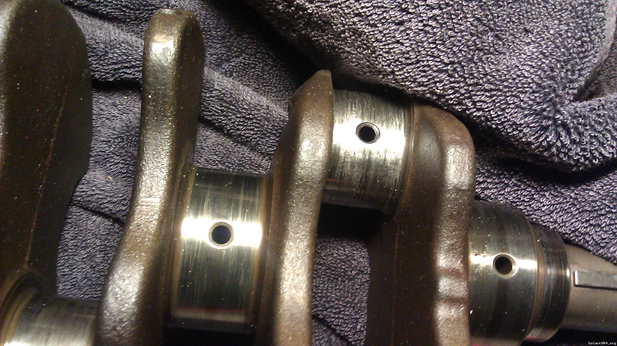

ok i took off the crank shaft and one of the journals is a lil damaged the other ones are smooth ... So my question is this what are my options take it to a machine shop or buy a new Crank i heard somthing about our cranks about getting machined not sure though so tell me what you guys think

I understand that these cranks are nitrated. What that means is that they are ground and then hardened and then polished. I used to rebuild a lot of Porsche engines that had nitrated cranks and never had much success at having them ground locally. I might be in the same shape with my crank, but I haven't measured it yet. No scoring, but I had the #3 main not getting oil for about 400 miles. I'm planning on making the trip to the machine shop tomorrow and will give you an update on what they say.

Correct they are nitrated and it only goes so deep into the crank. When the crack in ground it can take most or all of that hardened layer off. A lot of people have had good luck running cut cranks but for me I would never run one. Used cranks are cheap enough that finding one should be easy and would be worth the piece of mind to me.

Well, I have measured and remeasured and have found that I don't have to have any machine work done, so I can't give the advice of the machine shop! I would check and make sure that your crank doesn't just have the bearing material built up on it. They are hardened and what you see may be the bearing material and could polish out? Just a thought!

now that you mentioned that I have noticed there are some spots that are some what smooth and have a bead like feel. And on other spots it feels like tiny little knife cuts. Glad you mentioned this might take a trip to the machine shop tommorow. That would be awsome if it just needs a polish /ubbthreads/images/graemlins/laugh.gif this is my first time taken a motor apart so this is all new to me
