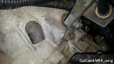

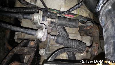

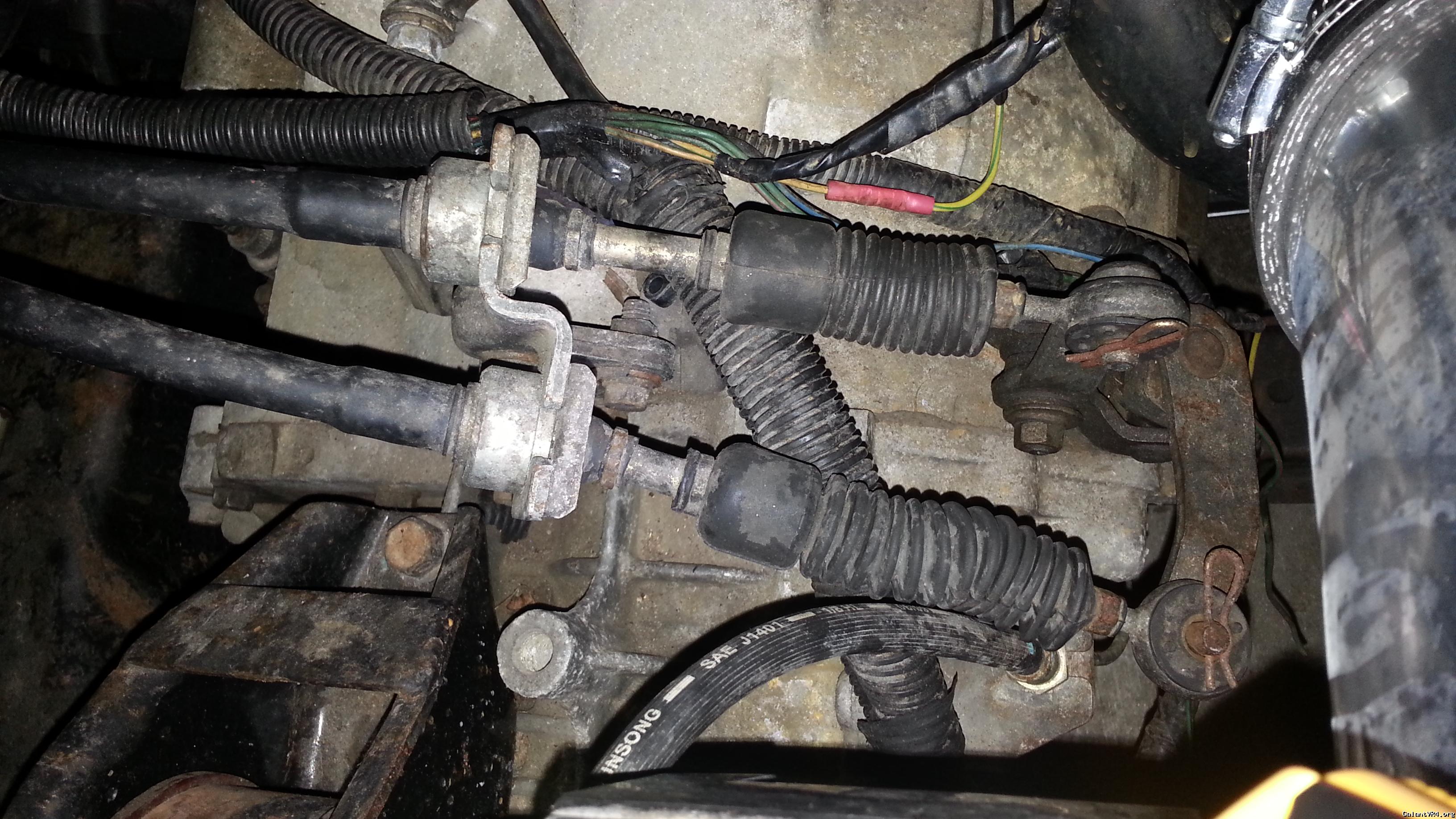

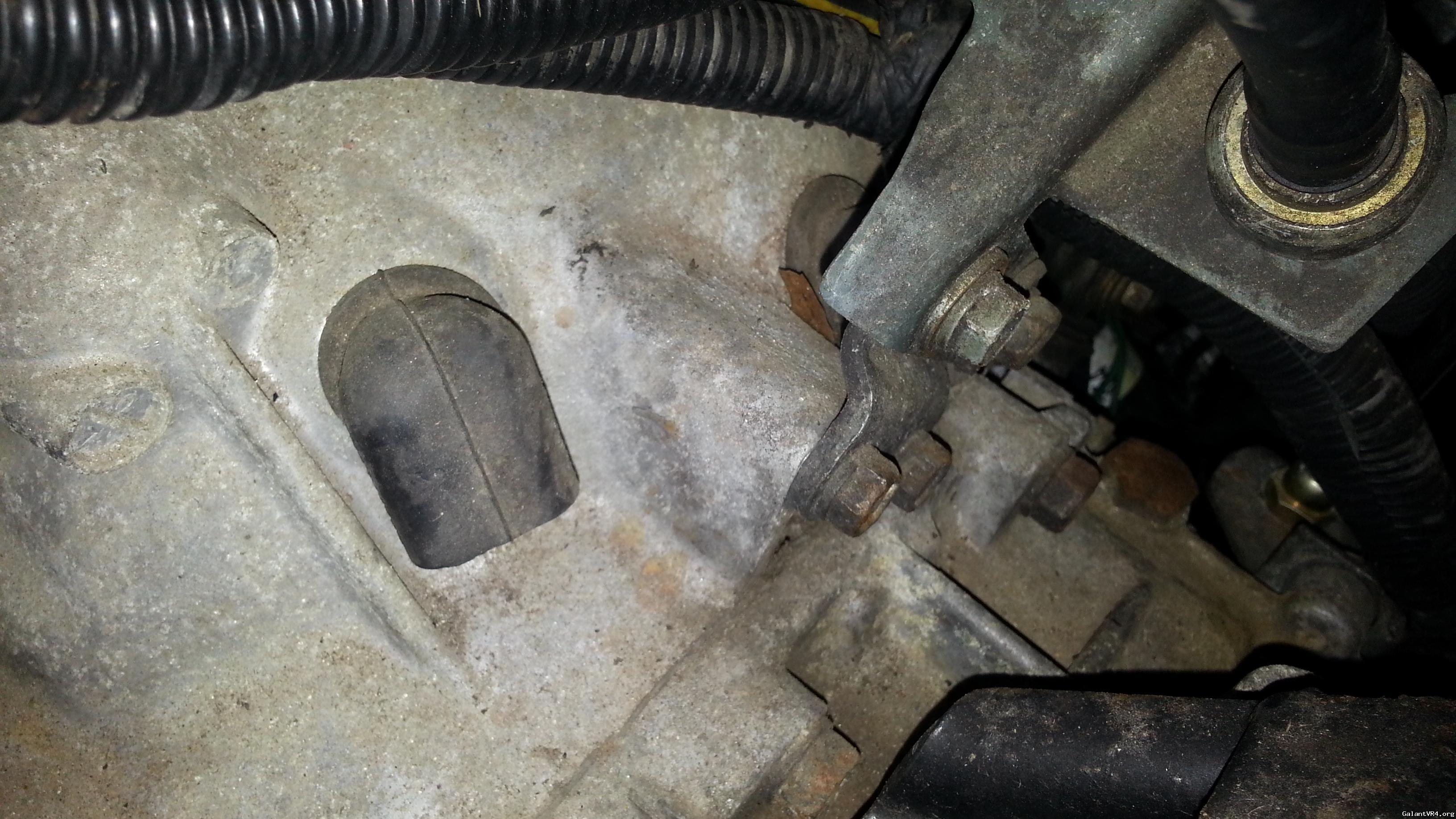

Something is not right. Click on the pic to make it bigger.

Move the clutch line over to the other bolt you mentioned. Do you still have the rubber insulators holding the cable bracket to the transmission? If not, the cable bracket will be about 1/4" closer to the engine, and could put a little more angle into the one cable.

Factory, there are "stepped" washers with rubber glued to them to allow for a little bit of movement. You don't need them in there, and most delete them for a firmer shifter feel. I would just tweak the outer cable mount, so it points a bit more towards the arm. No more problem.
I might have put a washer behind them, but it's really not necessary.
