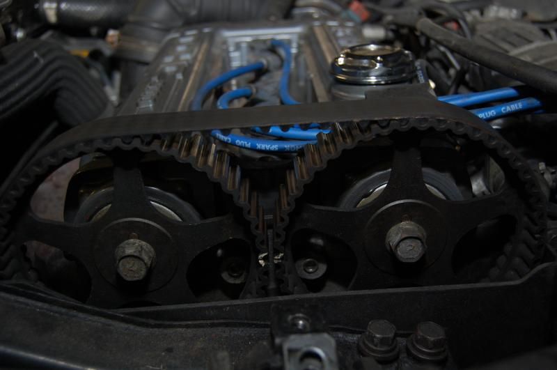

If you cant get it to 5* you have to check the markings on the crank to see that it lines up with the oil pump cover notch, your #1 piston is at top dead center and the two cam gears are as shown in this picture. If you have balance shafts you have to check that they are timed properly too. It's possible the two halves of your engine are not in sync. or one of your balance shafts is out of phase.

First of all if the balance shaft belt was not replaced with the timing belt the job was not done correctly. But Before you remove the timing cover, take the spark plug out of the number one cylinder. Gently insert a long screwdriver so it rests on the number one cylinder. Find top dead center and make sure it lines up while the cam gears lineup. It may take up to 4 cycles to get them to align.
