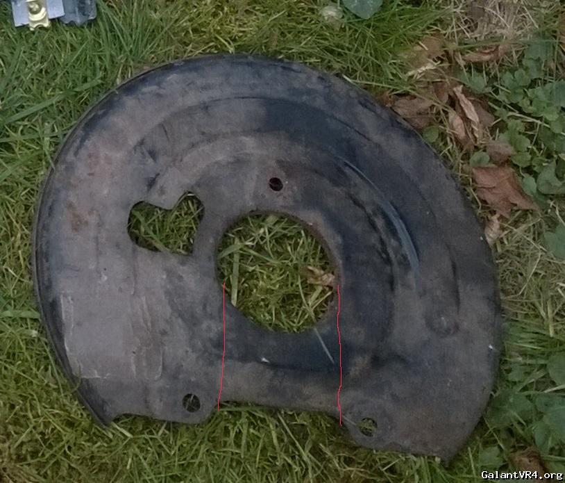

Yes what he said, there are bolts holding them in place, so cutting it in the bottom dont really matter. They accept it at inspection too and they are pretty harsh here.
Not the best drawing, but you get the idea, cut the red lines. The holes are where the bolts are if im not mistaken.

I actually only think the 2 lower ones are for bolts, not sure. Been a while since I changed one.
yes they hold fine, its the caliber bolts, if they fall off. well..... :p
