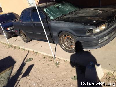

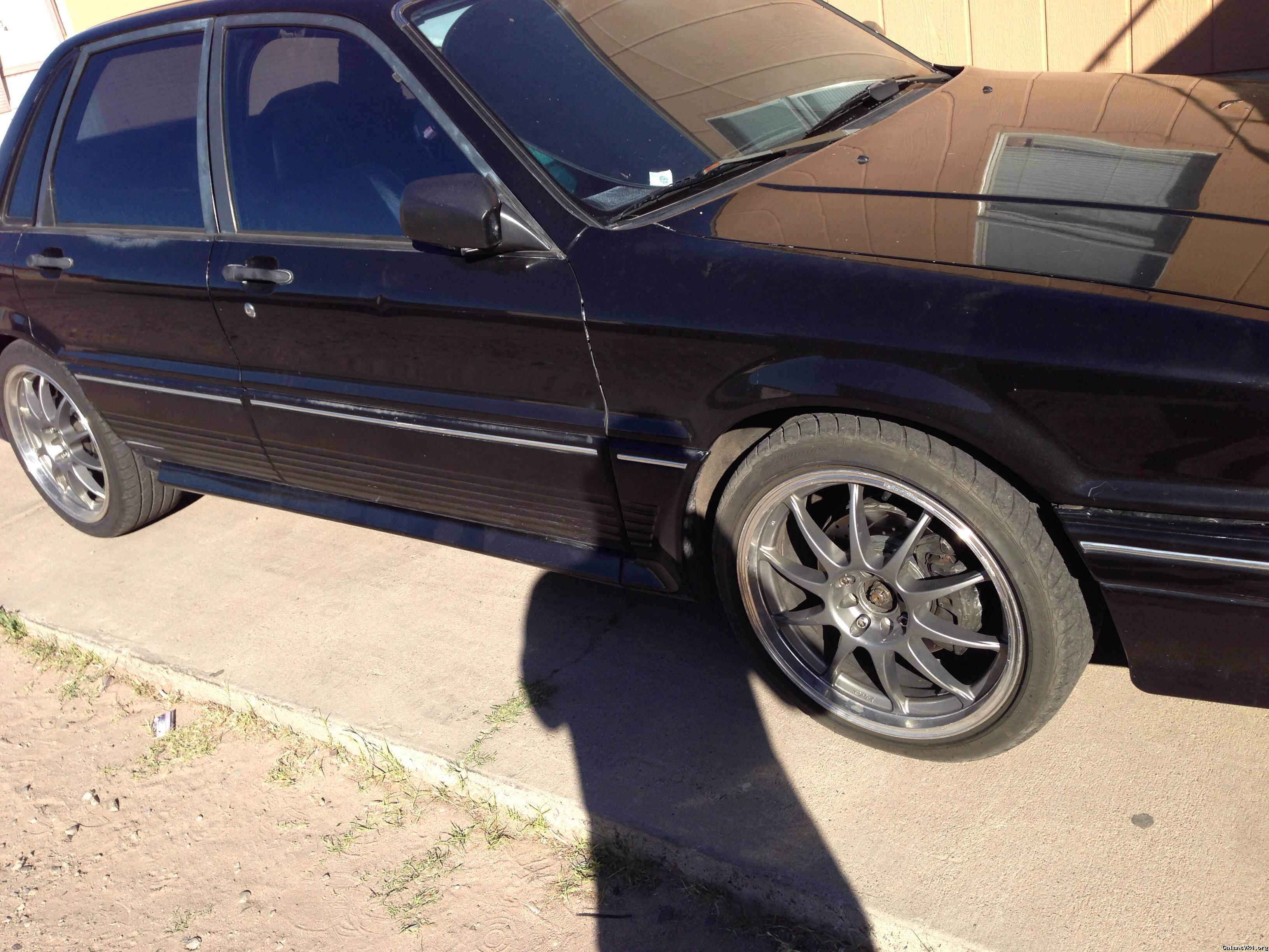

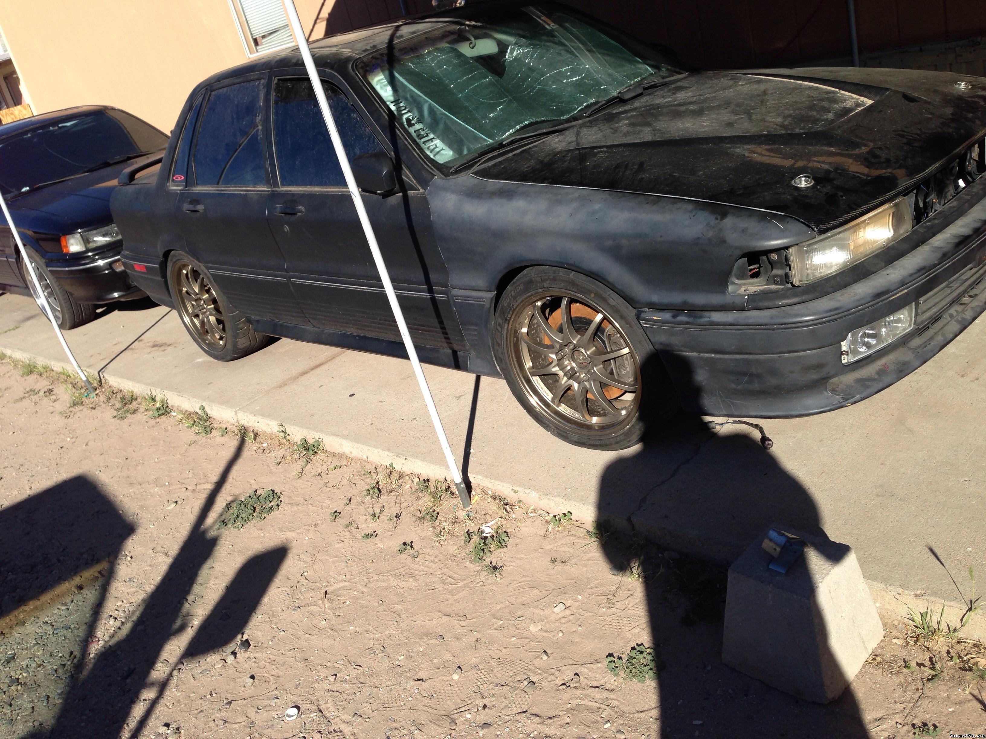

18x7 or even 18x8 wheels will fit, you have to use coilovers. Heres mines, bronze are 235/40r18 and silver 225/40r18 the latter is a 18x7 wheel. Silver is 4 lug, bronze are 5 lug.
