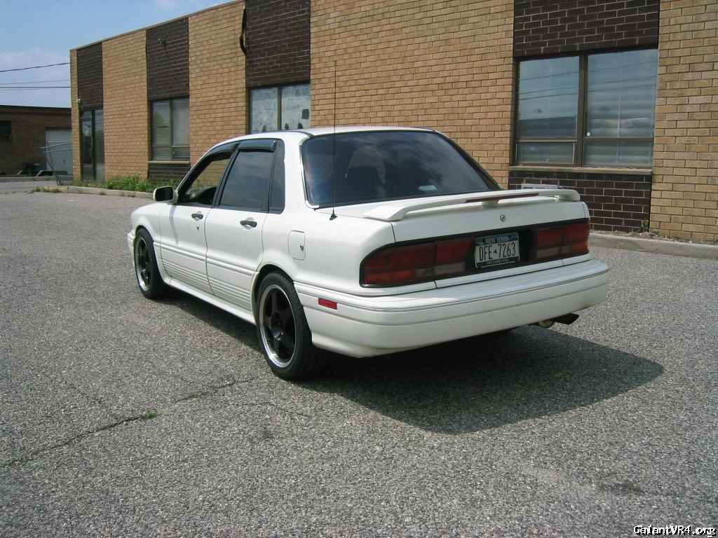

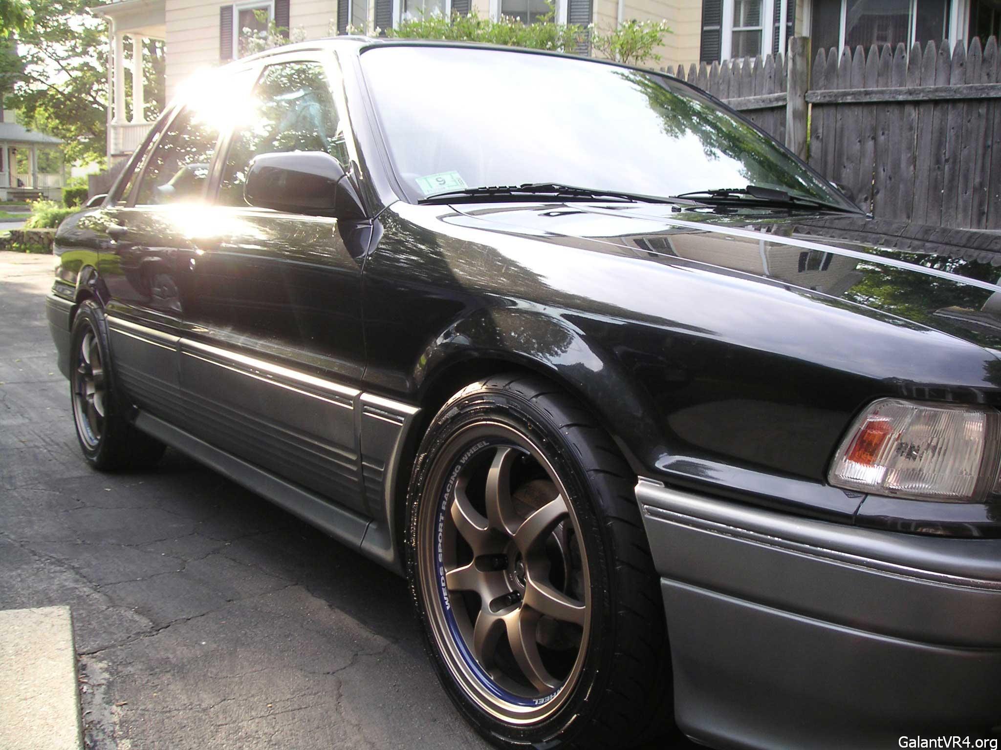

here's my old setup
17x8 with +35mm offset rota slipstreams
245/40-17 toyo proxes 4
new setup (I don't have pics yet):
17x8 +38mm offset EVO MR SE BBS rims

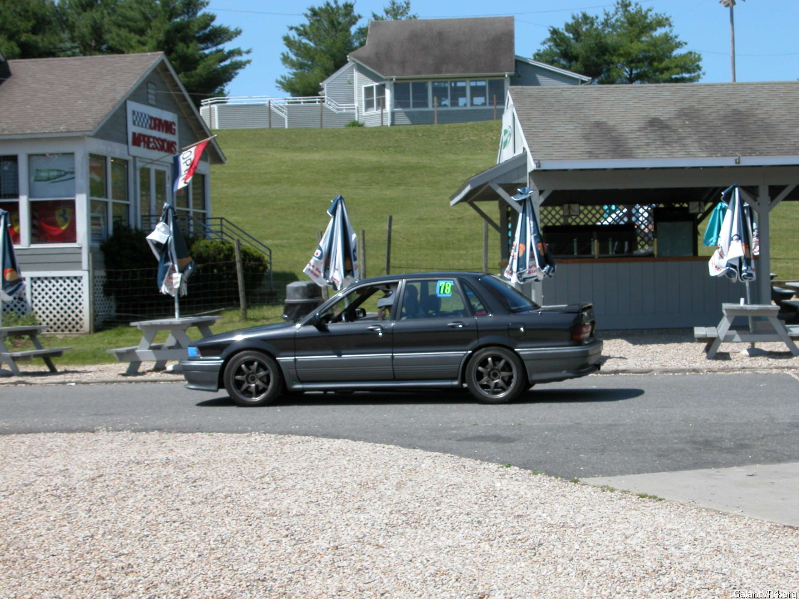

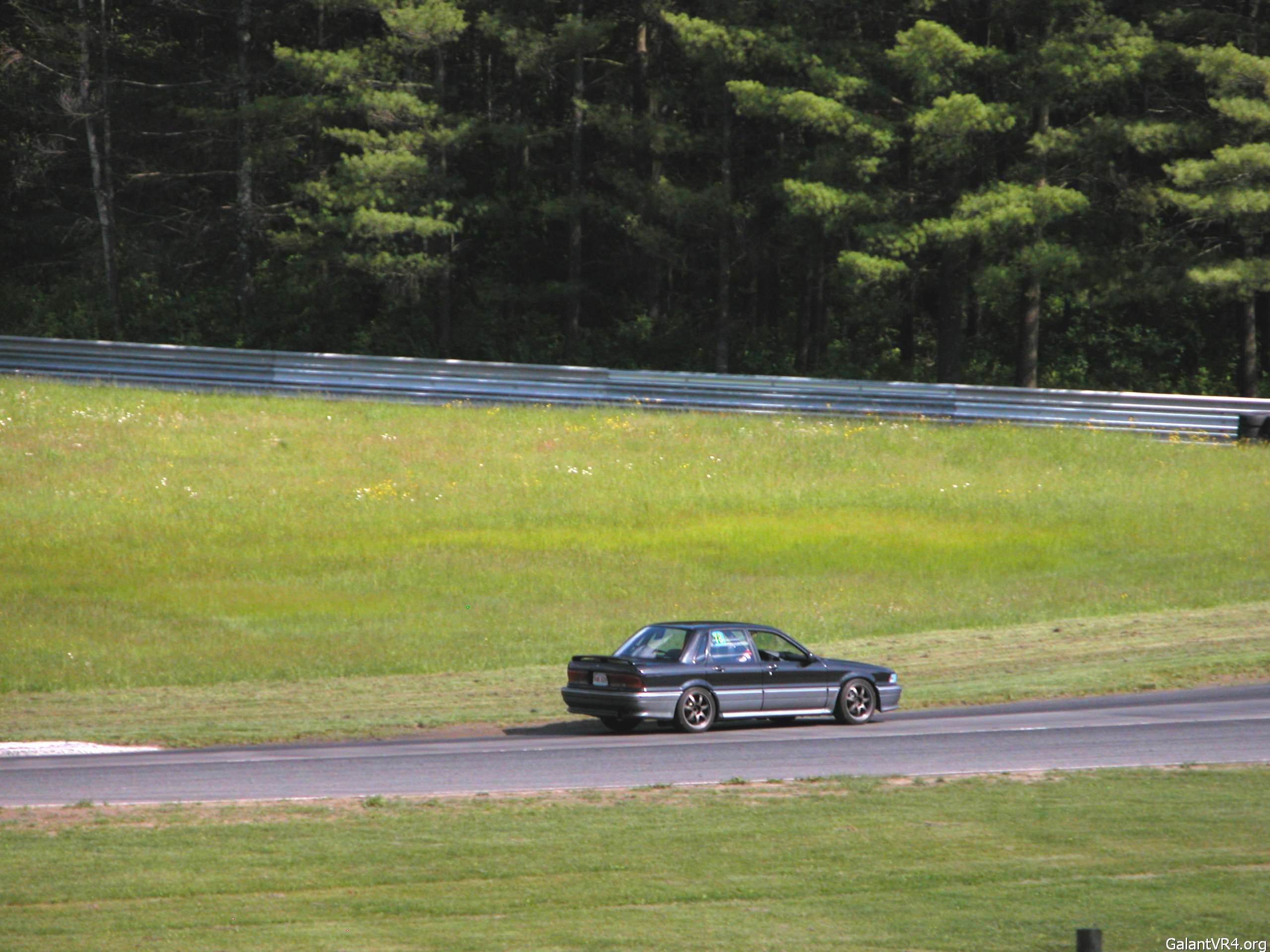

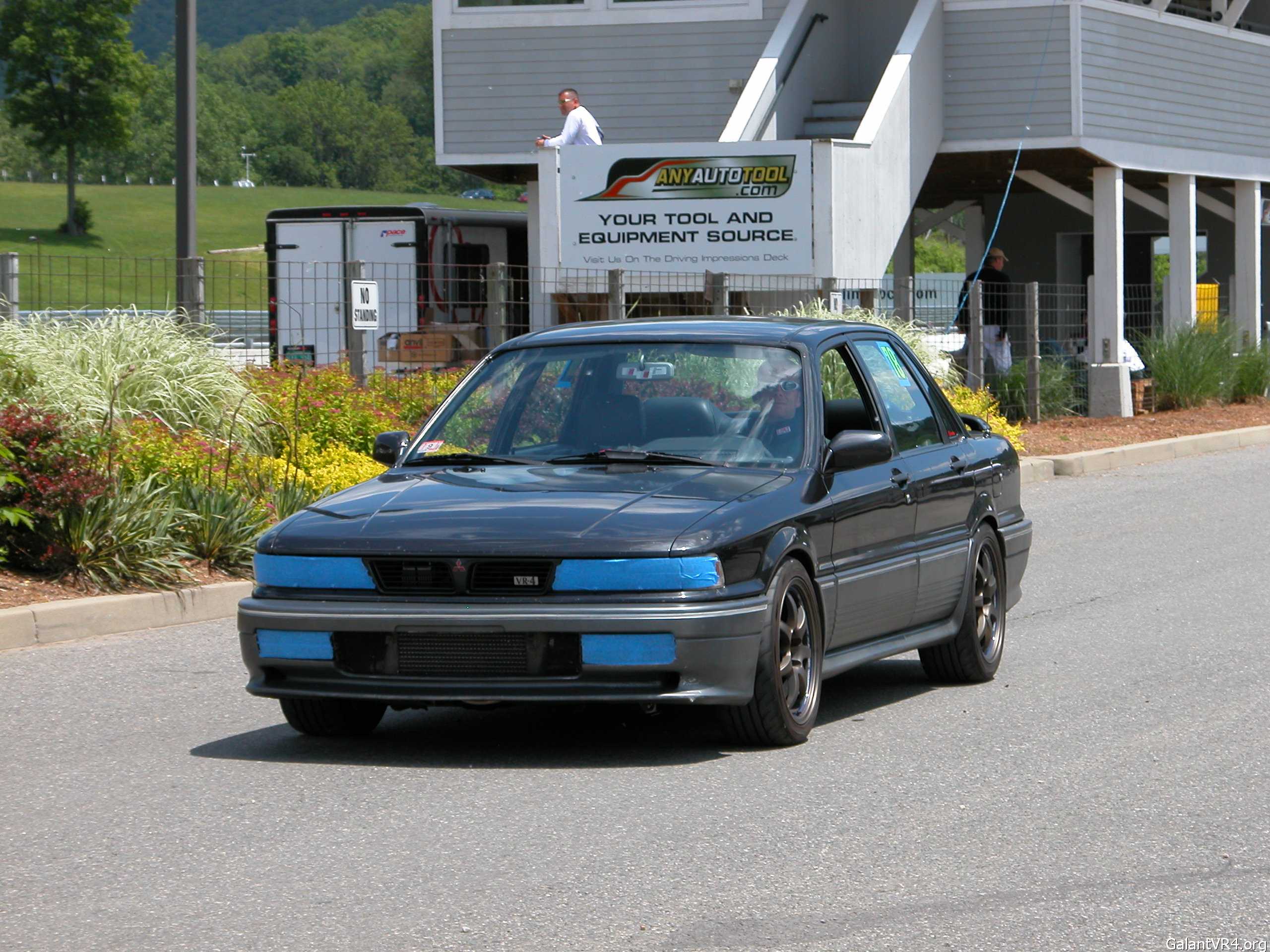

Evo 8 Enkie 17x8 +38mm offset wheels
245/40/17 Dunlop Direza ZR

Wow, that looks a lot like my car... prob. b/c I bought Adrian's wheels. /ubbthreads/images//graemlins/laugh.gif
Sticks out ever so slightly from under the front fender lip, even with about -1.9 degrees front camber with this set up. I do have coilovers so that gives more clearance than stock front spring perches would. I have the same size tires Adrian did. No rub issues, except for full steering lock backing up, when the inner tread rubs the fender liner ever so slightly.
May try the 1/4" spacer in the rear to even out the rear with the front in terms of track and how they're lined up with the fenders. Rear trailing arm clearance is adequate and they've never rubbed there. If the wheels were .5" wider they'd likely contact the trailing arms.

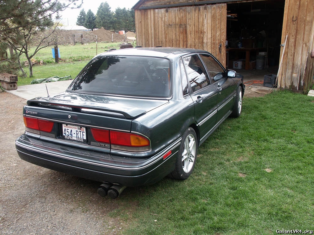

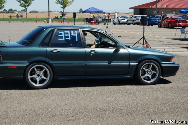

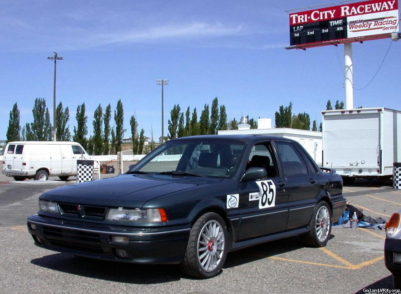

16x7.5 allesio's @ ~40 or 42 IIRC
225's
17x7 tsw imola @ somewhere around 40-42 IIRC (might have had a spacer in the rear in this pic)
235/40 or so kuhmos
17x8 5zigens @ 35
245/40

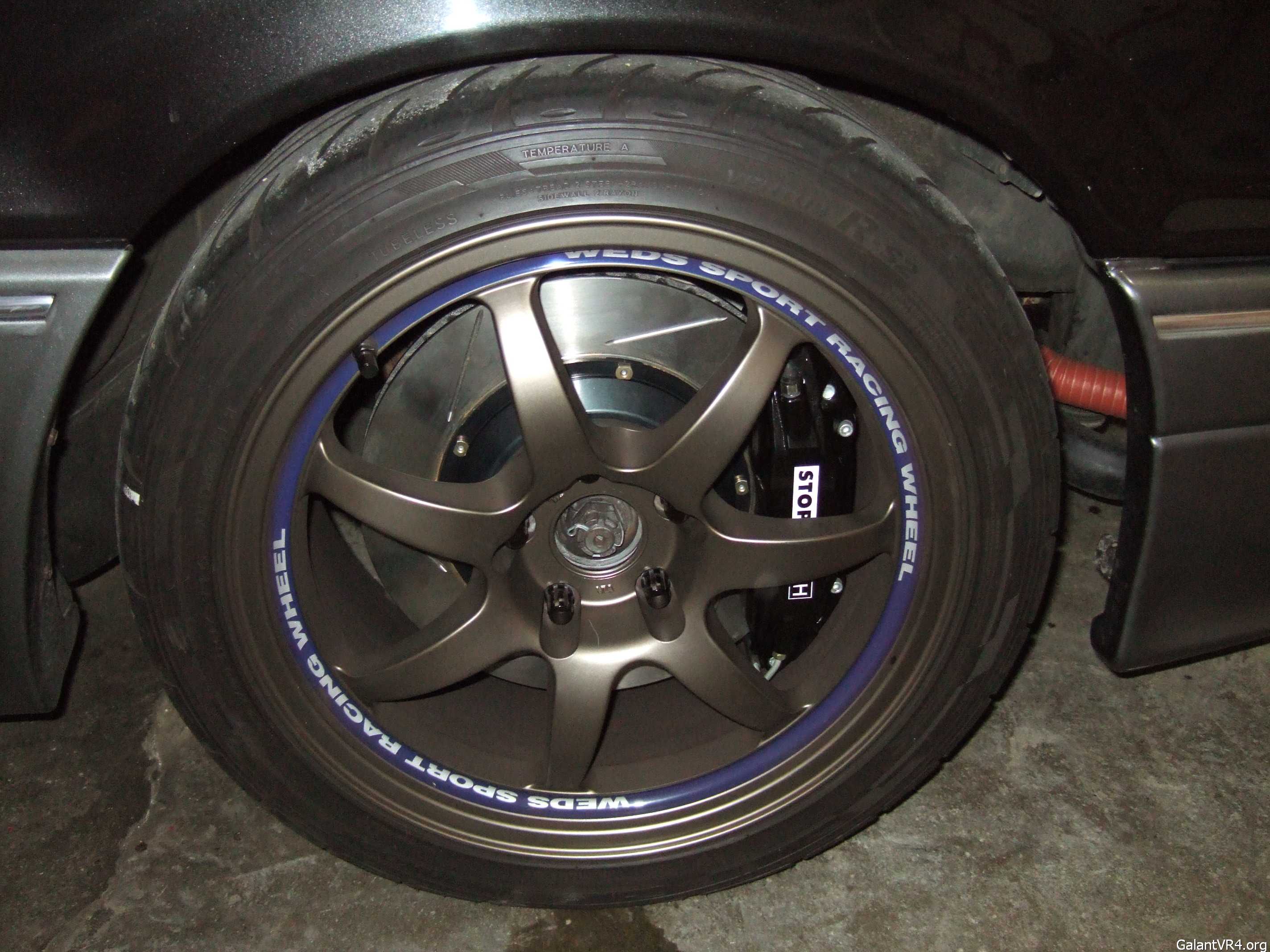

17x8 offset is 35 with 245 tire.
they clear, but I'm running a pretty healthy dose of negative camber
