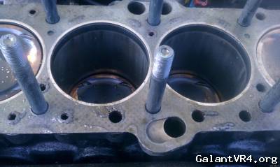

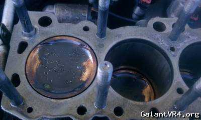

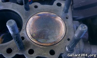

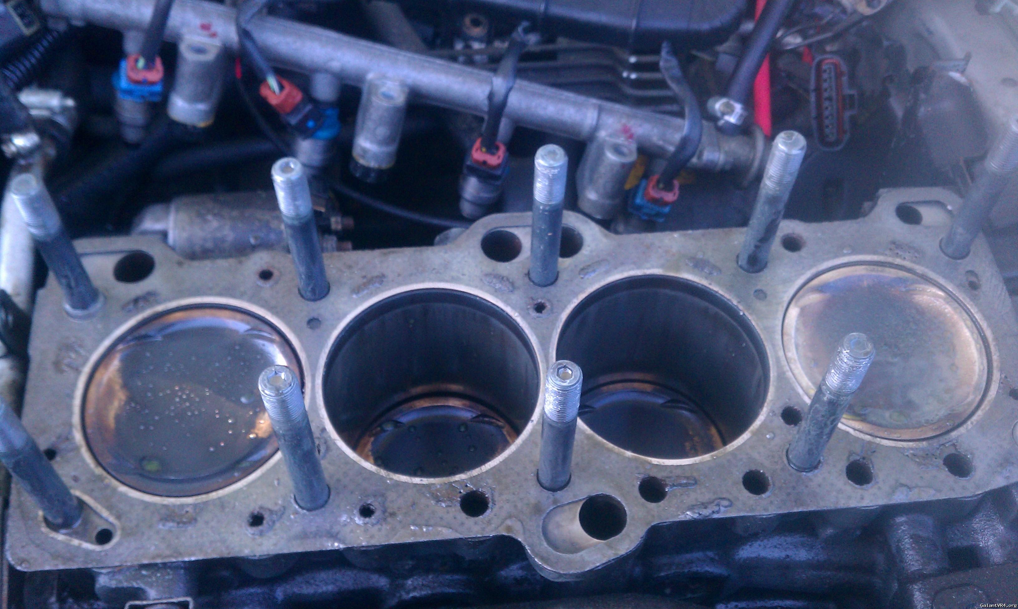

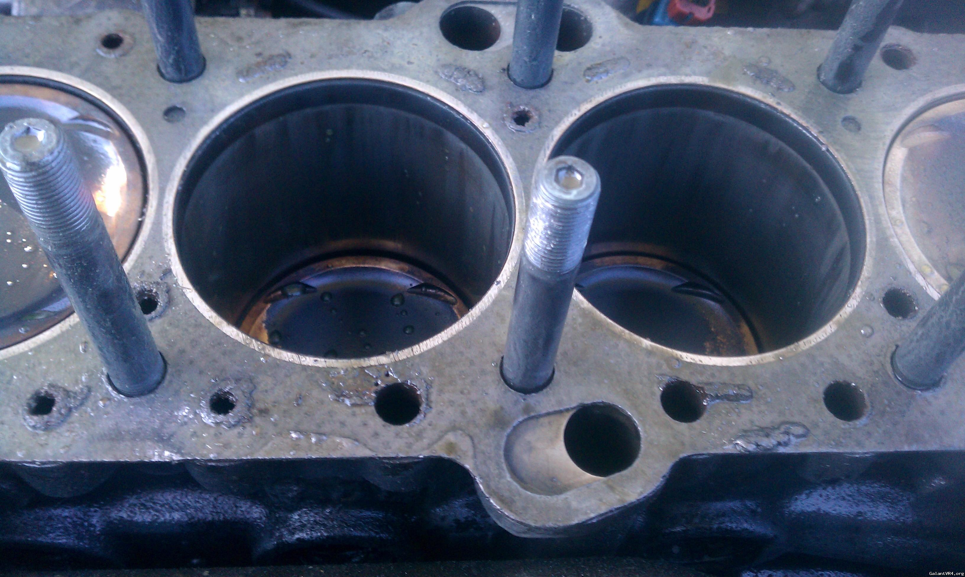

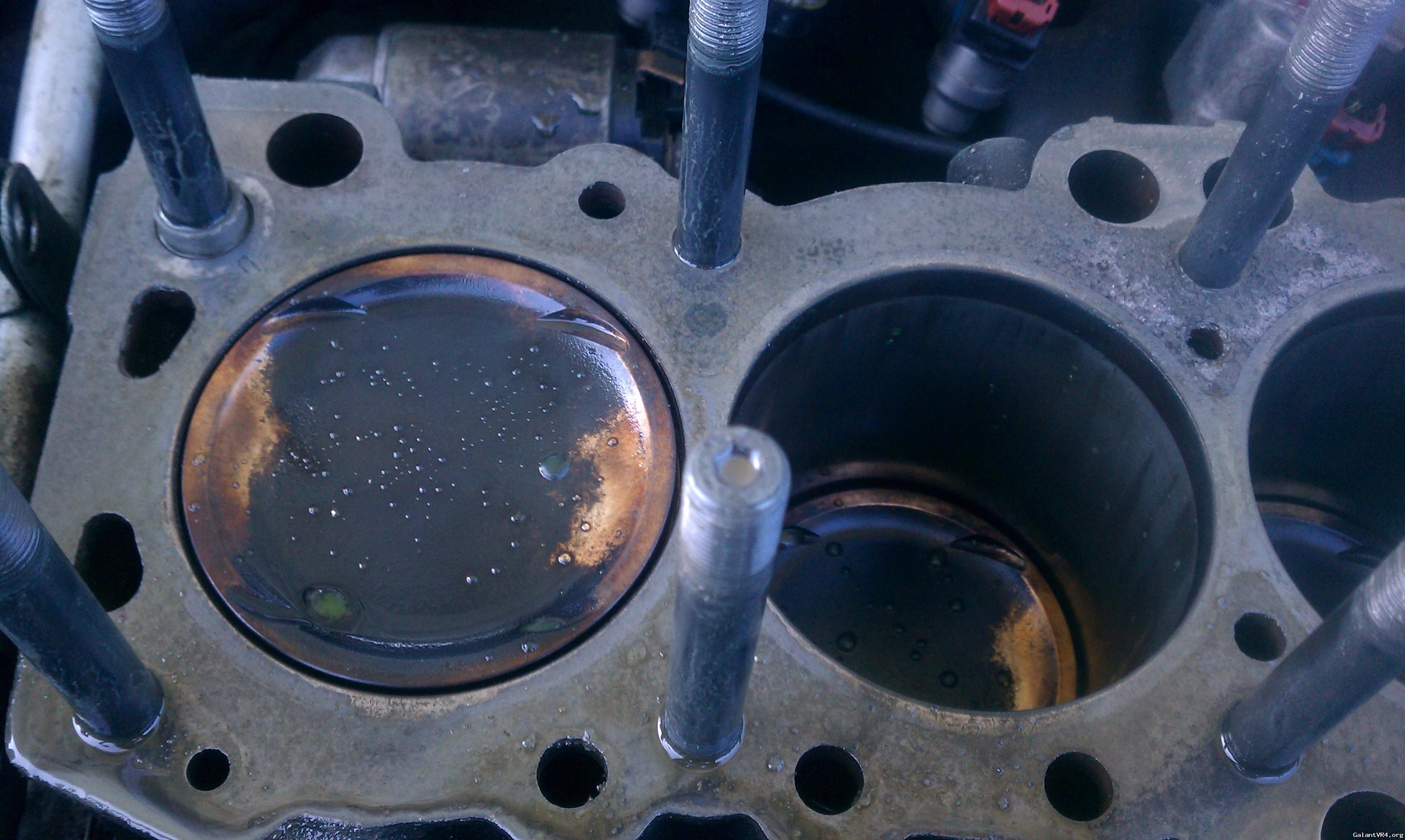

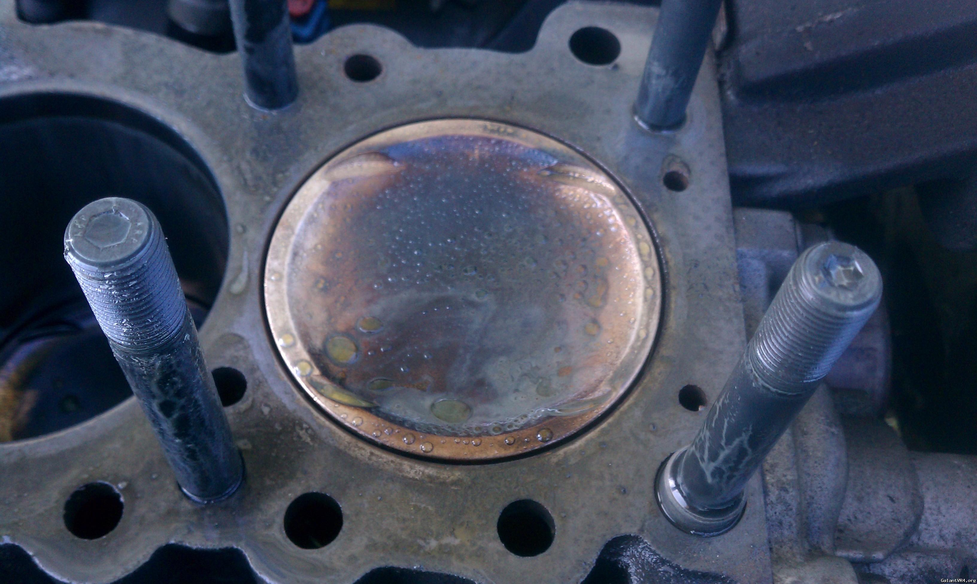

The fact that the number #1 cylinder combustion chamber and piston crown is cleaner than the others suggests that coolant was getting into there 'cleaning' up the carbon. Combustion gasses would then in turn have escaped into the cooling system and over-pressurising the system hence the bulging hoses - though you would have thought the radiator cap valve would have opened and just pushed coolant into the over-flow bottle all the time.
For 75 bucks I will be having the head resurfaced, just to be on the safe side. I have never heard of a cast iron block being warped with 16g 20psi arp's and a few bolt ons. I should probably get some sort reward for achieving that. So I guess I will check the block.

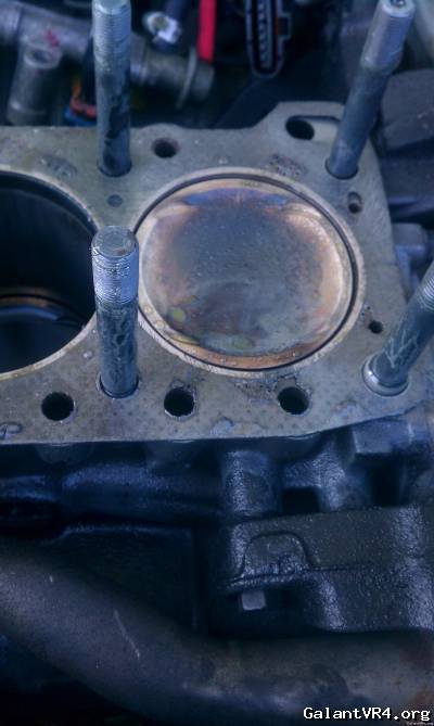

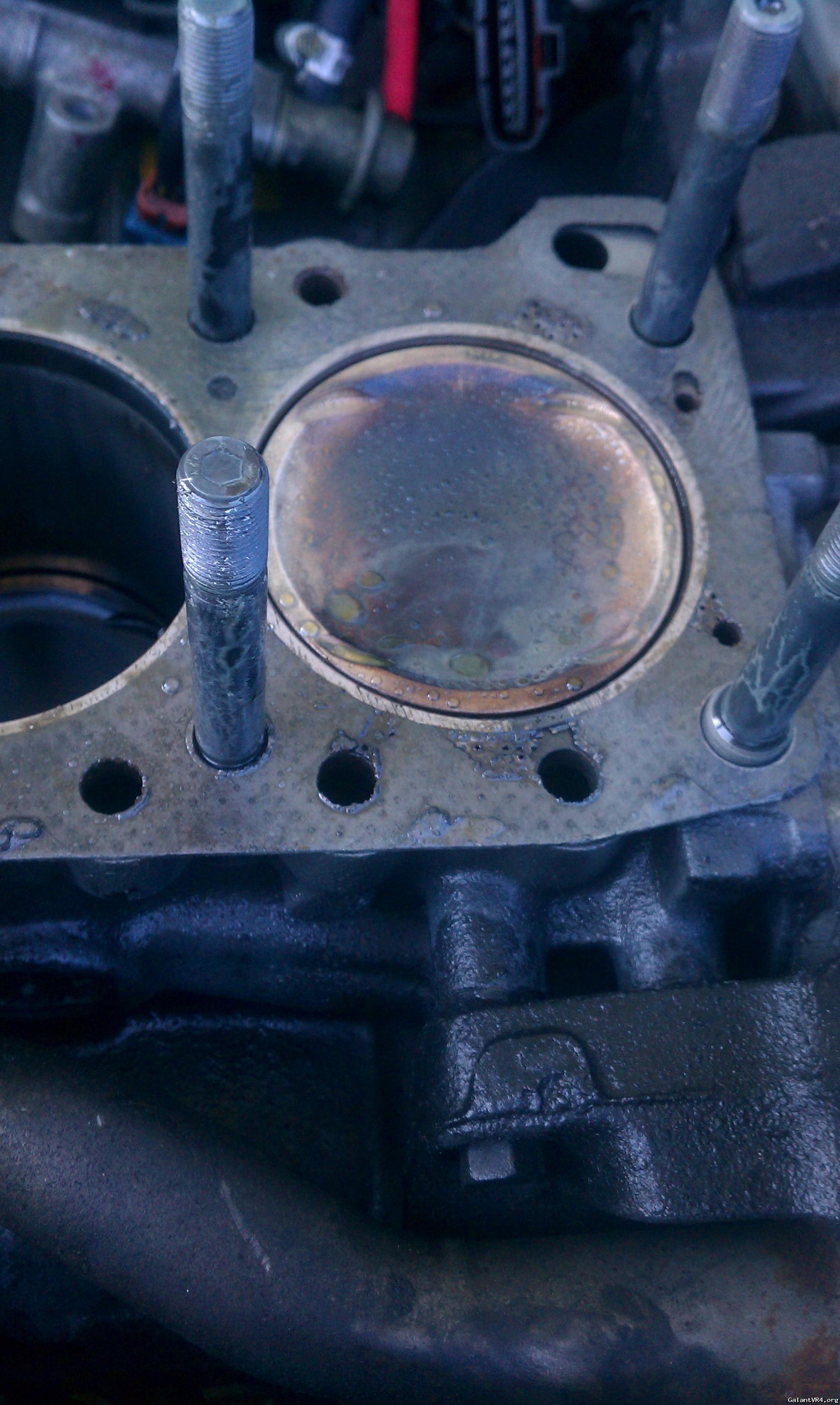

I am sure more people than me have seen in the pics exactly where it was coming into the cylinder in the last set of pictures. I can see the gasket material is a bit different in the path from the water jacket hole and the cylinder, I would be sure to check in that area the most for any warping issue. Every time a shop pulls a head off an engine for a head gasket, Myself, Or another shop, It is always properly checked for the block warping, and the head is machined flat to be sure the problem does not happen again. I do just about 3 of the Ford f series from 03-07 with the 6.0 diesel engine a month at the shop I work for (engines known for horribly warped heads and blocks from poorly designed engines and head gaskets) The best way to have a good piece of mind is to do it right the first time! I hope it was just time for a head gasket and you don't run into this problem in the future when it is all said and done!
