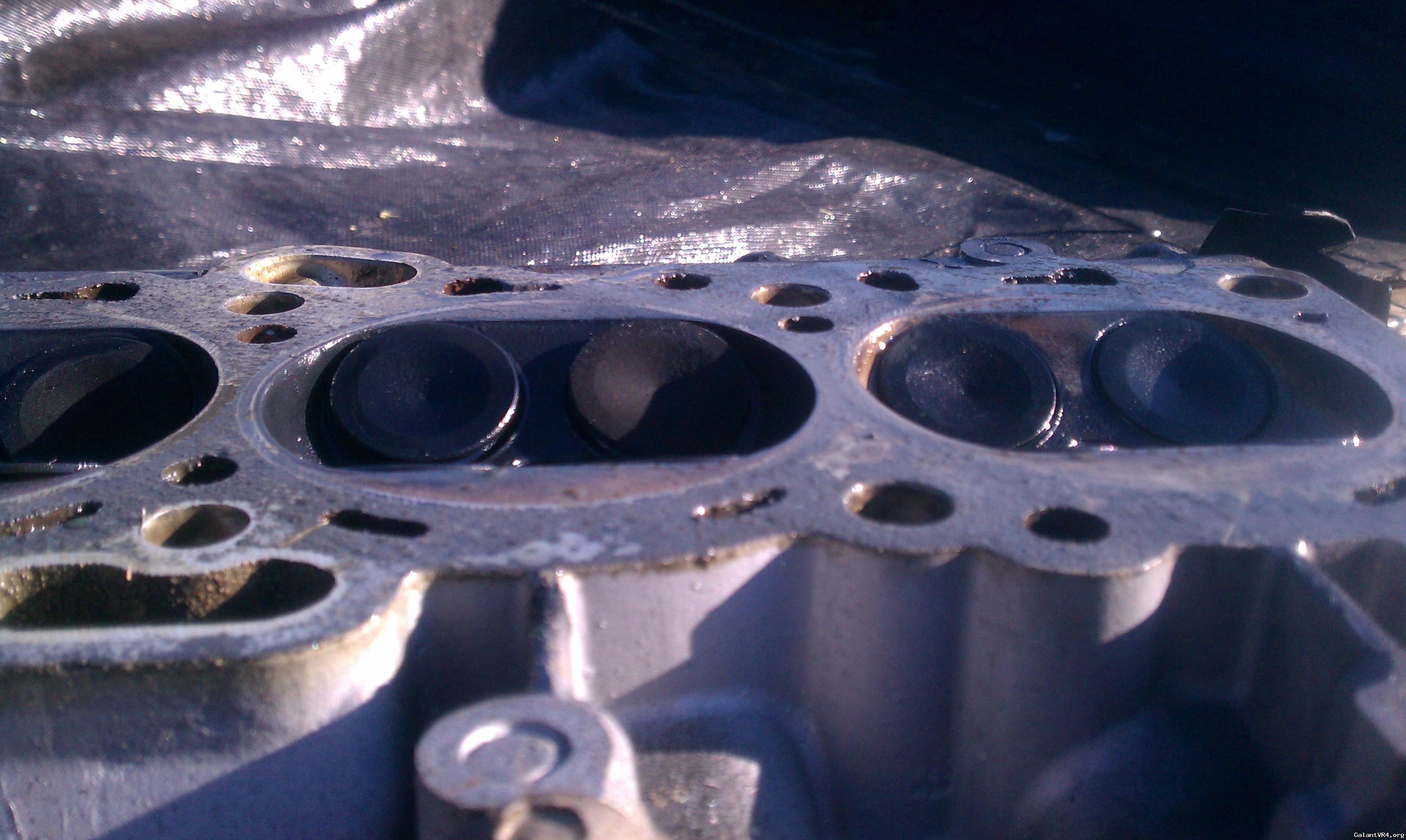

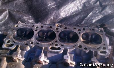

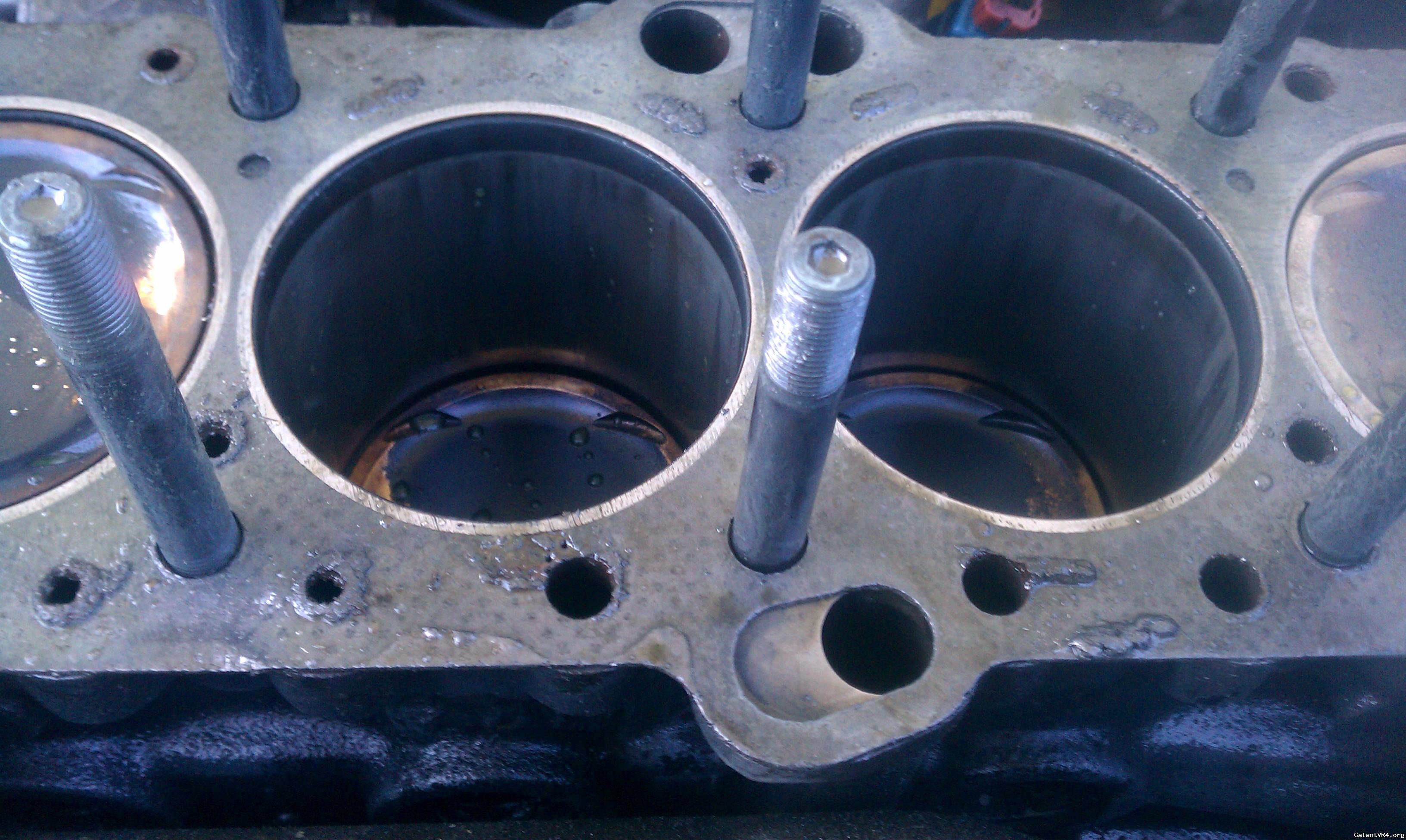

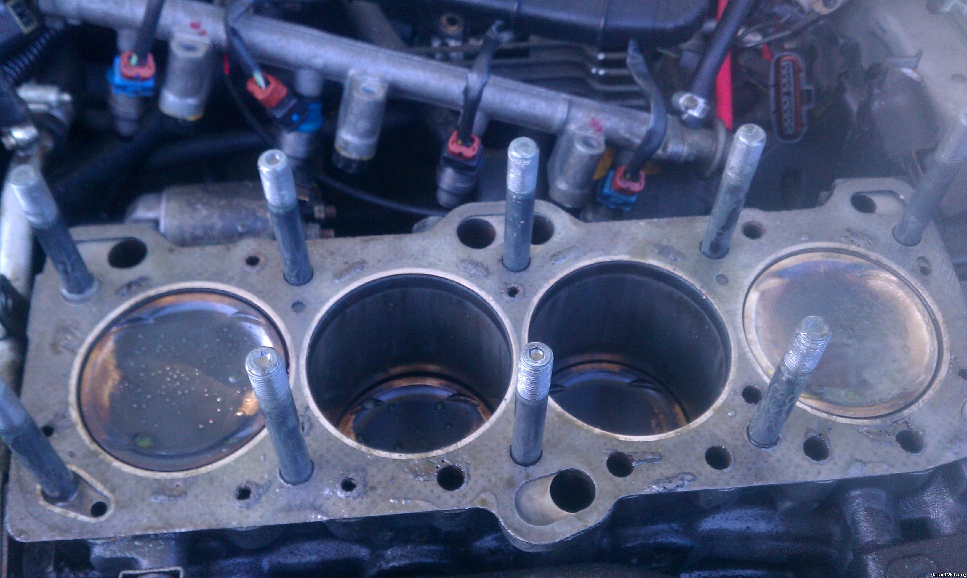

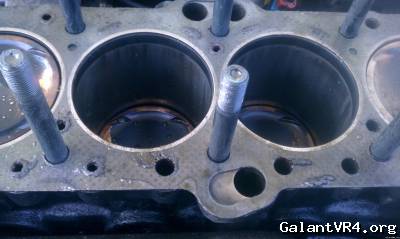

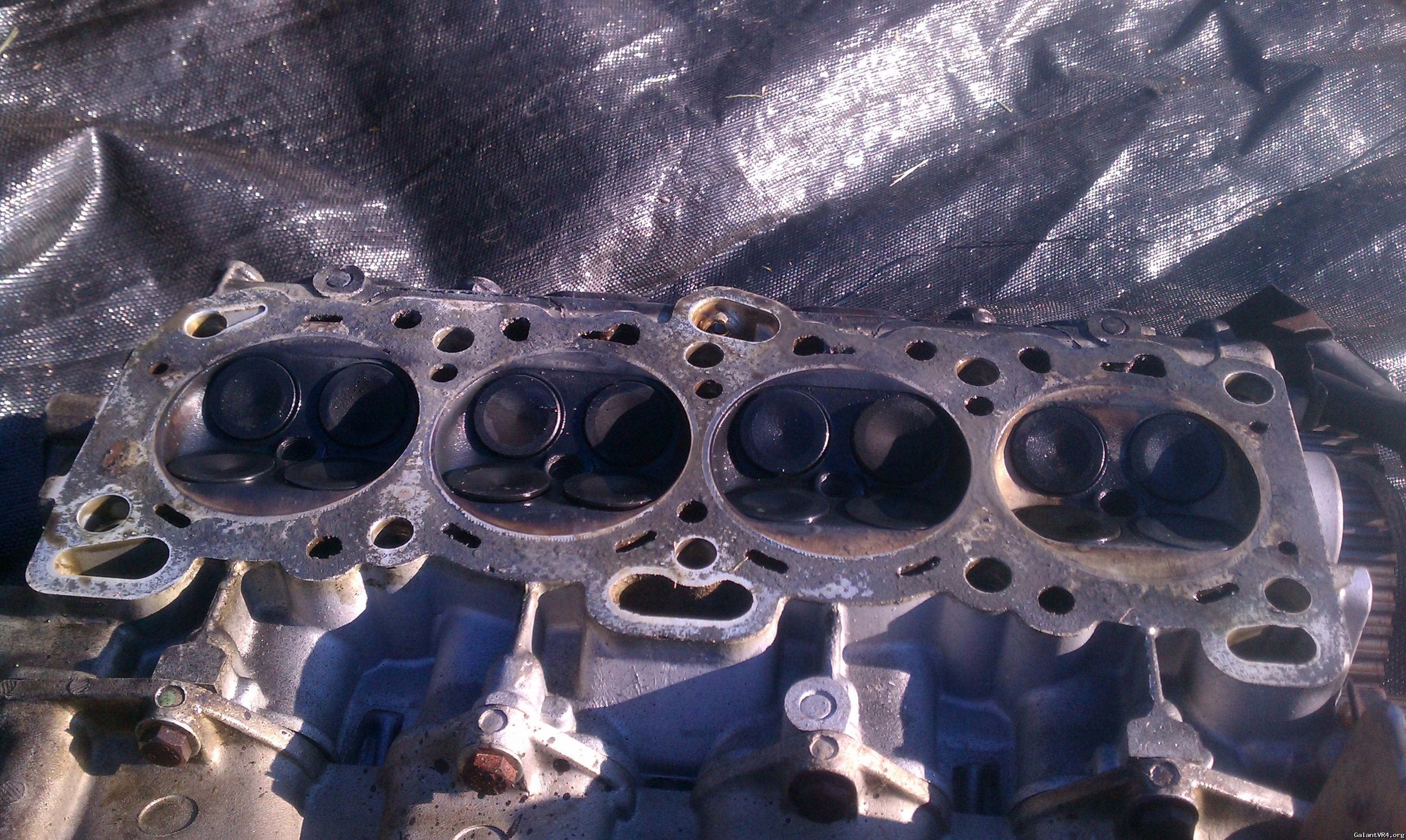

just pulled the head what do yall think? You can click on the image to make larger.

Looks like #1 is the culprit. Look at the water passage on the lower right hole and it sure does look like the gasket material is blown away right up to the metal sealing ring.
Take a few pics as close to the head as possible for each cylinder and the surrounding water/oil passages. Then remove the gasket and snap another one of just the gasket.
Sure looks to me like the gasket has been blown away in that spot.
