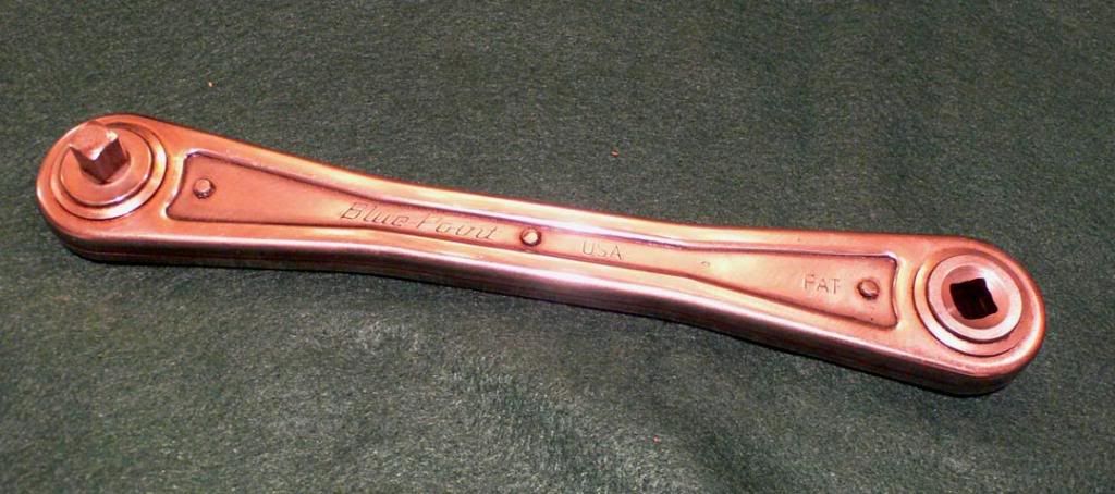

You realize, an open end wrench, and a box end wrench, are two totally different things, right?
I don't see an open ended wrench working too well on those two bolts. A box end wrench is hard to get in there, since that bracket kind of shrouds the bolts. A crowsfoot boxend wrench works okay, but then you run into clearance issues with the length, or leverage issues if it's short enough to fit in there well.
I've had good luck using a lateral extension, like this...
transparentdsm
Jul 27, 2011
3,690
Cherry Hill, NJ
yeah i know the difference,, i spray a bunch of PB blast in there and wait like 15 -20 minutes, since its aluminum it doesn't rust, and they usually fall out for me.
