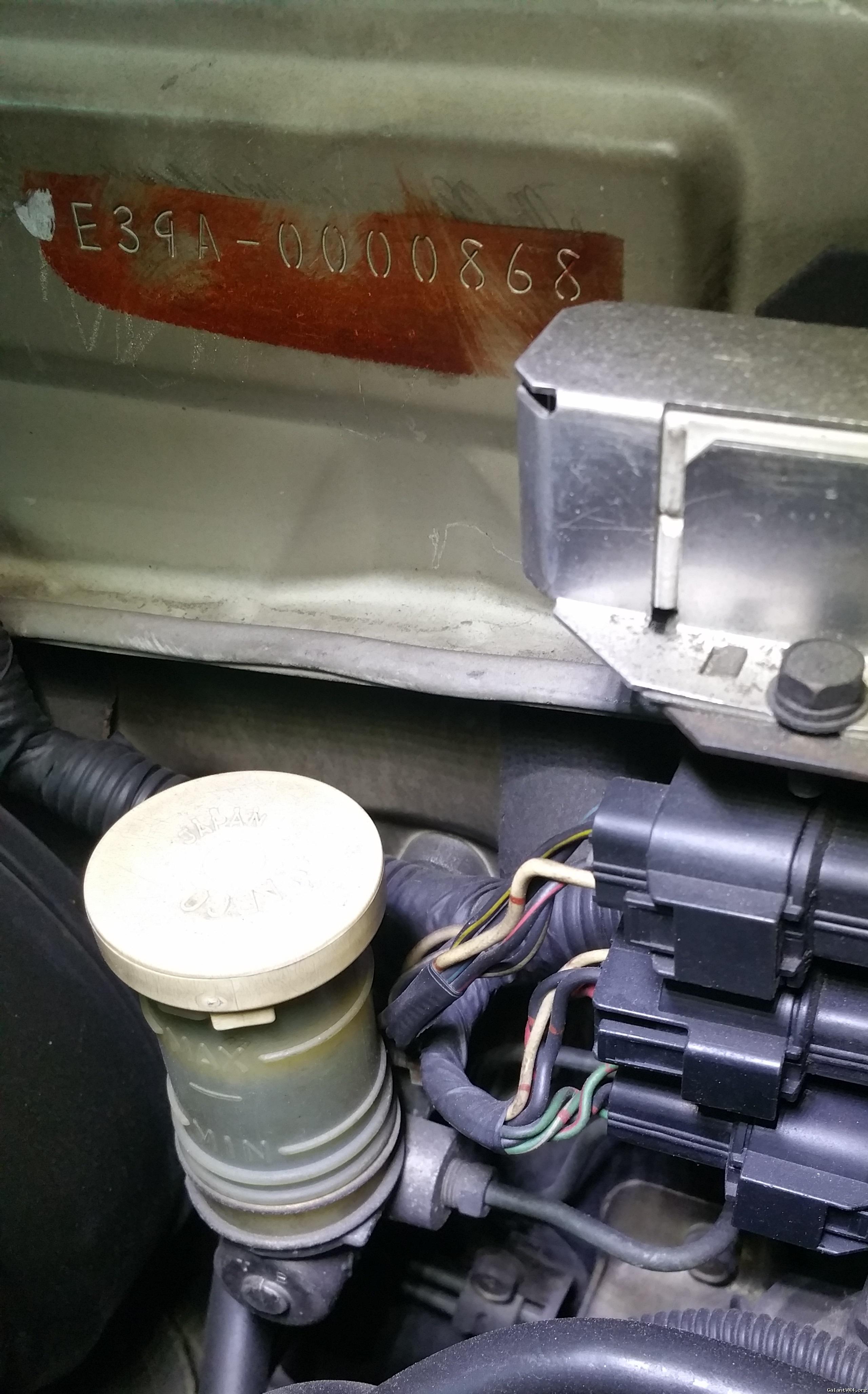

I recently acquired a JDM Galant VR-4 and while looking it over noticed the clutch master cylinder leaking past the seal into the cabin area. Where can I find a replacement one?
E39A-0000868
10,992
Do a little study and see if it is actually different than the US version. Even if it is, it may be adaptable.

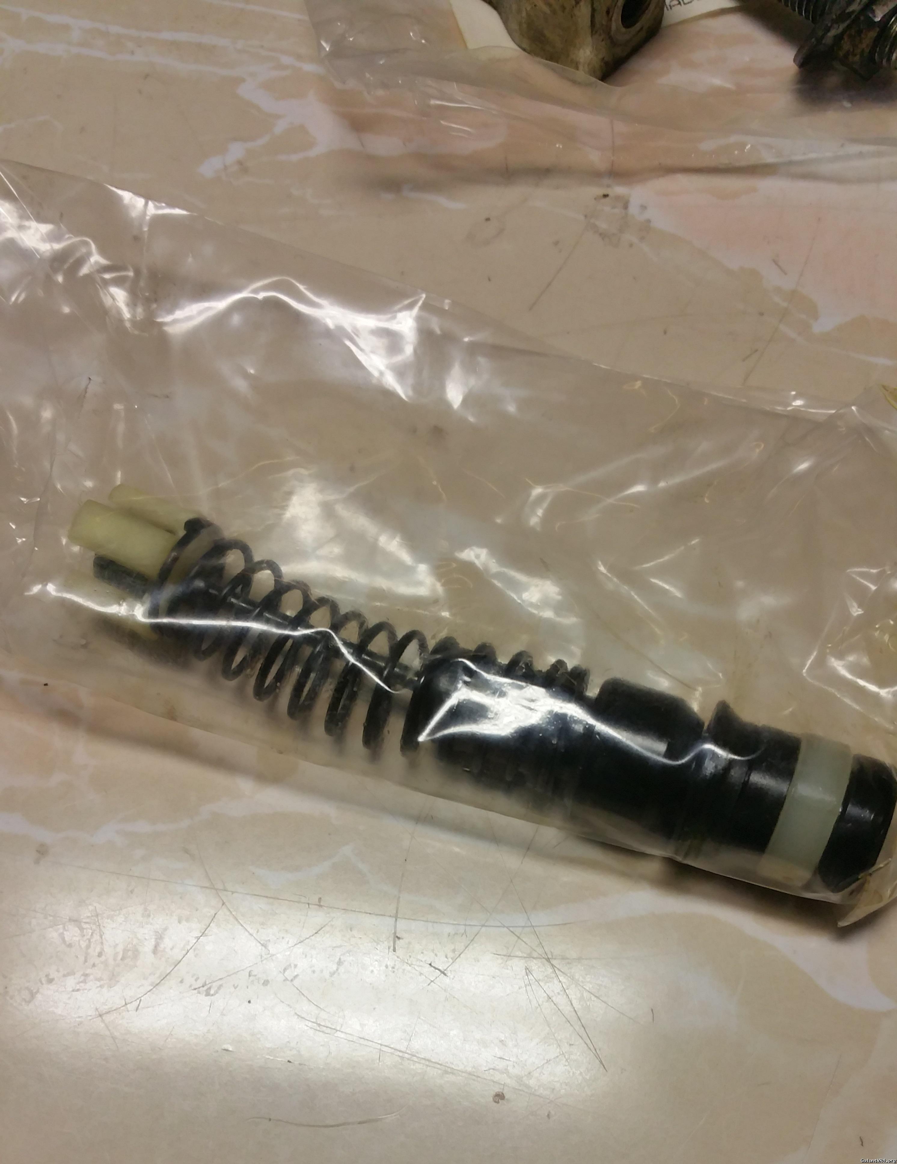

Or rebuild it yourself with parts from JNZTuning. Guts will be the same but I believe the line comes out the opposite side
10,992
That makes sense too. If diameter is the same (and it should be..), should be easy.

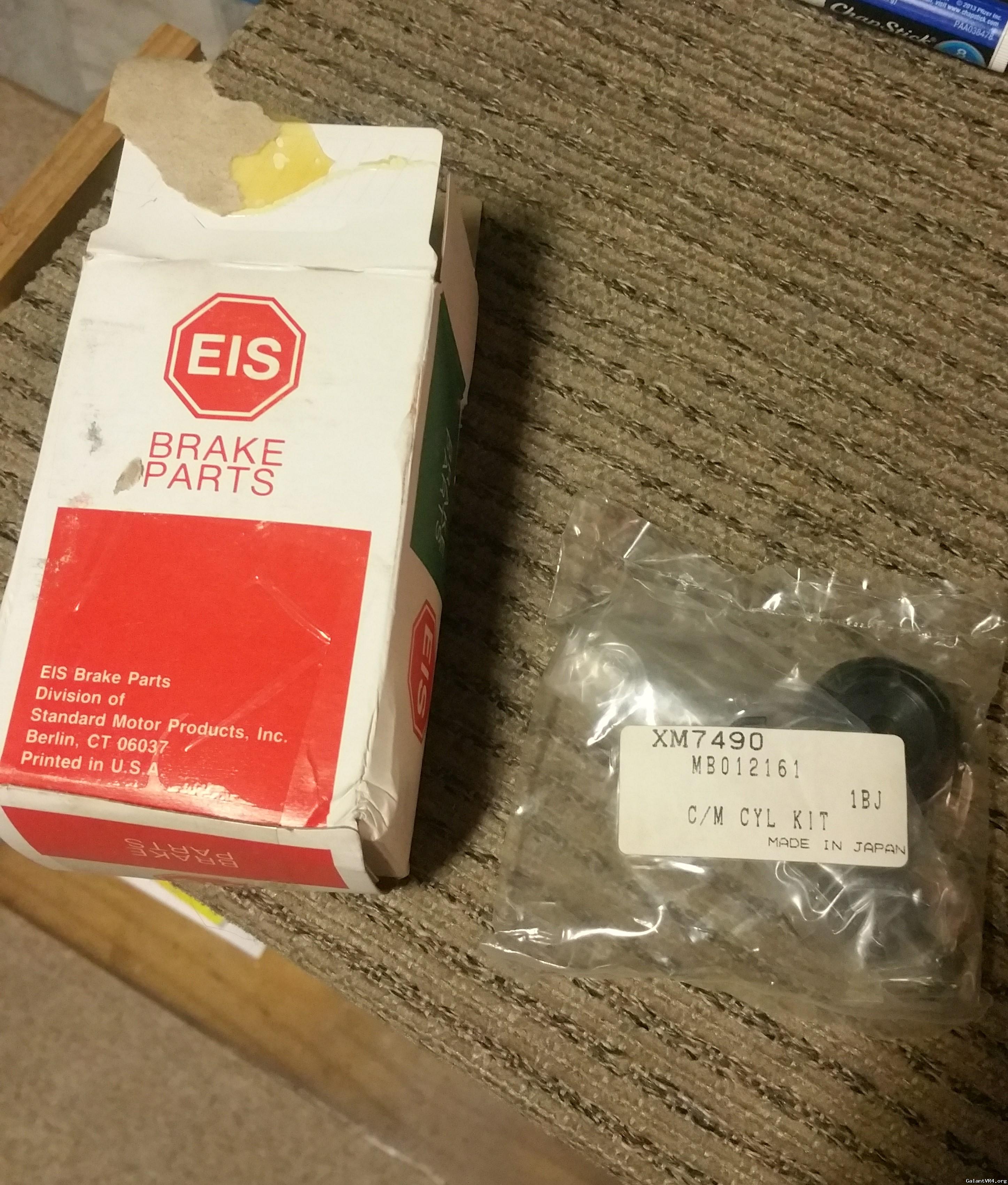

I just double checked and the car is w/o cruise. I ordered a rebuild kit through RockAuto for a USDM '91. But I will also order a pair of these seals from JNZ. Thanks Guys

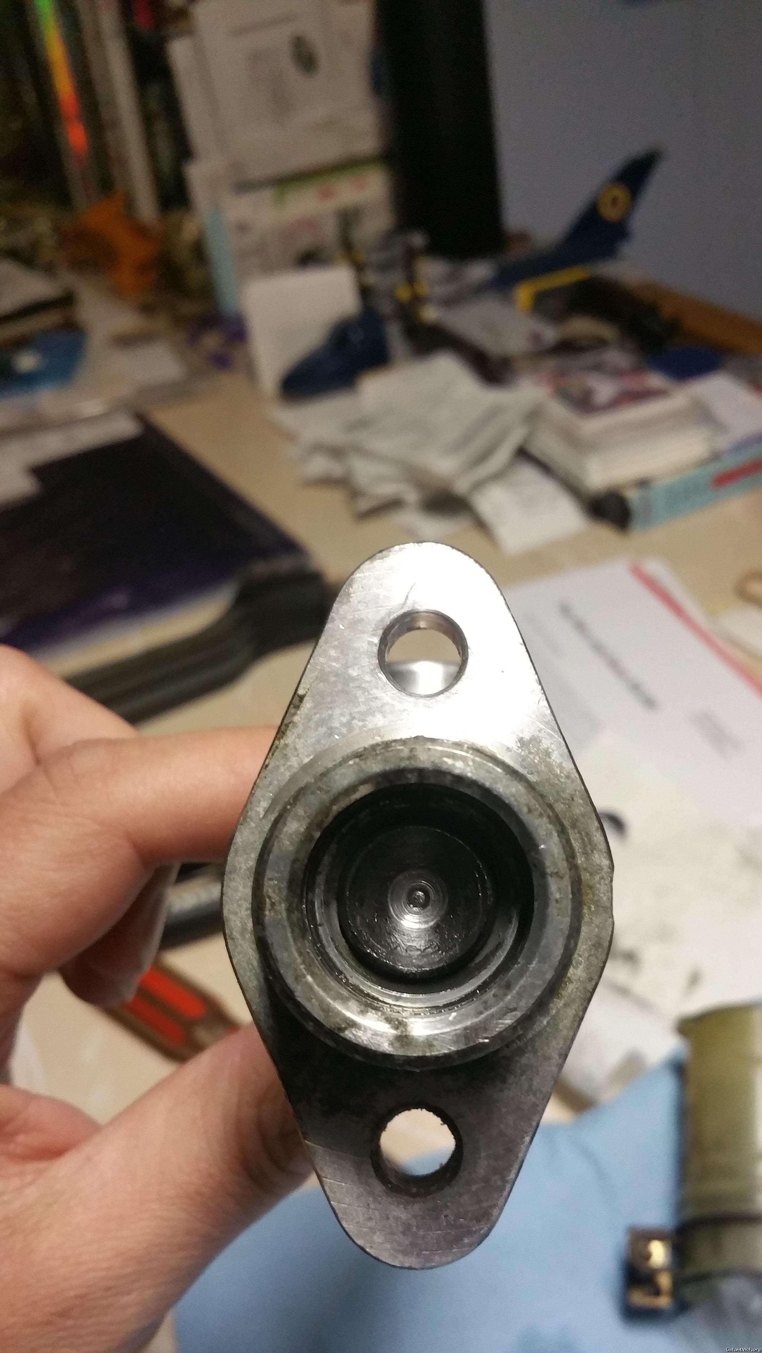

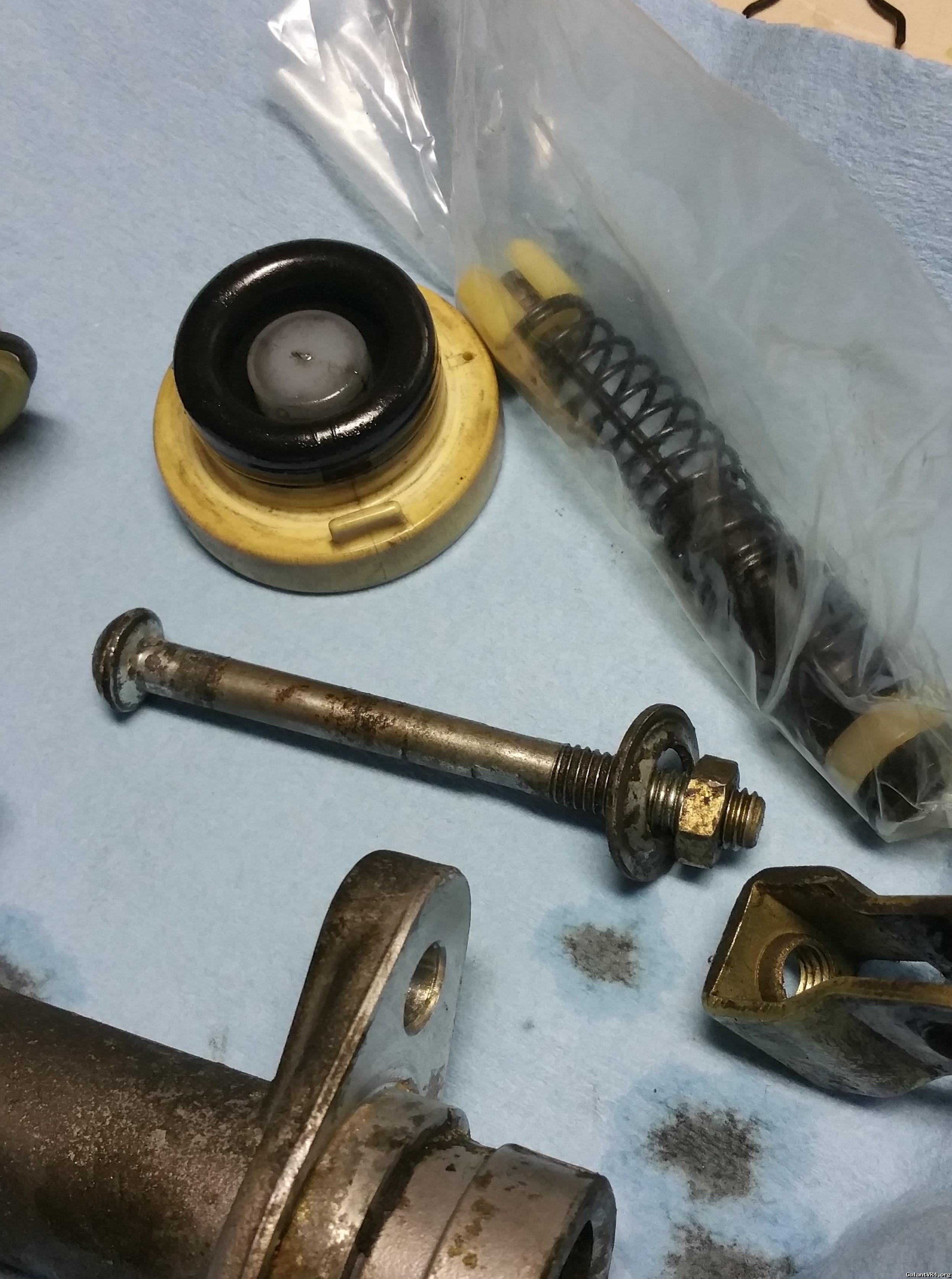

Quoting G:
There is the clip shown in the box labeled 20110 in the illustrations. Did you remove that?
10,992
You may have some corrosion in there. You can soak it or try compressed air through a line hole. Don't look in the end when trying that method.
mscatchell
Mar 22, 2017
11
Morton Grove, Illinois
I'll try that and see what happens, only other thing I can think of is to drill a hole in the piston to put a screw in to pull it out since it might have a plastic collar like the replacement.
