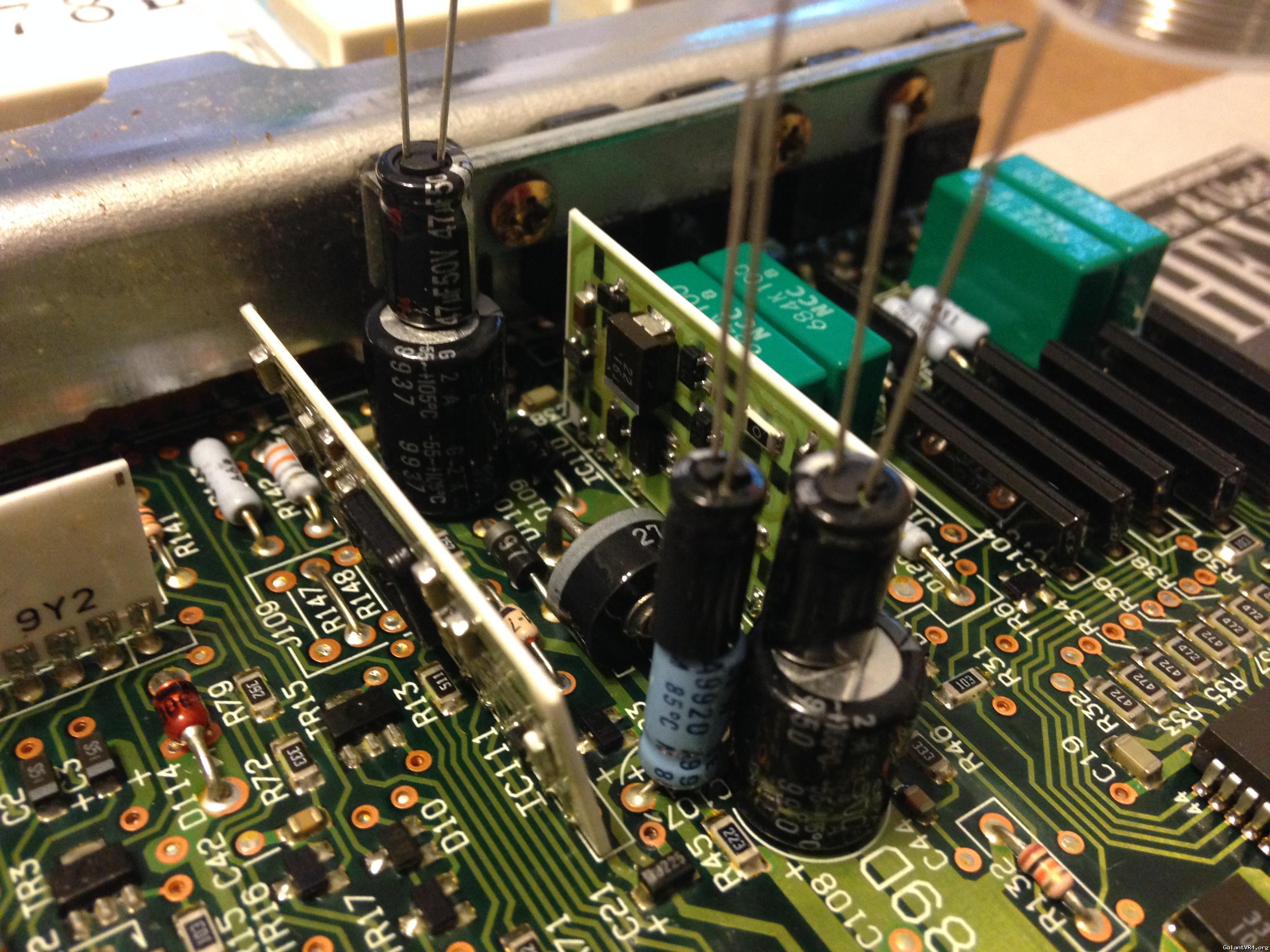

I purchased the replacement caps and they are physically much smaller, is this normal?
The "Digi-Key PN links" are broken on the How-To site, so I tried to find the closest ones they had:
22uF 50V: P5568-ND (mfg PN: ECA-1HHG220)
100uF 25V: P5540-ND (mfg PN: ECA-1EHG101)
47uF 50V: P5570-ND (mfg PN: ECA-1HHG470)
Have caps just gotten smaller in the past 20 years, lol??
Caps on my board are in good shape though so I'll wait to swap them.

Yes, much like how computer processors and hard drives have got physically smaller in time capacitors too have shrunken. Always make sure you retain the correct capacitance, but if the exact voltage is not available you can safely substitute in higher voltage units.

I only meant I'd wait until I got a reply or found the correct caps - turns out what I have will work, so I'll be swapping them this weekend /ubbthreads/images/graemlins/smile.gif

I did this last weekend while changing out a heater core. Ordered parts from Mouser:
Part numbers and links here:
1
RoHS: Compliant1
667-ECA-1EHG101
ECA-1EHG101
100uF 25V
2
RoHS: Compliant1
667-ECA-1HHG220
ECA-1HHG220
22uF 50V
3
RoHS: Compliant1
667-ECA-1HHG470
ECA-1HHG470
47uF 50V
In case folks wanted another source, some of the links in previous posts had gone dead.
