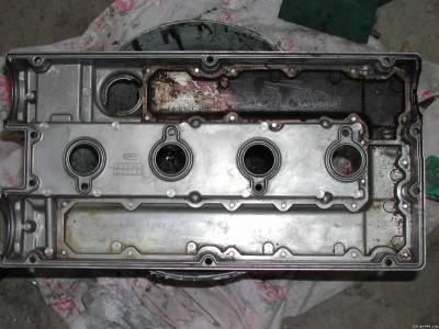

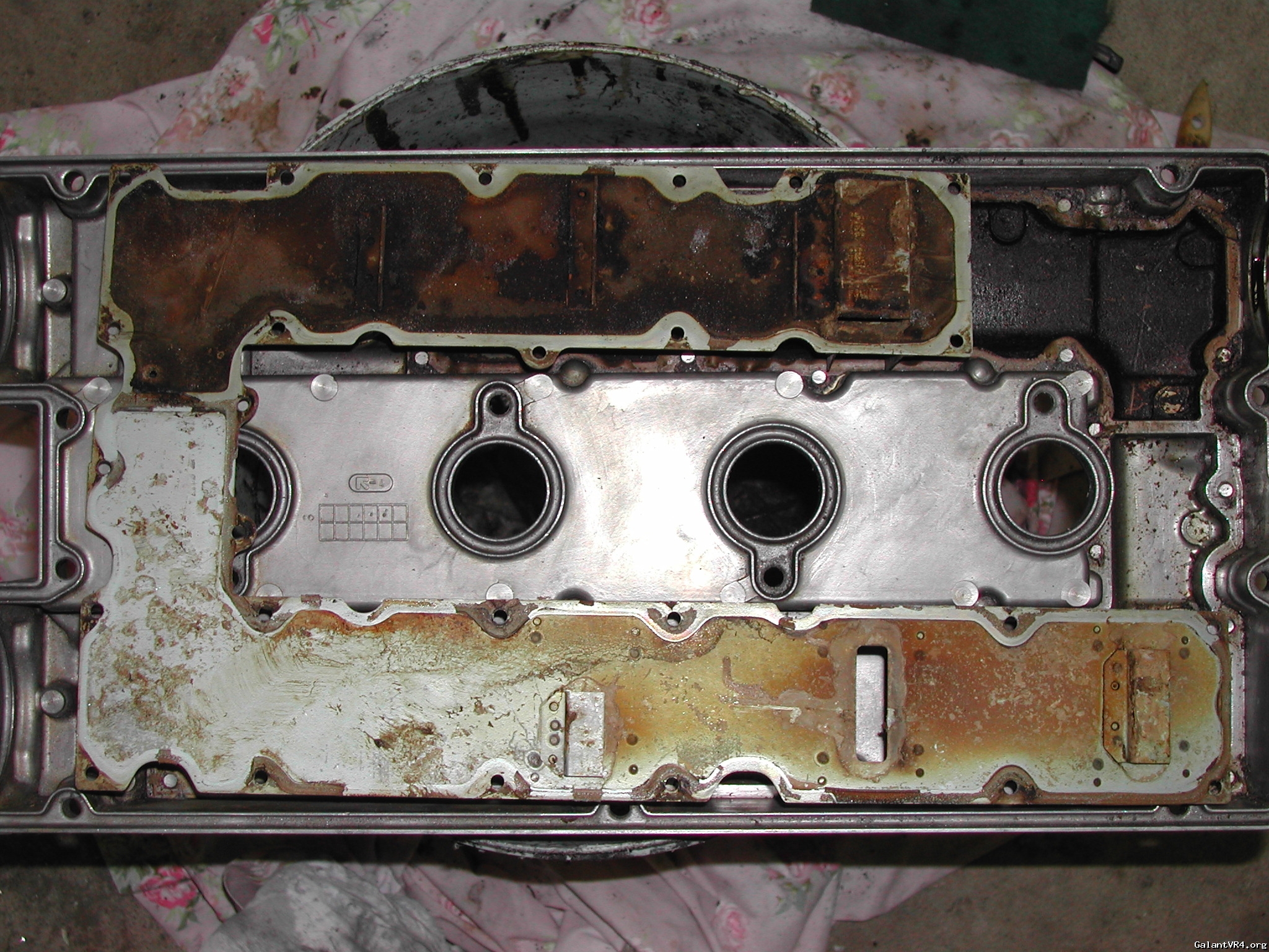

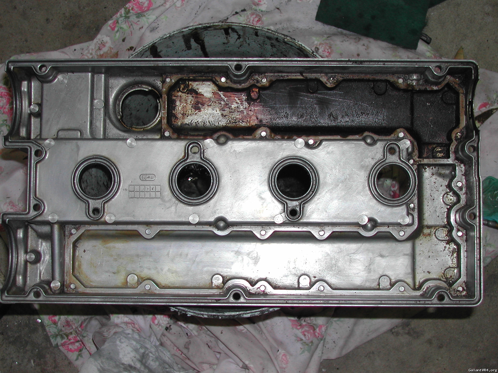

There are two separate chambers under the baffle. Here are a couple of pics. I don't think it would be a good idea to leave it off.
