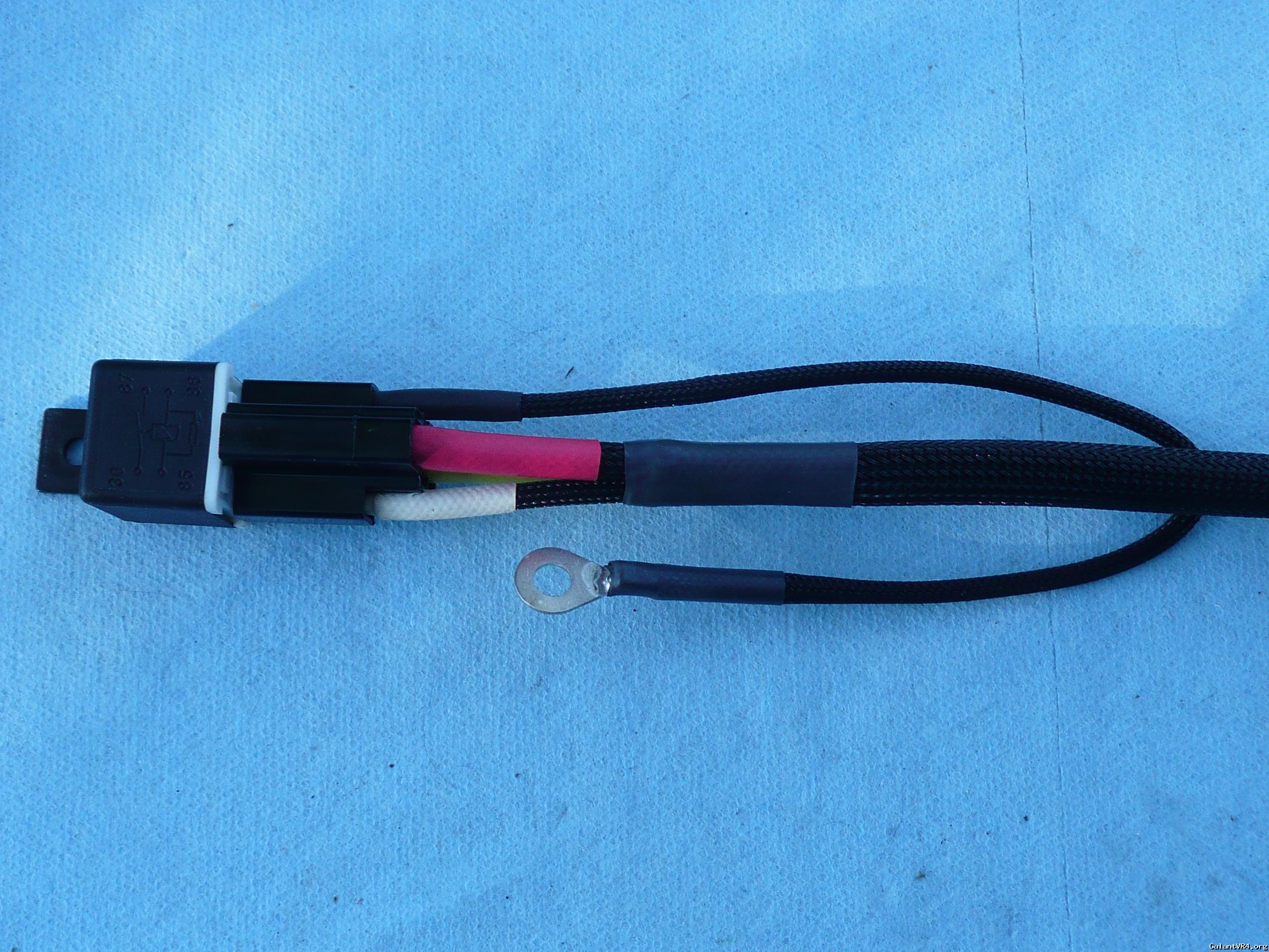

I have a TCI fan controller on my chevelle that is adjustable from 140 F to 250 F, IIRC and it was ~$75 (although I didn't pay that /ubbthreads/images/graemlins/smile.gif )...the problem I'm having a hard time finding is a good relay for the fan, since the fan draws 40 AMPS running and ~100 amps startup /ubbthreads/images/graemlins/ooo.gif (5,000+ cfm)
boom, baby
Easily handles 70 amp continuous, and has built in anti-flyback protection.
Got a bunch of these running around with zero issues.
If you would like, I can build you this exact set-up. (or whatever configuration you would like )
These relays are the real deal.
The contacts are rated for continuous duty electrical motors with half again more current draw than your set-up takes. (the relay legs on the power side are twice the size of standard h.o. bosch style relays
... like I said, zero issues /ubbthreads/images/graemlins/smile.gif
I can also pin up a cool guy Deutsch connectors to make future servicing easier.
Pm me for details. /ubbthreads/images/graemlins/smile.gif

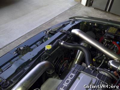

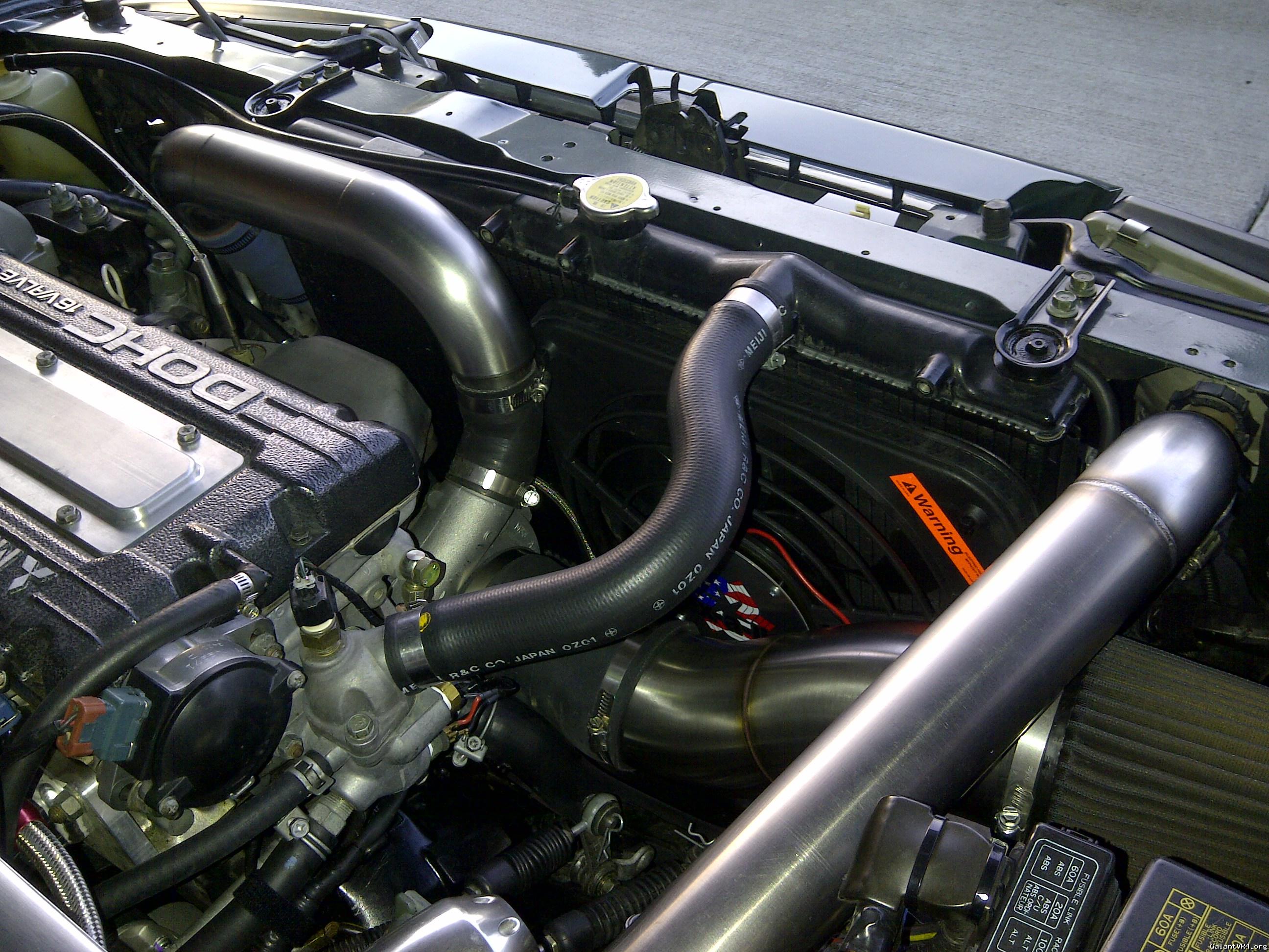

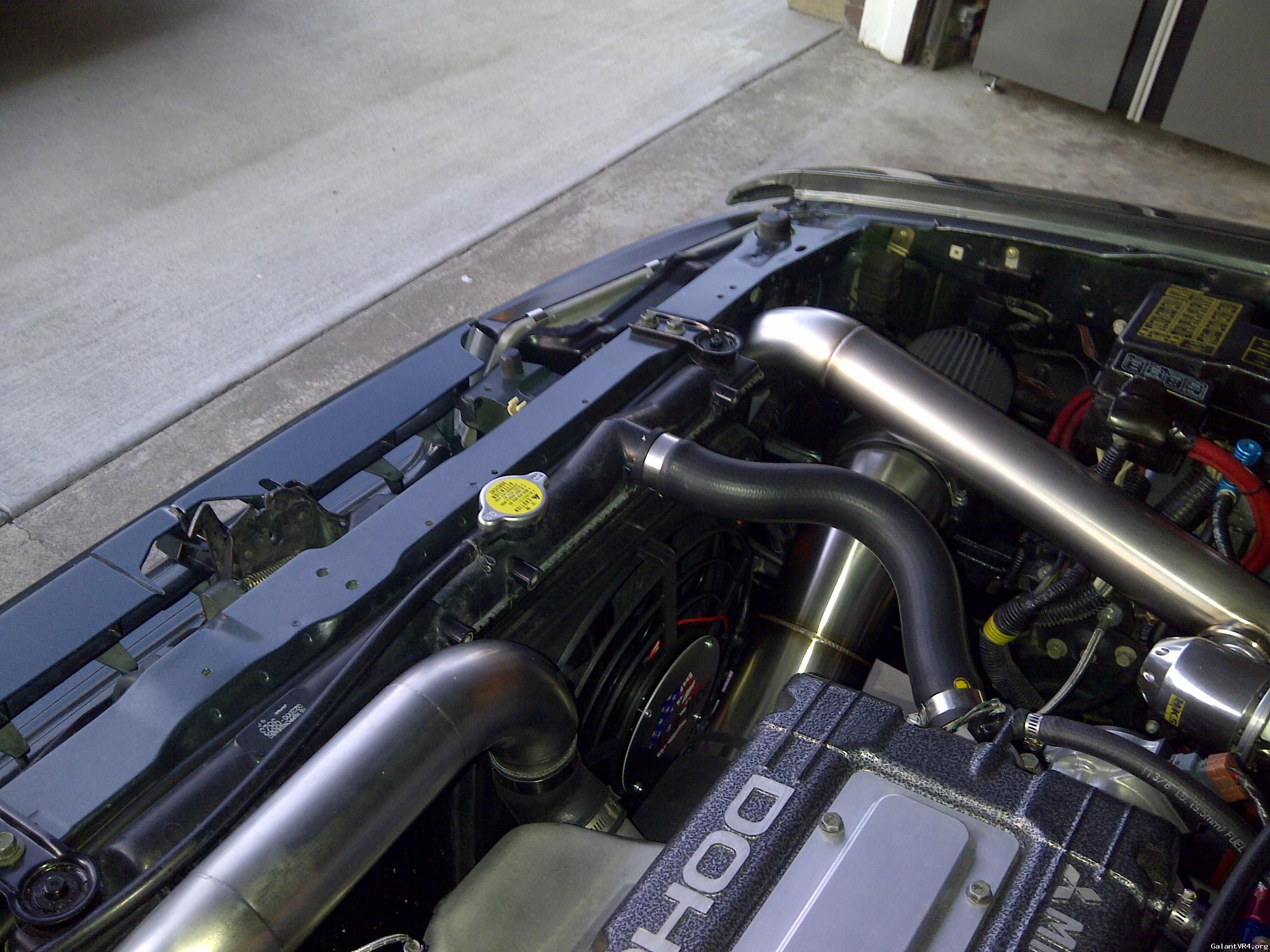

So I installed the new fan July 4th which required me to remove the radiator. So I reinstalled it and burped the cooling system again. I also realized that the low speed resistor was being finicky. I checked the one on 503 as well for the hell of it and saw that it didn't work at all, so I removed the resistor on both cars and looped the wires. Now when the fan first comes on, it comes on at full speed which I'm okay with. I just did away with the low speed setting basically. I'd like to add that this helped AC performance on both cars as well. Very noticeable colder output.
Anyway...I am now seeing much more consistent coolant temps, but I'm curious. Does ECMlink and Pocketlogger differ in temperature readings? I wanted to test this theory, but with ECMlink installed in the ECU, Pocketlogger doesn't seem to want to work. While my coolant temps are more consistent than they were with the old fan and air bubbles in the system, they are still higher than I'm used to seeing when I used to log the car with Pocketlogger. With Pocketlogger, the car would stay between 196-203. With ECMlink, I'm seeing temps between 200-210 with 206 being the norm. Could it be that the car has been running the same coolant temps the whole time, but I'm just seeing a difference due to two separate datalogging devices reading the temps that the ECU sees differently? I drove around tonight after work in 95 degree ambient temps and never saw coolant temps higher than 210, even with AC on. Car runs great under cruise and WOT conditions and doesn't push any coolant at all under full throttle. If this is normal, I'm okay with it. I just wanna make sure it is.
BTW, here are some pics of the FAL installed:
