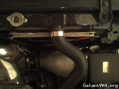

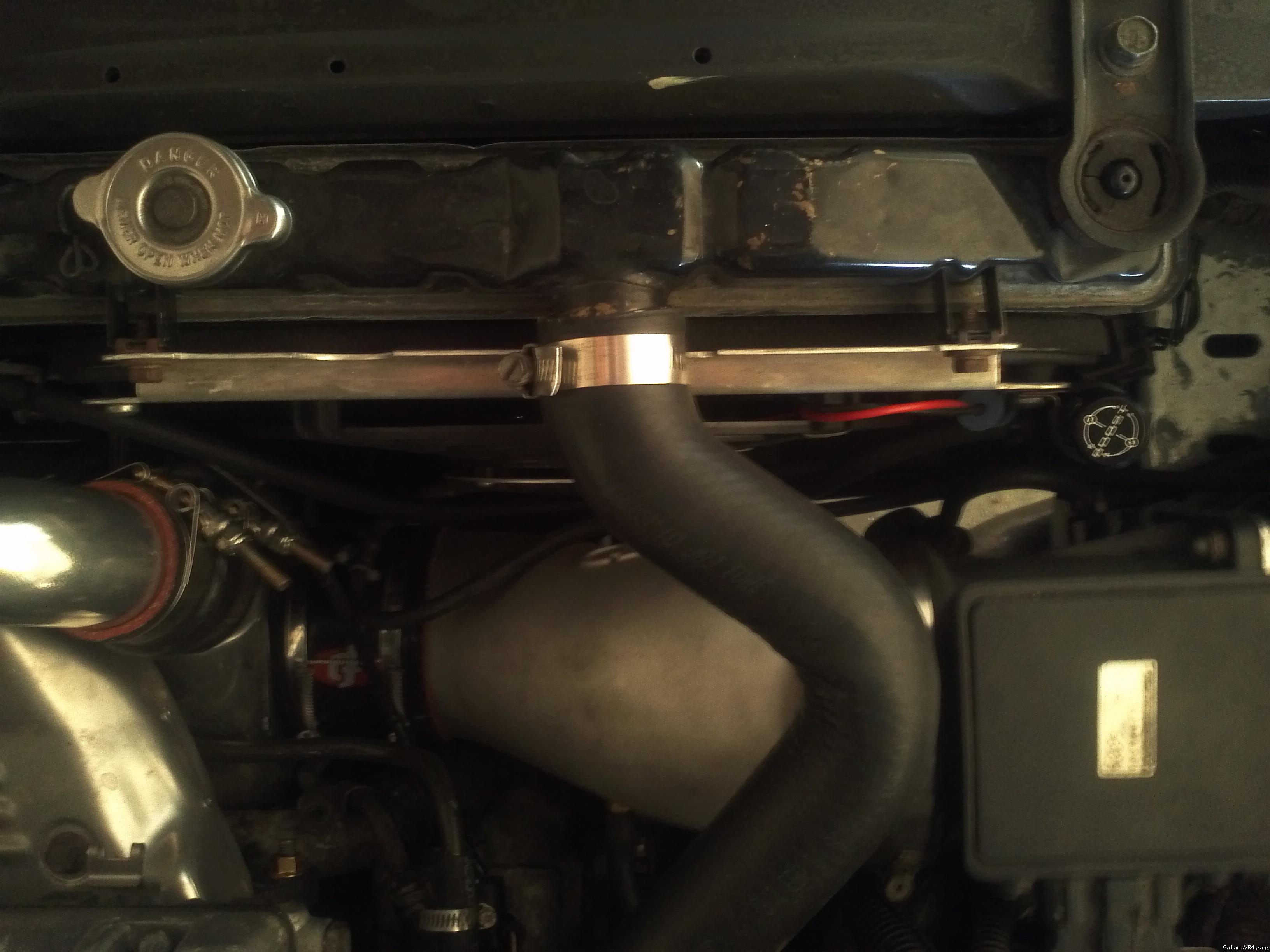

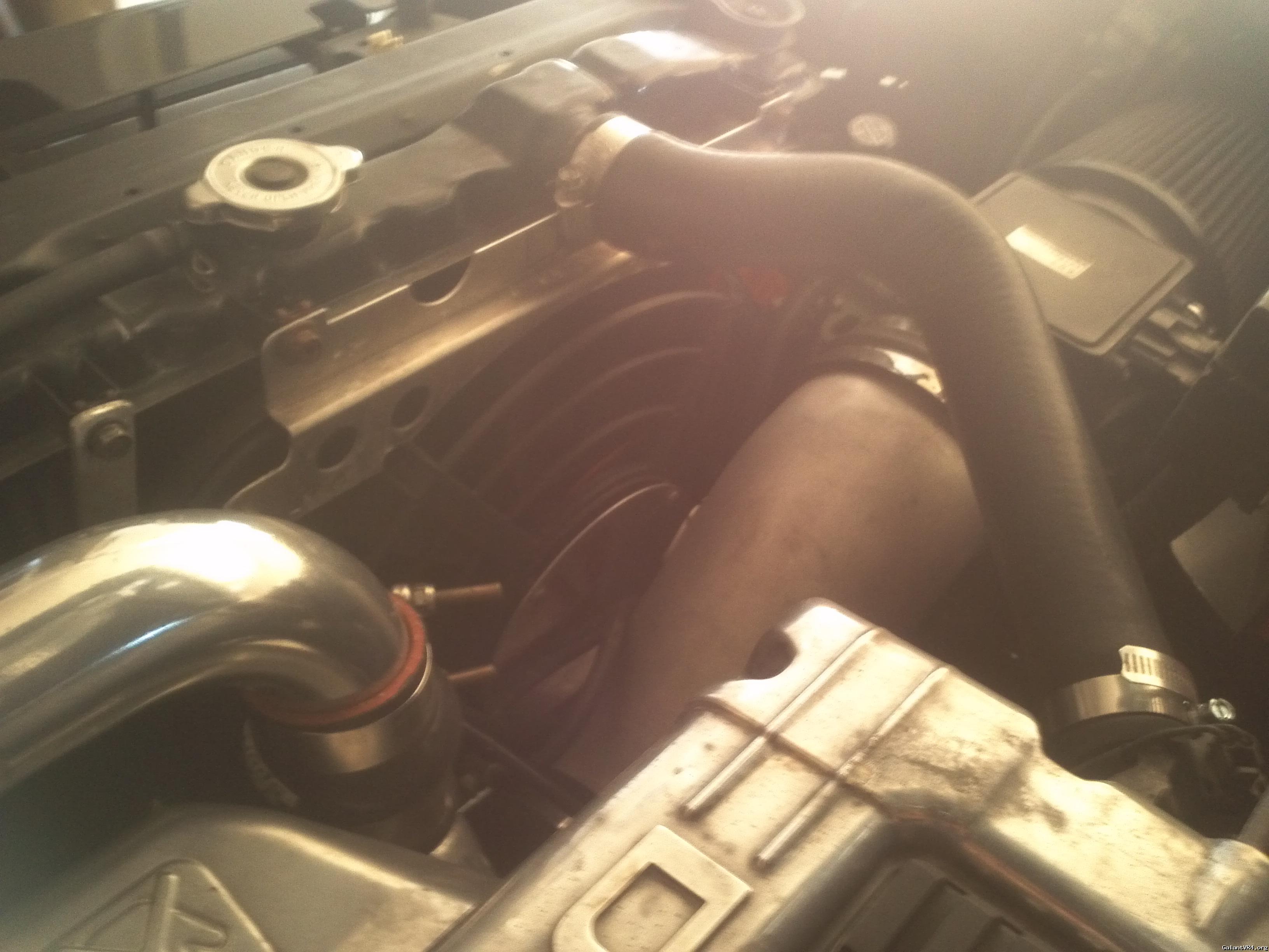

I'm using a bolt on FAL radiator fan for a Civic in my GVR4. FAL Fan Honda Civic It's a fiberglass bodied unit, with an integral shroud. Nice, compact unit. The brackets that come with the fan fit on the GVR4 radiator with a bit of trimming, and all I had to do was make a jumper plug for the GVR-4 fan plug to mate up with the Honda plug on the fan. Almost a bolt on operation, very easy to do.
One issue with the fan though, is the cheap rubber insulator that they use to provide a barrier between the shroud and the back of the radiator. Over time, this material starts to come apart and will get sucked into the fan, jamming the blades and fry the motor. Ask me how I know..... Bought another one, and installed it in the car. Car handles Texas heat and summers with no issues and I have enough clearance to run a larger intake pipe.

That fan is almost identical to the one I ordered. Good to hear it works and fits well. Do you have any pics of your setup?

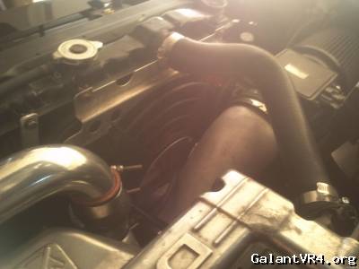

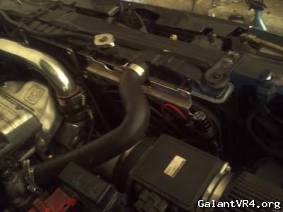

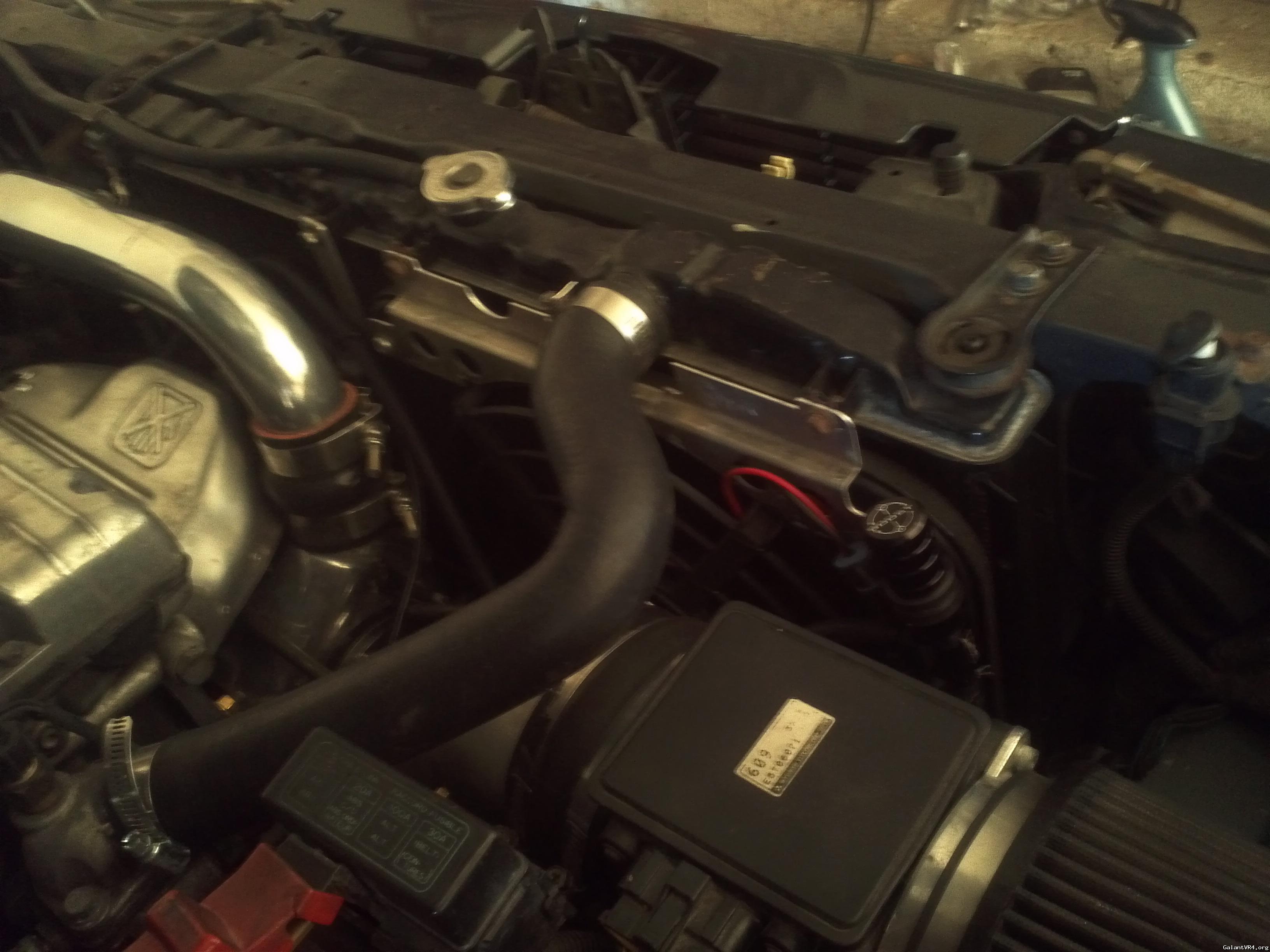

Mark,
Here's those pics. Sorry about the quality, but all I've got is my cell phone camera. Fan fits perfectly after trimming the top bracket, and provides plenty of clearance. Just requires some rewiring, and a little work, but it adapts well for use on the GVR-4.

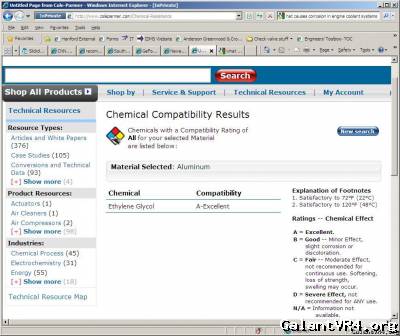

Ethylene glycol raises the boiling point of water, but depending on the (cap) system pressure, he'll probably be alright with DISTILLED water, as it is probably the best thing you can run (higher heat transfer rate) + it won't corrode aluminum like glycol does. I'd say run it too, so long as you're not boiling over water, although I'd say if you have 16 psi system pressure, that'd be ~250 F at sea level so you should be fine.

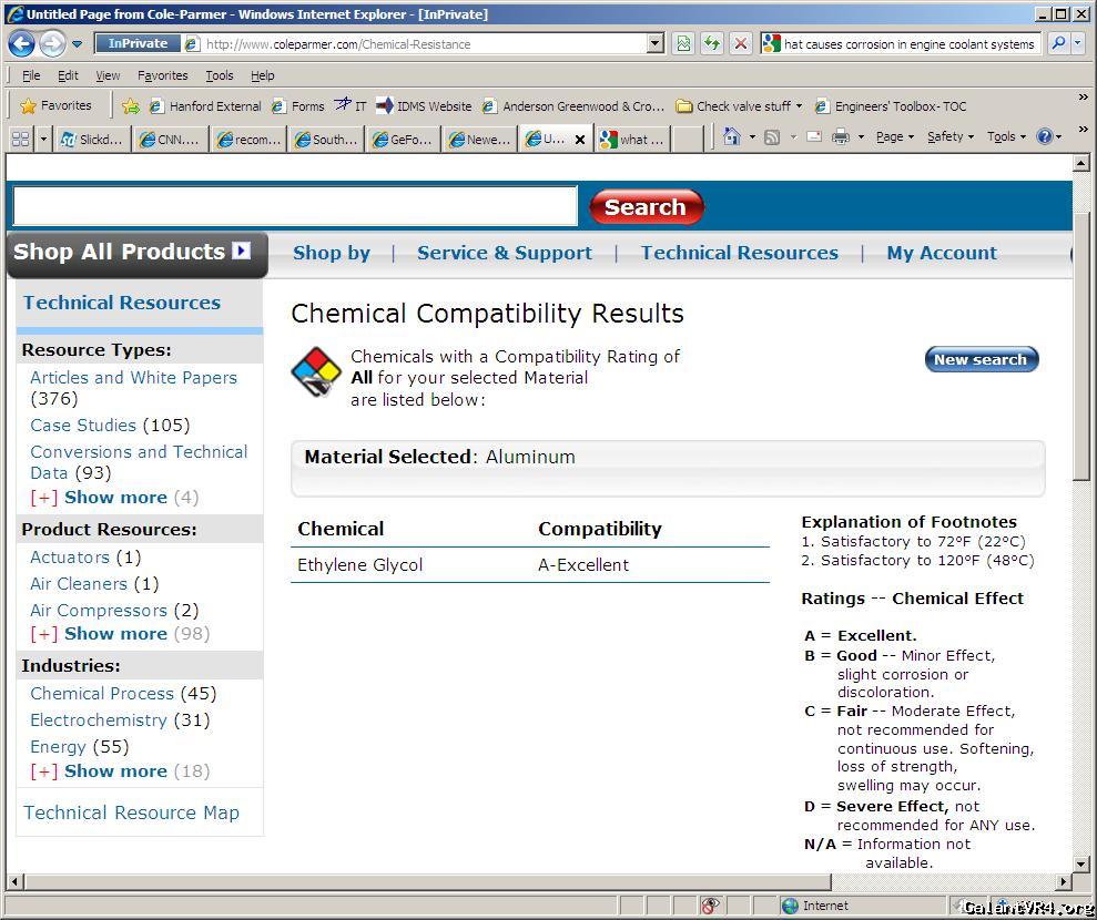

Since when does etheylene glycol corrode aluminum? /ubbthreads/images/graemlins/confused.gif

Quoting Barnes:
Ever look at an aluminum thermostat housing? However, some OTC coolants do contain additives that help prevent corrosion and especially if you don't use pure water.

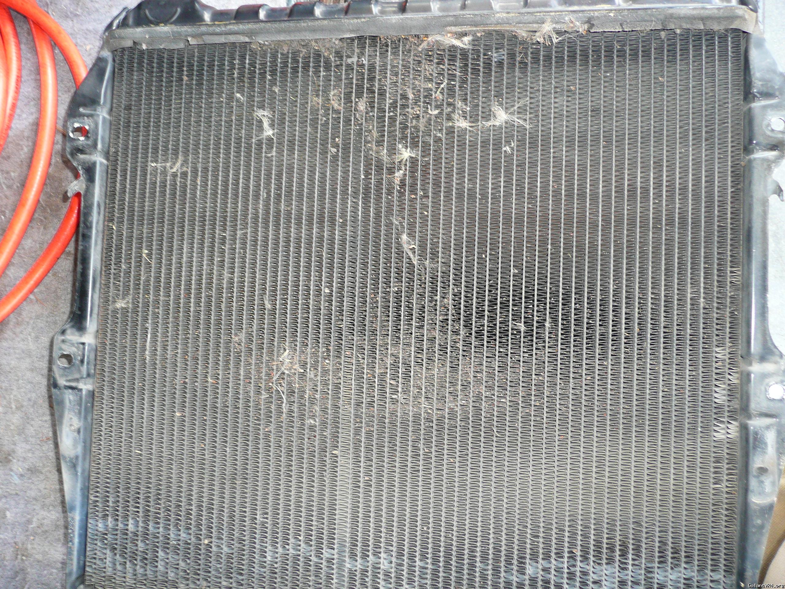

It's worth noting that problems with cooling a vehicle at low speeds can have many causes.
^^^ This is by far and large the biggest one that most folks never consider.
They'll bolt on the biggest/baddest fan they can, and leave the core filled with crap that impedes the airflow.
Back flushing the core with a stream of water will remove the vast majority of this blockage and lower the load on the system considerably!
Be sure to backflush the a/c condensor as well.
Straightening the fins will help a small amount, (but it's tedious as hell.)
Just this simple step has helped every vehicle achieve lower coolant temps and cut the fan cycling down considerably.
... and it's free! /ubbthreads/images/graemlins/cool.gif

For the record:
Also, Toybreak:
You make an EXCELLENT point. When I was doing a bunch of maintenance on my '98 Camry with 200k miles at the time I did this. However the only reason I washed the radiator core was due to all the bugs. However when it came time to actually wash the core, I was AMAZED at how much sand/dirt/grit came out. I had to give my driveway a serious cleaning after that.
