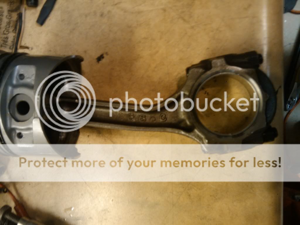

Very careful with the timing. The evo3 can spike around 35 psi at a really low rpm. If you don't have a really good way to tune you end up with this.
