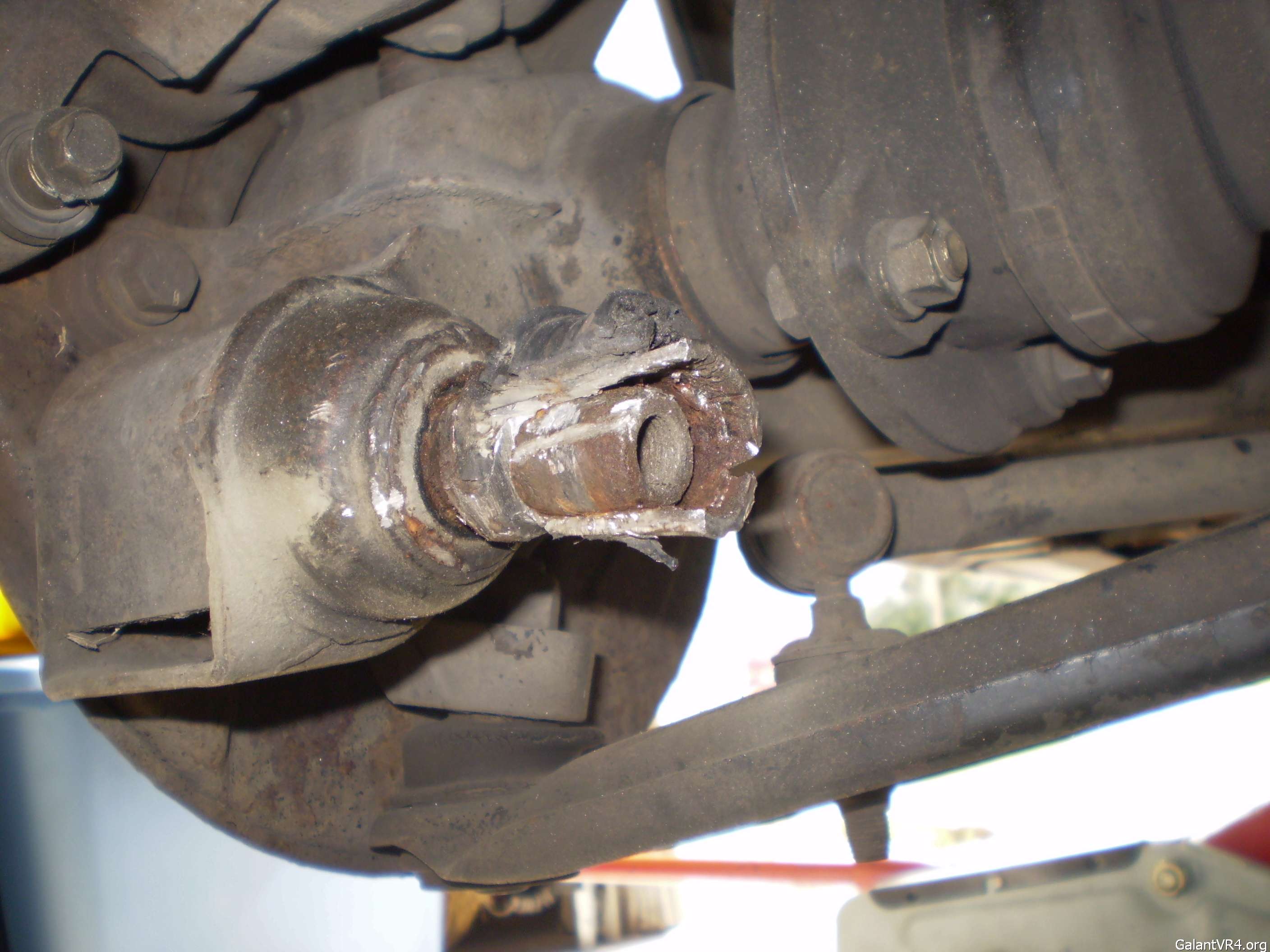

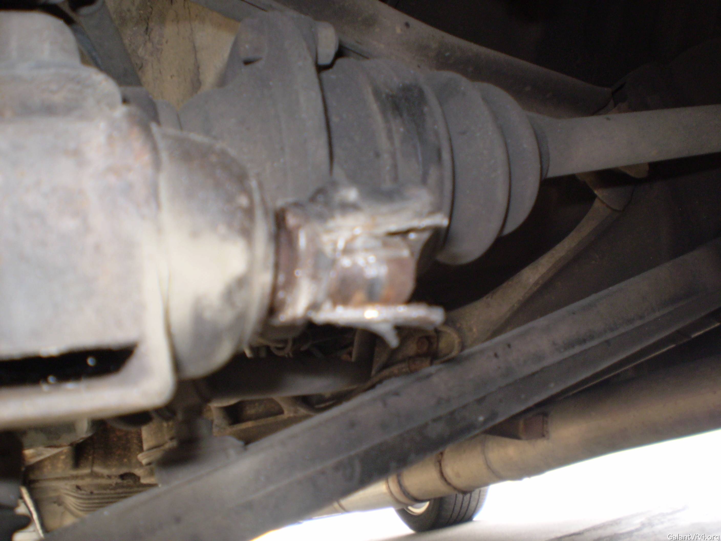

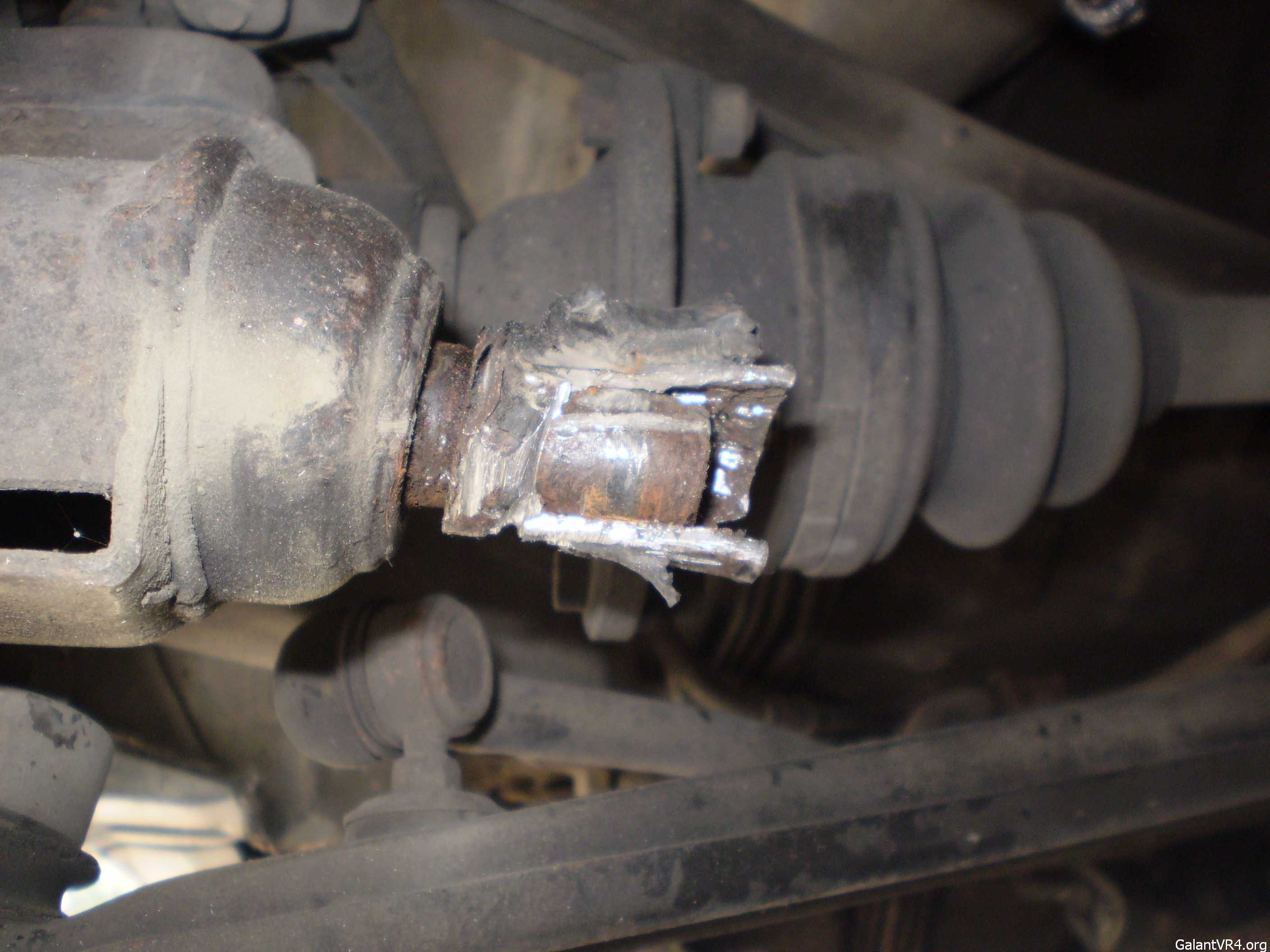

Sounds like you had the same problem as me. I went through hell trying to remove the original rear shocks on mine. I eventually had enough and mangled the insulation to seperate the shock from the shaft slot. I removed the remaining rubber insulation and took my air grinder and cut a slit enought to where I could get a flathead screwdriver and hammer to seperate it from the knuckle shaft. Here are some pics of the aftermath...you'll get the idea and get creative.
