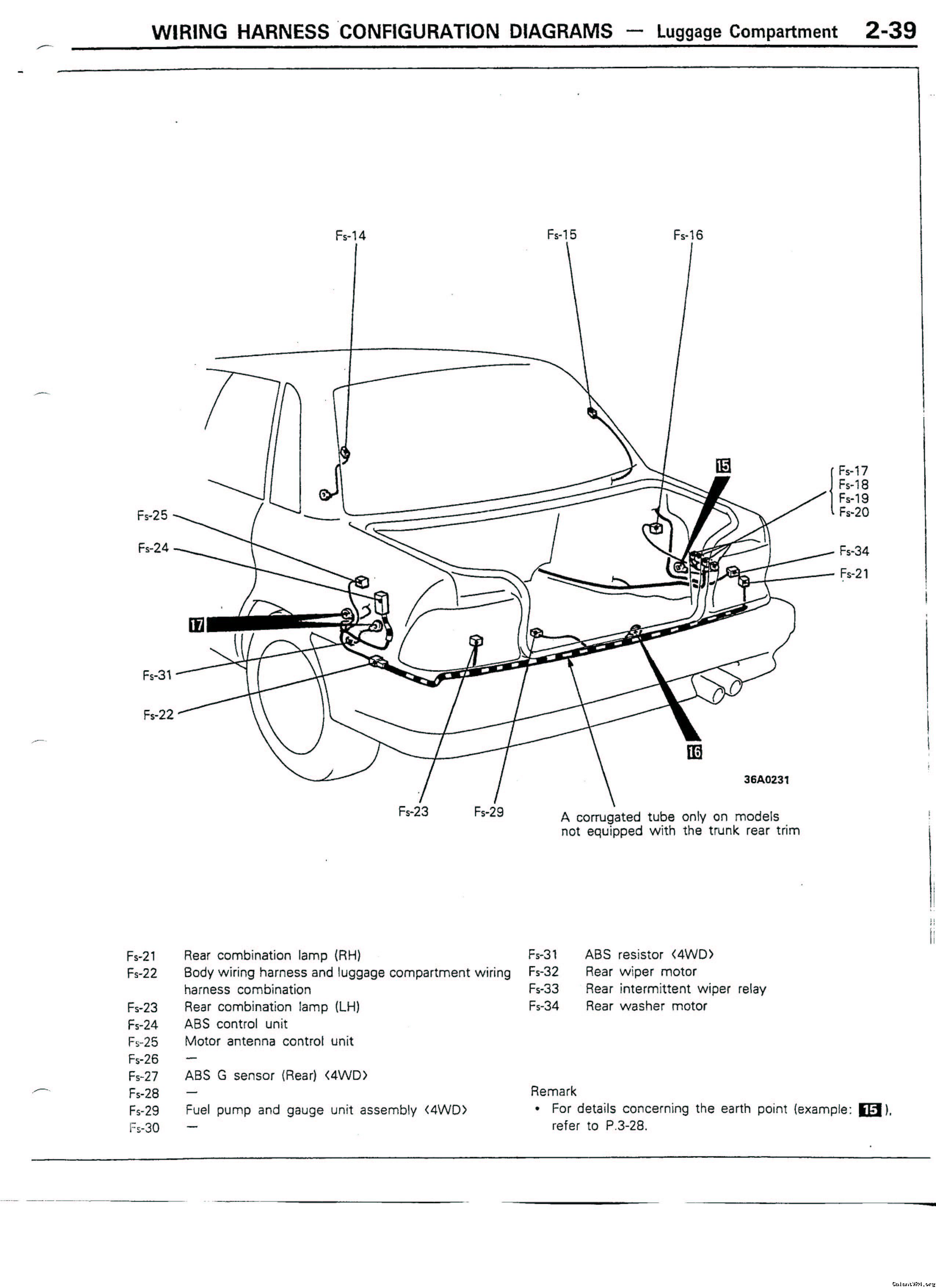

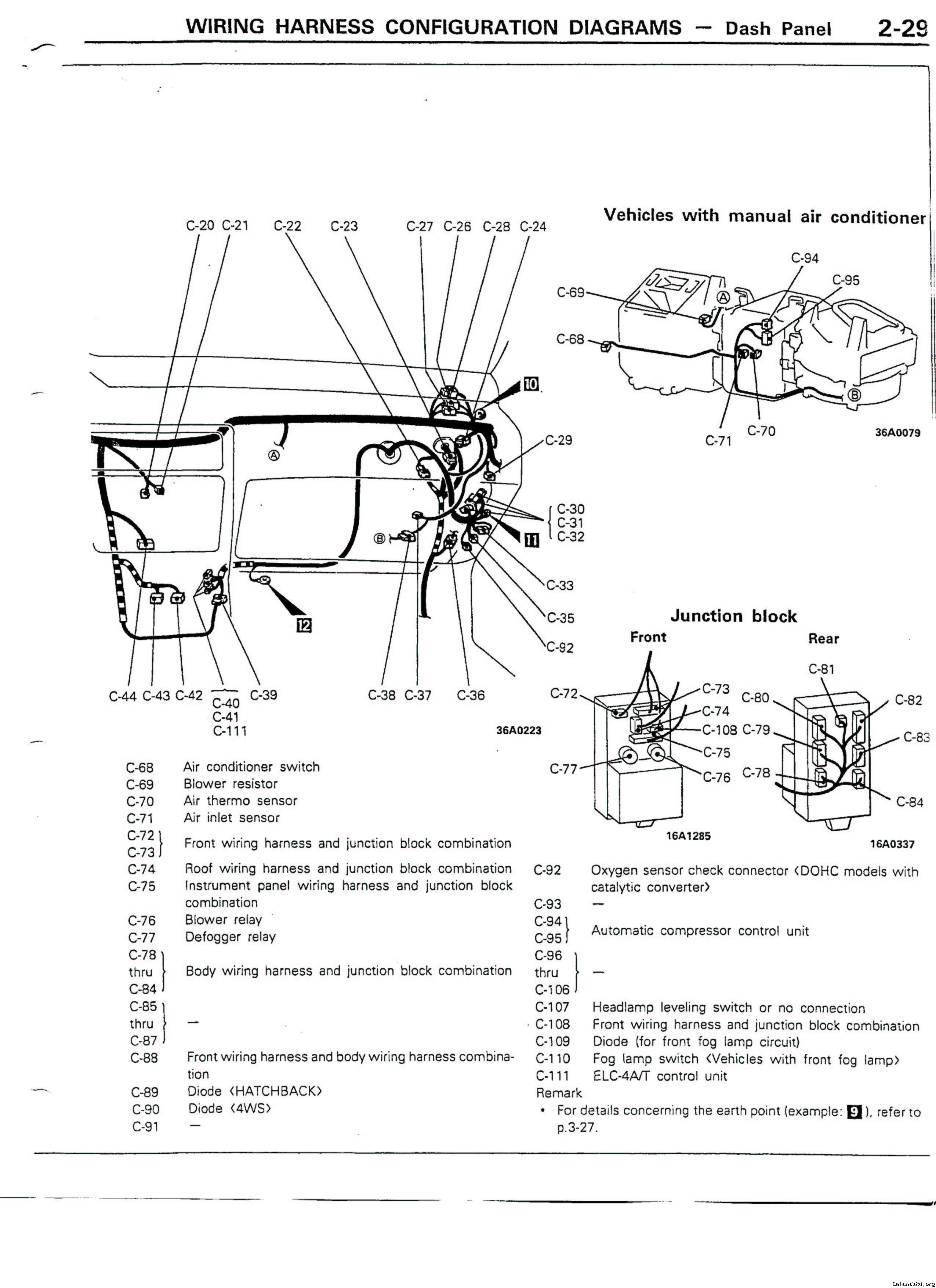

read the discussion on the 'General' threads...
thought someone from our Europe/UK brothers may have wiring diagrams which could help wire the thing up
any help would be appreciated
thanks in advance.

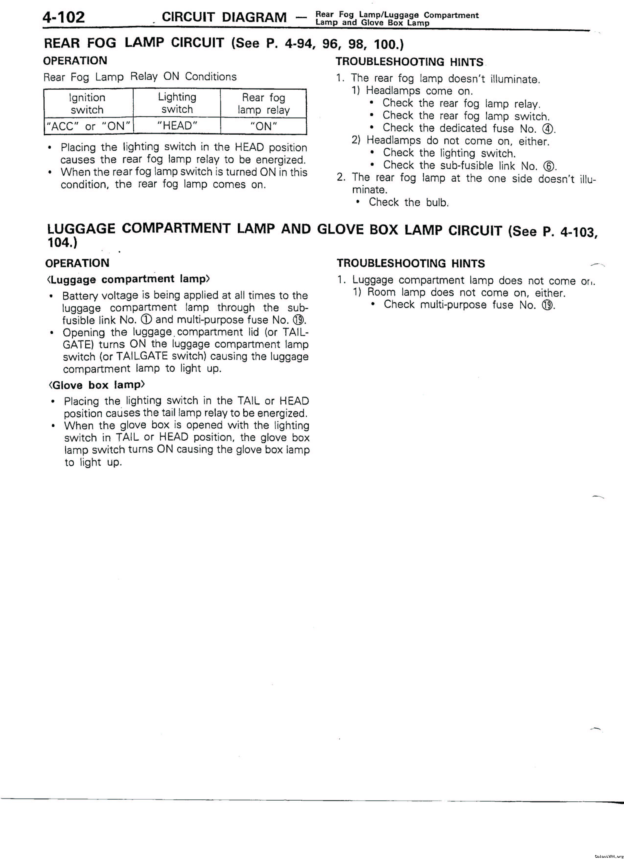

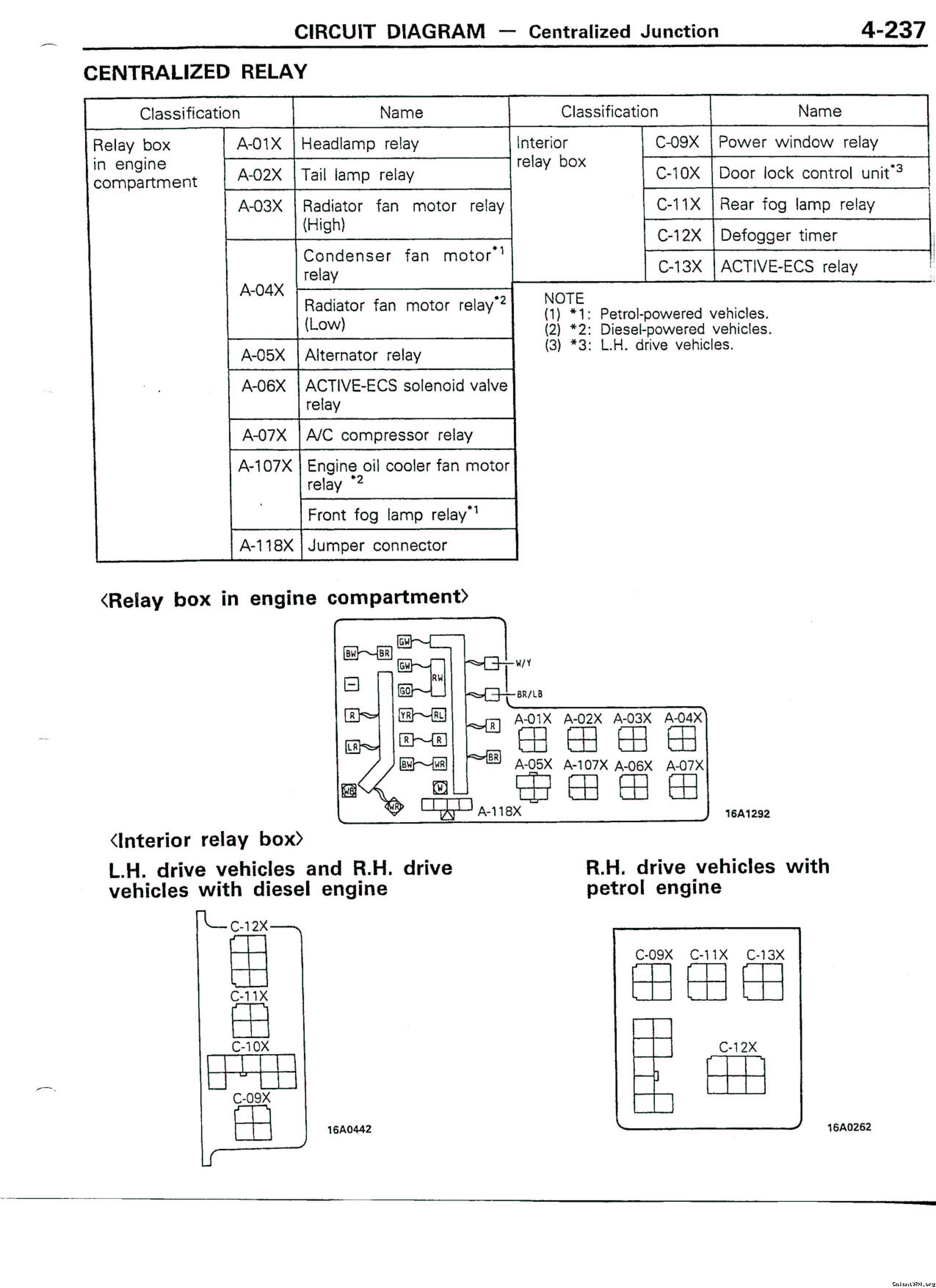

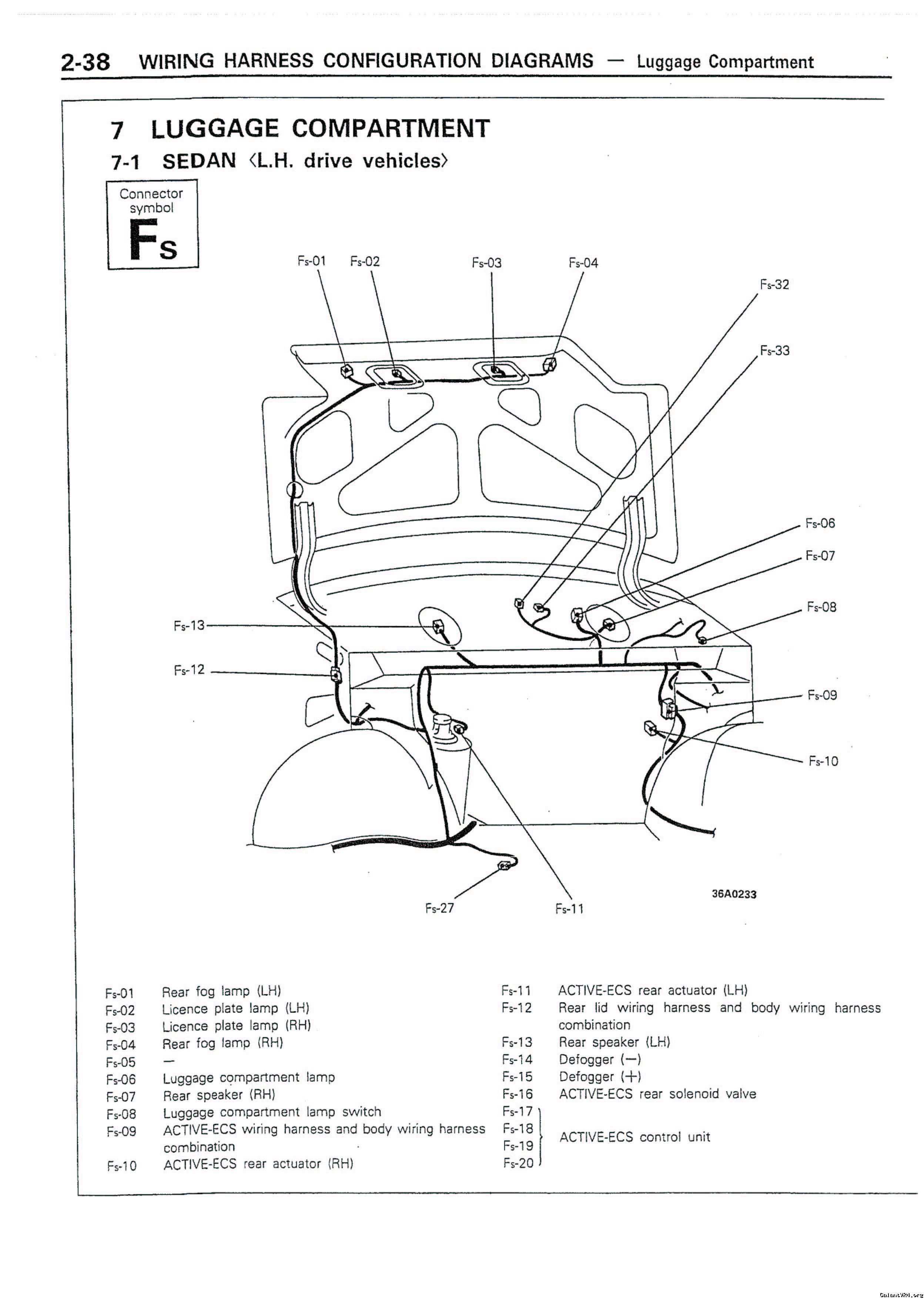

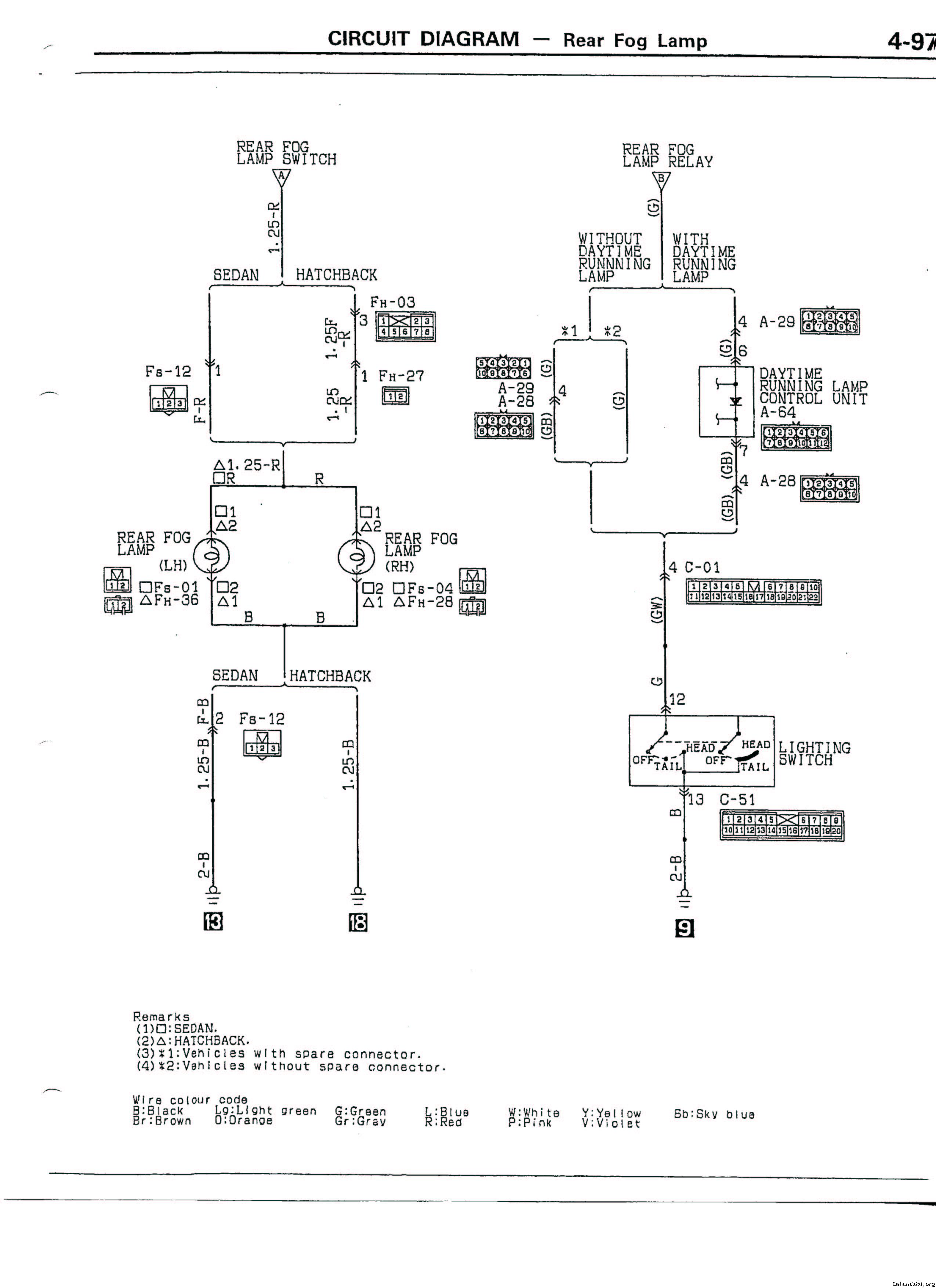

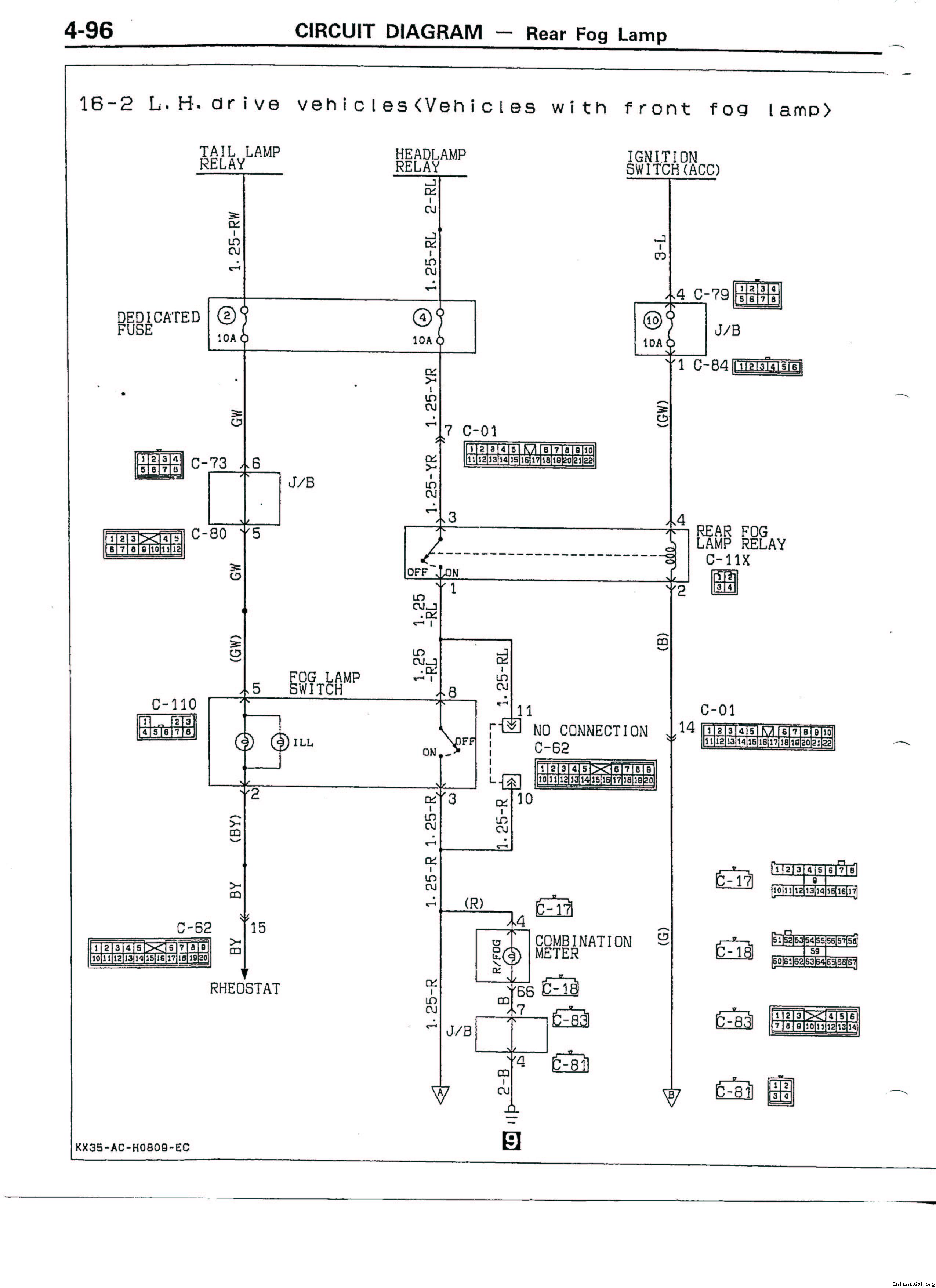

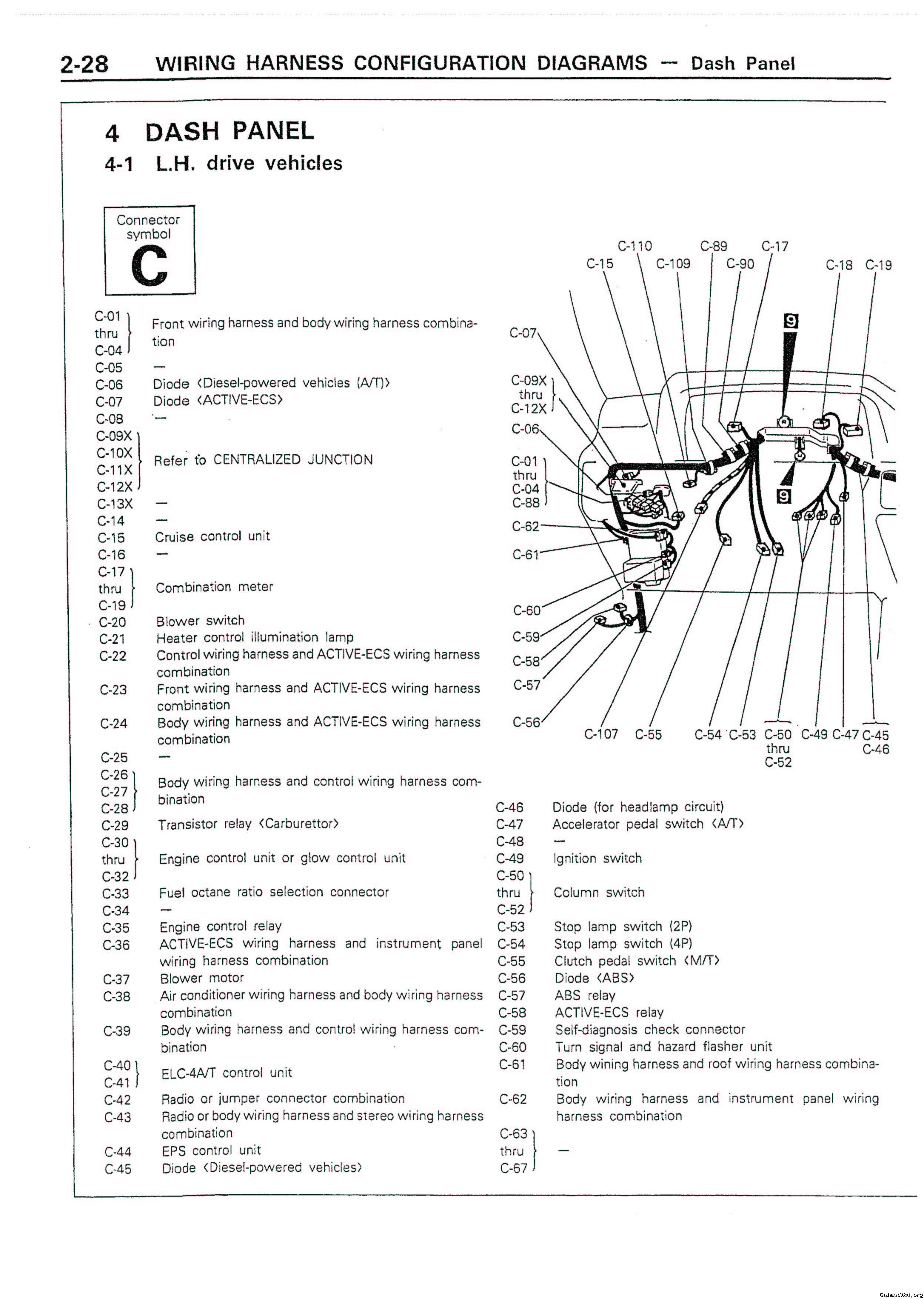

Yup, got the wiring diagrams.. be a few days before i can have a chance to get them up. what year is your car? fuse/power distributuion changed in 1989.10 and i think but cant remember if you need a diode for the telltale light in the dash.. Anyways its been a while so i'll dig the diagram and go from there.
Why do you want rear fogs? ooh and don't forget to give me the year of your car
