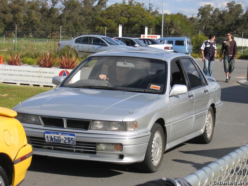

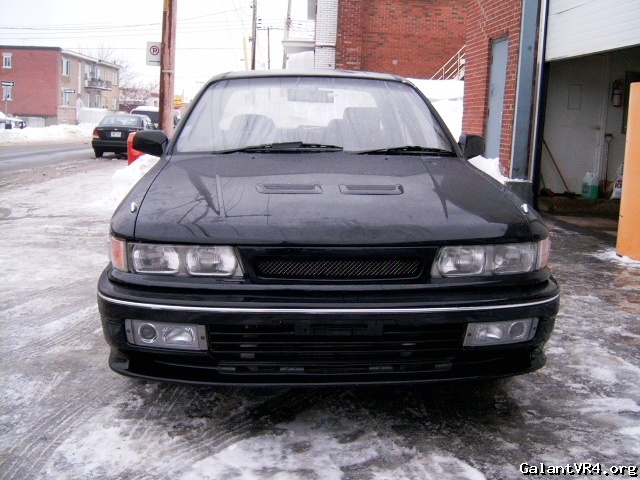

Here is a comparison for facelift vs pre-facelift front ends for you.
1.Pre-facelift, indicators in bumper with fogs lights.
2. Facelift.
If you go with the facelift option you will need to convert your corner lights into indicators and I would also put in a set of facelift headlights with the city lights ( park lights ) in them.

Interesting, I didnt realize there were two different fronts. It looks like the only difference is the fogs, correct?
brisvr4
Feb 13, 2004
955
brisbane australia
Pretty much, the pre-facelift bar has the turn signals in the bar with the fog lights while the facelift has them up next to the head lights.
Facelift also has the park lights in the headlight.
There is also a difference in the way that the fogs mount in each bar too.
The prefacelift has a vertical bar in the centre of the hole where the fog light bolts in.
