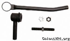

I picked up:
RAYBESTOS Part # 6111101
RAYBESTOS Part # 6111102
From rockauto.com They look alright, should do the job just fine. Make sure you order a set of MEVOTECH Part # MK9617 with them.

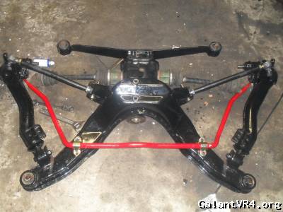

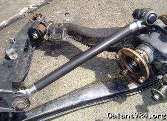

I purchased these. for the Galant.
Shipped fast, and they work just fine.
Not the greatest of pictures, and not even fully put together. But you get the idea.

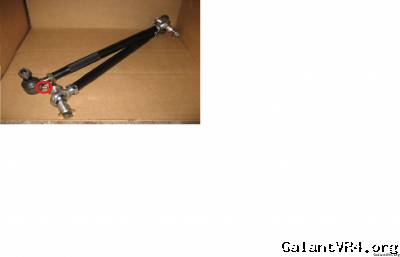

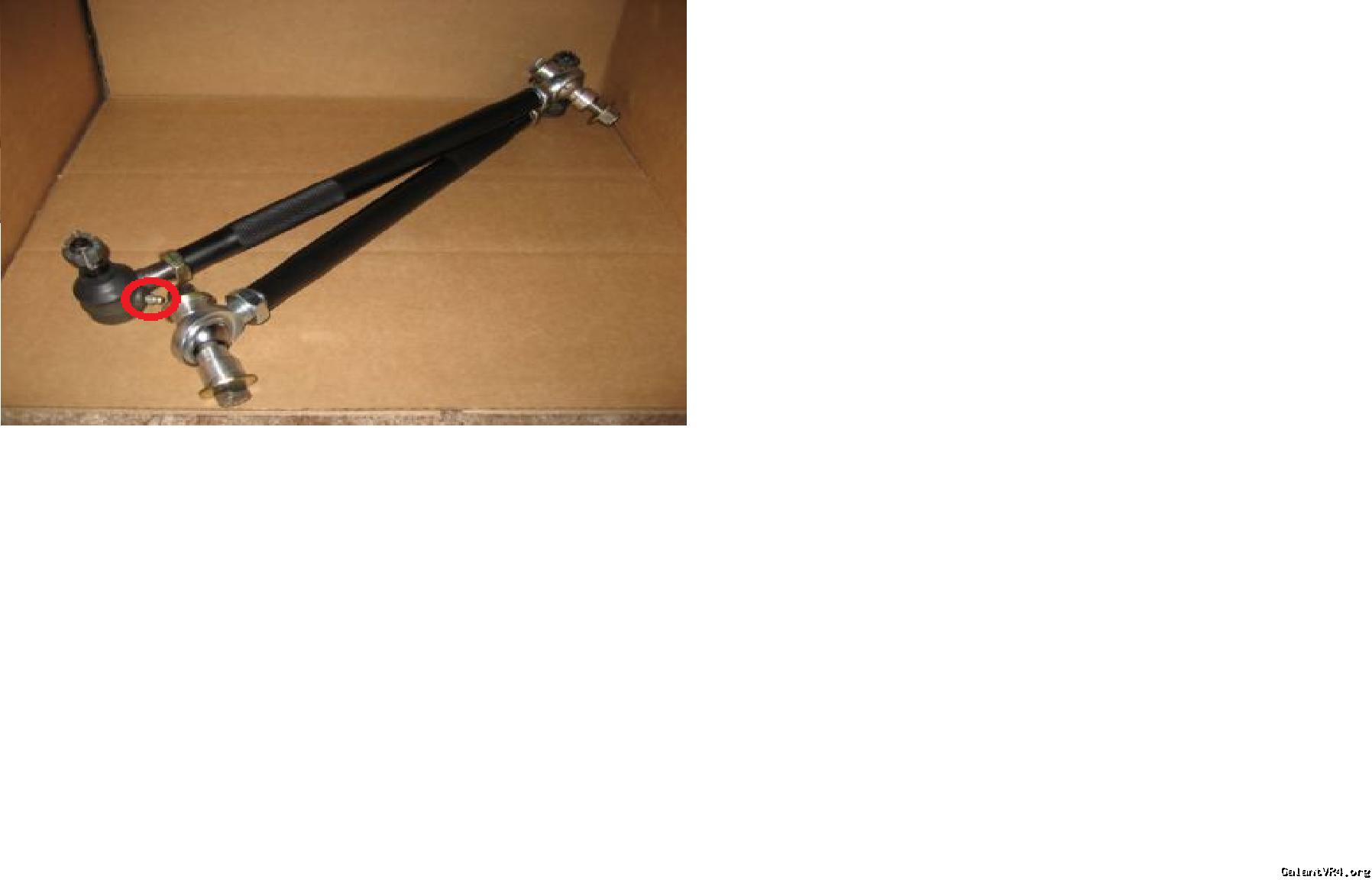

The fitting, circled in red. Is a grease fitting. It allows grease to be pumped throught the fitting, and into the balljoint.
Super simple to do, just friend a friend with a gtrease gun and have him/her do it. Or bring it to a shop or something and just ask them to do it.

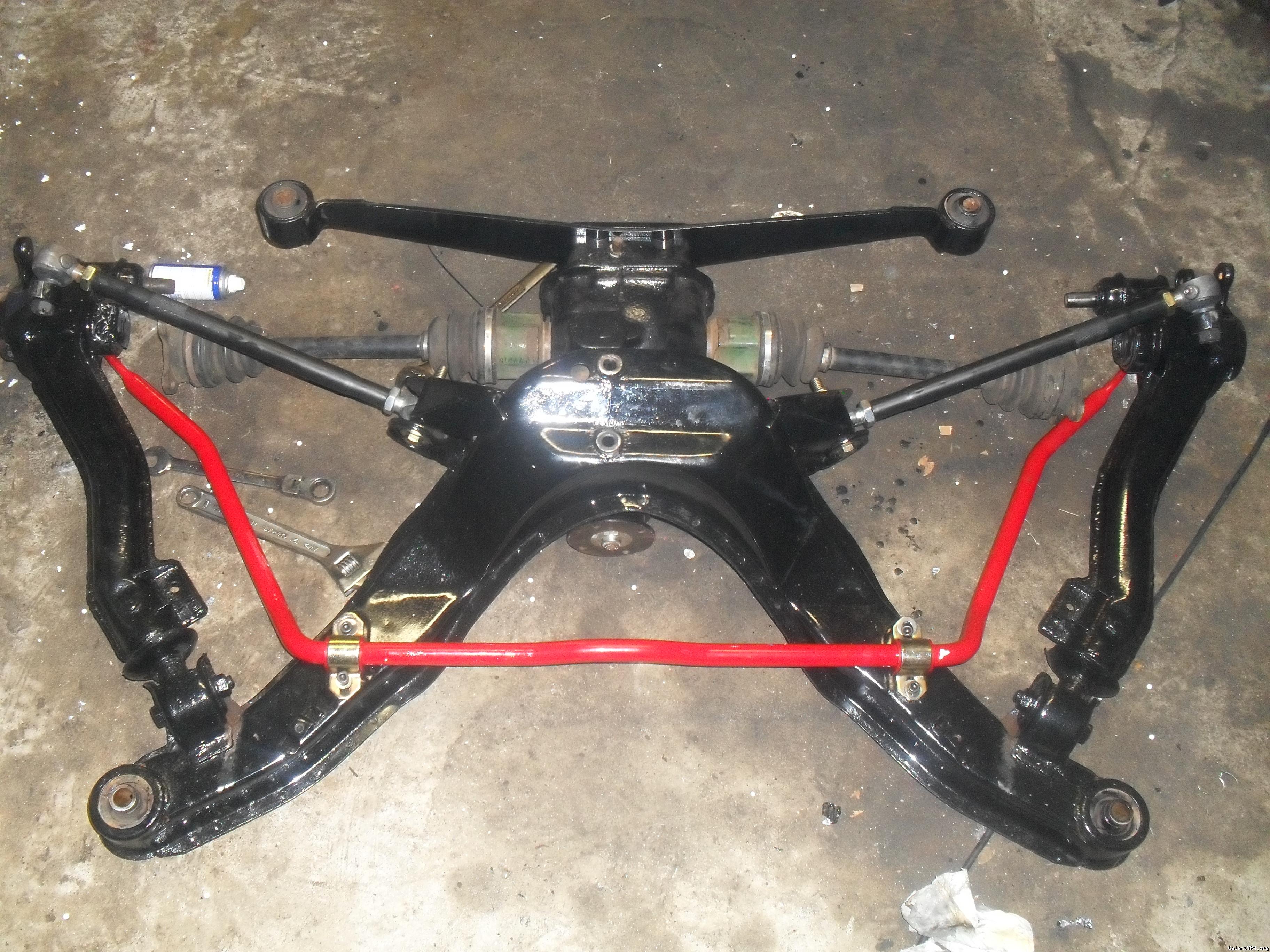

I dropped my AWS rear subframe, and had one already built-up to put in its place. The one in the picture.
Went from:
AWS, ABS, 3bolt rear end, stock sway bar. bull
To:
4bolt, RM swaybar, new oem endlinks, poly mounts, *Chromoly upper adjustable control arms, clean looking rear end.
Only two outter tie rods /ubbthreads/images/graemlins/grin.gif
