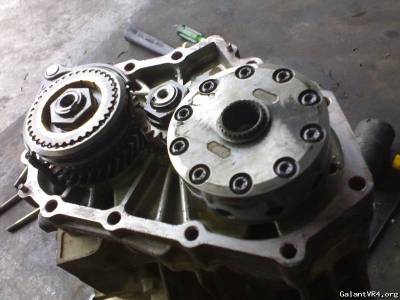

I have seen a pic of a clutch lsd that fits in the stock vicous location. Has any see or know anything about these???

so no one has an idea on the vc replacement? Would something like that be beneficial? A clutchpack replacement for th vc or would this be a waste of time? thanks.

Anyone who has used one of these or simply understands the physics of these a little more can you spell out why they work to counteract understeer? Am I correct in assuming they require more of a torque split front rear before locking up and therefore let the rear end go more before transferring power forward allowing the car to rotate further before 'catching' the tailslide.
If so, would one of these work well in conjunction with a centre differential that offered a rear biased split?
^^+1! I'd like to hear more on this. I've been digging around here looking for all the info I can on alternatives for center diffs. So far the Cusco tarmac diff + stock VCU looks like a great option. How does the ralliart VCU affect front end push?

I recently found a thread on tuners about a Japanese built adjustable clutch plate coupler that replaces the stock VCU. The description seems to suggest that it does pretty much the same as the Ralliart VCU except that the plates inside the housing can be adjusted so that the user can change how much torque is sent to the rear.
Apparently they were discontinued a while back but a contact of mine somehow talked them into to reproducing one for me but on the proviso that I make a decision to move on it quickly. It's not cheap (120,000 yen) but with Ralliart gone or on the way out, this may be the last thing available to do what I want. Apparently this came out of an EVO III transmission. Does anyone know if there is any difference between our couplers and those used in early EVO units?
No difference Paul. They will slide right on.
