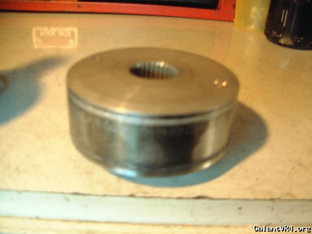

Anyone know anything about this one?

This could be a early Group A viscous..I remember the motorsport viscous couplings being numbered like thisQuoting Bimmubishi:

The ralliart part number actually refers to a Evo 1-3 CD-CE9A Lancer Group N viscous coupling..I can enquire with ralliart nz if anyone is interested..
