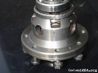

I am going to look at a 91+ 1g lsd. Seller states its a genuine Ralliart unit. Anyone have any info on these? Any identIfiable castings or markings? Google is very weak in the info area. Thanks for any help!

There's some pretty obvious differences if you look at the shape and location of all the openings in the exterior housing.

Thank god for this forum because I knew what to look for!!! Come to find its an Evo3 unit without the axle! Junk! The kid was offended like I was being extremly rude when I said it was useless! He picked up the phone, called a friend and stated, "I found the axle for you!!!"
I passed! Ive been down this path and the part isnt worth the time/energy/$$$ to make it work!! My understanding is you need the axle and something about the gear bolt pattern is different(?). About right??? Also rumored it wont fit in the VR4 case???
