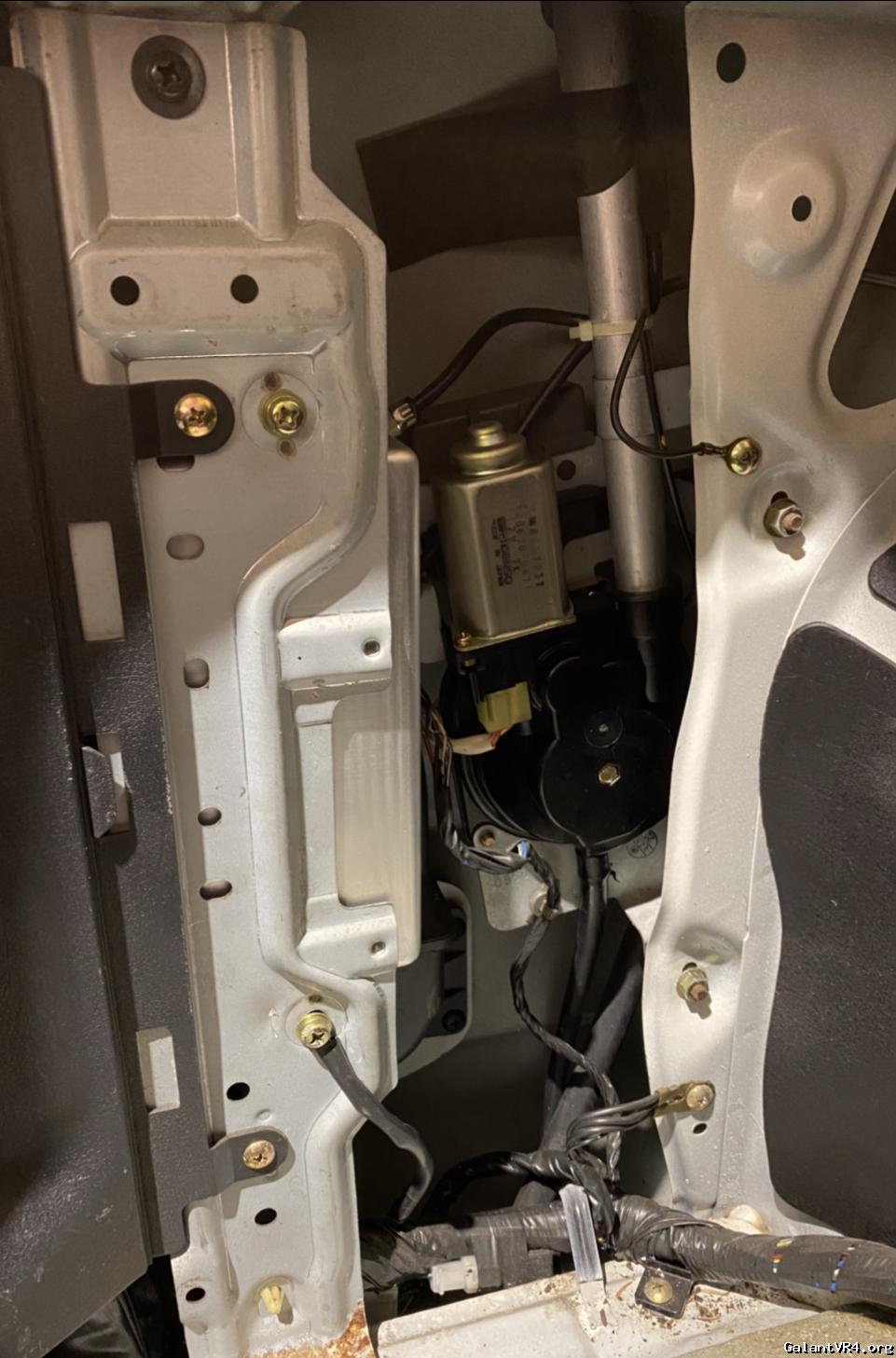

The amp is (or would have been) mounted in the left rear corner near the antenna and ABS computer. It is behind the trunk inner trim.
