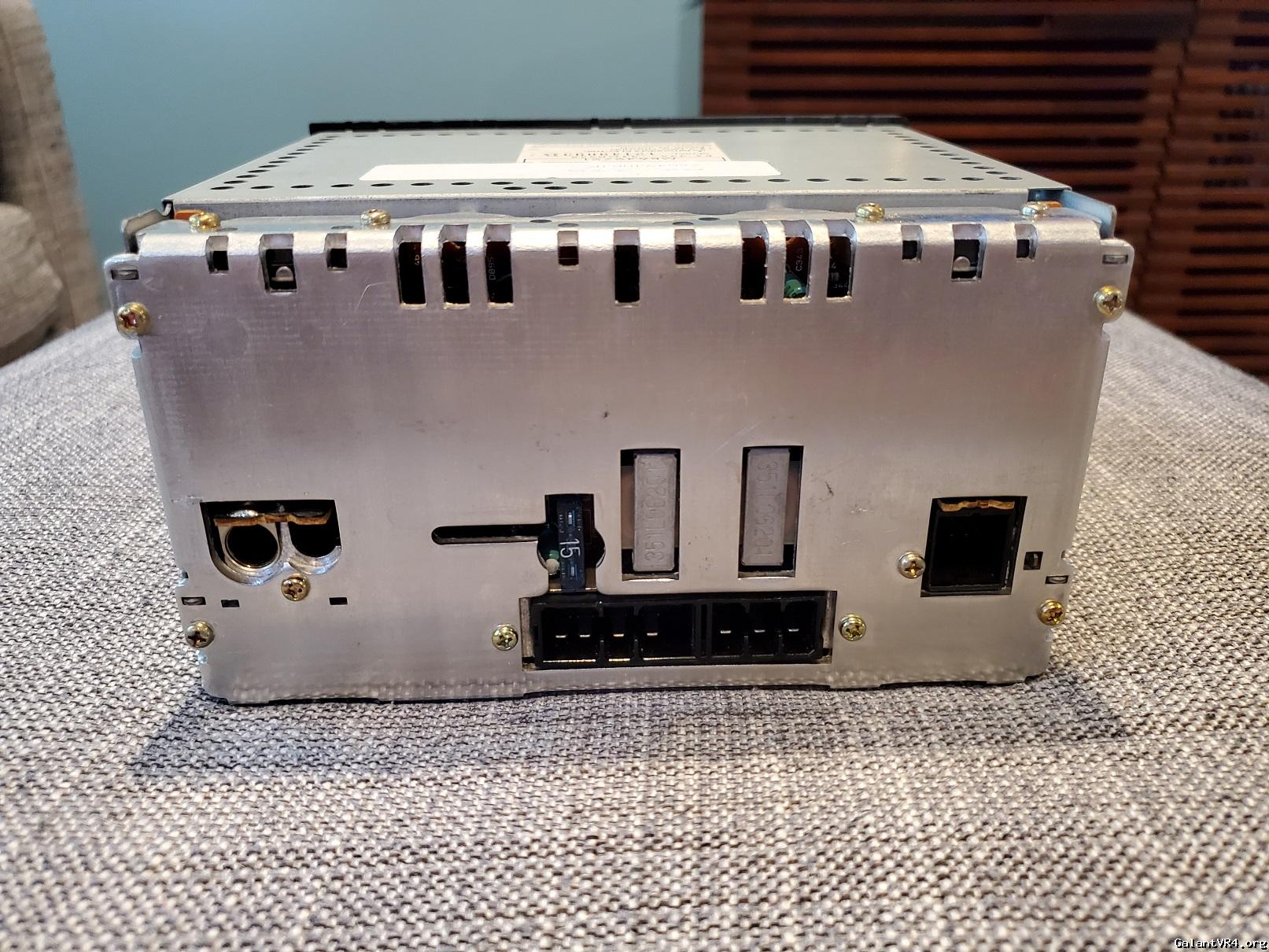

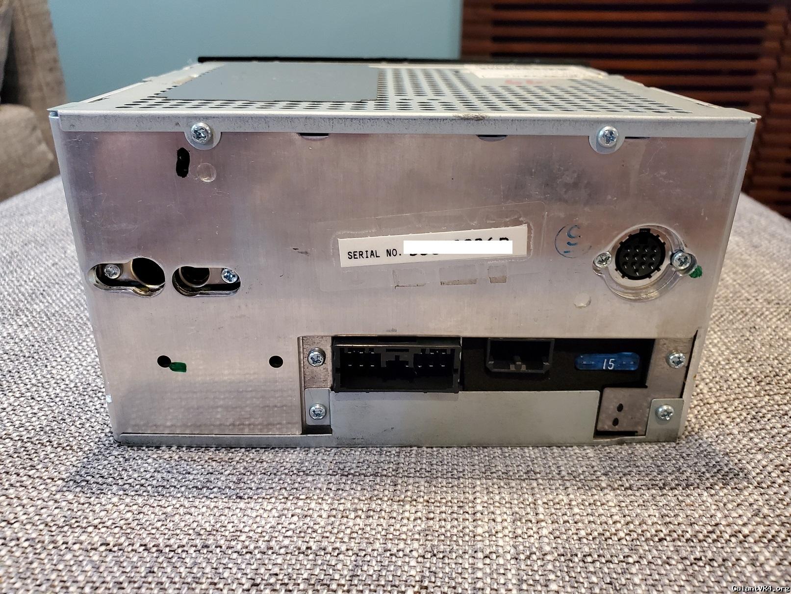

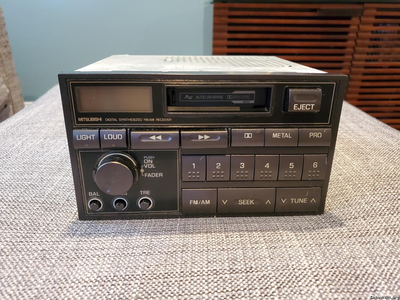

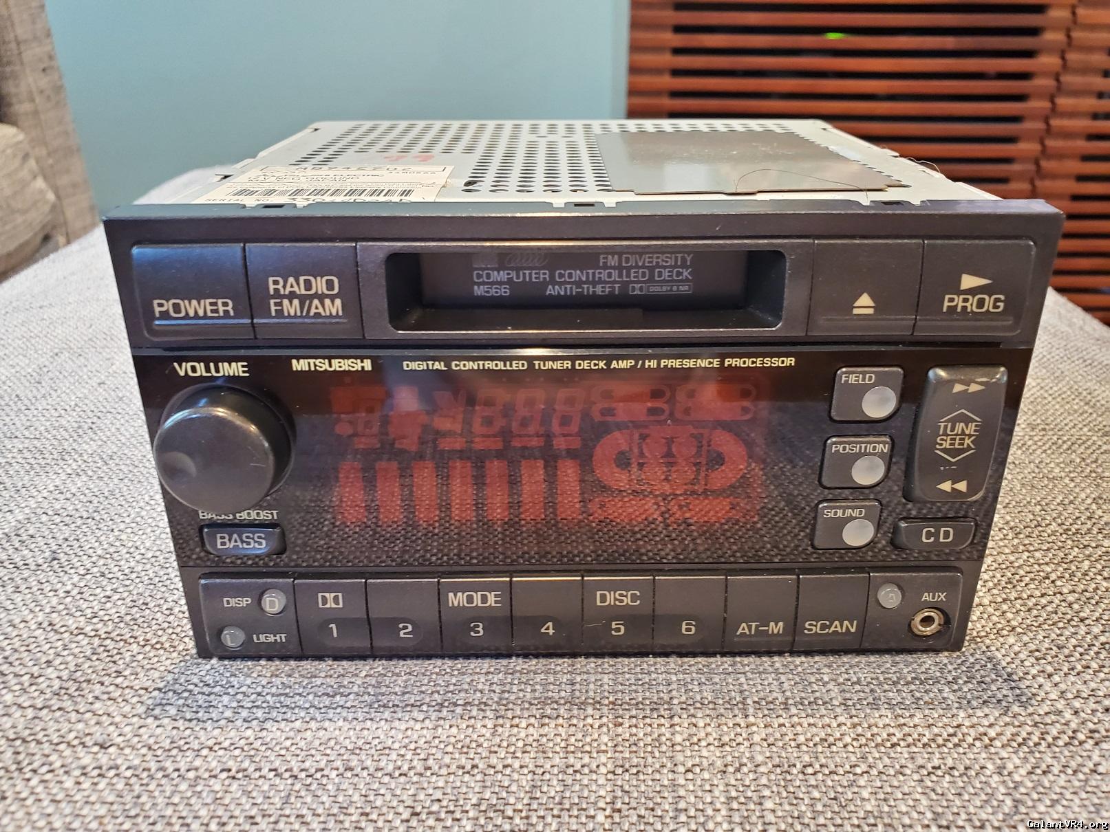

I pulled all the aftermarket audio out of my car and have been looking at returning it to stock-ish, and I thought I'd use this thread to post some more information about the stock radios.
First up, this was the base radio for the VR-4 and the one that came in my car. MB541074
Next up, this is the upgrade radio (the mid-level) for the VR4. MB649791

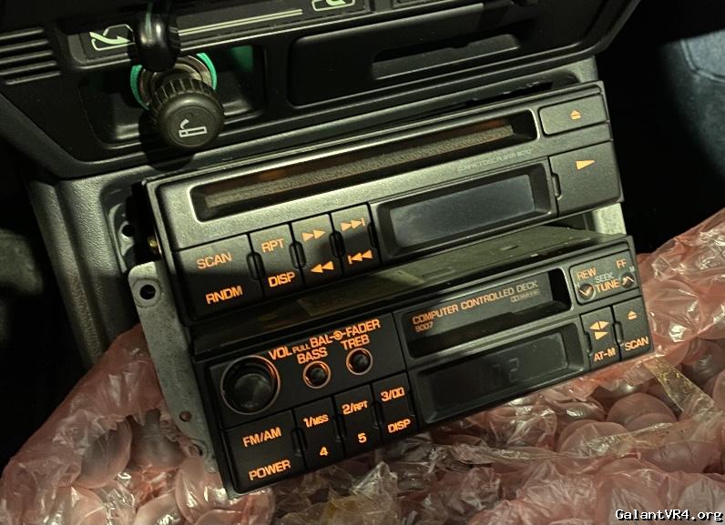

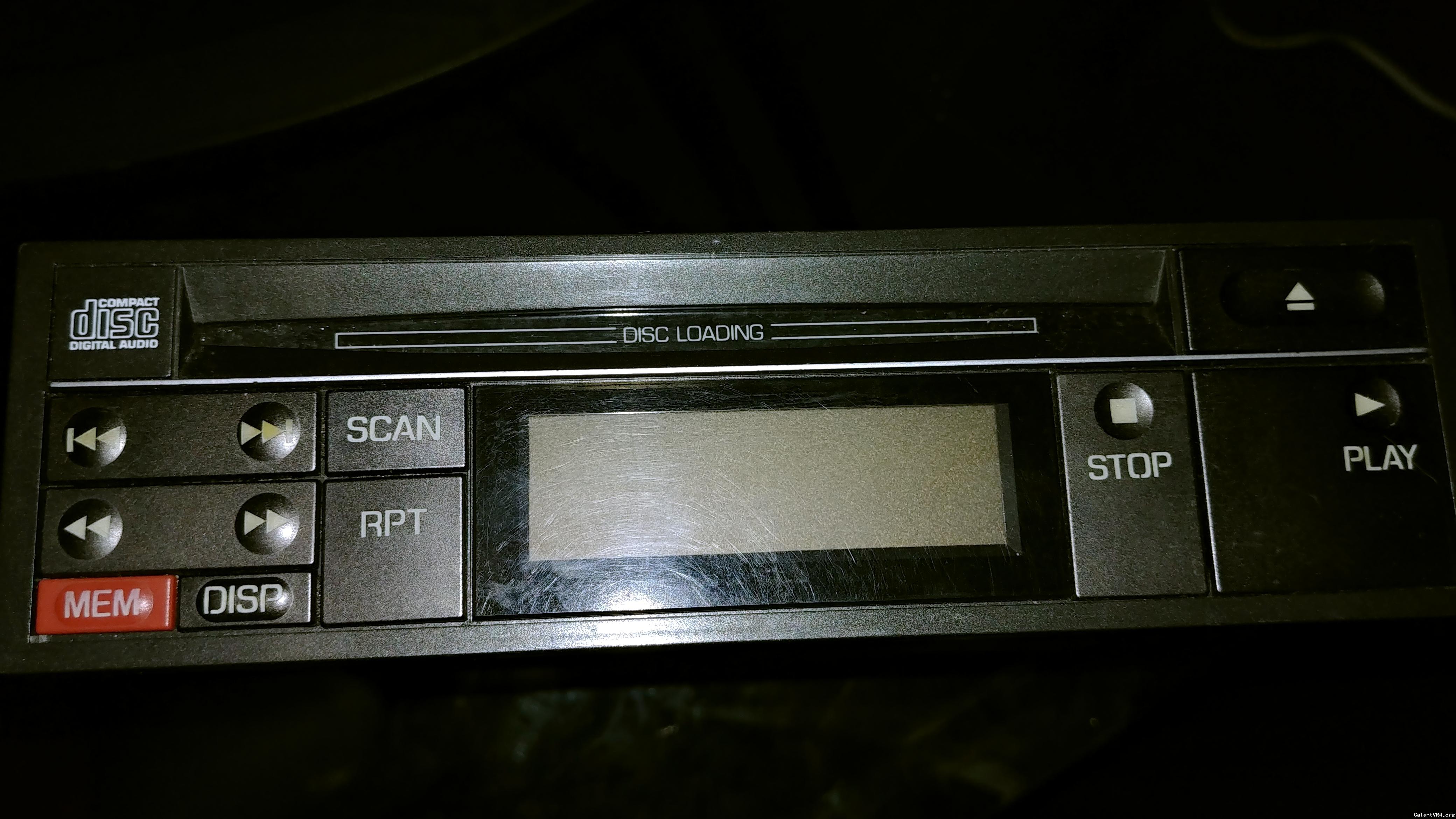

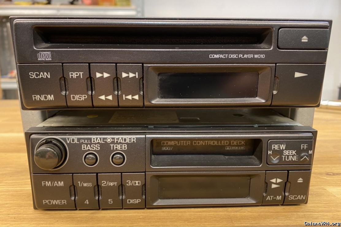

The next upgrade for the VR4 was the 2-single DIN cd-players. Pics stolen from earlier in the thread as I don't have these.

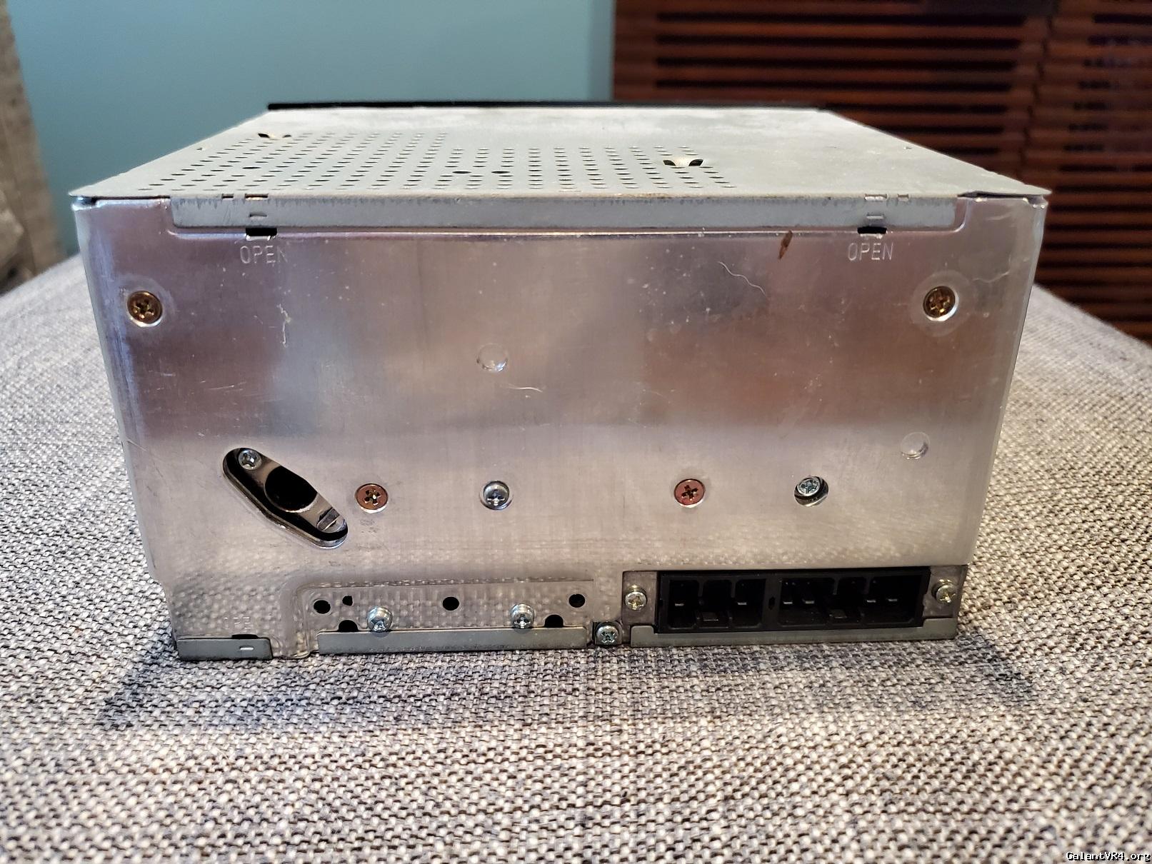

In 91, we had this one. It requires a separate amp mounted in the trunk.
In 92, the amp was moved into the radio so we got a different tape and cd deck:
Now a few decks I've been playing with.

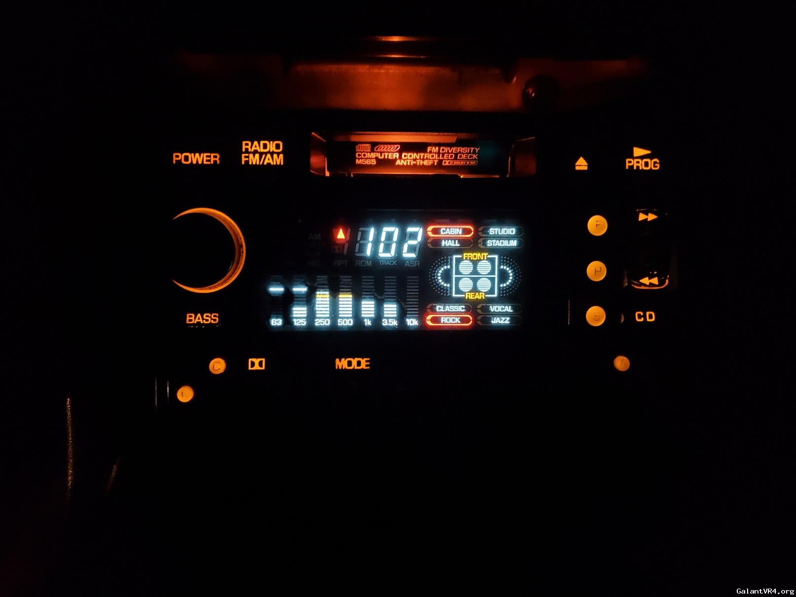

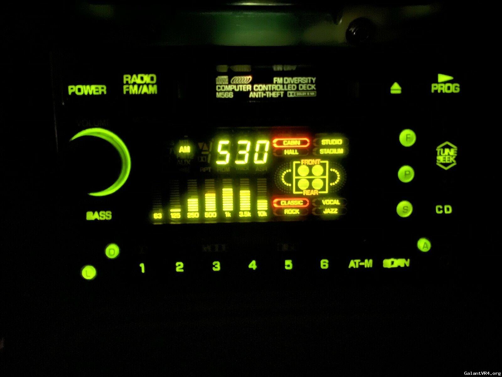

MB942702 - This particular one came out of a 93 Diamante and I think it's one of the coolest Mitsu OEM radios
and at night. Doesn't quite match the deep green of our backlight. It's more of a yellow-ish green.
There are a few variations on this radio. MB942704 was used in the Mitsubishi 3000GT and is exactly the same with the exception of the backlight colors:
MB629129 is also similar. It's from the 91-92 3000GT and while it doesn't have CD changer control like the MB942702/MB942704, the radio plugs match what's in the Galant.

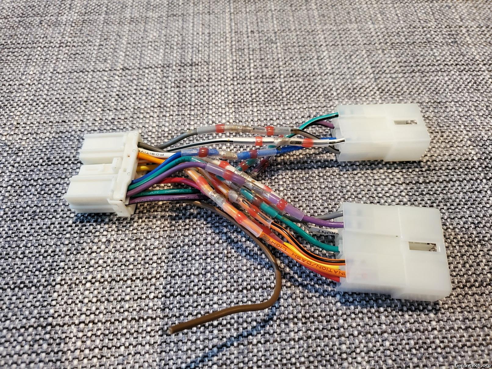

However, all you need to do to get the MB942702/MB942704 radios working is to put together an adapter harness:
You also will need to redrill the radio brackets, as the radio mounting holes are in a different location. They are also anti-theft decks, but you can get the radio codes from Mitsubishi online for free.
Finally, all the part numbers are what I was able to find. There are other similar-looking radios out there but with different part numbers. Some of that is because the backlight is a different color, so double check it to make sure you get what you want.

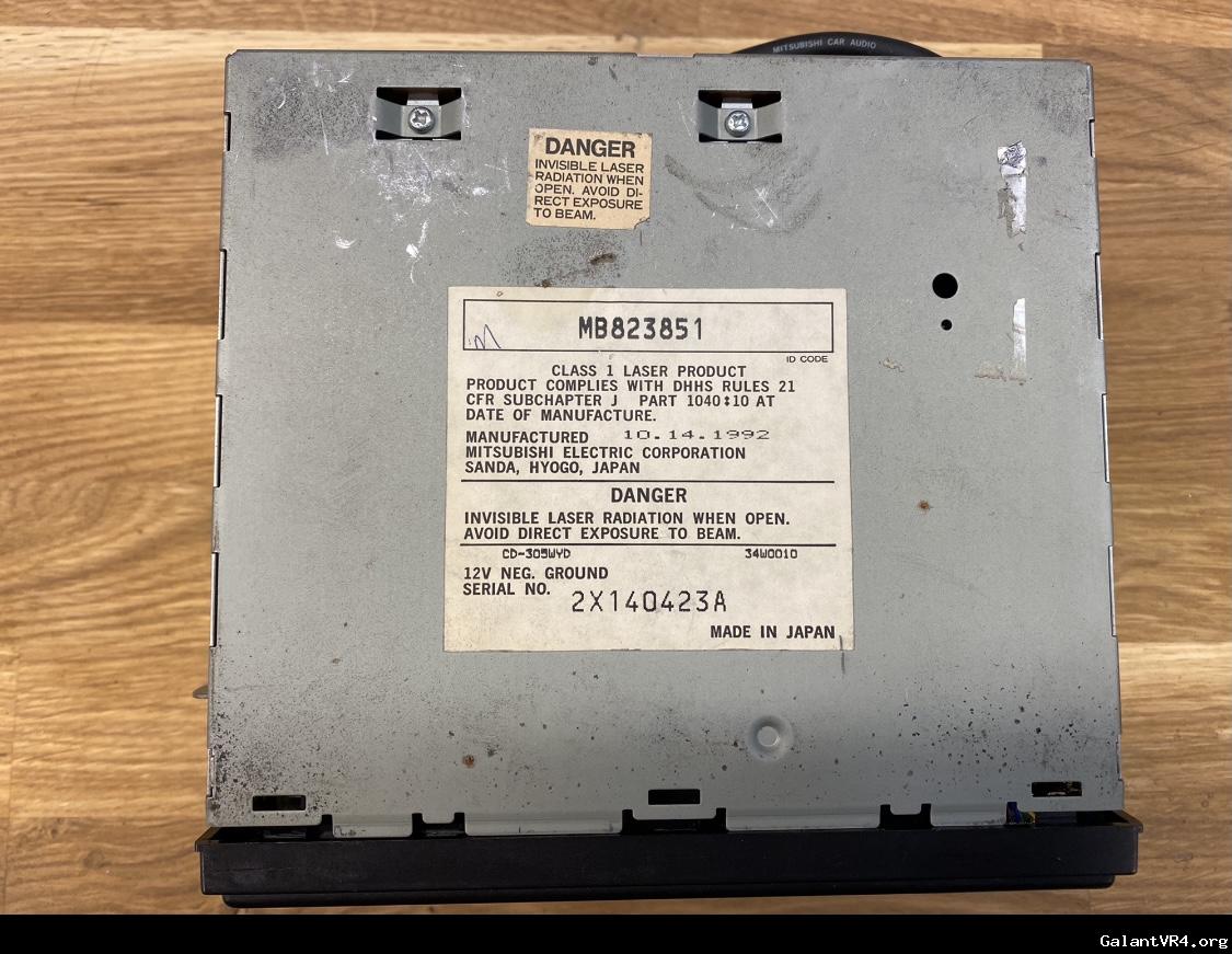

So I found a 92 radio with the tape/CD player.
To my great disappointment, unfortunately, the radio does not work. There are lights in the buttons (wrong color) and the display shows the clock. When I try to turn on the radio nothing happens and none of the buttons seem to do anything. My car is a US VR4 from 91. Is there anyone who can fix my problem or do I just have a faulty radio that can not be saved?
10,950
The buttons are orange because that model and part number radio is from a 92 and up Eclipse which used orange interior lighting. The light colors can be changed, but finding the right lens covers and doing the work is not simple.
Sounds like it is powering up at least. Does the CD player work if you insert a disc? Is your wiring all stock and in good condition?
Lastly, the 91 MY VR4 used a separate amplifier in the trunk, and from 92 the amp is in the radio. I think they interchange because I have a newer radio in my 91. I don't remember if I had to do any wiring changes other than removing the old dead amplifier.
Do you have audio repair shops where you are? It could probably be fixed, since if it turns on it may just need some simple component replacement.

When I saw that the light was orange, I also suspected that the radio probably came from another Mitsubishi. However, I imagine that it is possible for me to change the color.
I have no reason to believe that my wiring harness should have been anything other than original.
I do not think my car has any amplifier in the trunk but it is possible there has been one before.
I find someone who can take a look at it
