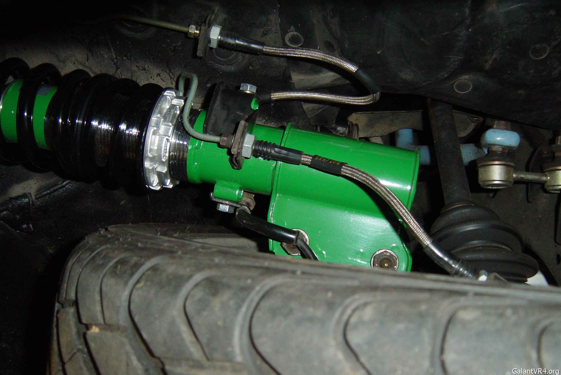

Log:
I still have the fronts and rears now at level 8 and the car handles very well. (not too stiff unless I hit a small hole etc.
The tire psi is 42 front 44 rear.
One tire was mounted back wards on the rim but in their condition (worn) I doubt it really matters.
They don't appear to rub anywhere on the body despite the 9" width wheels.
The turn in of the car has now is just incredible. But power of the car easily breaks the 245's loose in the turns. (New R compound tires are needed)
The car does seem to push less, however.
More to come... (still need tint)

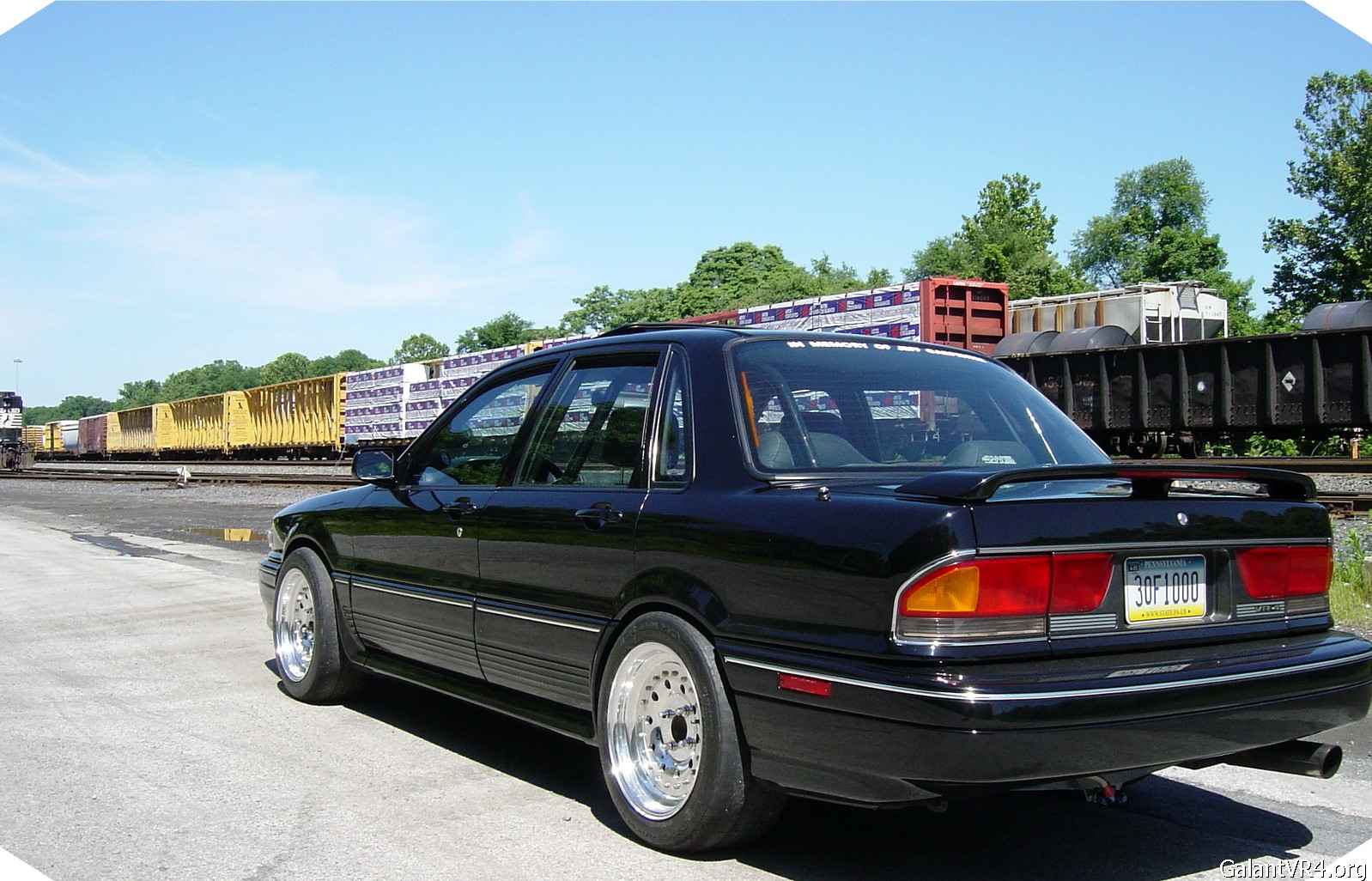

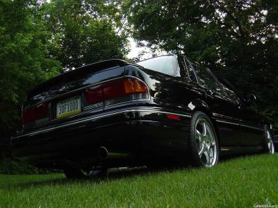

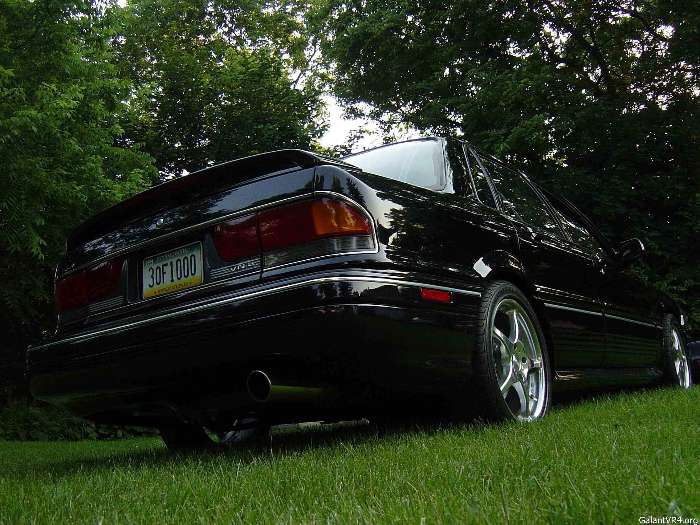

#3,
In the pictures, am I seeing different wheels than the SSR's you've had for a while? Post a side pic and describe if I'm on track.
G
Feb 24, 2004
8,896
zompton
the lowest i've found em for is $1300.00 what did you pay ?
number3
Jun 26, 2001
7,624
KoP, PA
Street wheel and tire package
17 X 7 SSR
225 45R17 Bridgestone Potenza S02
32lbs
AGX and H&R
Tein HA
You can see by the pictures, how the Tein make the 16 X 9 wheel fitment possible. I don't think they would ever clear with the AGX.
