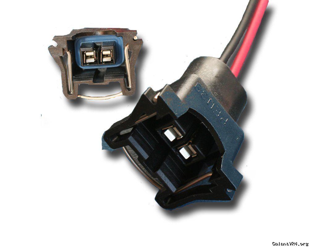

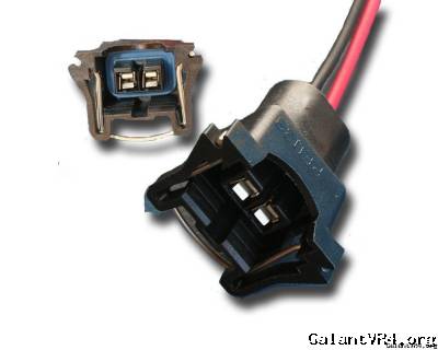

Who was the guy here that sold these? Have you seen this type before?
I'm wondering if this is an OE part and for what car?

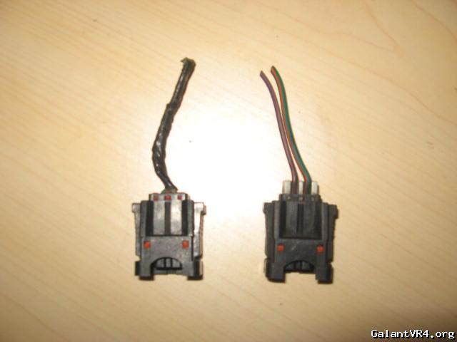

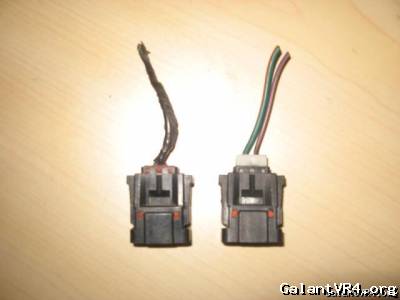

I believe those came from some of the older intrepids. Pretty sure the Mitsu ones are gray/black where those are orange/black.
10,992
Are those different than the 2g type? They look very similar to me. 2g is what I used on my cars.
89Mirageman
Jul 5, 2006
2,502
Stantonsburg, NC
The black connector itself is identical between the two. On the Mitsu one the top plastic piece sticks out further and is grey in color. The other one sits flush and is orange. The rubber piece at the bottom that seals it off seems to be orange on both.

10,992
G's picture is missing that outer gray wire guide, so thanks for the other photos Chris.
