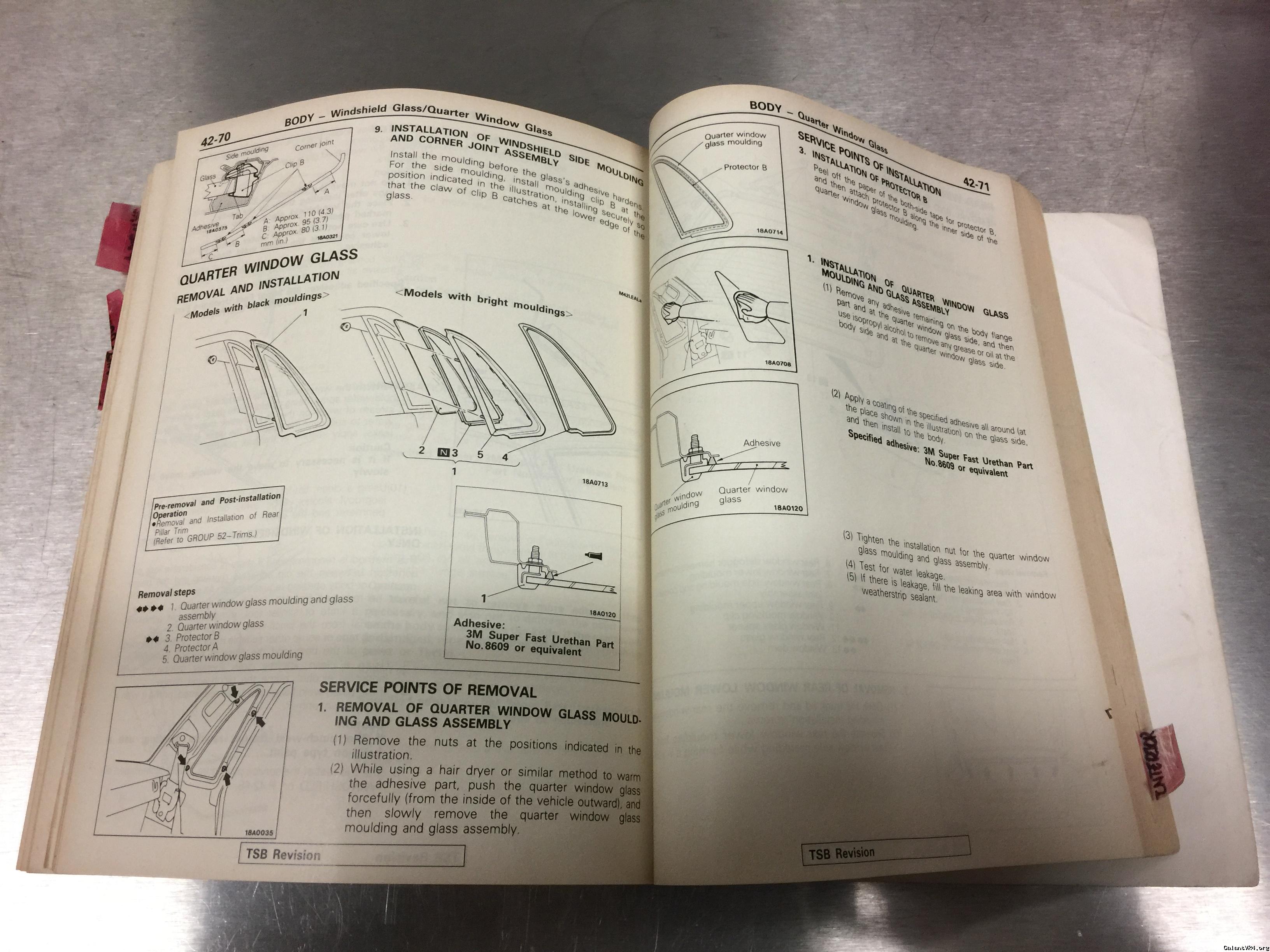

Pull the interior plastic and you will find 4 screws.

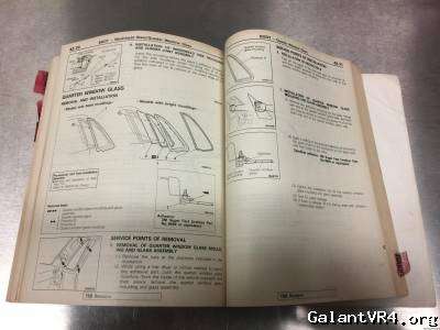

Once you remove the interior plastic trim you will find four 10mm nuts. Furthermore, the only Sealant you should use is the OEM Sealant. It is part no 8609 Super Fast Urethane from 3M. You should be able to source this product from any Bodyshop retailer.
I have attached an image from the FSM to aid you. Using the factory application and method will prevent you from performing this procedure twice.

thank you pot, i did not realize it was a certain kind of sealant. on the screw part, thats just my bad. thanks for this, like i said im gonna be doing it here soon.

Also run a garden hose over it afterwards to make sure it is totally sealed, and don't over tighten the nuts or you will have glass all over the place.
