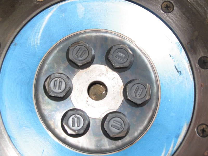

Well I discovered something else today that may or may not have anything to do with the thrust bearing failure. When I removed my clutch, I noticed that each flywheel bolt had wear on the outer most edge meaning there were clearance issues between the clutch/PP and flywheel. On my old engine, using the same Fidenza flywheel, I noticed the previous owner hadn't used the spacer and slightly longer auto tranny bolts that are supposed to be used with aftermarket flywheels. When I installed the new clutch, I did use the spacer and new bolts. Given what I saw today, the spacer is obviously creating the clearance issues mentioned above. Any ideas as to why this would occur given that aftermarket flywheels require/strongly recommend the use of the spacer? I'll post pics of the bolts tomorrow.

Flywheel Bolts:
No idea. When I installed the Fidanza FW and ACT 2600 I used the OEM bolts, and no spacer. Bolts had plenty of depth to properly seat, and I never had any issues whatsoever..... /ubbthreads/images/graemlins/dunno.gif
I can definitely say that ACT 4G63 flywheels do not require or recommend longer bolts and in the past when I've used Fidanza flywheels their's didn't either.

This is the kit I bought orginially.
The argument for the longer bolts and plate make sense but it has obviously created clearance issues on my setup. I will be reinstalling the flywheel with stock length bolts and no plate just to avoid any issues.
The only problem with what I read in that link is that FP doesn't specify which aluminum flywheel/flywheels require the longer bolts which leaves it up to you the end user to determine if the longer bolts are necessary or not. As you've already discovered, in your case the longer bolts aren't needed.
Daryl

I bought that kit to use on my Fidanza aluminum flywheel as well. I didn't need the bolts as they bottomed out on the crank and ended up using the stock bolts with the plate. It was my impression that the plate was to prevent the bolts from digging into the flywheel.
Either way the bolts FP provided were too long for my setup and I ended up using the stockers.
