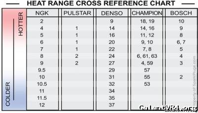

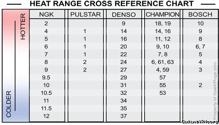

So since I am genuinely learning stuff here, school me properly.
I'm taking it that the 7 in the BPR7es corresponds to the 7 in the NGK column? And if that is correct then the Pulstar 1's range anything from the equivalent of a No.4 NGK (which I am guessing is pretty hot) right up the 7?
Wouldn't that theoretically (ignoring any other design issues) mean that the Pulstar 2's would probably work quite well in hot climates?
Or have I got this all wrong?
