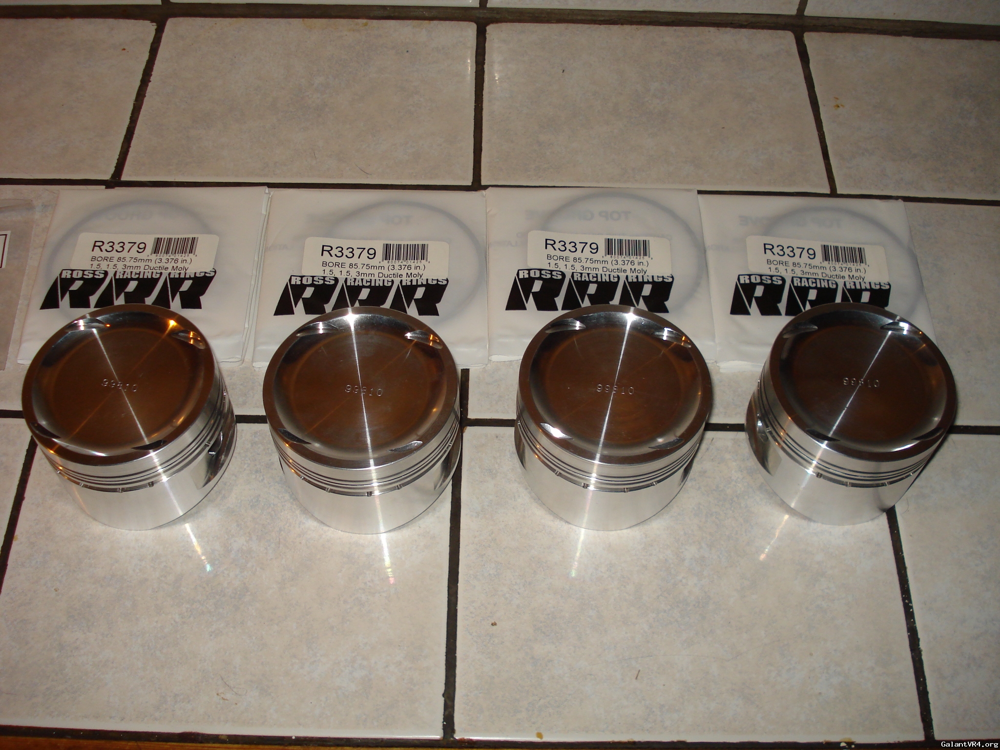

my sexy ross pistons .30 over

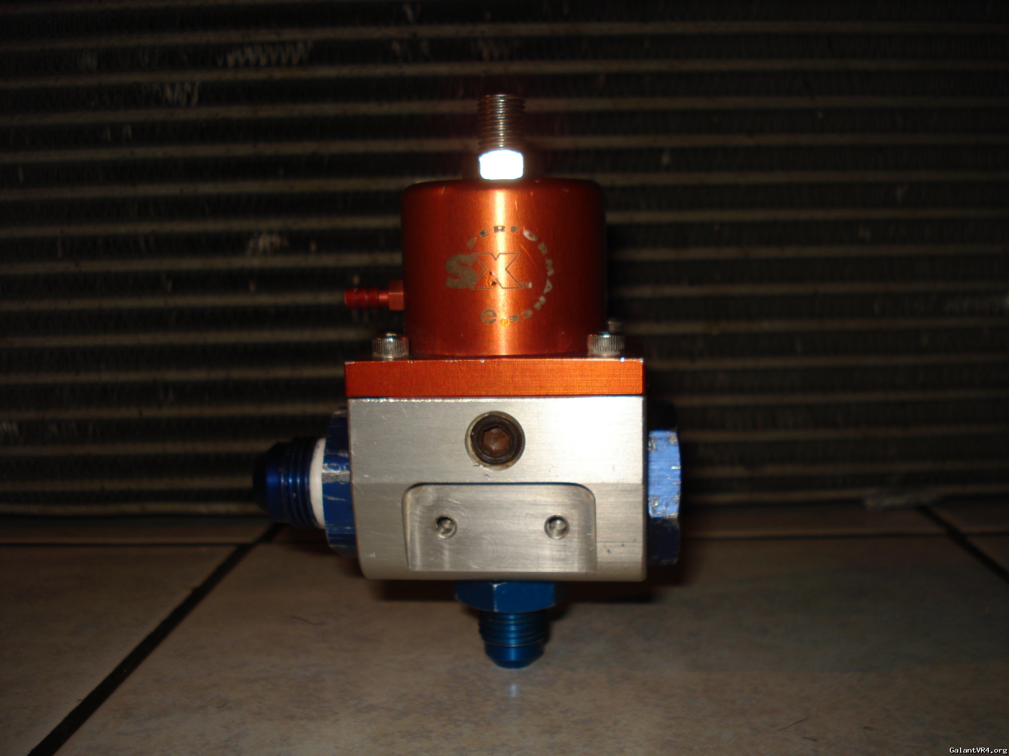

and my sx performance fpr .im trying to figure out what lines and fittings im going to need in order to hook it up
