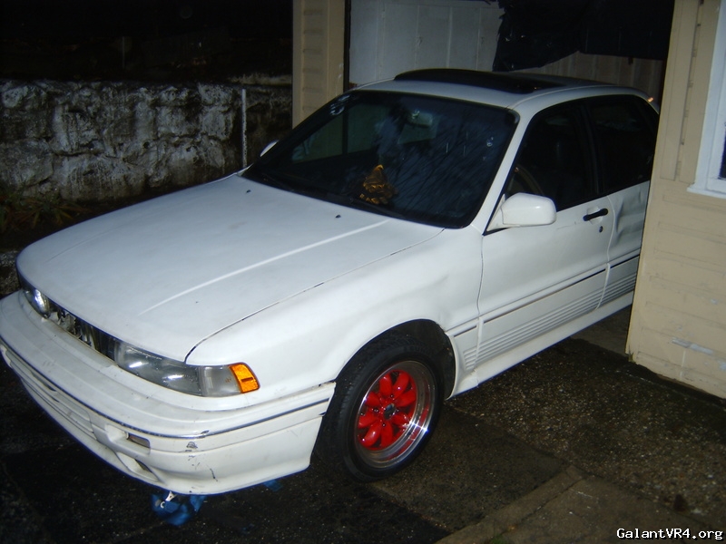

this is the car when i first got it

Nice list of mods, good luck on your build. Are those rotas? Did you have a prelude or accord before with those wheels on them?

um there sportmaxx they came with the car ,,,im going to try to make it on pump gas if it fails i will use c16 race
