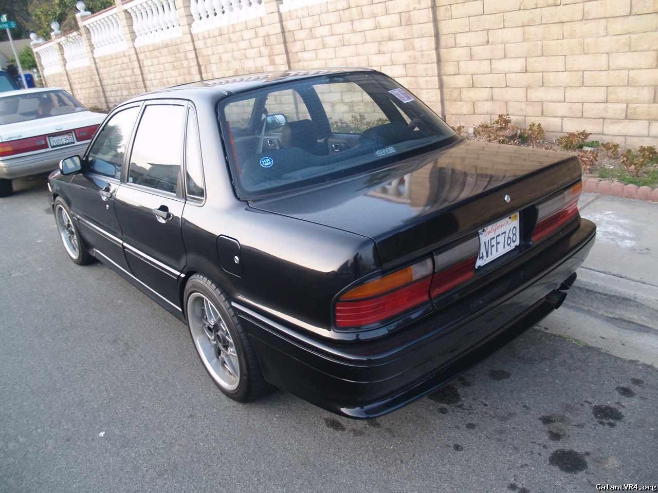

The whole exterior setup looks very nice. Gorgeous car!

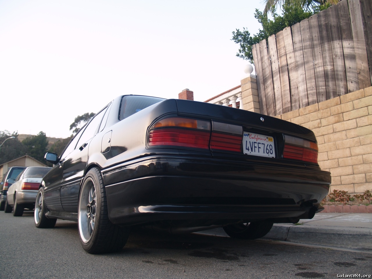

You've really got the "original" VR-4 look going... the JDM parts, the original tails (for the e39) and the color looks almost exactly like Jeremy's JDM.
Awesome!

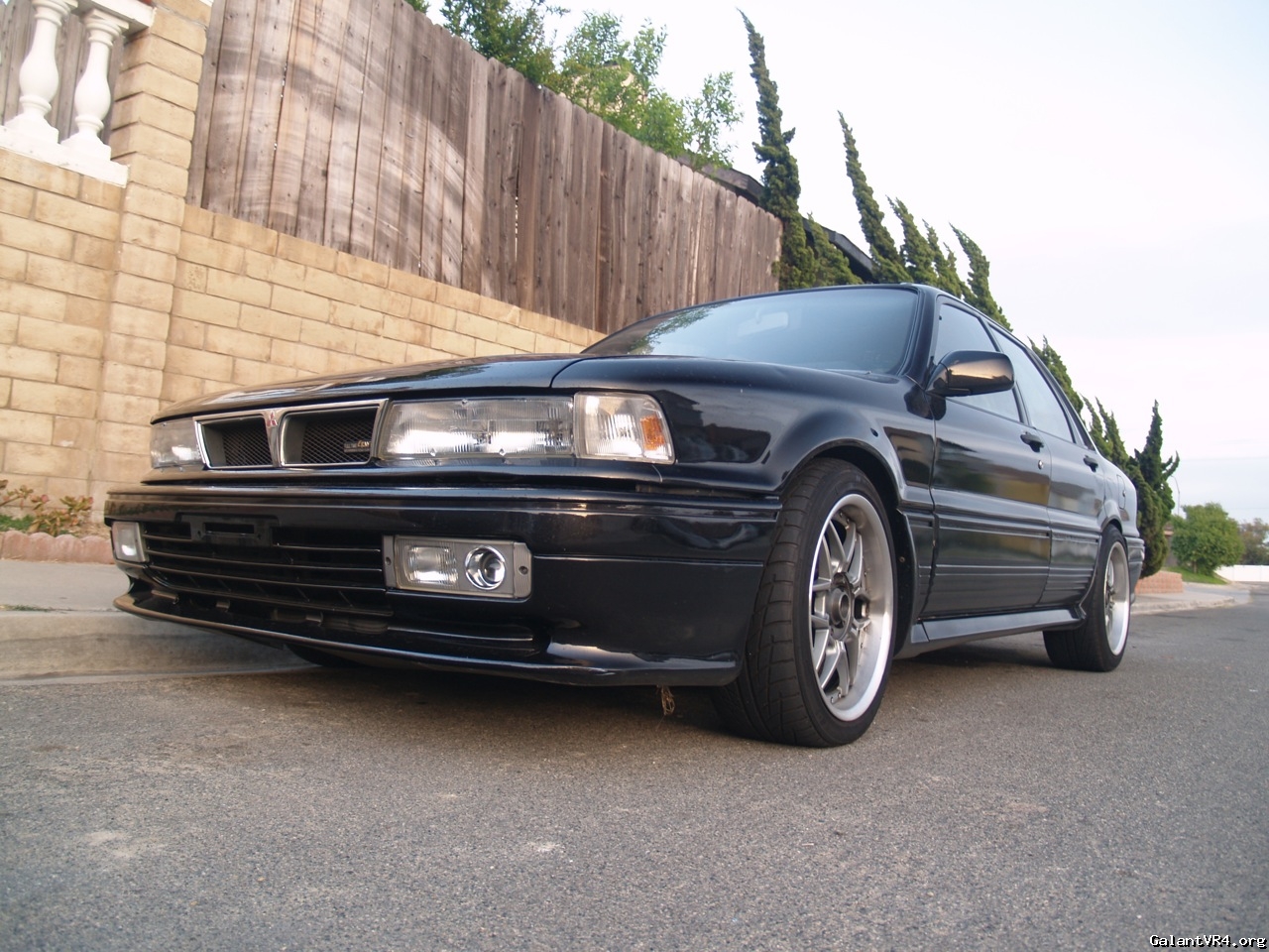

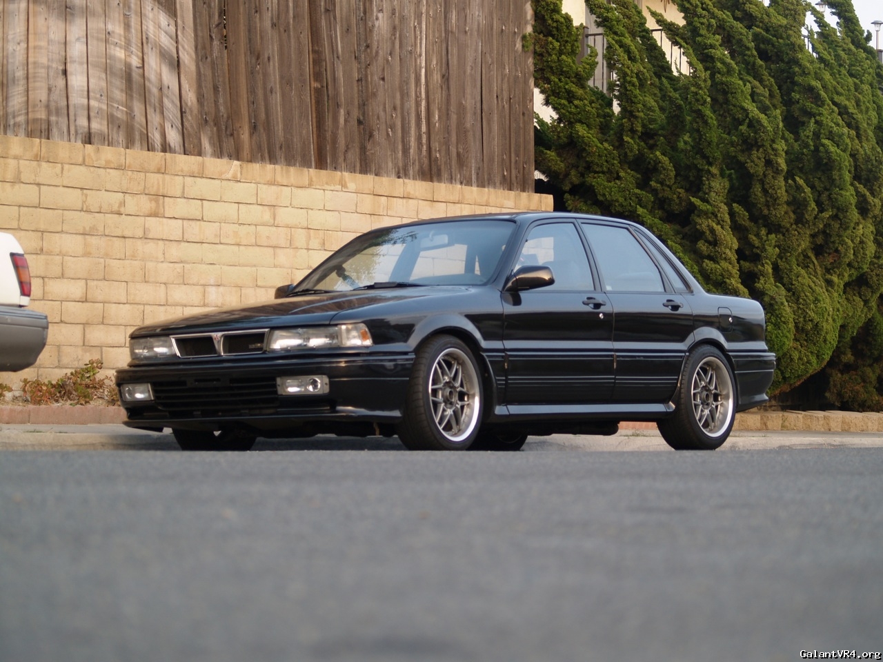

looks great, please dont go to a skinnier tire, that is perfect.
Those wheels look great with that front bumper. The car would be perfect if you could bring the front ride height down a touch to even out the wheel gaps.

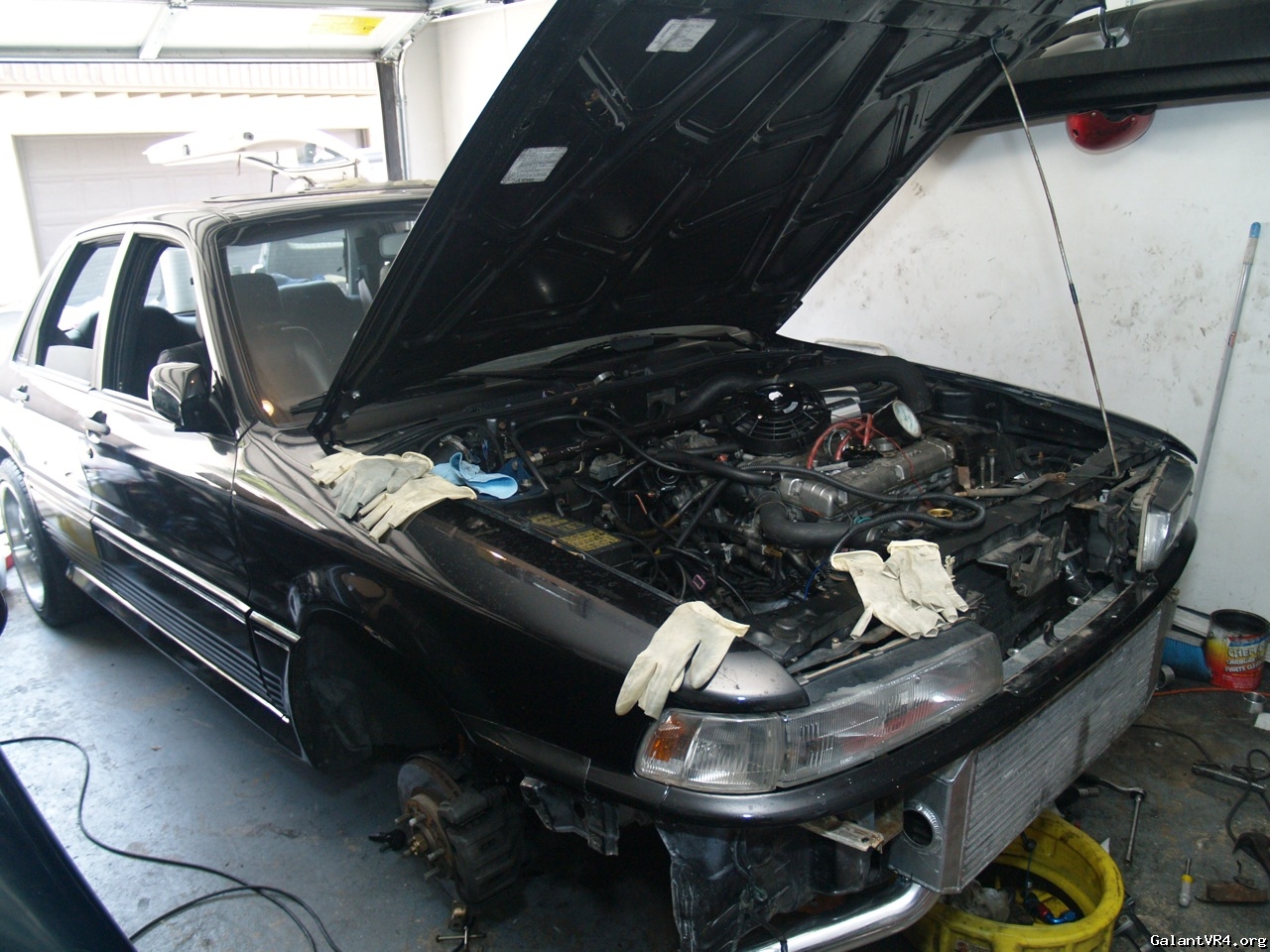

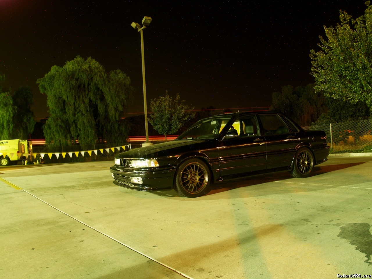

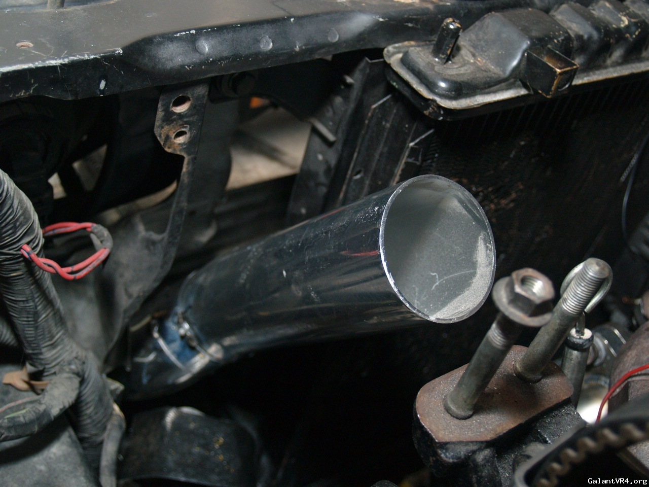

Some updates. I've been working on her for the past 4 years and it's finally coming together. After destroying one motor due to Haltech not configured correcty for Crane ignition box and numerous little issues, like not passing smog, and most recently, a failed oil pump due to timing belt too tight, she's back on the road again. Here are more pictures of the build and where she stands now.
Break in period, all stock, smog ready
Passed smog!!! Time for the goodies!

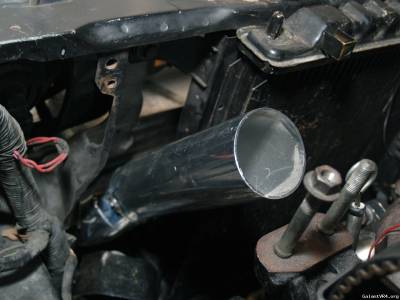

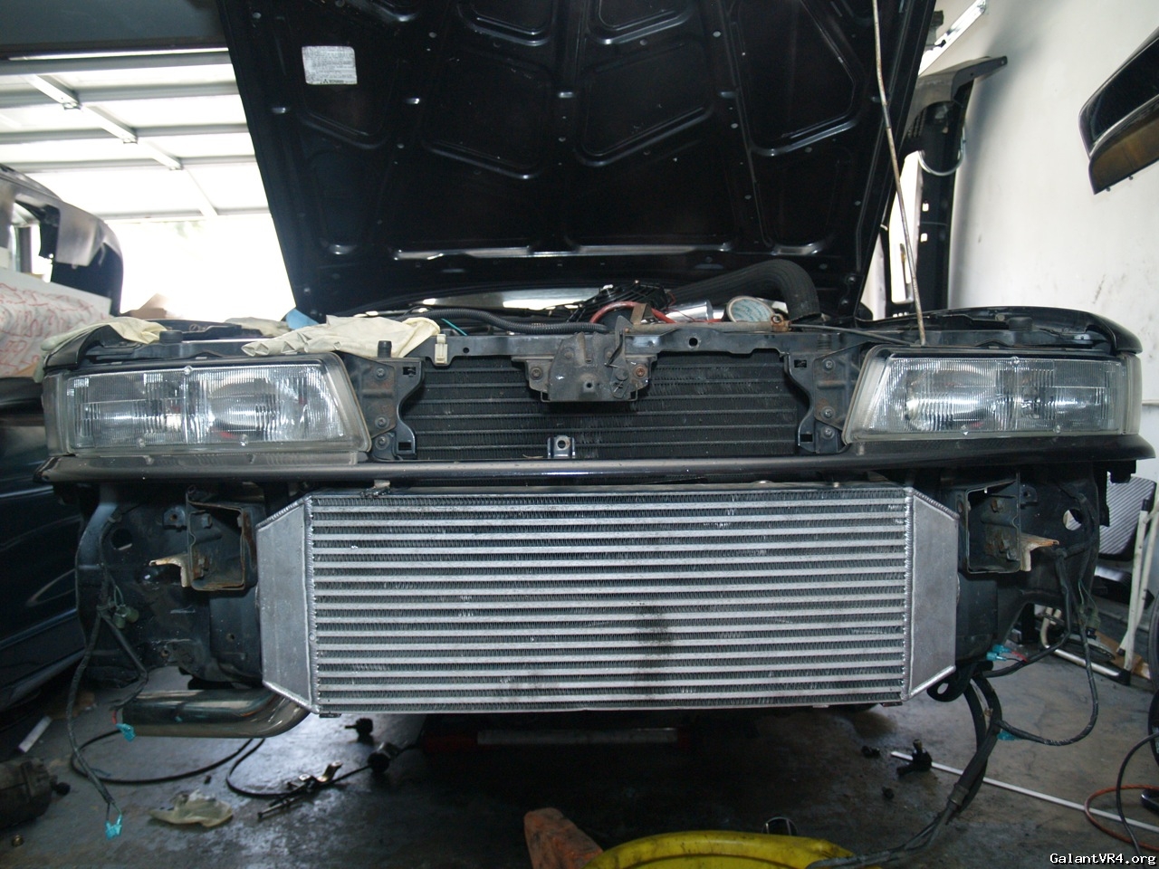

Mocking up intercooler

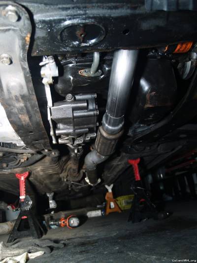

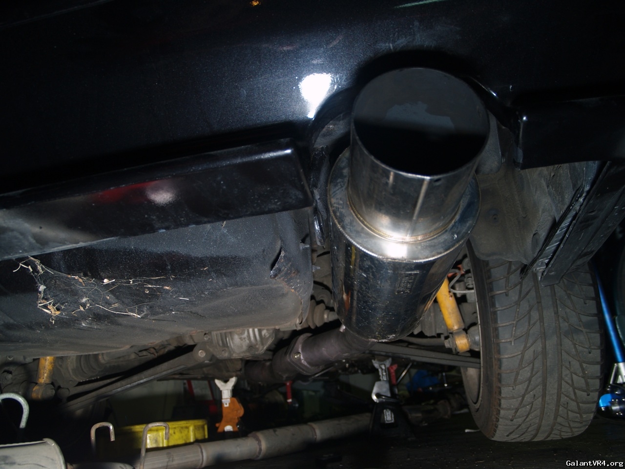

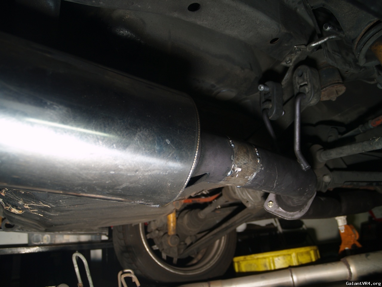

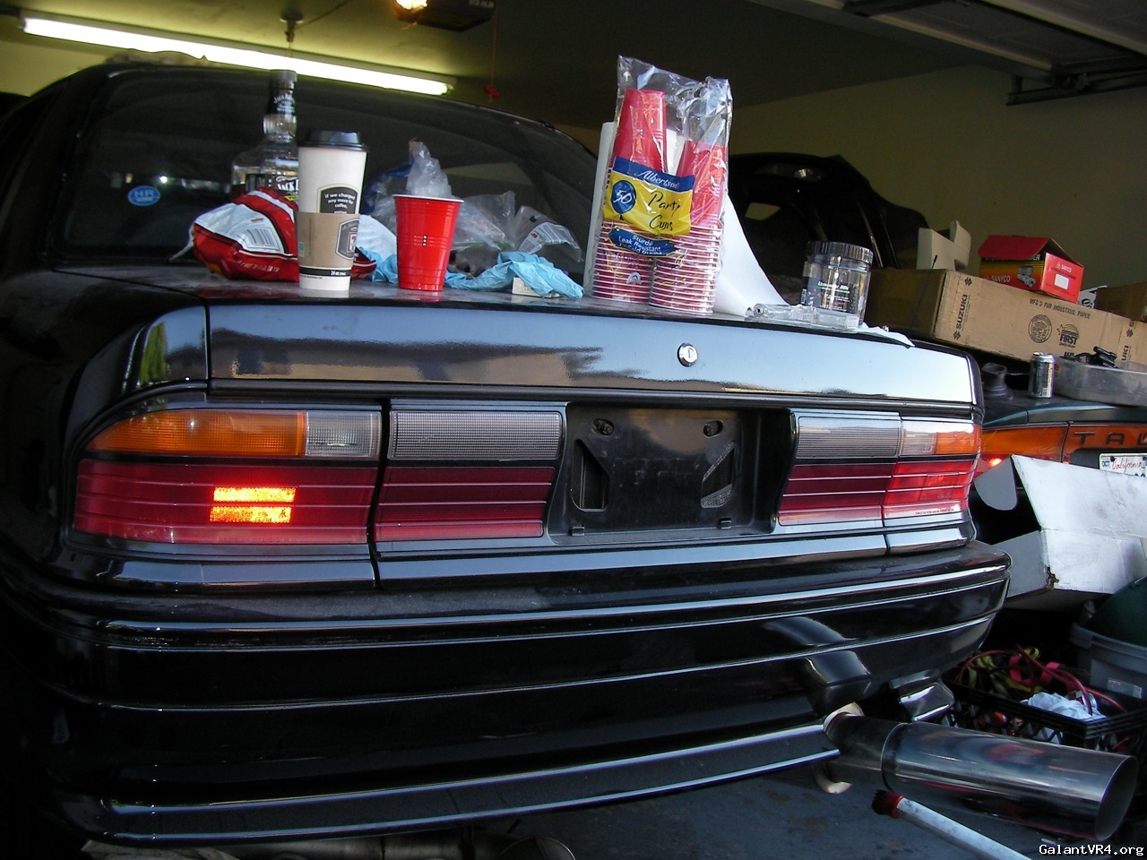

Retrofitting my old GSX N1 cat back

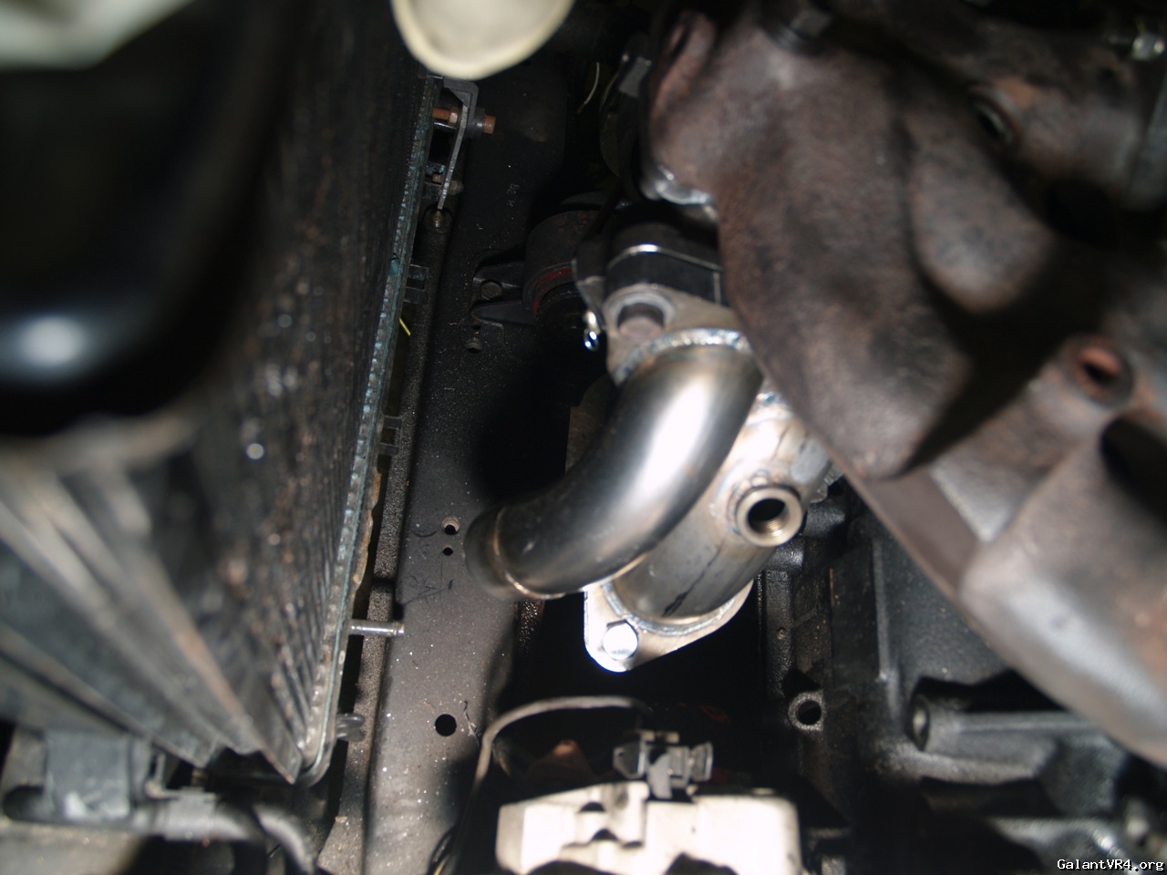

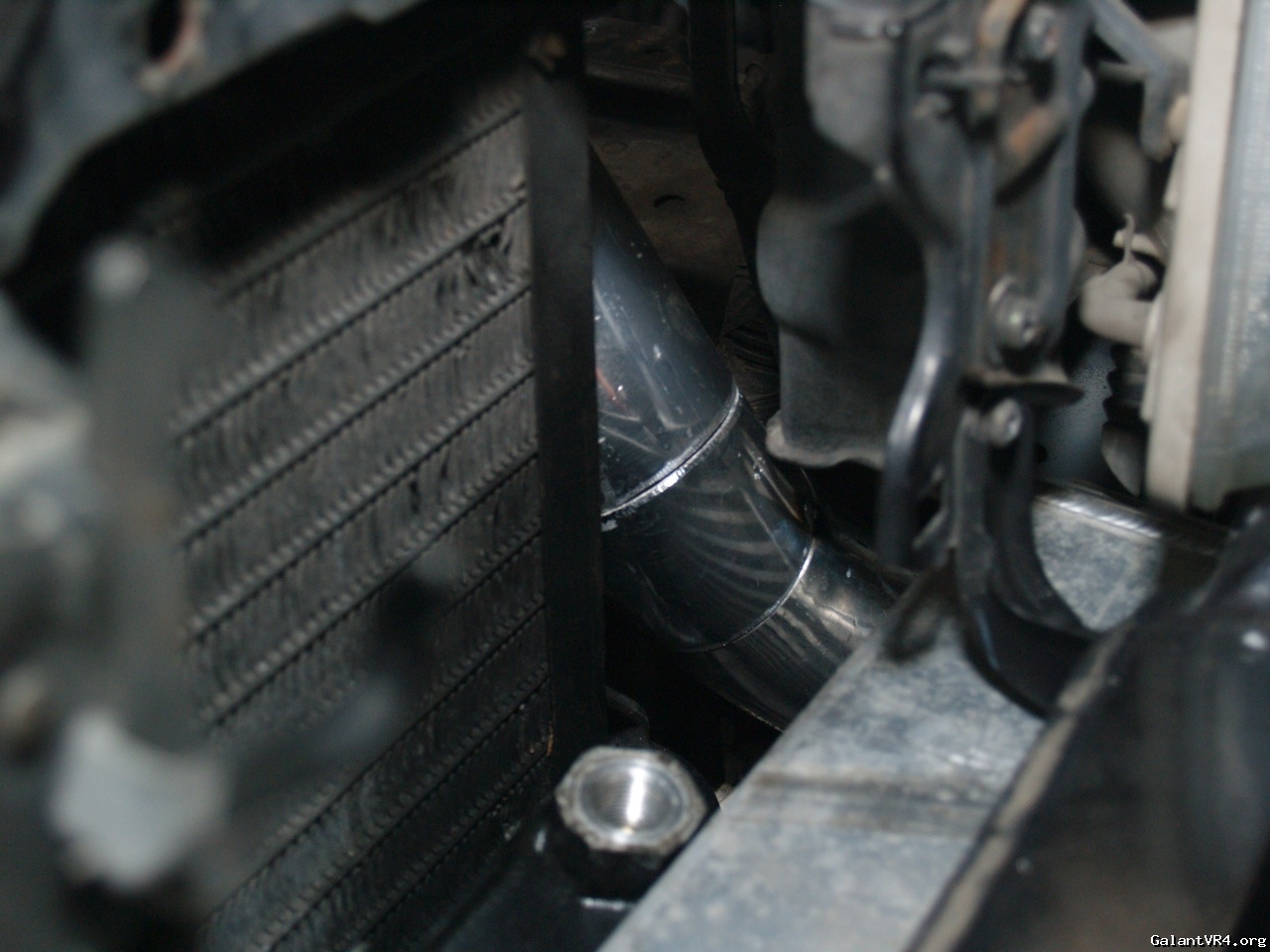

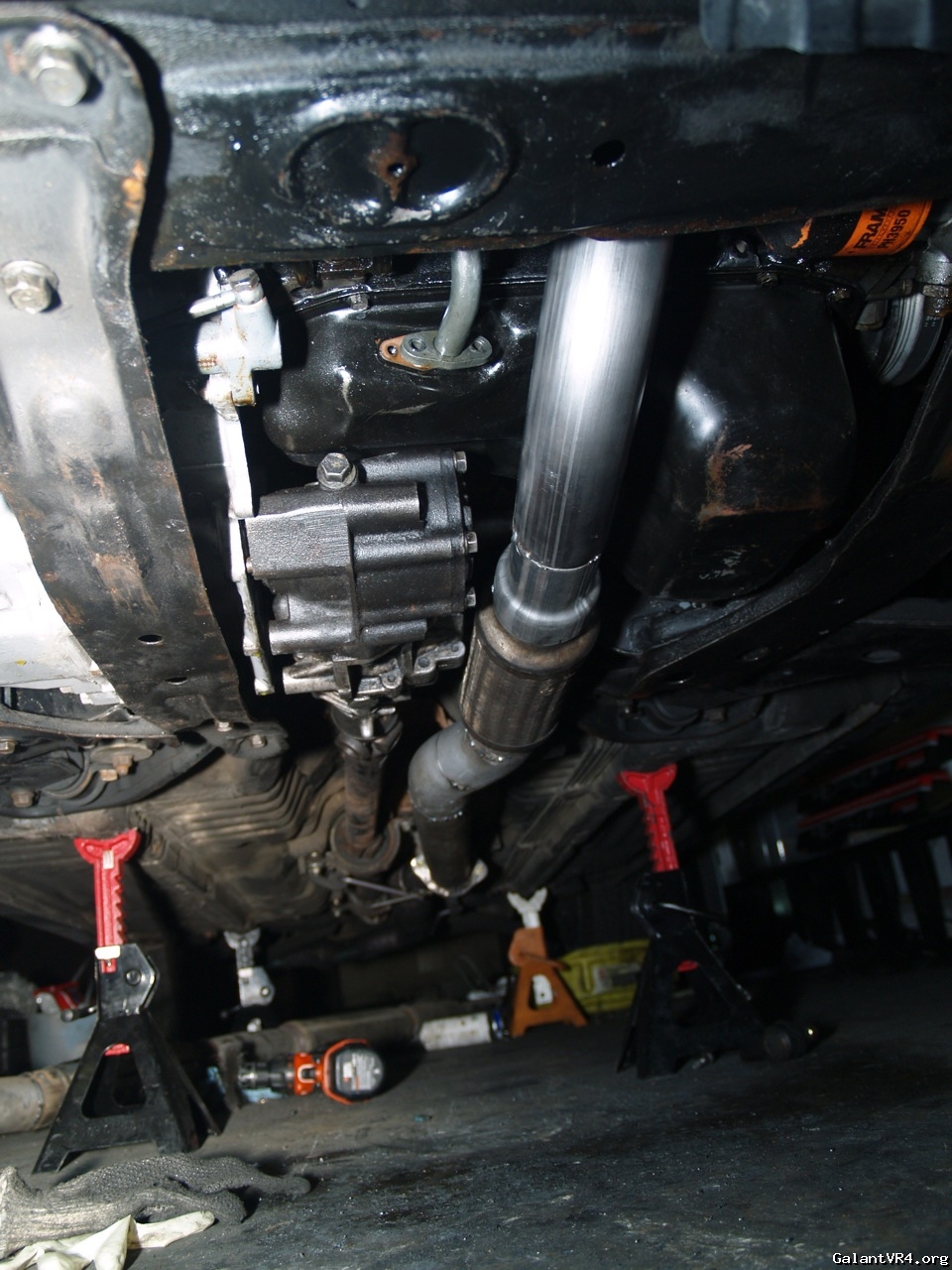

Mocking up downpipe and O2 housing with dump tube

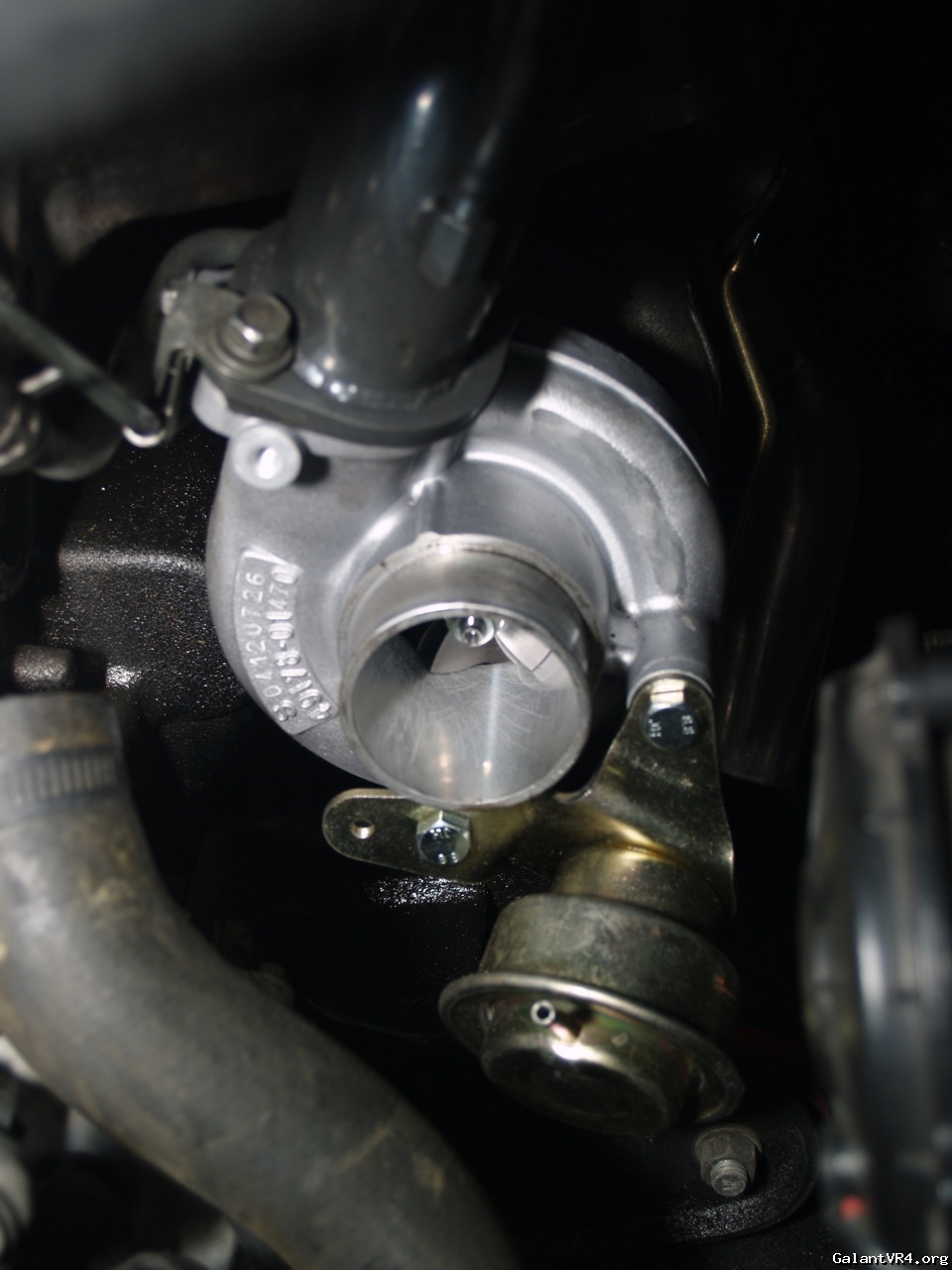

Crazy little FP 18G-6SL2

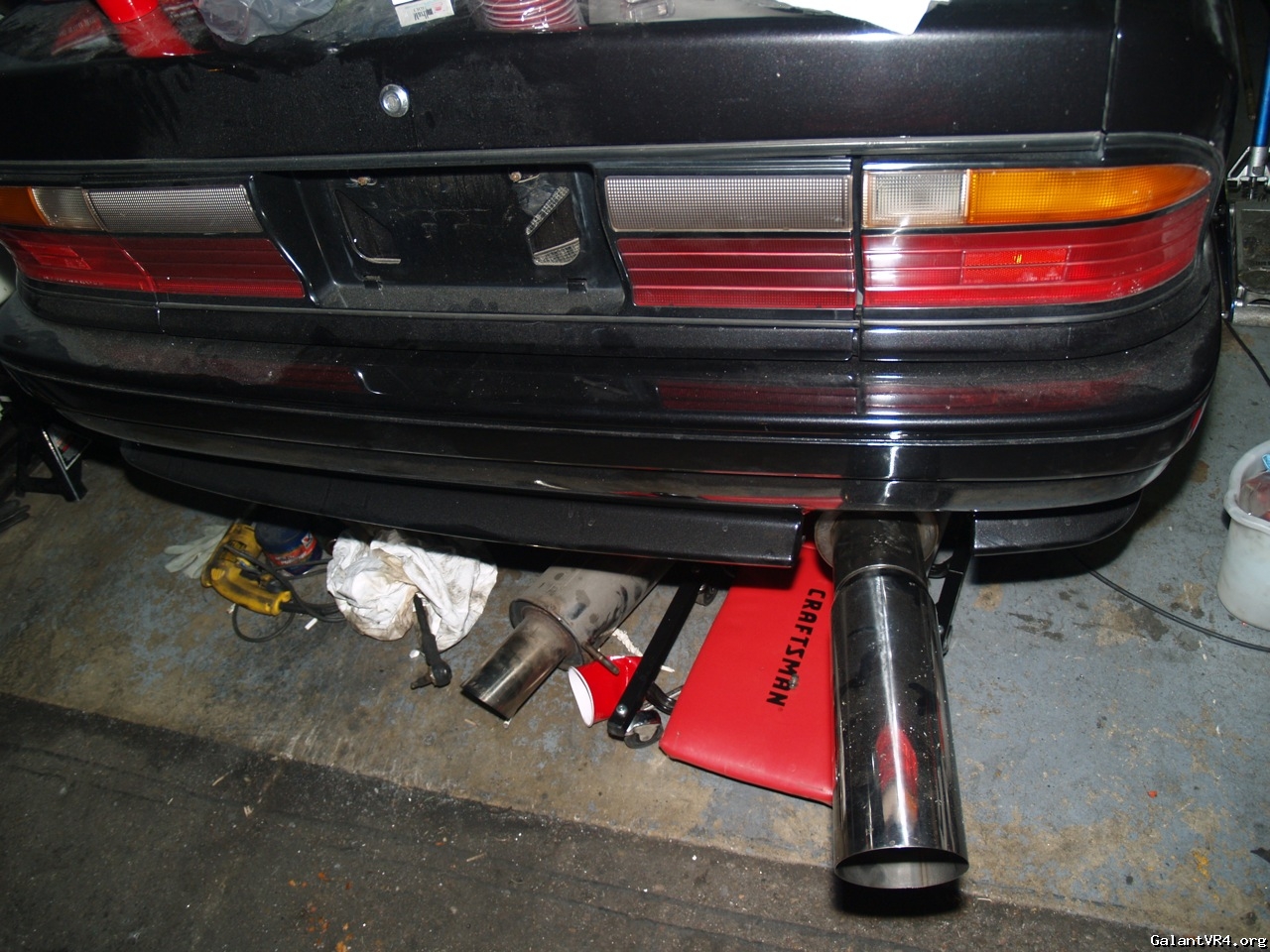

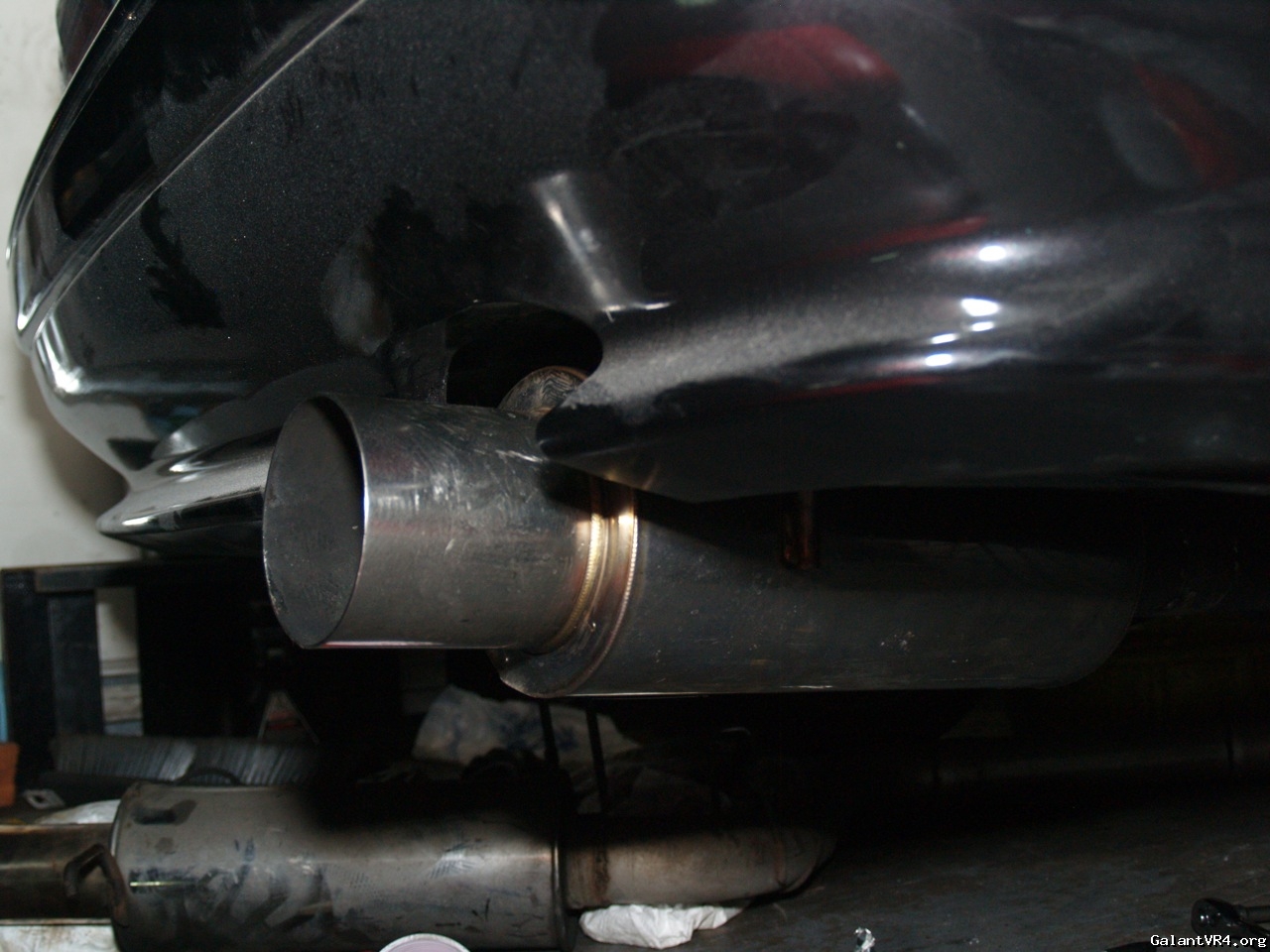

Super exhaust tip for kicks!!!

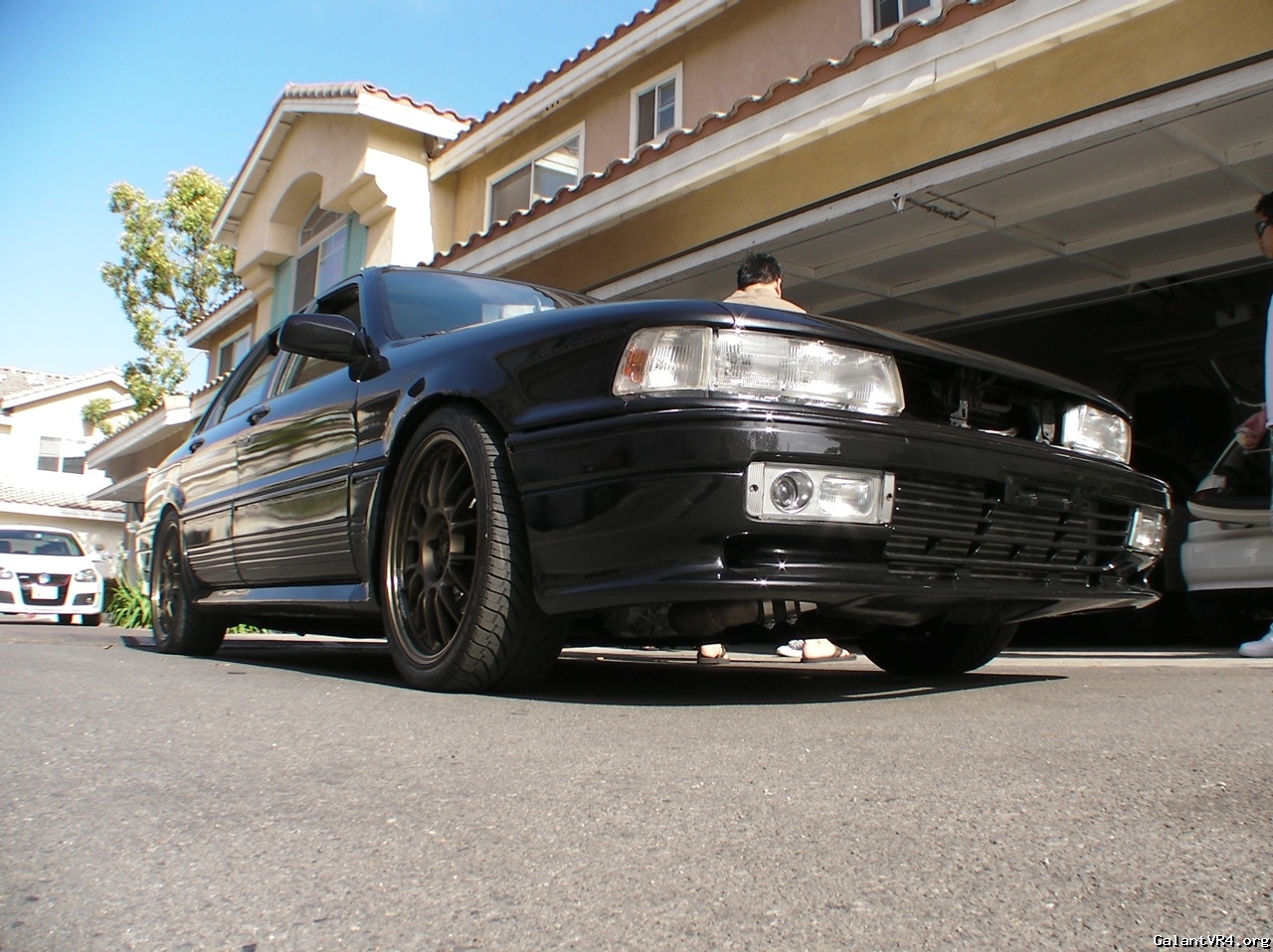

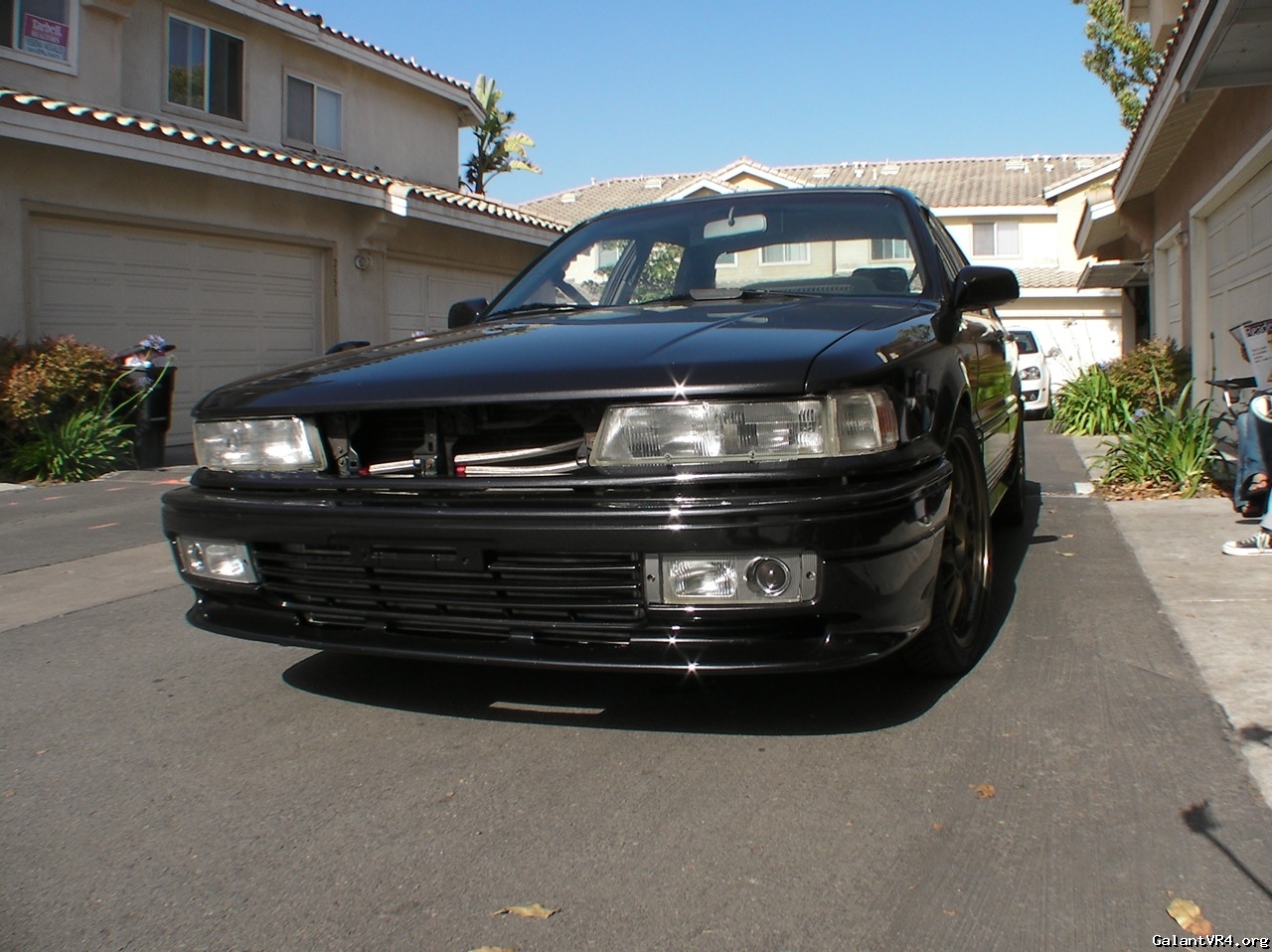

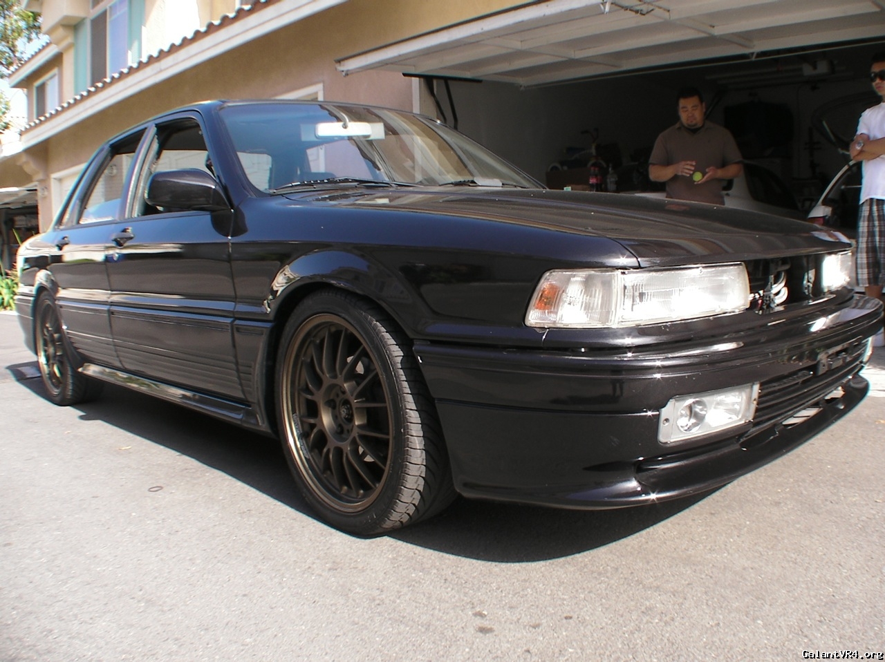

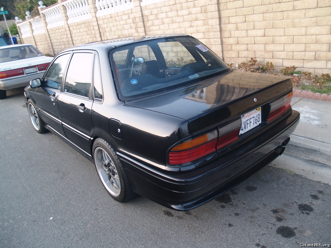

How she stands now...

Looking good, I don't think you want that dump on your cross member though.

What a nice GVR4. Pretty clean setup too, but I liked your previous wheels better than the current ones. Your GVR4 just sits better with a wider offset and some meaty tires.
Either or...still a beautiful GVR4 /ubbthreads/images/graemlins/applause.gif
Lookin' good, bro! /ubbthreads/images/graemlins/applause.gif

Yea, I personally like my Kakimoto's better. The measurements are
Front: 17x8 37mm offset
Rear: 17x9 37mm offset
I'm borrowing my friends skinny 7.5" Volks, because I'm waiting on new rubbers for the Kaki's. I was running FWD at the time and the rubber on those were 215 in front and 235 in back. Overall diameter is different and I didn't want to break the welded center diff when I went back to awd.
