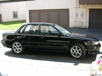

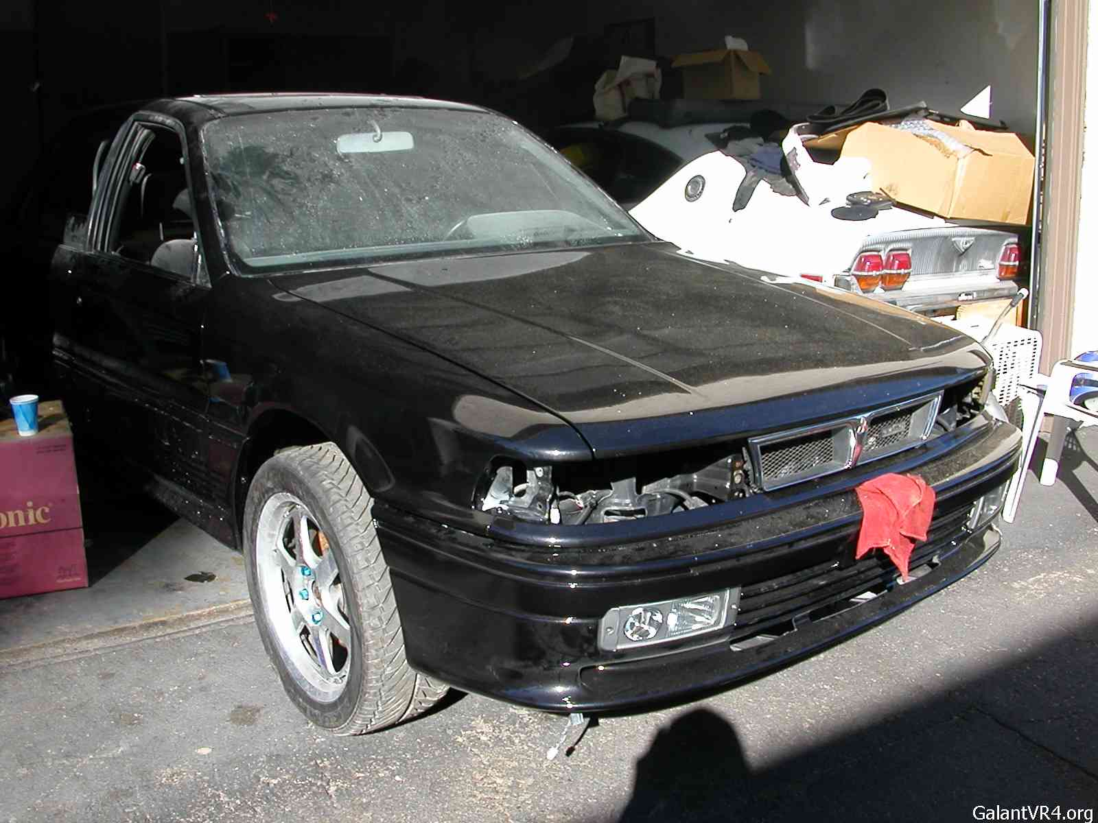

Well I finally got the GSX subframes on 1649 and test fitted the Volk GTP's. List of completed tasks:
- GSX front and rear subframes with ES poly bushings.
- 4 bolt lsd rear
- 5 lug conversion
- no 4ws
- no abs
- manual rack pinion
- welded trailing arm mod
- koni yellows with eibach prokits (i really want some teins!!!)
- ingalls front and rear adjustable camber controls
- steel braided brake lines
- new ball joints and steering knuckles
- jdm front and rear bumpers (still need to fab some front brackets)
- jdm motorized side view mirrors (why? i dunno, still asking myself that question)
- jdm head lights
- jdm corner lights
- 89 tail lights
- paulo amg front grill
after all this...my 'to do' list is still pretty looong.
I still need to source a stock hood before I send her off to the body shop. Anyone got one laying around near Southern Cali?
Some pictures...

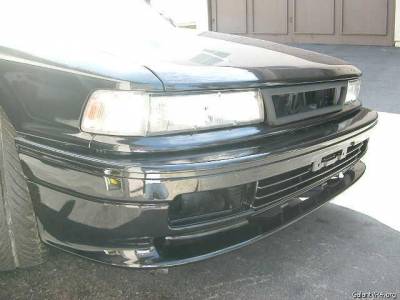

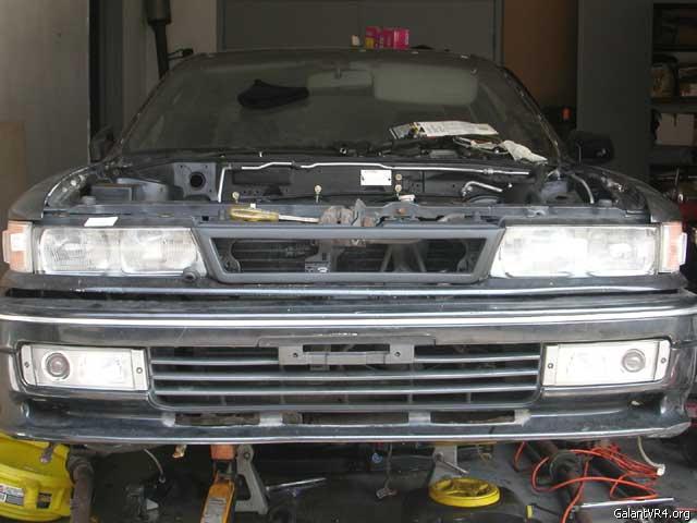

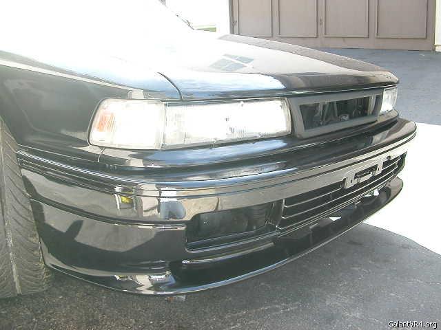

Are you thinking about putting some mesh behind that grill?
Looks awesome!
You got the retractable mirrors for when you parallel park and don't want to lose a mirror. /ubbthreads/images/graemlins/smile.gif
NICE!! That looks like some hard long work
Good Luck
Install some mesh on Paulo's AMG grill it looks much sleeker that way, I can post a pic of mine if you want.

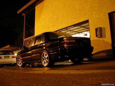

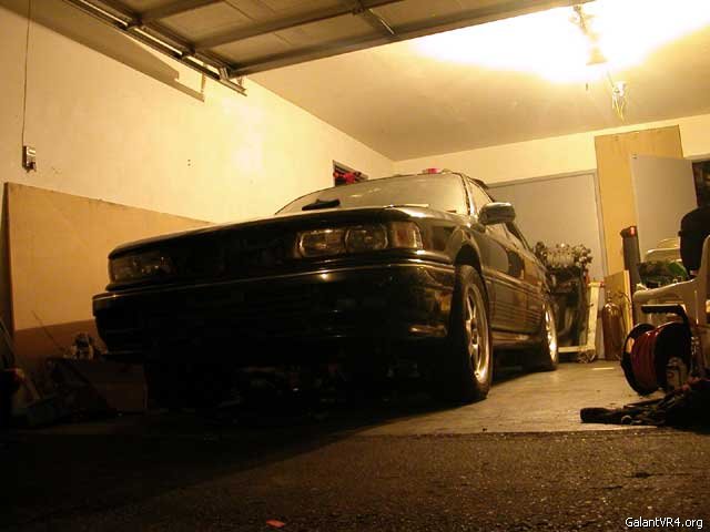

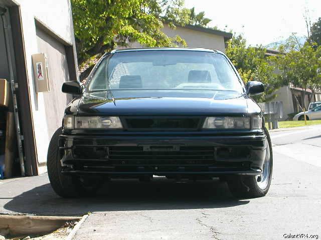

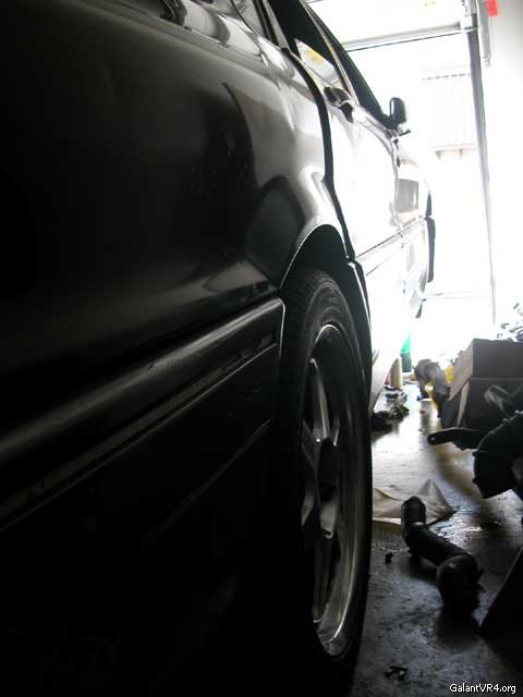

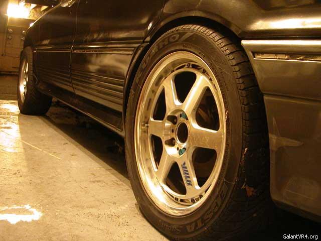

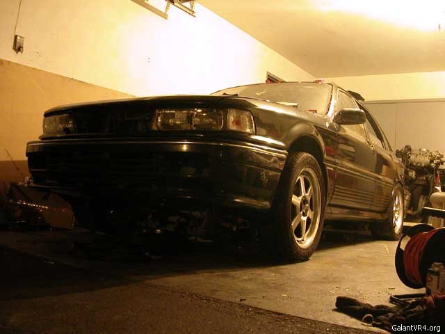

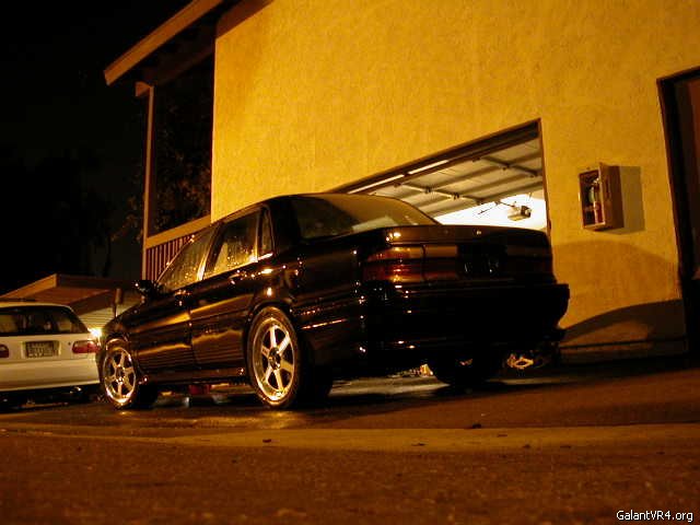

got the front wheels on, rolled the car back and forth to see how the rear sat...
It's pretty slammed. I might need to get 235 width tires instead of the 245's that's on there right now. Rims are 17x8 +43 offset.

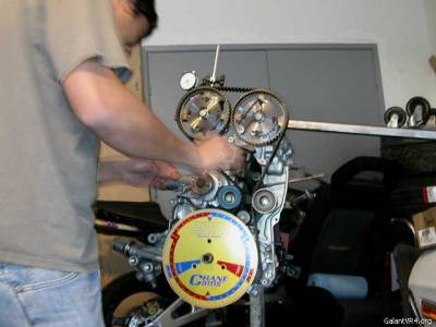

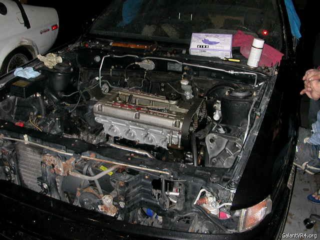

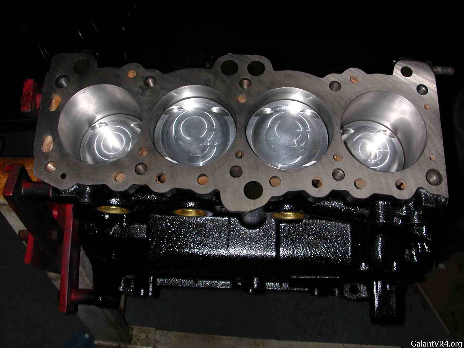

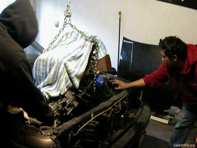

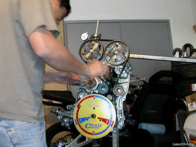

Motor will be stock for now. I do have a built bottom end that's been sitting since '02. It has JE pistons, Crower rods, knife edge crank, and no balance shafts. As soon as I drop off the car to the body shop for a finish of Infiniti Twilight Blue, maybe I'll start porting my head which will take in HKS 272's, JUN adjustable sprockets, webcam valve spring kit, 1mm ss valves, new guides, and new gen lifters. Turbo...i'm still undecided. I do have a Garrett t3/t4 60-1 stg 3 w/ .82 a/r that is...yes..sitting around still brand new in box! I might sell it to my friend and go for a FP Green.
I will put a mesh in the grill and an rx-7 air to air oil cooler will sit right behind it.

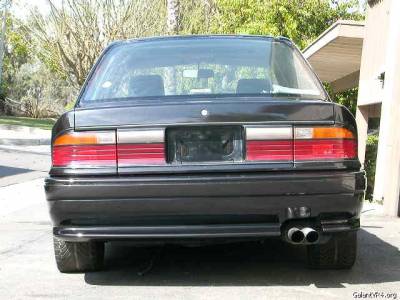

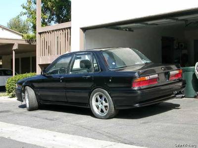

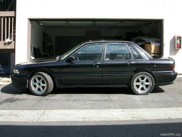

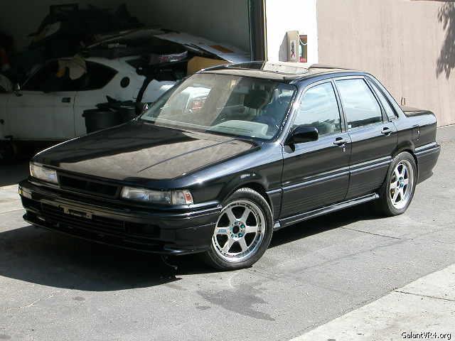

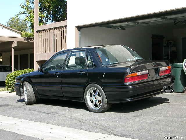

Well she is about 90% done. I still have tons of things to do.

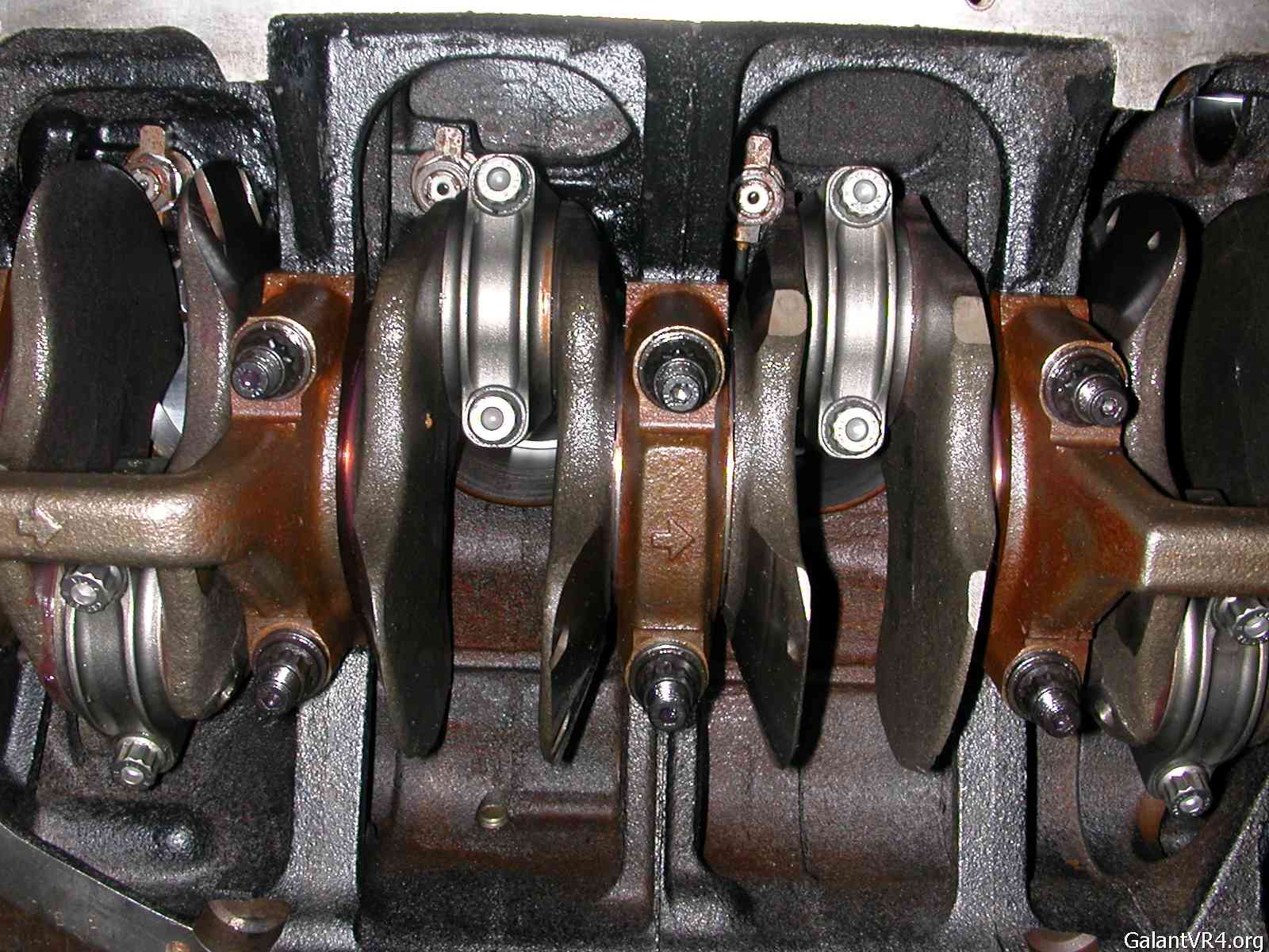

built bottom end consists of JE pistons, Crower rods, knife edge crank, ARP hardware, and of course no BS
Closer look at the knife edge crank...

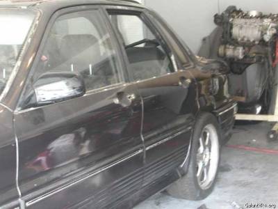

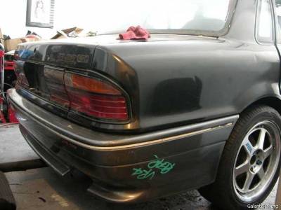

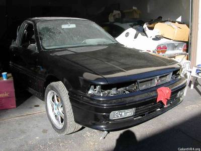

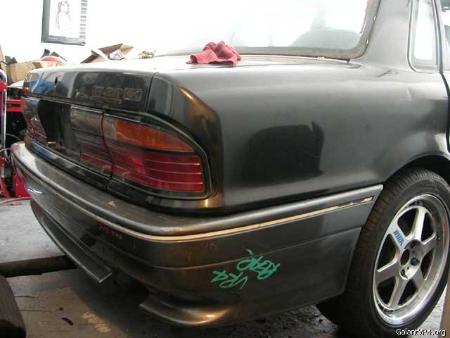

Fresh from the body shop...

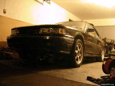

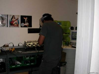

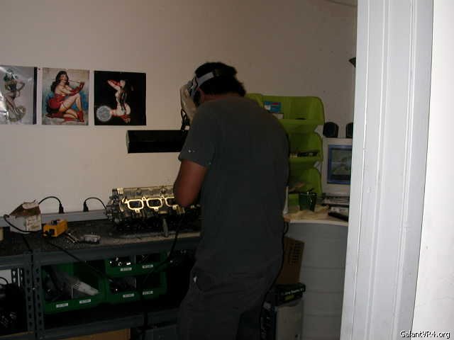

Porting head. No flow bench, so the only thing I can really do is clean up the castings...
dialing in the HKS 272's

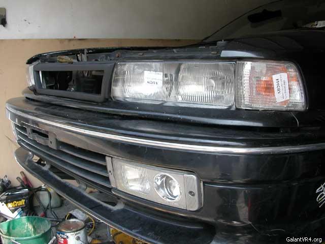

Still need to wire up the JDM headlights and fogs...

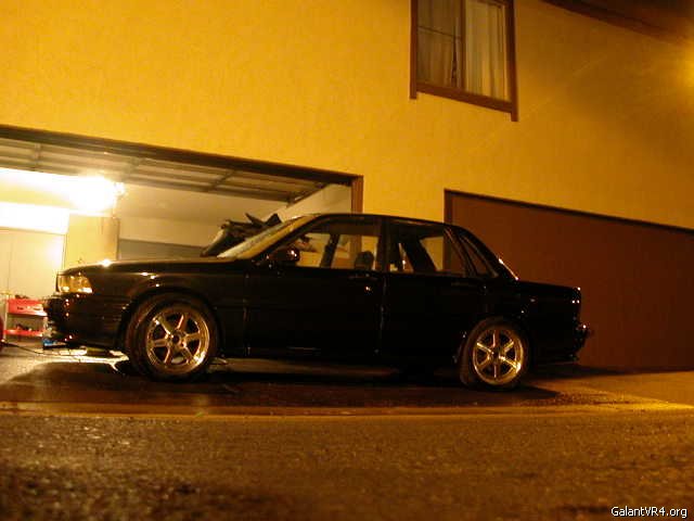

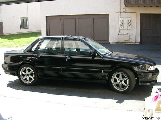

There it is. I'm still waiting on my window mouldings and vr4 emblems, which cost me $460!!!! javascript:void(0)
/ubbthreads/images/graemlins/bawling.gif
I will be breakin her in this weekend...hopefully.

Good looking car! Nice to see another GVR-4 back on the road.
One question though. Do you plan on going really fast in reverse?
(hint: look at the tires) /ubbthreads/images/graemlins/wink.gif

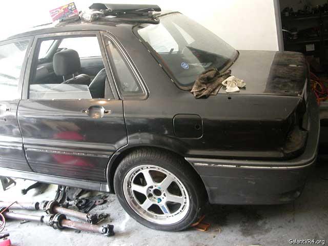

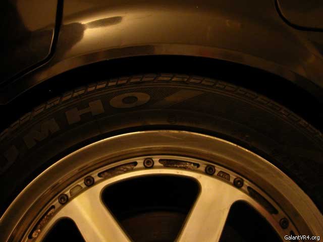

I was going to ask about the width of the tire but you already answered, 245 on 17x8 +45 offset... I thought they'd stick out but it doesn't seem that way at all or do they? Nice ride man /ubbthreads/images/graemlins/worthy.gif By the way, you started this thread almost a year ago damn! Long project but well worth it /ubbthreads/images/graemlins/applause.gif
I got one too
Apr 1, 2004
114
San Diego, CA
Ahh...thanks for pointing out the tires. Totally forgot about that. They are the Kumho Ecsta Supra's. I need to check if they are directional. As for the rims and tire combo. I actually have some 17x8 37mm offset for the front and 17x9 37mm offset in the back. I test fitted the rears and they fit...barely. I need to grind the trailing arm, roll the fender, get smaller width tires, and camber it.
