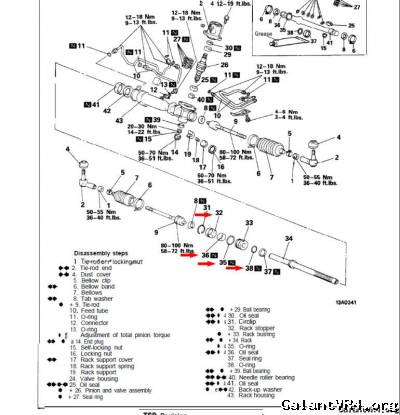

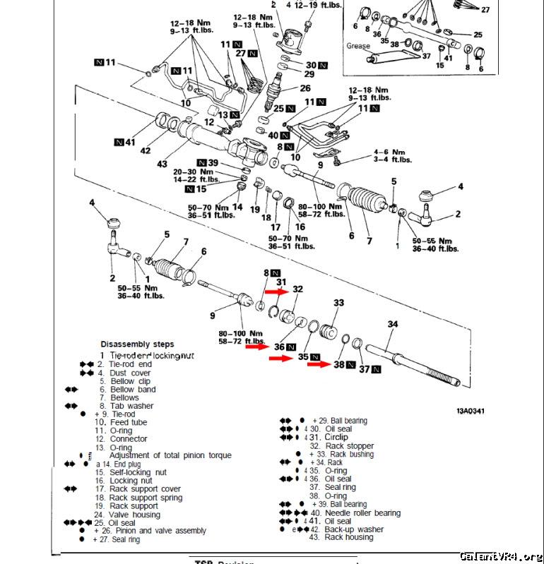

What diameter is the hard line on the rack
It's a metric line can't remember the size, JASO end fittings for a 14mm spanner. Have yours rotted out? I had one go which i took back to bare metal then braized (weld blows holes straight through!) still fine and dandy to this day.
