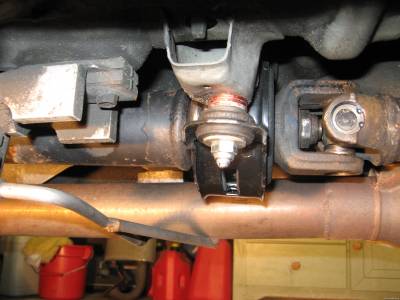

What are you guys using for shims?
I found this, would this work for under the carriers? I have never had one off.
/ubbthreads/images/graemlins/dunno.gif I know, wierd right?

Terry: I would use a regular round washers, before I use one of those..
The harbor freight shims might be easier to install, but they just don't seem to be that secure, since the opening is not a full circle.

This might be a dumb question but you guys shimmed both sides of the bearing the same hiegth? Not front AND back bearing but both studs on same bearing?
CP
Aug 30, 2004
8,940
West Simsbury, CT
Both sides of the same bearing with an equal number of washers. I'd think if you only shimmed one side of a single bearing you'd introduce a lateral kink into the entire driveshaft (all 3 sections).

Here's my story:
I installed 3 large washers on the front bearing only last night and took it for a test drive. Most of the decel noise/vibrations were gone but I now have a new drive line vibration when holding a steady speed.
I removed 2 of the 3 washers and the drive line vibration is gone but the decel vibration is back.
What a pain to do because I have to drop my exhaust to get the bearing to drop down far enough to get washers in and out.
I an going to get the body spacers from Harbor freight because that way I wont have to drop the exhaust to add/remove spacers.
Looks like we are on the right track.
Here's my theory.
The "wub wubs" surfaced after the new motor went in. It is a fresh motor that when I let the motor pull the car down in gear, wub wubs are loud and I feel it is because the motor is tighter it changes the drive line angle until the car gets low enough that the motor centers itself back in the bay. Then the noise goes away.
Changing the front bearing will compensate for this slightly, I just need to find the right spacing. And the exhaust pipe is a PAIN in the ASS.

I used some thick washers from my local NAPA.
Cy, what size are those washers?
What size is the stud?
Thanks.
CP
Aug 30, 2004
8,940
West Simsbury, CT
Not really sure, sorry. I took a spare bolt with me that the nut screwed onto and used that as my gauge to get the proper sized washers. The washers are pretty thick so I didn't have to use a whole lot of them, introducing more pieces to lose under the car when messing with the CBs.

I just got done installing more shims and have not test drove it yet but I did buy that $5.00 shim kit from Harbor Freight and it was super easy.
I put the open end of each shim into the vise and closed down the gap about 1/3 of the way to give it a better "base" and they slide right in.
That is definatly the way to go as far as "shimming" the bearings.
If anybody needs shims and is going to MOD, I can bring some. The kit has 144 in 5 thicknesses and I only used 4 /ubbthreads/images/graemlins/rofl.gif.
PM me and let me know if you need any. But there not worth mailing for the cost of the kit.

FYI, I have also experimented with more shims for my rear carrier bearing.
5mm shims is the right amount for me.
Thicker than this, I get driveline noise at steady-state cruising speed.
Less than this, I get the famous wub-wub decel noise.
There really is a good reason why the manual clearly stated that the amount of shims is very car specific, and you're supposed to note them whenever the driveshaft is removed. But over so many years, with so many miles on our cars, bushings/motor mounts have worn enough (or replaced with much stiffer ones) causing the original factory adjustment to be no longer accurate.
