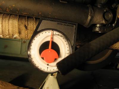

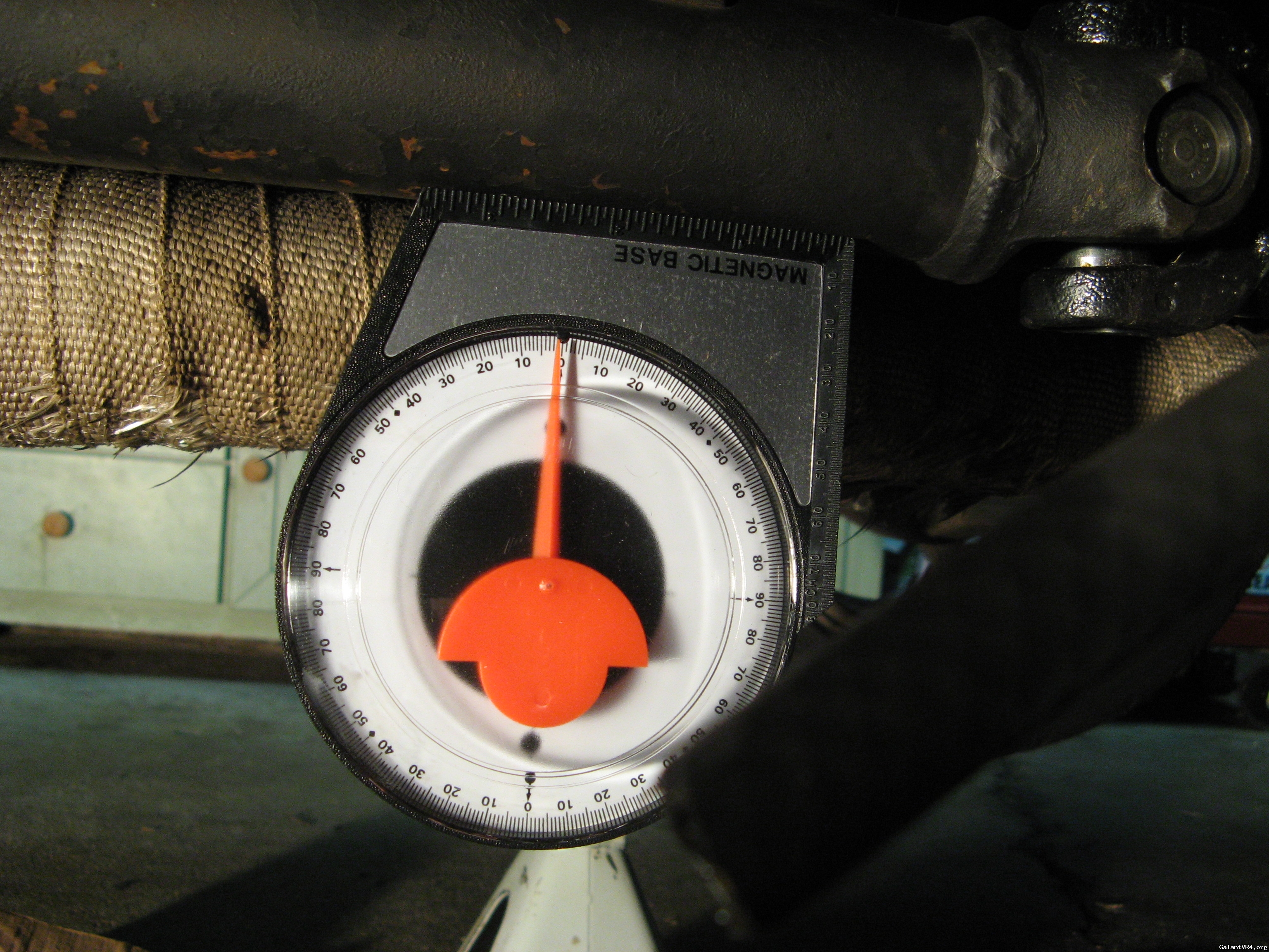

Front portion of the DS had about a 1.5* angle:

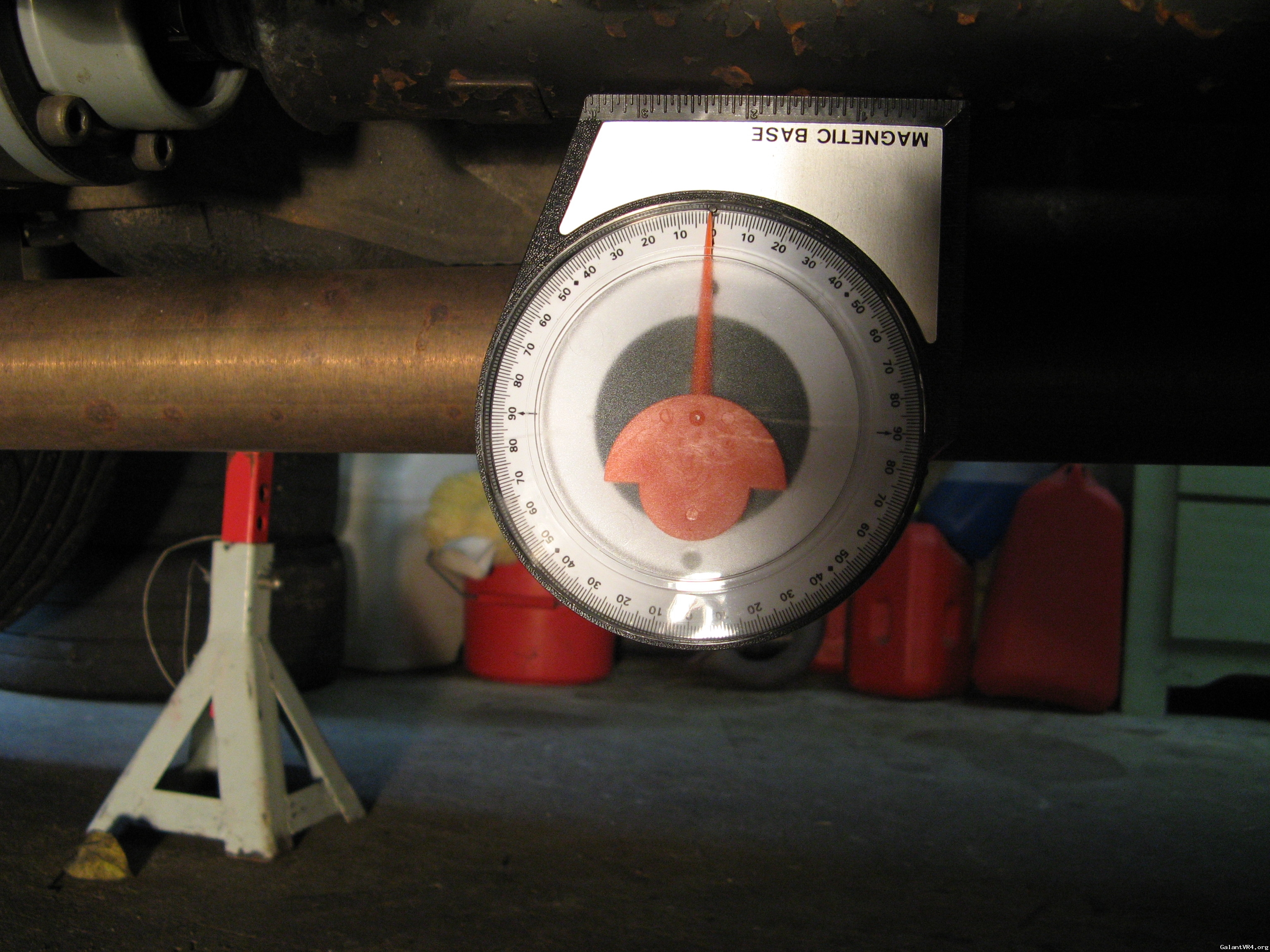

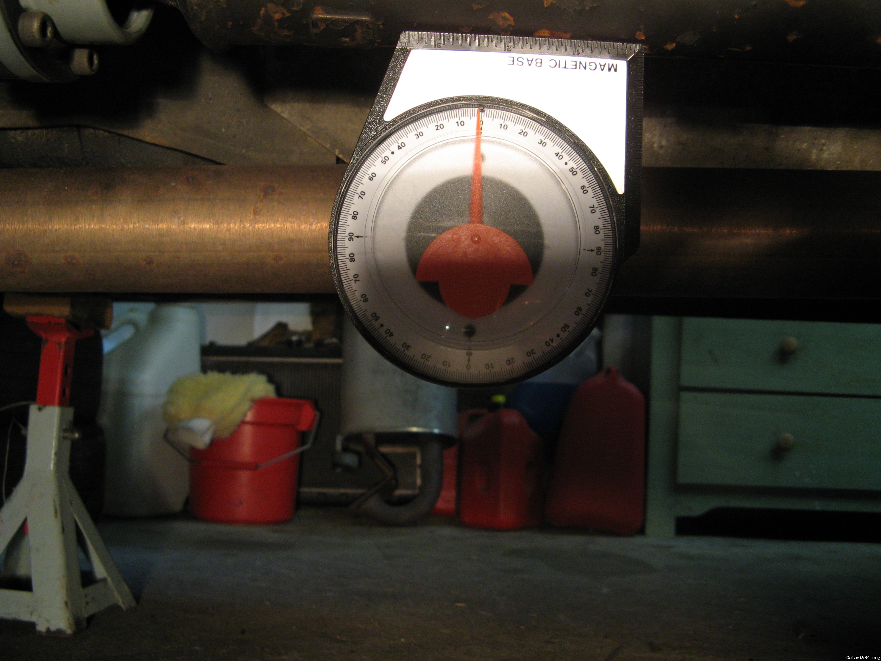

Rear portion was at about 1*:

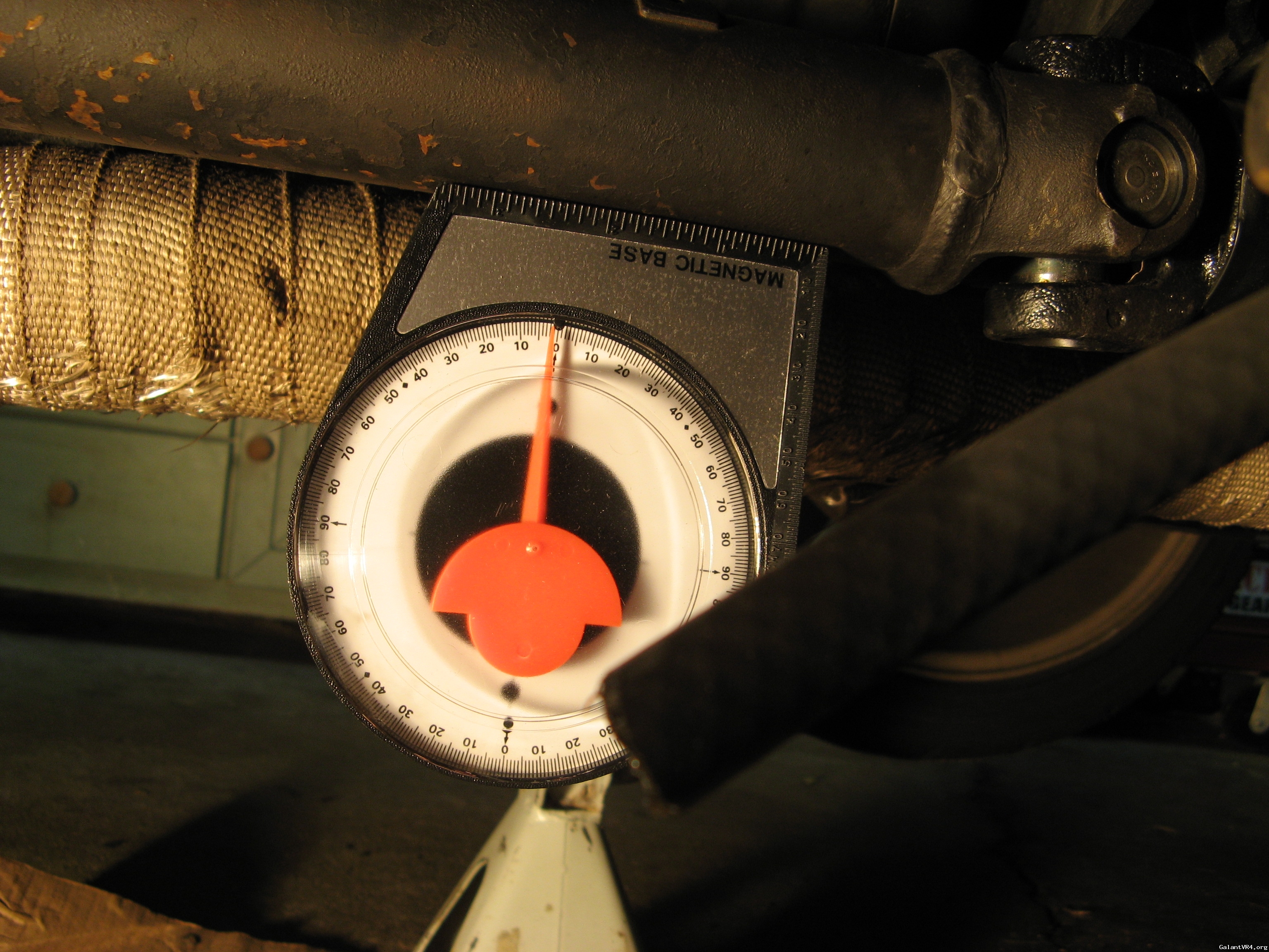

So I shimmed the front carrier bearing with another 2 washers:
So they're roughly the same now:
I didn't experience much of a change at all, so I guess front and rear motor mounts are next on the list. I was poking around in there and the rear mount seems like it'll be pretty easy to get at once the t-case is removed (I don't have an AC compressor either). I didn't look at the front, so I have no idea how difficult that will be to change.
