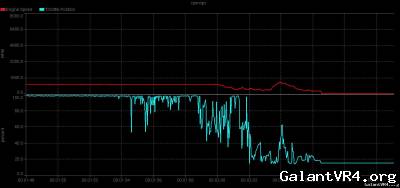

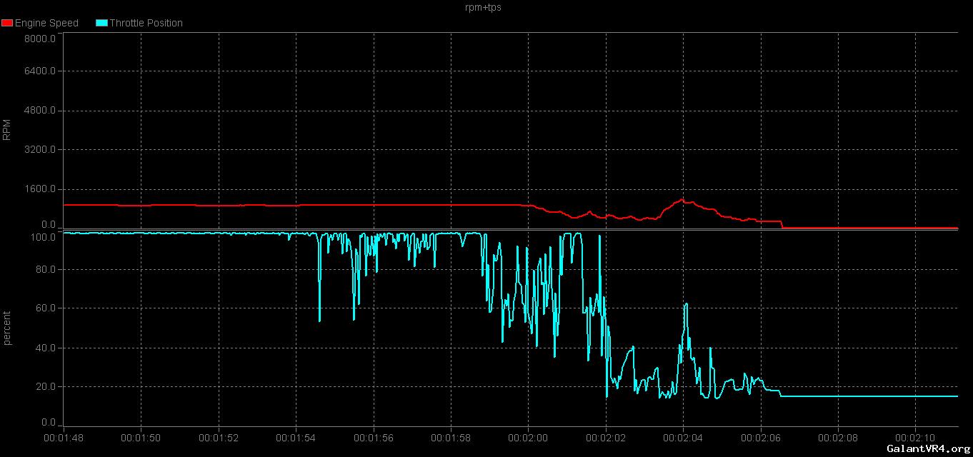

Symptoms occur mostly when good and warmed up - proper operating temperature. Engine will randomly buck, drop cylinders. In the rare times it's happened while parked, idle will hunt very erratically, 500-1500rpm, before stalling. Applying ~30% throttle overcomes the issue, sometimes even "fixing" the problem for extended periods of time, but the misfires are still evident and it's not common for the car to die multiple times in a row in rush hour traffic on warmer afternoons.
Battery connections have been replaced/cleaned. Additional grounds installed. Symptoms happen irrespective of fuel level (ruling out aging fuel pump). CLT has been replaced. AC switch atop tstat housing has been rewired. Local harness exhibits typical loss of flexibility.
I'm gonna re-do all the wires this weekend, as I'm sick of this sh*t. What I'd like to know is:
- At operating temperature, lifting off the throttle in gear at approximately 3000rpm, what is the ECU looking for and adjusting? TPS, IAC, CLT?
That is, if the CLT reading is fluctuating rapidly due to connectivity issues, what is the ECU doing to try and compensate? Open/close IAC? Flood cylinders?
Don't have a logger, and the friend I usually borrow it from lent it another friend, who lent it to another friend. No access right now.
Besides, I'm looking more for an understanding of the way signals are interrelated during these conditions.
Thanks.
