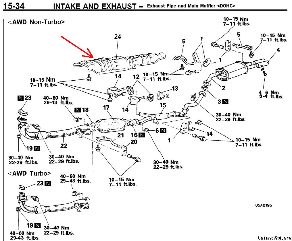

Did you have to drop the exhaust to remove that heat shield? Do you know how many and where all the bolts are that hold it on? So far I have only found one. The drawing I have shows two of them but it doesn't really show their exact location.

Here is the drawing for the heatshield that I have.

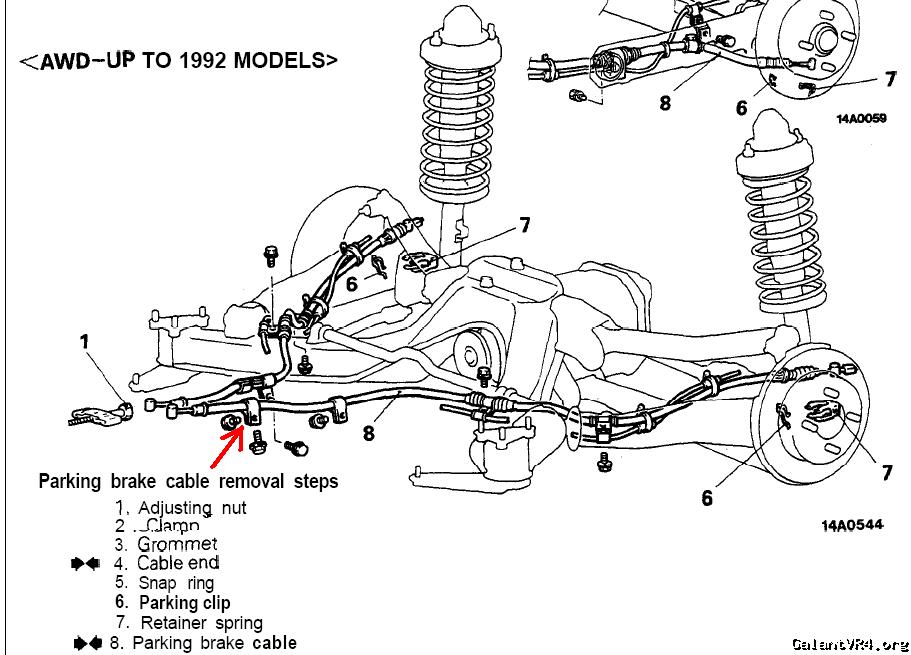

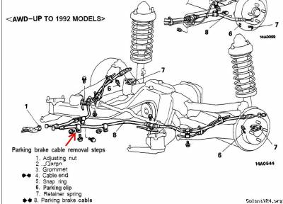

This is the bolt I have left to remove.

Well, I finally got the old parking brake cables out and the new ones in. I didn't have to remove the heatshield but I did have to drop the rear carrier bearing a bit. With a long extension and the carrier bearing dropped I was able to get to the bolt in the previous drawings.

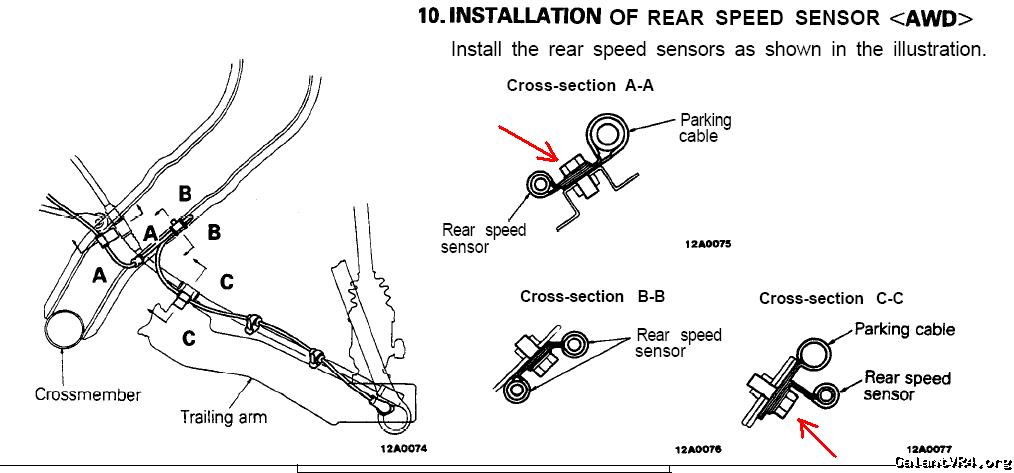

I still have to figure out a way to compress the hold down clamps for the parking brake cable and wheel speed sensor together so that I can thread the bolt that holds them. The ones giving me the most trouble are the ones that are bolted on top of the rear subframe member. There isn't very much room to get creative there.
It turns out that the bolts that were easiest to remove are the most difficult to get back on. I should've known.

These are the two that I need to compress so I can thread the bolt on.
