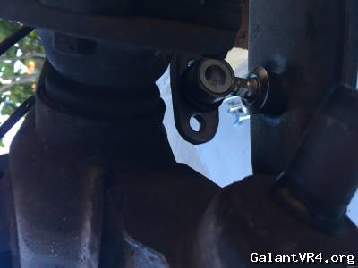

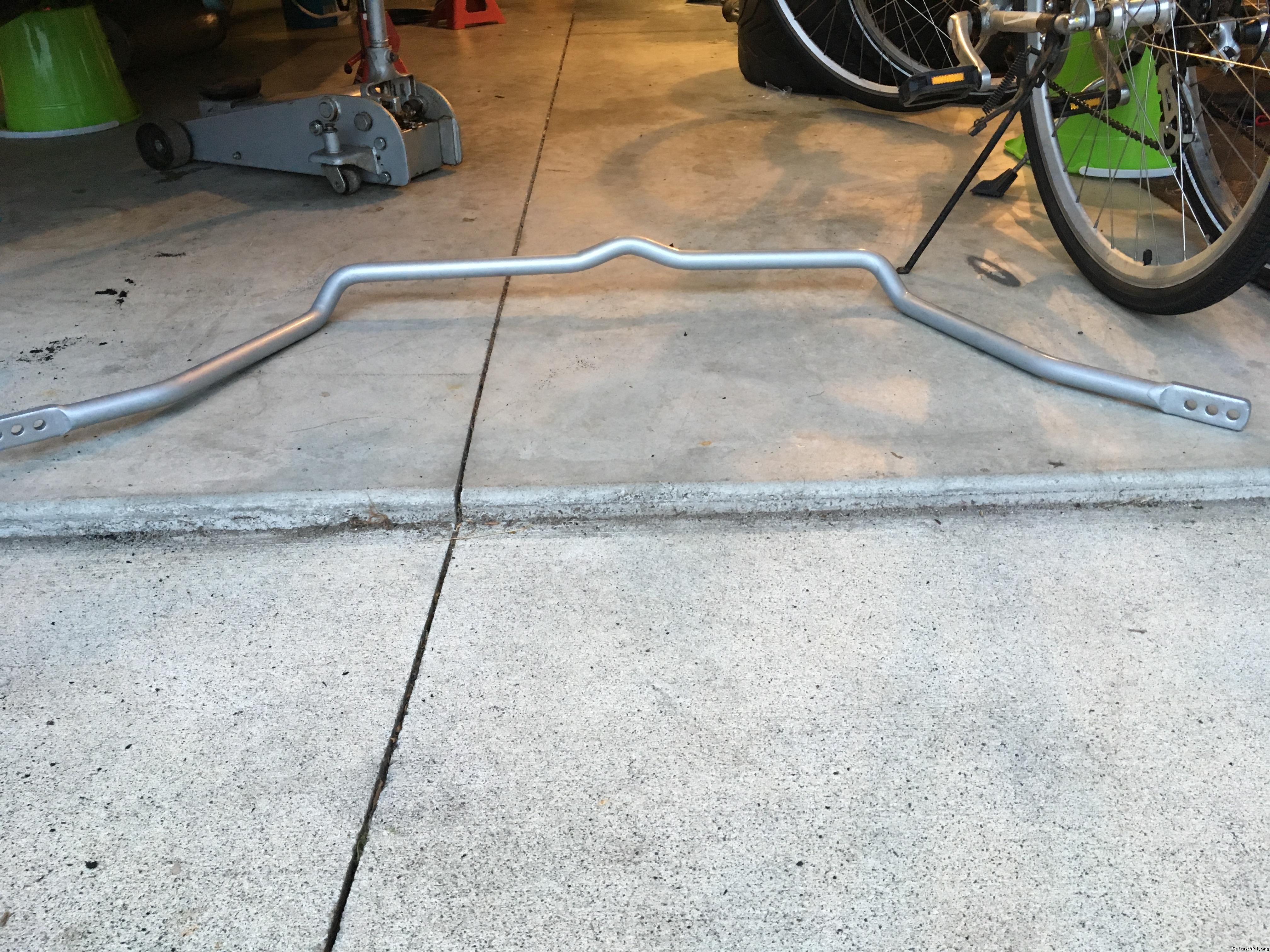

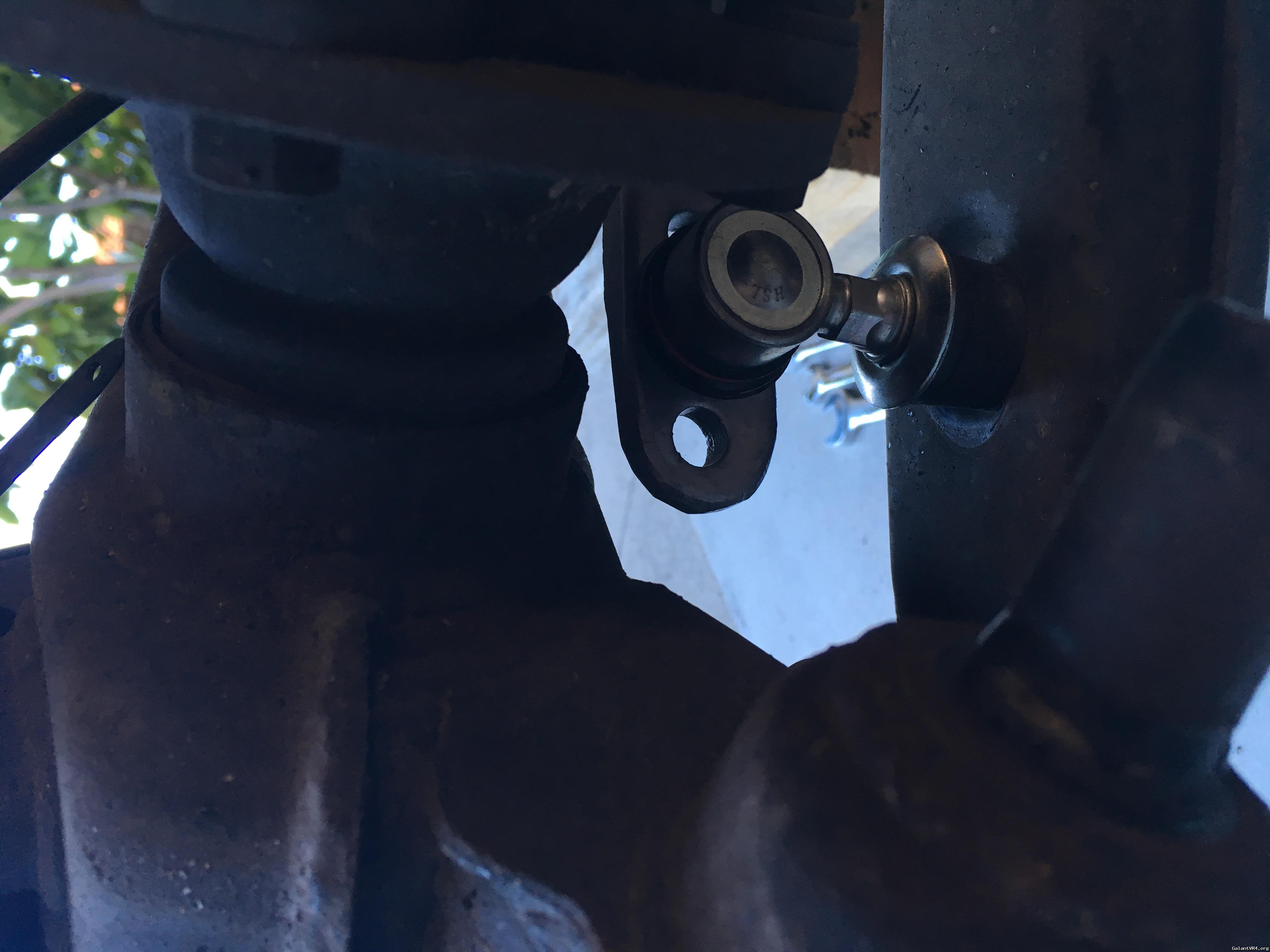

I just installed my whiteline 26mm bar last week and had all the known issues and perhaps one more.
I ground the slots on the bar mounting brackets and changed hardware to hex cap screws with D shaped washers in order to fit the brackets to the factory mounting position.
The clearance between the end of the bar and the rear trailing arm/hub was insufficient so I had to grind the top corners down to stop it contacting there. I dont think this is a big issue but reflect sloppy/cheap manufacturing.
I don't want to us the word bent, but my bar was crooked. When I sat it on a flat surface the right side of the bar sat flat against the surface and the left side of the bar was 20mm above the flat surface. (workbench and concrete garage floor)
When I installed the new mevotech endlinks I cut one of the bushings in half and spaced them differently in order to compensate for the 20mm difference and remove any preload on the bar. You can see it in the first picture above.
So not all that good from whiteline, but what I will say is that a 26mm bar in the middle stiffness setting did help the under steer a bit but as mentioned above it certainly did not make the car neutral or tail happy. So i wonder if the 25mm bar would be worth it. I am thinking I will change my endlink location to the stiffest setting soon.
